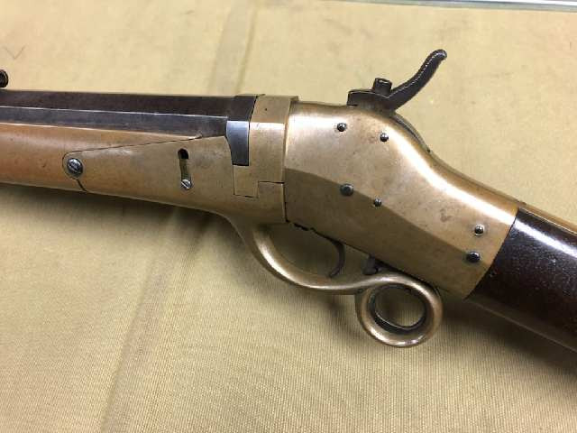

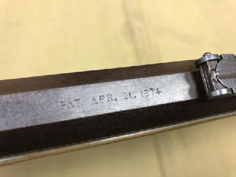

Not a Winchester.  My friend has passed away and we are trying to figure out the maker of this rifle/carbine.  He and I had talked about this gun in the past but my memory is terrible.  Top of the barrel says Pat. Apr. 21. 1874.  No other markings.  I really don’t want to go through every page of a Flayderman’s

I have not held this gun in about a year.  I am sure it is a lever gun.  It may be a one of a kind.  This could be the rifle used to get a Patent.  US Patent 150,102.  Frank Atwood Huntington and Alfred Swingle of San Francisco. My friend collected brass guns and had a hand full of experimental rifles.  I know he told me the Manufacture but I don’t remember it being some obscure maker.

More and better pictures would be most helpful!
Reminds me of a Starr Rifle but need more details. Is it percussion cap or center fire? What does it look like with the lever operated?
Couldn’t find anything from the patent date, other than Sharps has a matching patent date for one of their rifles, and its not a Sharps.

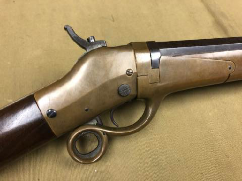

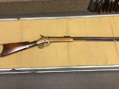

Here are a couple more pictures.  I contacted the Auction house and she said they had already ordered a copy of the Gun Report.

And the inventors thought they could sell THIS in competition with ’73, or even ’66, Winchesters!

So, do I have this correct – this is a lever action repeater?  Where does it load?  Where are the cartridges stored?  It looks like there is no magazine tube.  A very interesting rifle.

I just looked at the patent drawings now.  I can see the cartridges work there way up from the rear – but it is not clear to me where they load.  Through the butt?  I would enjoy seeing a photo of the action open.  I would also really enjoy working the action on this one to see exactly how it operates.  Ideally, running some dummy cartridges through it would be very illuminating.  I enjoy odd pieces like this.
