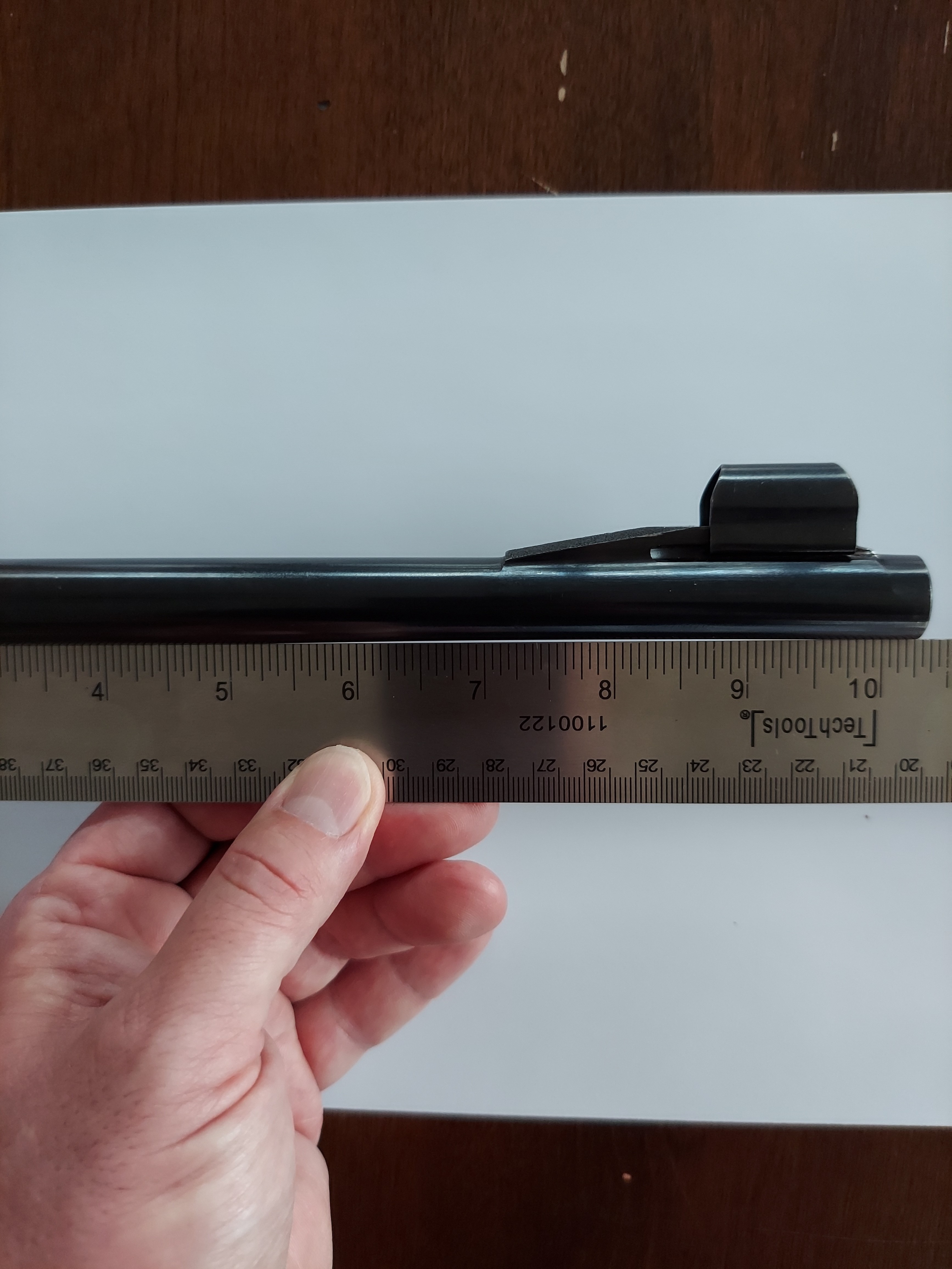

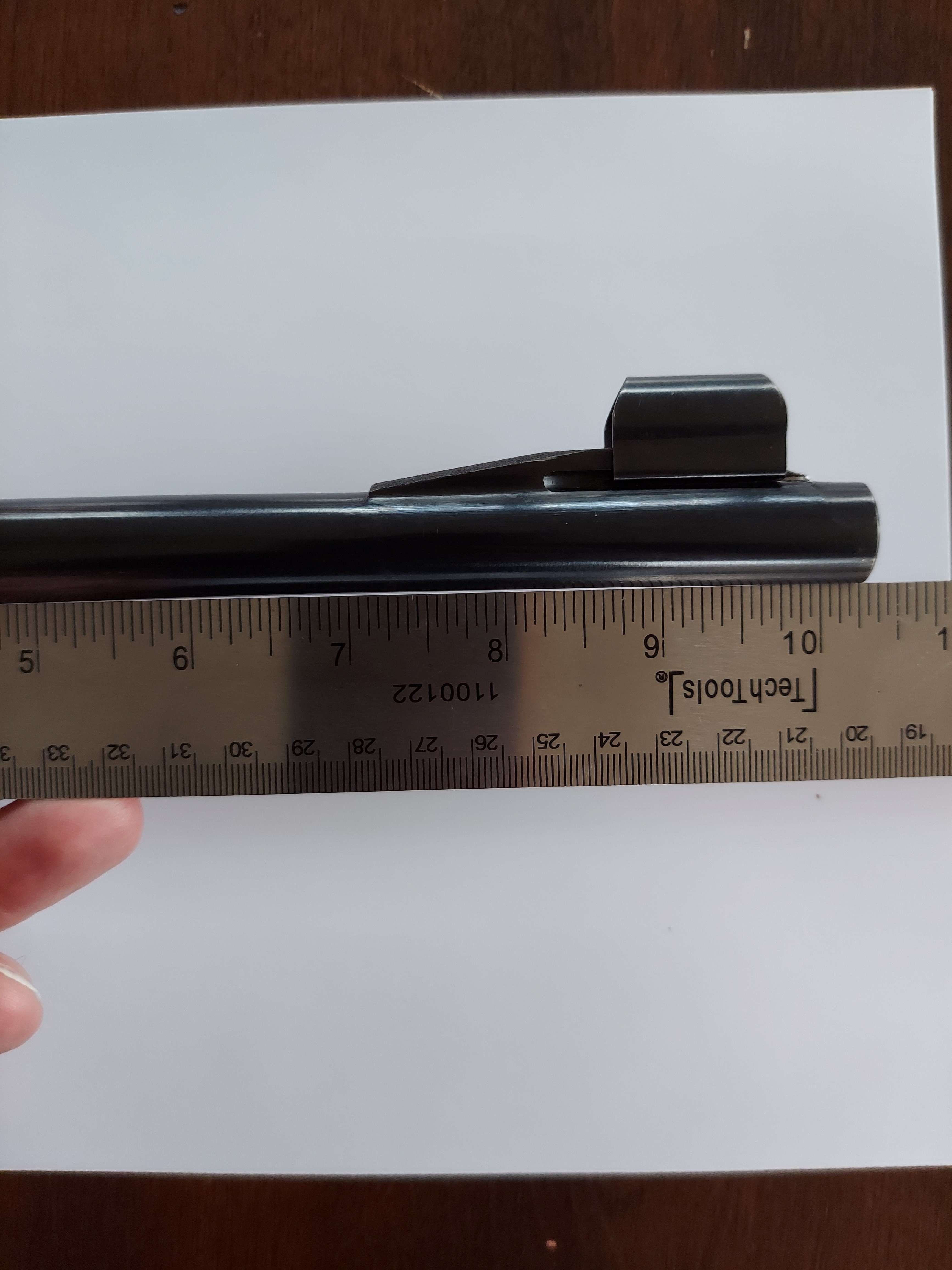

Hello All!  I was hoping the membership could help guide me in the right direction for a repair.  I recently acquired a Winchester Model 71 made in 1955.  The rifle is in beautiful original condition, with only a few minor handling marks on the wood.  Bluing is great.  Unfortunately, sometime during it’s life it acquired a slight bend in the barrel.  The bend is in the last 6-inches at the muzzle end, and I don’t think the gap between the barrel and a straight-edge is even 1/8.”  Naturally I’d like to have the issue addressed.  I was wondering if anyone could recommend a gunsmith for this type of work.  Replacing the entire barrel seems excessive given how minor the bend is, but I’m certainly no expert.  Turnbull has already turned it down, as have all of my local smiths.  So….any recommendations?  Thanks!20221025_092838.jpg20221025_092932.jpg

Verify that the bore has the bend before you do any bending not that its just had too much metal removed in that area in the finishing process.

ck4241 said Turnbull has already turned it down, as have all of my local smiths.
Be grateful for that–you may have saved about as much as the gun is worth.  And be doubly grateful the “local smiths” turned it down, or you’d probably have a disaster on your hands!  But the cardinal question is, how does this defect (if that’s what it is) affect the accuracy of the gun?  If it will produce a reliable 3 shot group of about 2 MOA, I don’t think you have a problem beyond a minor aesthetic one.
If AFTER testing it, you discover a serious accuracy problem, you might speak with John Taylor at Taylor Machine.
How would I verify this?  My eyesight isn’t good, but I cannot discern any evidence when looking down the bore with the naked eye.  Run a dowel down the bore perhaps?
Forum Posts: 5011
January 10, 2023 - 5:48 pm
Winchester would straighten barrels after the boring process by looking down the barrel at a window with a line across it but I think that was before the rifling was put in. If you can’t see a bend in the bore then a metal dowel is the next best option. A wood dowel might follow the bend depending on how hard of wood you used.
