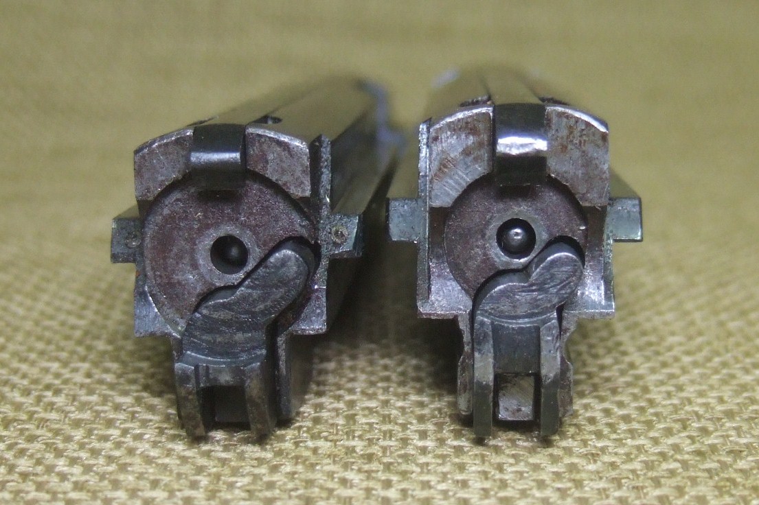

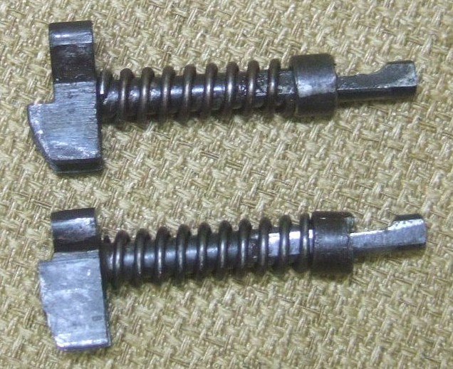

Here is a pic showing both.  The large caliber bolt and ejector on left, small caliber on the right.  Then the ejectors: large caliber on top, small at the bottom.

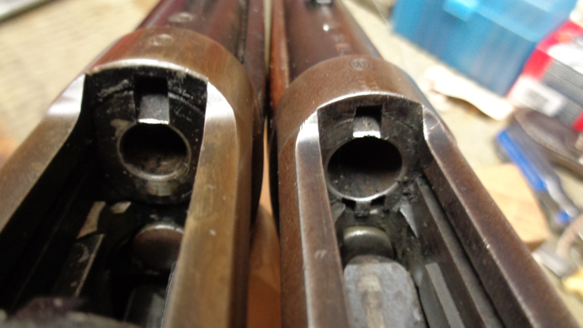

Here is a view of the breech: small caliber left (25), large caliber right (38).

It looks to me like the cuts have something to do with “…if a cartridge case ruptured, the gas pressure would escape out the hole without damaging the rifle or shooter.”  (Re: Questions and Answers Page #1395 at  http://oldguns.net/q&a8_98.htm  .   For example, on the small caliber W-Ks, the gas escape hole is located at the forward edge of the top cover, just above where the extractor engages the top part of the barrel, similar to what Spangler notes in the referenced answer, but on the large caliber W-Ks, this gas relief feature on the top cover has been eliminated, and the cuts to one degree or the other on the bottom edge of the barrel that has been cut to allow for a larger cartridge extend a fraction past the rim of the chamber, and might serve the same purpose.
