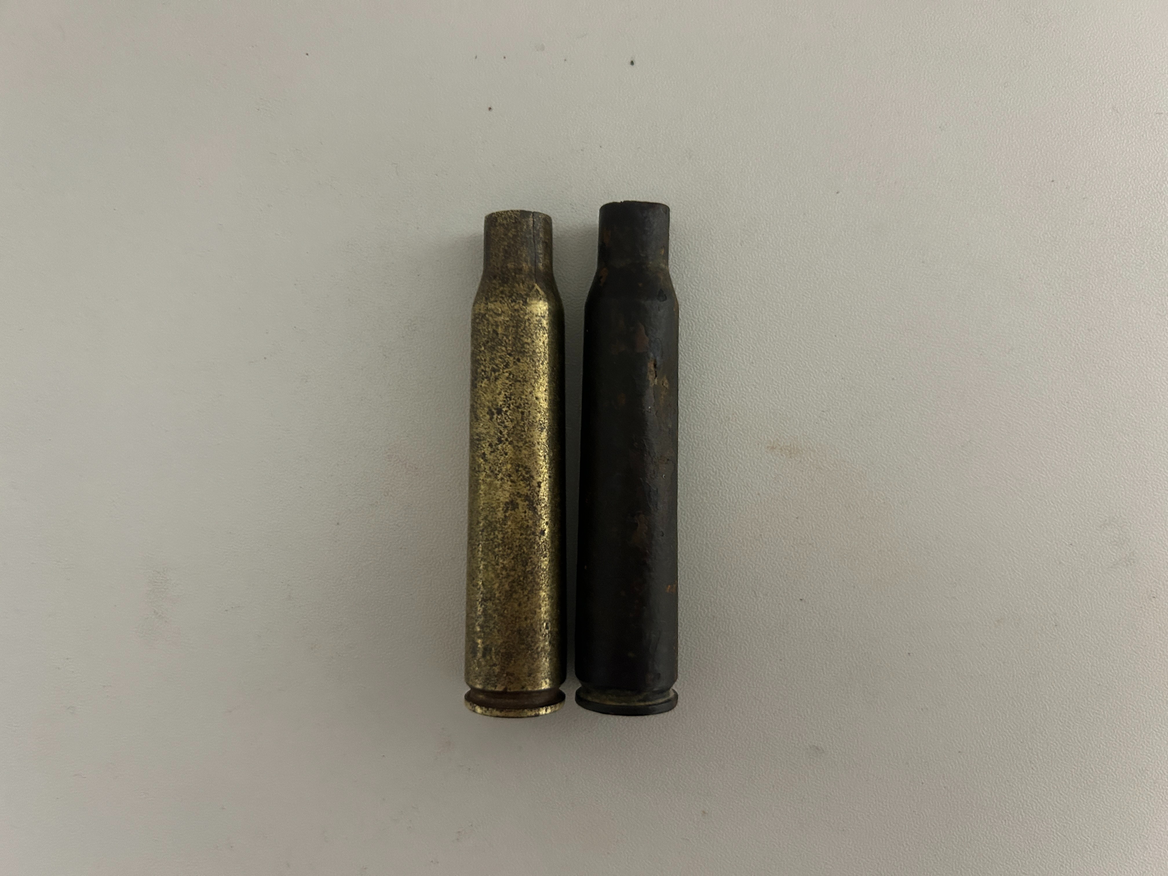

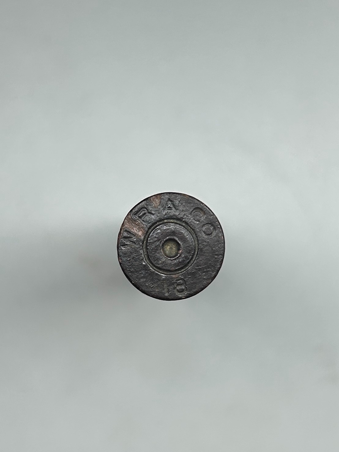

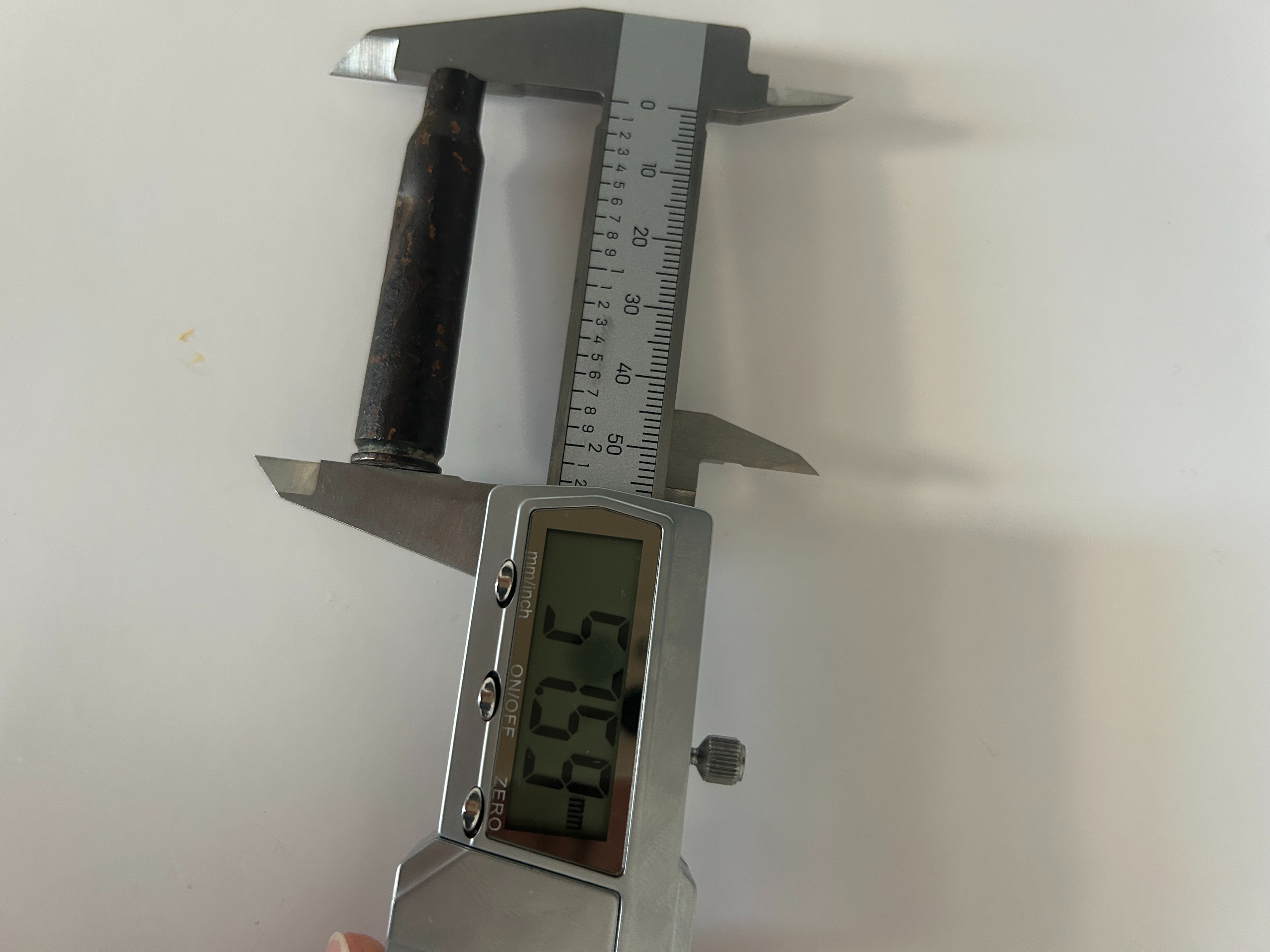

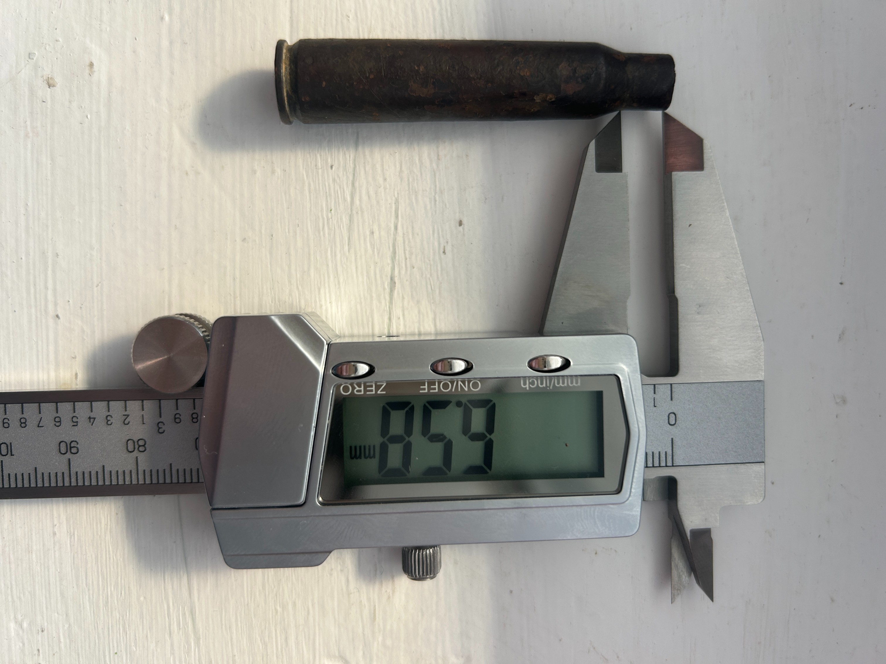

Hi guys, I received a dug out case with headstamp “WRACO” and “18” from a seller in China. Any idea about the headstamp? The case is about 57.66mm long, base diameter is 12.03mm.
The case looks a lot similar to 6.8x57mm Mauser which Mauser developed in 1907 specifically for China. I would be amazed that Winchester made 6.8x57mm Mauser for China!
Aaron

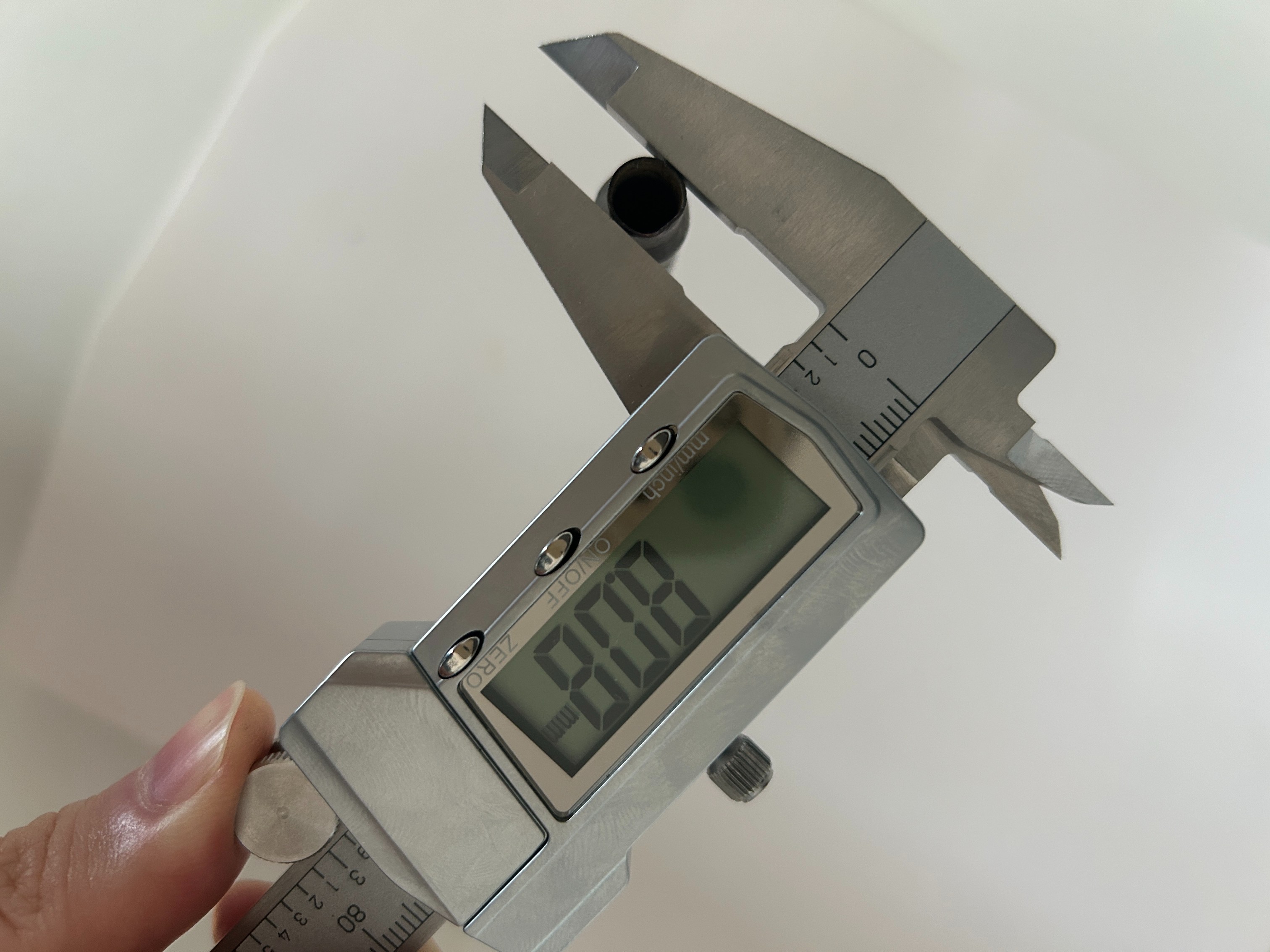

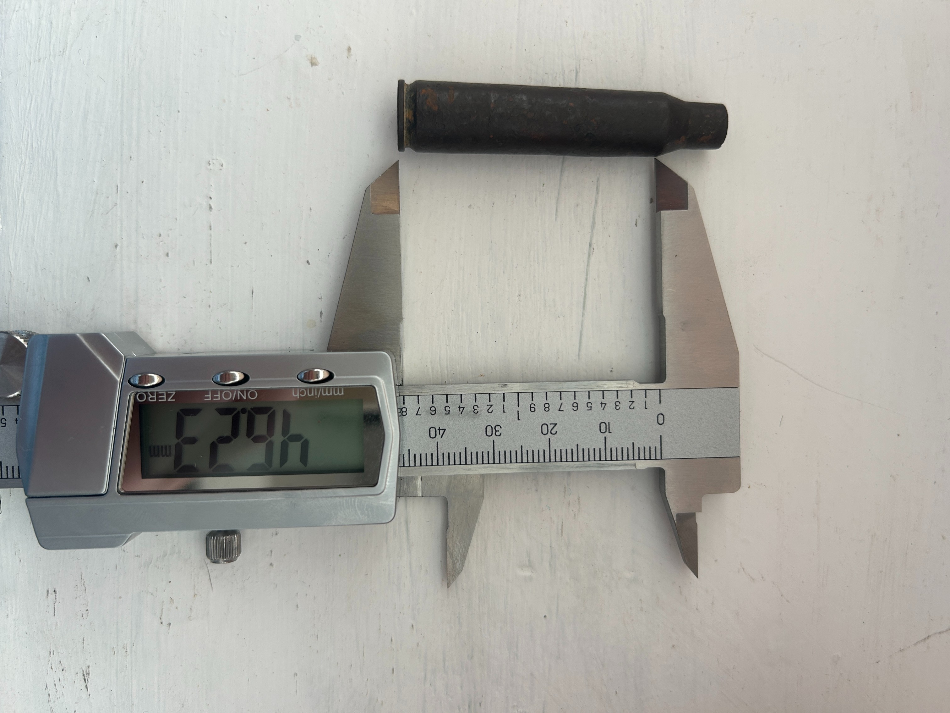

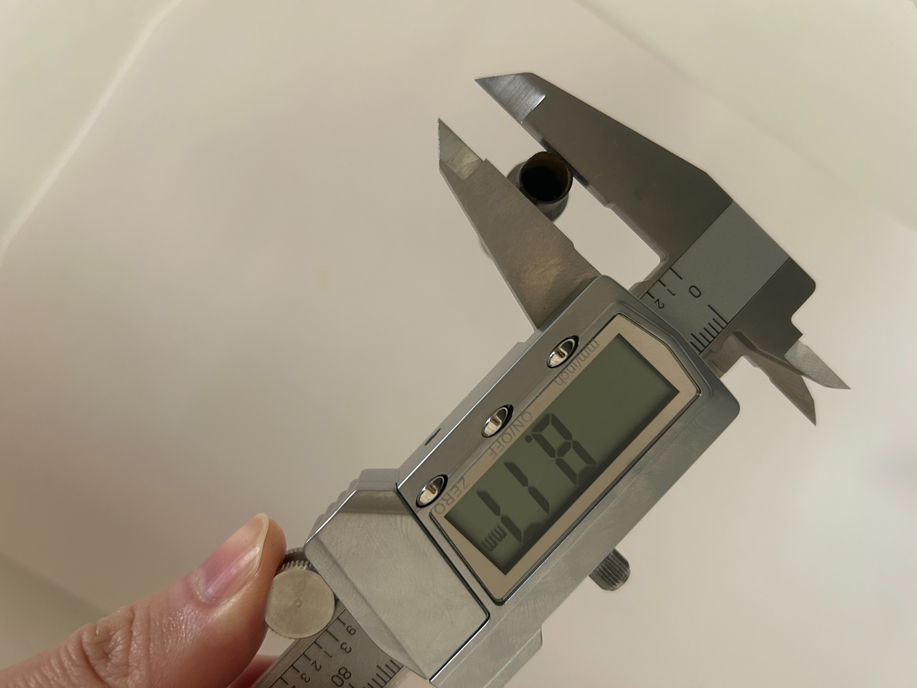

Take some measurements with a set of calipers.  Overall length, neck diameter, base diameter, rim diameter etc.
Forum Posts: 14946
October 26, 2025 - 6:00 pm
Generally speaking, If Winchester manufactured a firearm for a military contract, they also manufactured and shipped 1,000 round per firearm.
Forum Posts: 6915
October 26, 2025 - 6:49 pm
According to Donnelly’s manual for the Chinese 6.8 x 57 mm the dimensions for a new unfired case are:
OAL 55.676 mm
Head/base D 11.76 mm
Rim D 11.887 mm
Neck D 7.899 mm

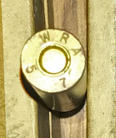

The 18 on the head stamp usually means with military rounds the year of manufacture. So 1918.  This one is a 1957.

Look on page 337 of Dan Shueys book volume 1. It appears to be a 30-06 for a machine gun–Bill
You might be on to something.  I don’t see the machine gun connection, but I am blind sometimes,  but the 1917 rifle that was used in WWI was a 30-06.

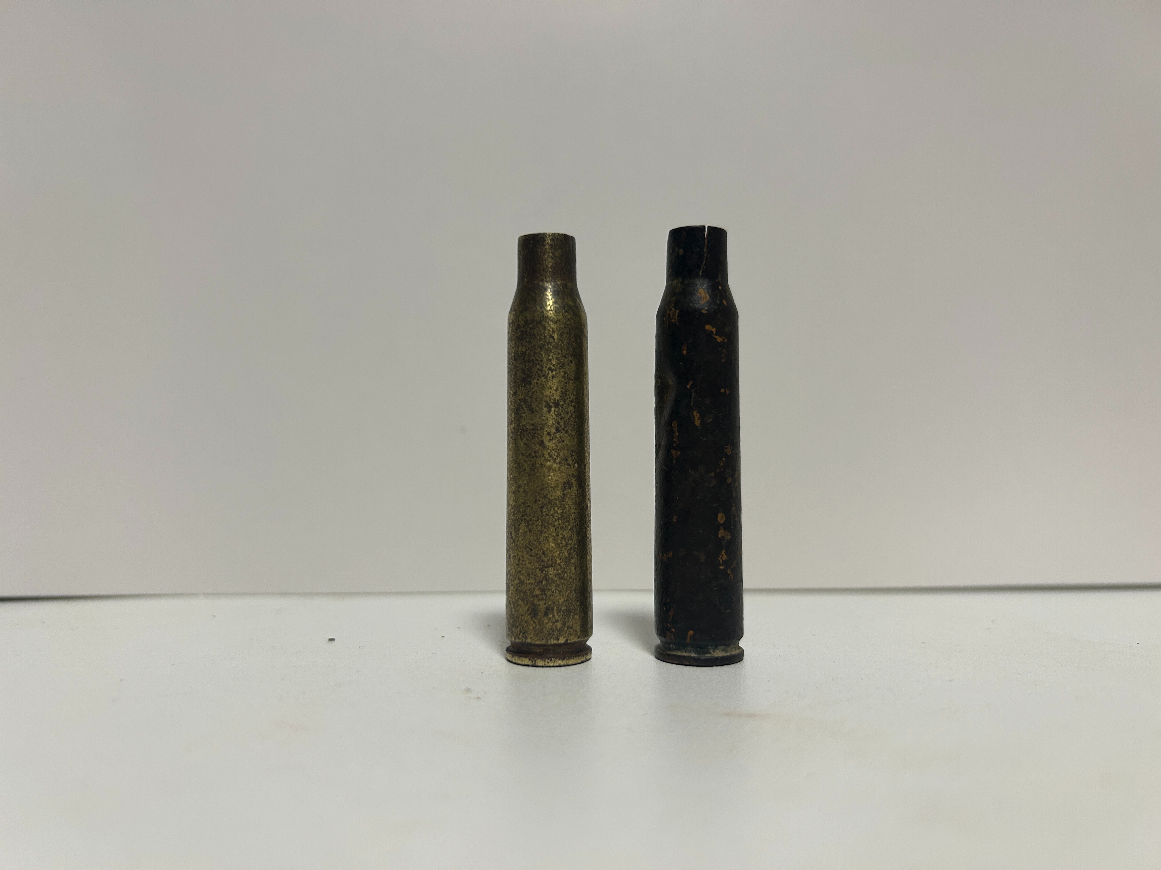

Someone at Facebook group said this is a 6.8x57mm case modified from .30-06 case and it’s common to find in southern China.
November 5, 2025 - 11:35 pm
I’ve asked the guys on the IAA Forum about the case and will see what their response is.
November 6, 2025 - 4:59 am
This seems to be the consensus with the guys on the IAA Forum.
Circa WW1 United States .30-06 cartridges that have been extensively modified into other calibers and were found by metal detecting in China. Along with other brand/make US WW1 .30-06 cases reformed into 6.8x57mm cartridge cases.
So originally a 30-06 Gov’t WRACo case with a 1918 dated head stamp that was re-sized into the Chinese 6.8x57mm case.
