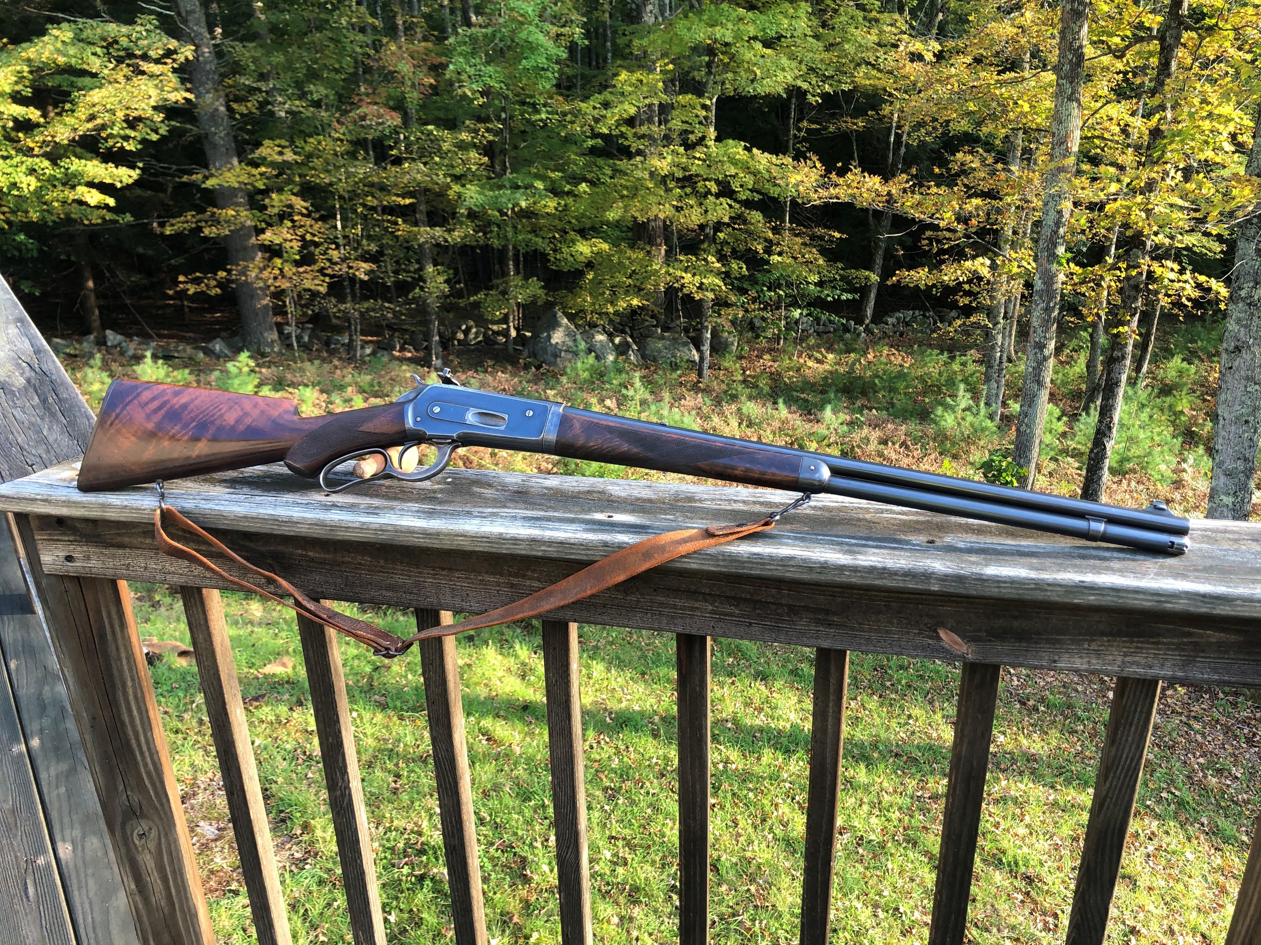

Aah, the 33wcf. Talking my language now.SmileIMG_0492-Copy.JPGIMG_0502-Copy-3.JPG

And for good reason, Tom. Adequate powder capacity, brass readily converted from the ubiquitous. 45 Govt case,  popular .338 bullet diameter, flat nose half jacket bullet still available for rough bores, molds and commercial lead for slick bores. A useful and comfortable step up without going overboard. I prefer to load my .348 to that power level, in fact.
If Winchester Guns would offer an 1886 ELW in 33 WCF,  particularly if Hornady would cooperate with a run of factory ammo, I think it could be a nice addition to the line. Hopefully, somebody with enough rank to make it happen would require inclusion of the fairly accurate, checkered steel shotgun buttplate with diamond-shaped bezels, as seen on the Miroku 1873 Deluxe Sporting Rifle.
I would strain the budget to get one, particularly if it were a takedown model. Might even beggar myself for a leg-of-mutton case.
To me the 33 WCF makes as much or more sense than the 35 Remington as a Whitetail and hog cartridge. (I’ve not hunted Black bear but the ones I’ve seen in Tennessee and Washington State seem to be outgrowing the “medium” label.  I might be more comfortable with a .338-06 for a couple of 350-400 pound boar Black’s I’ve observed on a security camera clip.)
