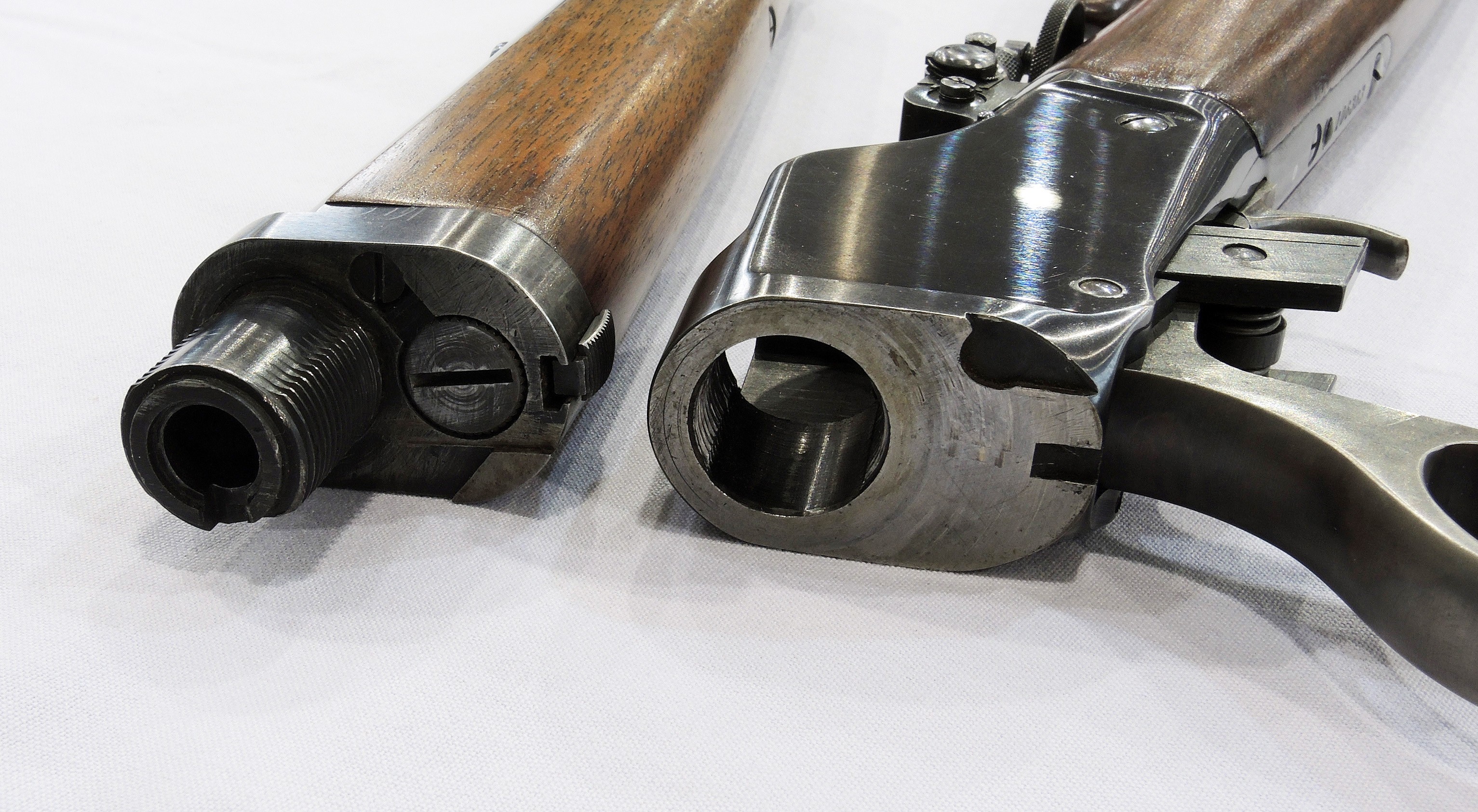

For the Model 1885, your Winder Musket’s journey (time in the factory) is not the least bit unusual.  I have seen many similar instances in the ledger records, and I own one rifle that had a similar extended stay in the factory;
S/N 106383, Take Down Sporting Rifle, 30 U.S.
PR date – December 2nd, 1907
Received in warehouse – May 15th, 1909
Shipped – February 23rd, 1919
This is the rifle…
