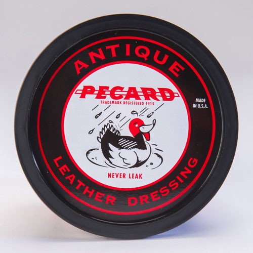

This is the best leather treatment I’ve found.

Like Vince, I use Pecards, even on leather car seats and my favorite old chair in the house.  Verdigris is an incurable curse.
