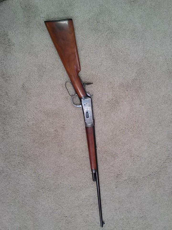

Thanks to all for the information. Thought I try to add a picture of the rifle that started all this.1516035851663-1450706542.jpg
