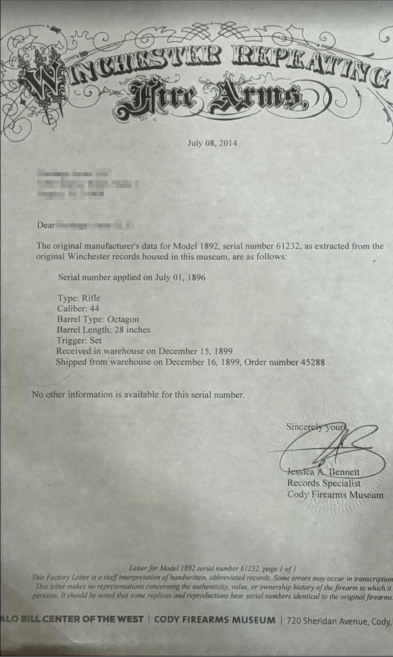

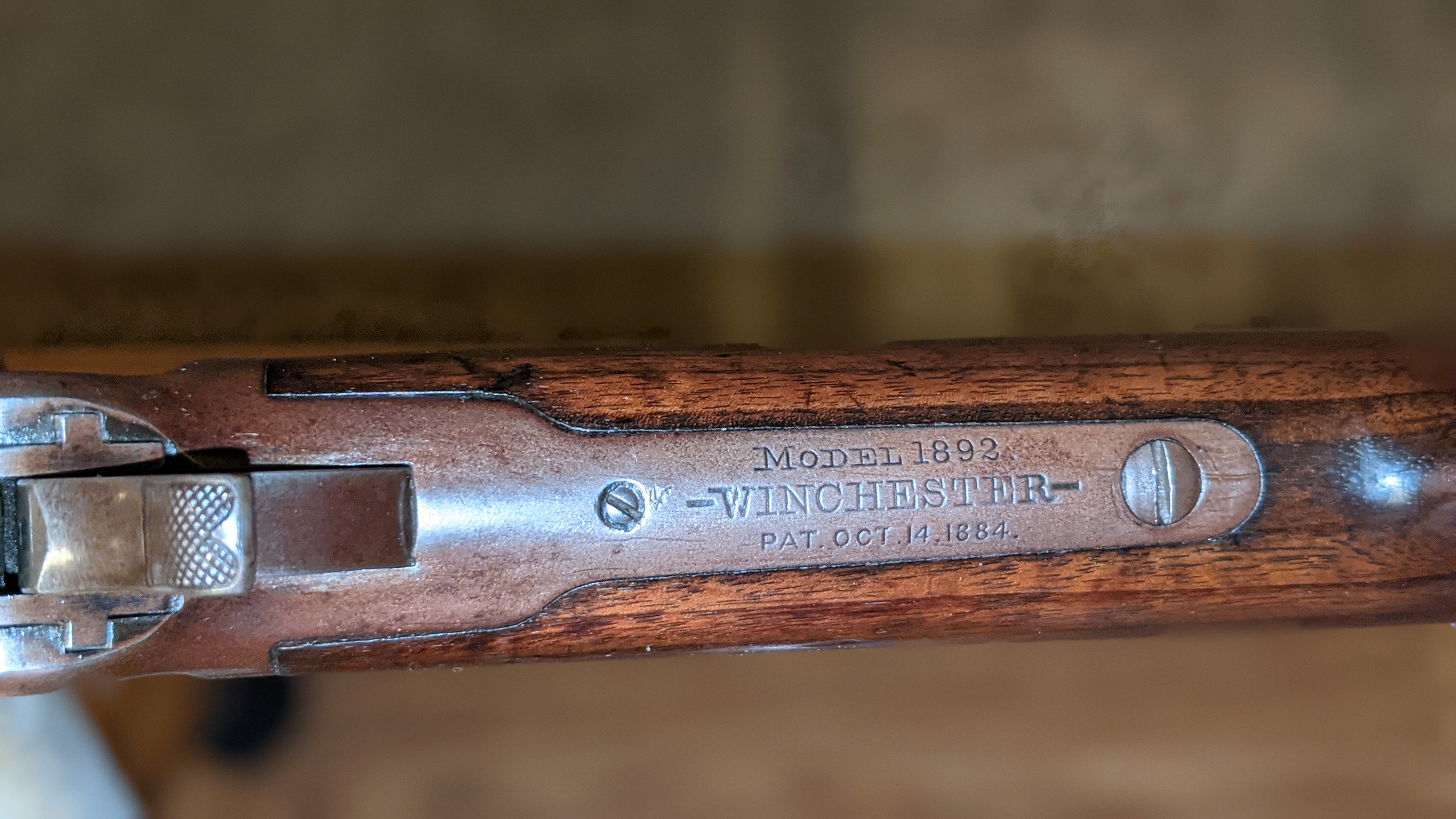

Throwing a monkey wrench in things here with my 1892, Serial Number applied July 1, 1896, in warehouse December 15 1899.  Mine has the WP hammer and is #61232

I think that’s consistent with the implications of the ledger entries and Michael’s earlier post (31). I don’t believe your 1892 was a regular production gun based on the number and type of optional features and the length of time between SNA and date received in the warehouse. I’m of the opinion that the craftsmen who built special order guns didn’t go through a lot of receivers so any given receiver might have spent a few years waiting in a tray before it was built into a gun and as has been pointed it they were not necessarily used in order of serialization. If a receiver can hang around the shop for 3-4 years before being used I see no reason why a hammer can’t do the same.

I am of the opinion that the hammer, and the internal components may have been fully assembled and THEN sat around until it was used.  I also believe that those receivers with outstanding bluing were set aside to be used on special order rifles.  It seems to be more common for those rifles with long delays between the serialization date and the time when they were actually made up into a functioning rifles and entered the warehouse are rifles that are special order and fancy guns.
