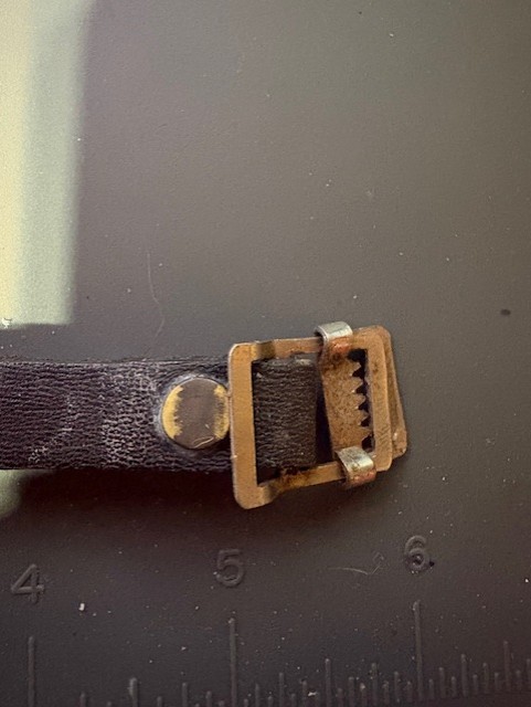

So, not to steer away from Winchester talk, but you guys are pretty knowledgeable about old stuff Wink what kind of rivet would this be called, and also, as long as I have your attention, what about that style of buckle? I need to replicate a strap like this one – unless someone has one or two to sell….

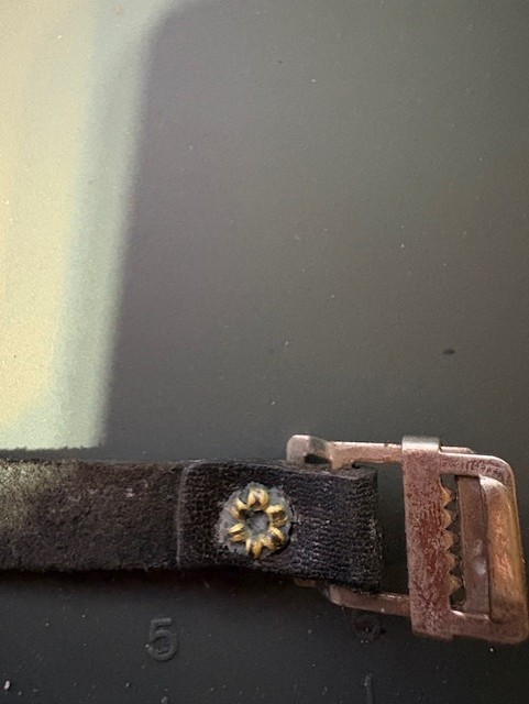

This is Rick at Old West Reproductions.  That is a tube rivet.  They come in several different lengths.  I use nickel plated and copper tube rivets, usually with a cap on the open end.  Yours was set in a rivet press using a “splash” anvil.  That creates the star pattern on the open end of the rivet.  Saddle shops, boot repair or maybe a farm and ranch supply would be a good place to look.  You can’t set them without a press, so best to locate a shop that has them and can set them for you.

What you are looking for is a “version” of a Triglide slide for leather straps.  When I say version, I can not find anything that comes close to the slide you need, as the new designs do not match the old style shown in your photo.  Tandy, Weaver, nor any of the other saddlery or leather supply houses I deal with, have anything like this.  The closest I could find is in nickel only and in 2″ only, nothing smaller.  In my opinion, this looks more like something that would be found on a purse strap.  I think I would try a hobby shop or a fabric store.  Good luck!

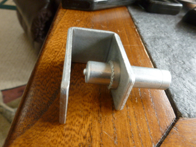

Is this the type of tool you need ? I have it in a box of clothing snaps. DonP1050042.JPG

Don, I don’t think so, unless the flat part has the “splash” pattern.

There is some sort of pattern on bottom. Don
