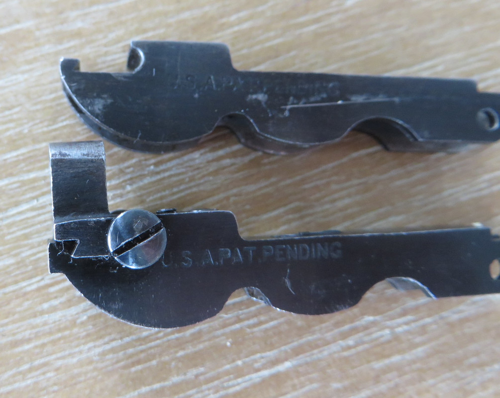

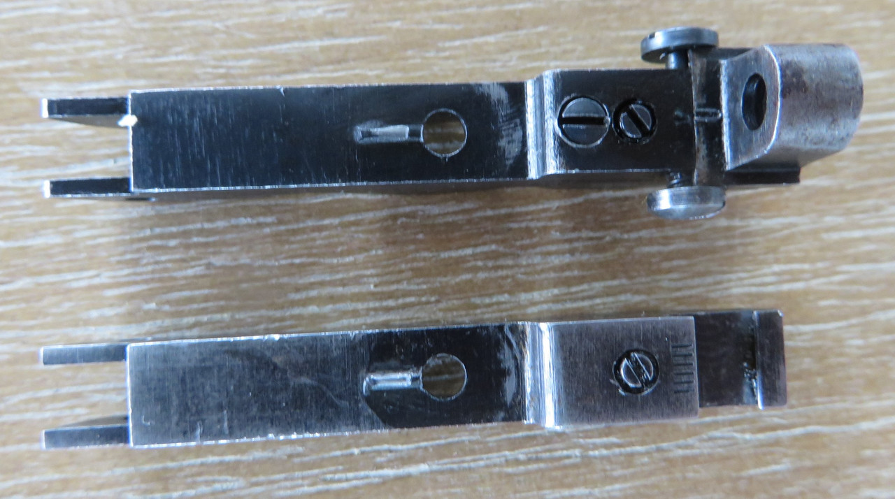

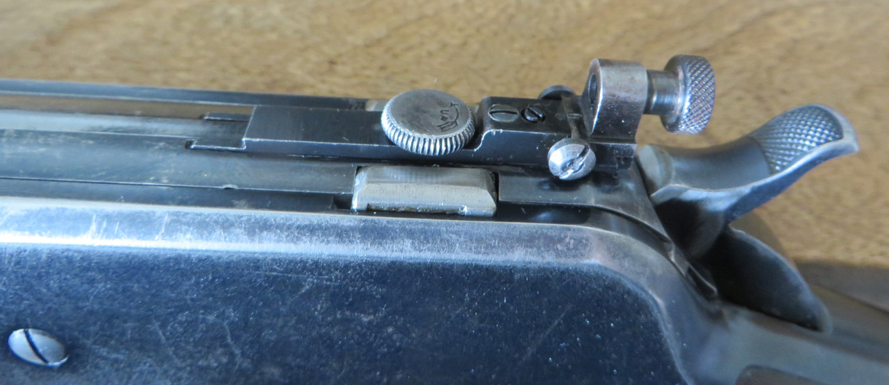

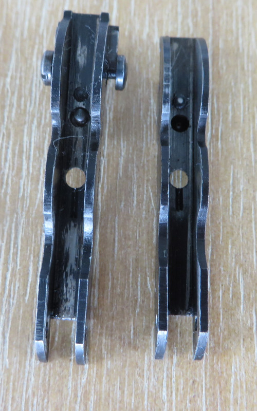

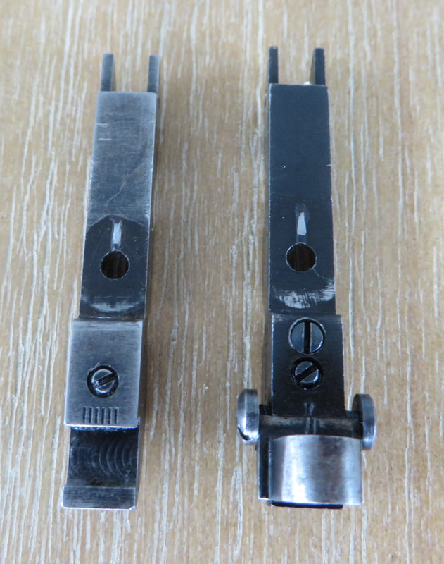

Replacement sight arrived and has been successfully installed with no issues!!
The later version sight, although a slightly different design, dropped right into the bolt.
Thought this day might never come!!
https://i.postimg.cc/B62Lcjxc/IMG-0766.jpg
https://i.postimg.cc/QCsB6jmL/IMG-0767.jpg
https://i.postimg.cc/vTz4kC24/IMG-0768.jpg
https://i.postimg.cc/66L48G6B/IMG-0769.jpg
https://i.postimg.cc/xTfJMTqM/IMG-0770.jpg
https://i.postimg.cc/7YKCV8Tc/IMG-0771.jpg

My installation went very smoothly and I have shot the gun with the new sight.
I just need to find the correct height front sight blade as the one that was on it is a bit short.
I did not have to remove the bolt, as the nut that the elevation screw fits into was still in place.
I’ll see if I can find that instruction but it does not tell deal with removal of the bolt.
Tom
Tom Graham
rogertherelic
Santa Clara, CA
Forum Posts: 990
January 27, 1992
March 17, 2024 - 8:58 pm
I believe the rear screw on the top of the peep sight is to stop the sight from being lowered past a previously set “zero”.  It is possible that it may be backed out to allow the sight to be lowered a little to correct your problem.  This screw acts as a way to quickley return the sight to a previous “zero” for height, if you have raised the sight for a long shot. RDB
