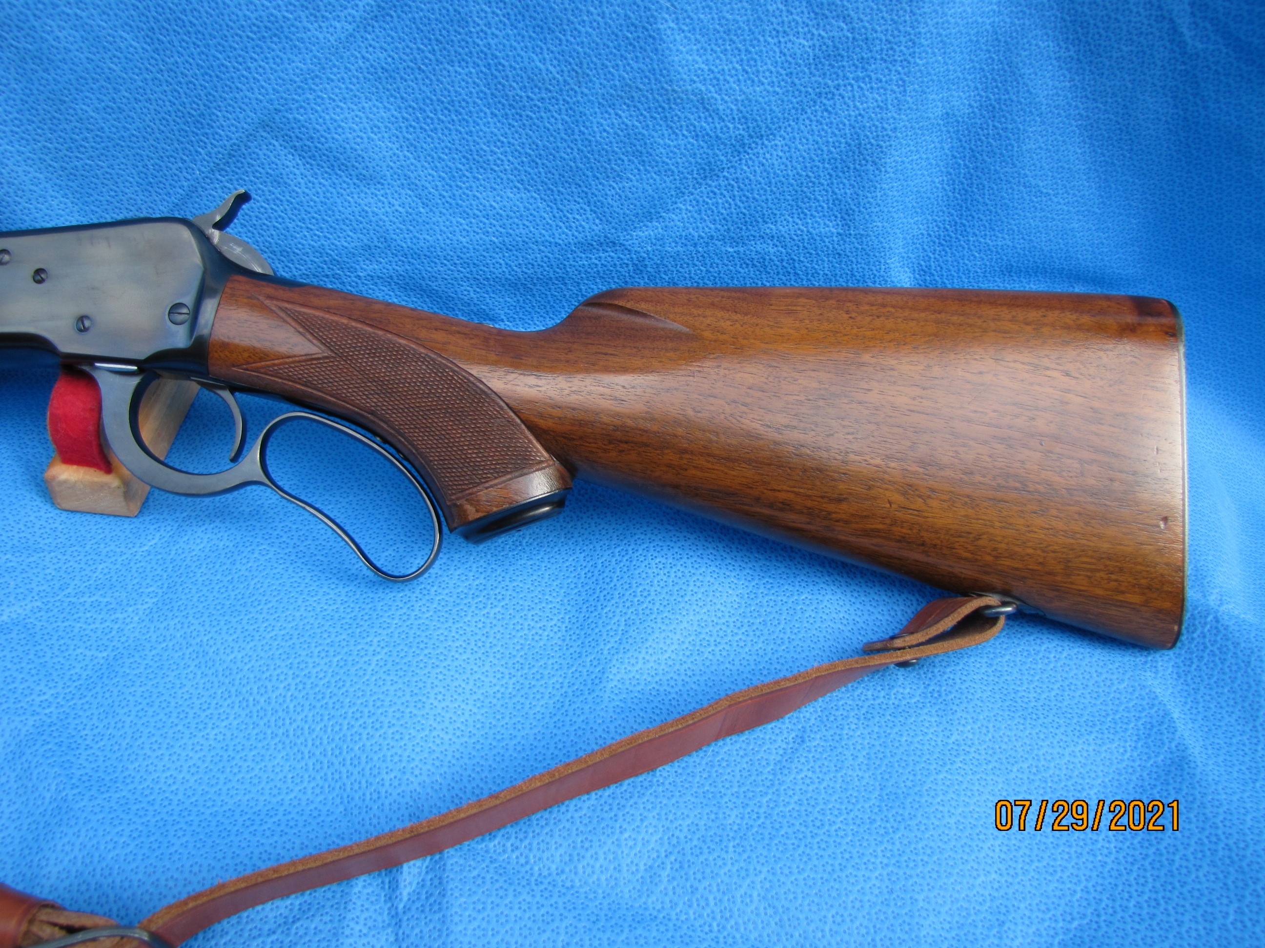

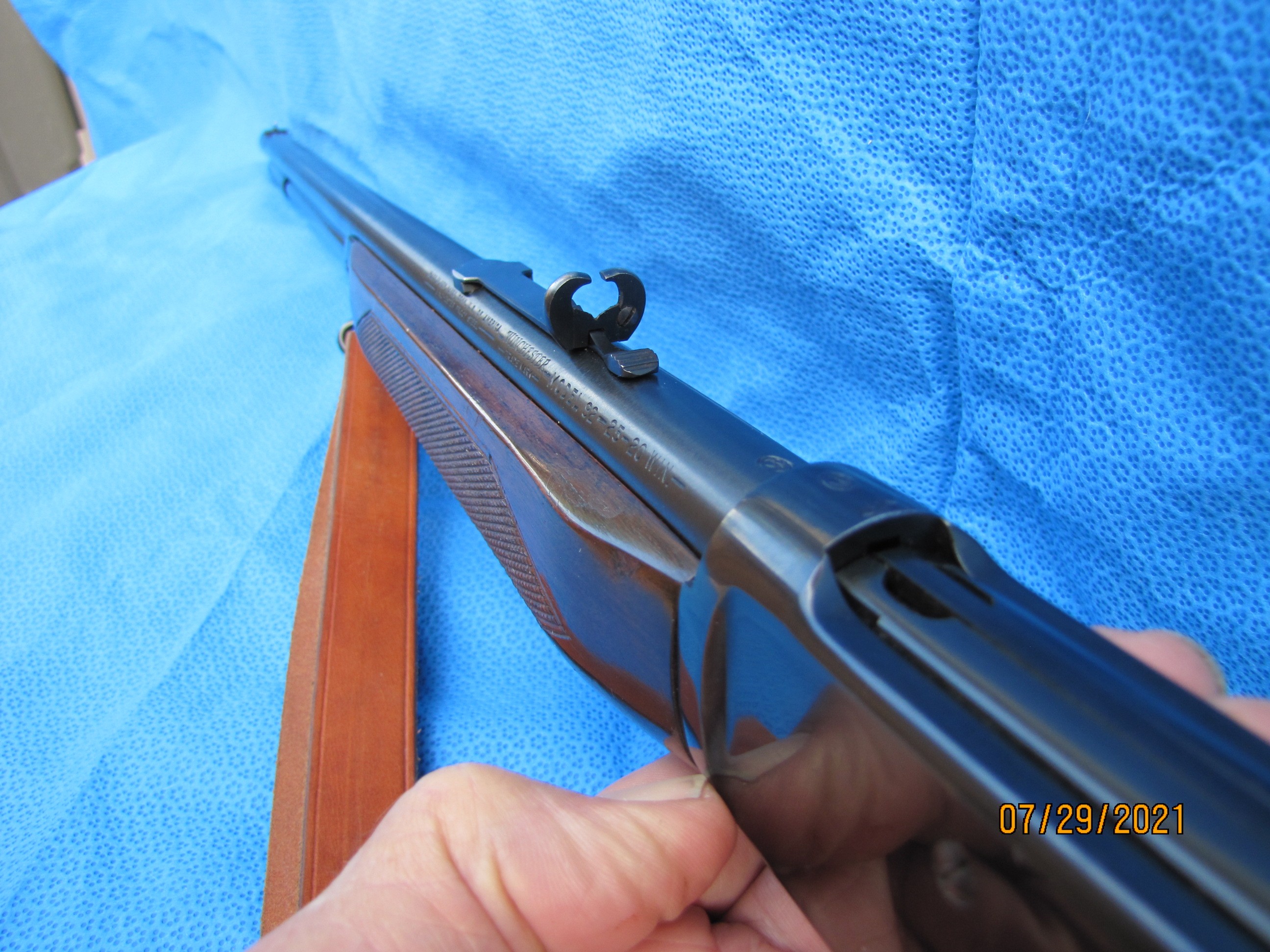

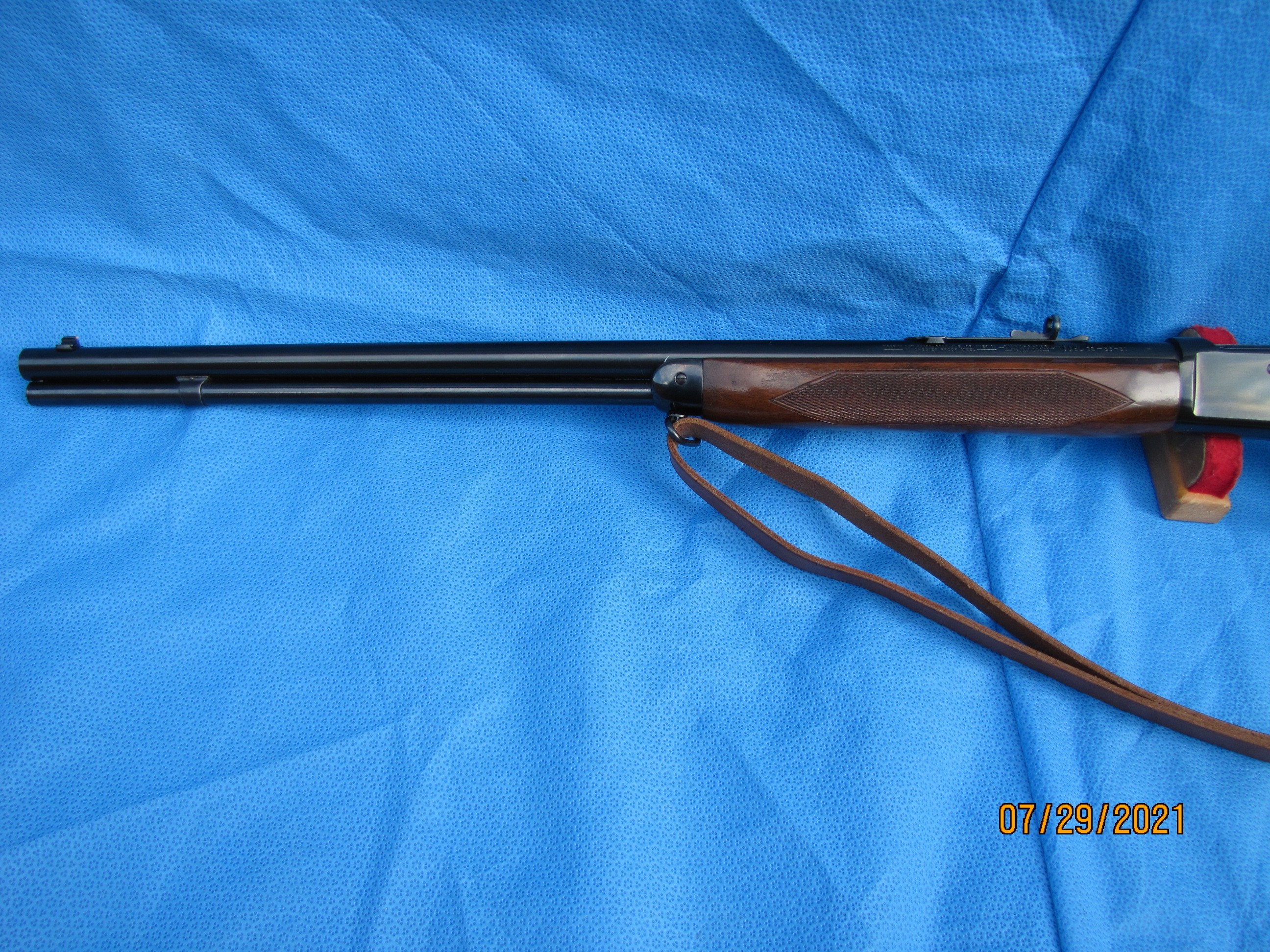

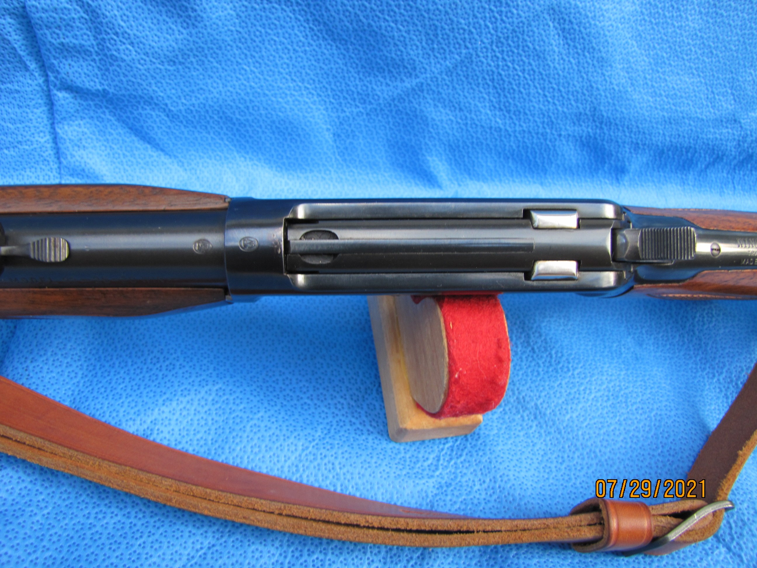

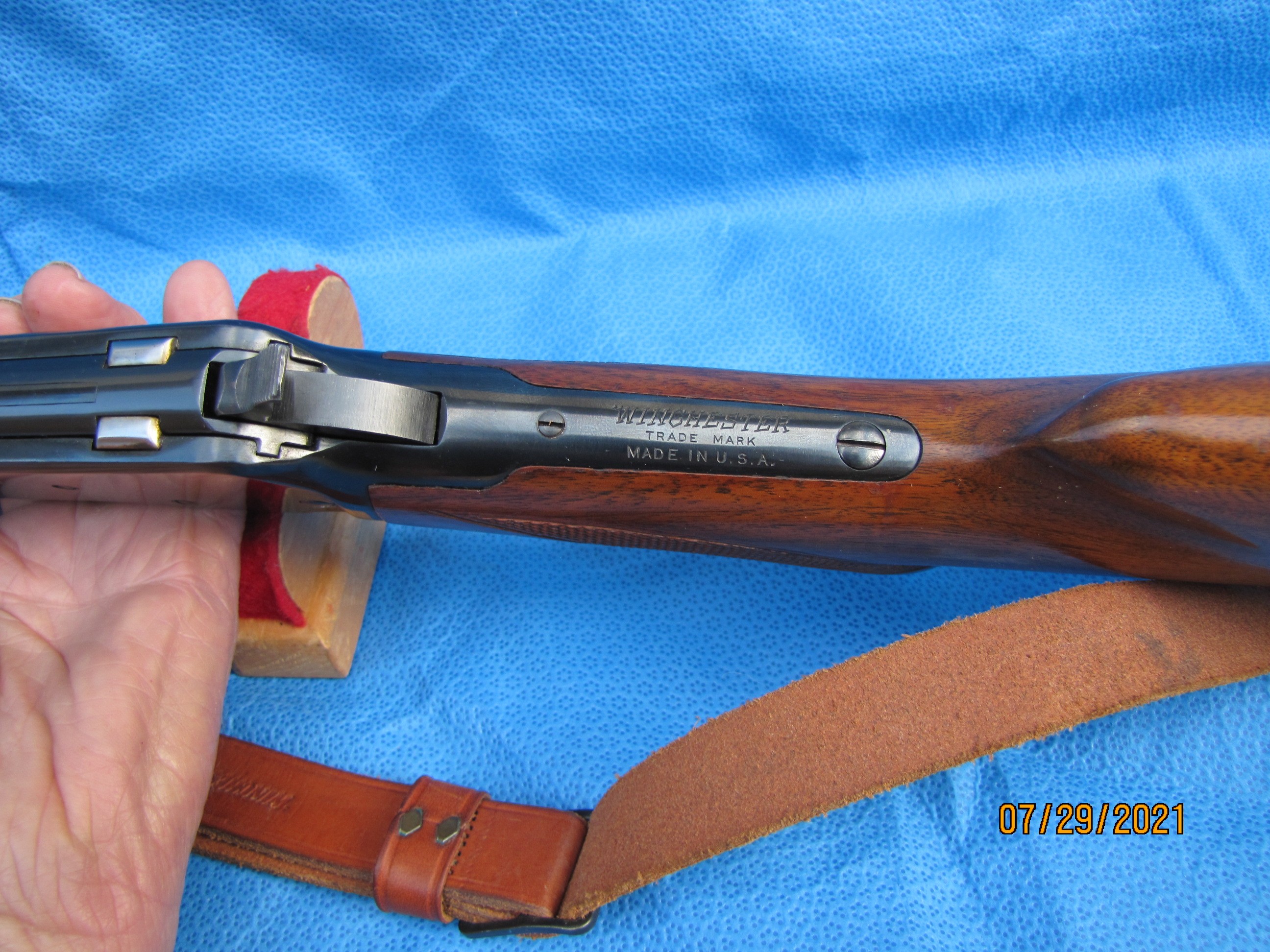

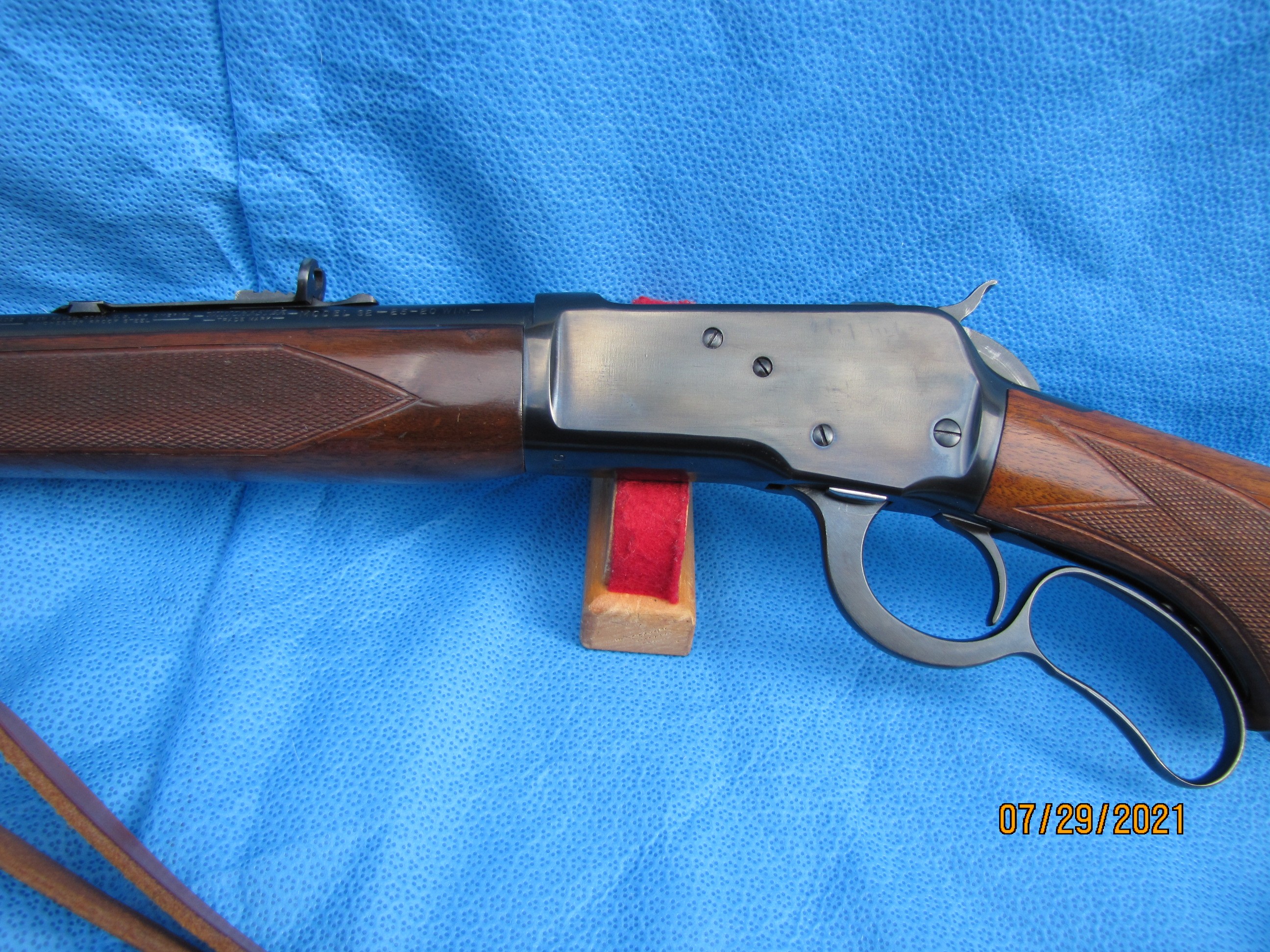

 I have a similar ’92 rifle, that I purchased from Edward Ulrich, several years ago.  Mr. Ulrich had worked as a “Winchester Rep” back in the 1950s.  He claimed that the parts department had discovered “enough left over parts” to assemble a few rifles.  These were offered for sale to Winchester employees in the on site “WINCHESTER STORE”.  I believed him and purchased the rifle, which appears unfired.  I either, got fooled or I did good.   RDB
Serial #1006356

Roger,
The barrel on your Model 92 is identical to those used on the Model 43 bolt-action rifles.  I highly suspect that it has a “48” date stamped on the underside of the barrel.
Winchester assembled a very small number of late production Model 92 rifles with remarked 24″ Model 43 218 Bee barrels, so it makes sense that they did the same with a few of the leftover 25-20 WIN M43 barrels.

Well, I an learning to be more observant. Thank you for that!  I owe that to your prompting and comments.  I decided to view all the screws with a lighted magnifing glass.  There isn’t one screw slot that doesn’t show having been turned!  Also the magazine tube has a hairline split where the magazine plug screw goes through.  The wood is proud and I can find no negatives there.  I am pleased that it has the proper serrated hammer configuration.  I hate discovering  my past mistakes so late in life.  I still love my Winchesters!!!  Embarassed RDB

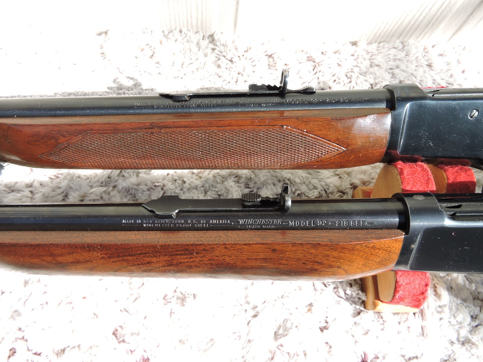

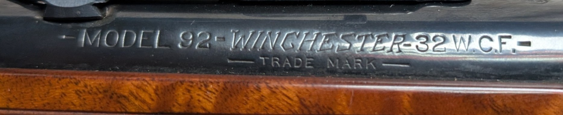

Bert,  For the most part, the finish is in really great condition.  I hate to take the chance of causing any scratches removing the magazine and fore end to check the date.  I do see the similar barrel markings on my 218 Bee Model 92.  I will see if I can get a good clear picture of the two barrel addresses side by side. Thanks for your information.   RDB
rogertherelic
Santa Clara, CA
Forum Posts: 988
January 27, 1992
August 8, 2025 - 4:28 pm

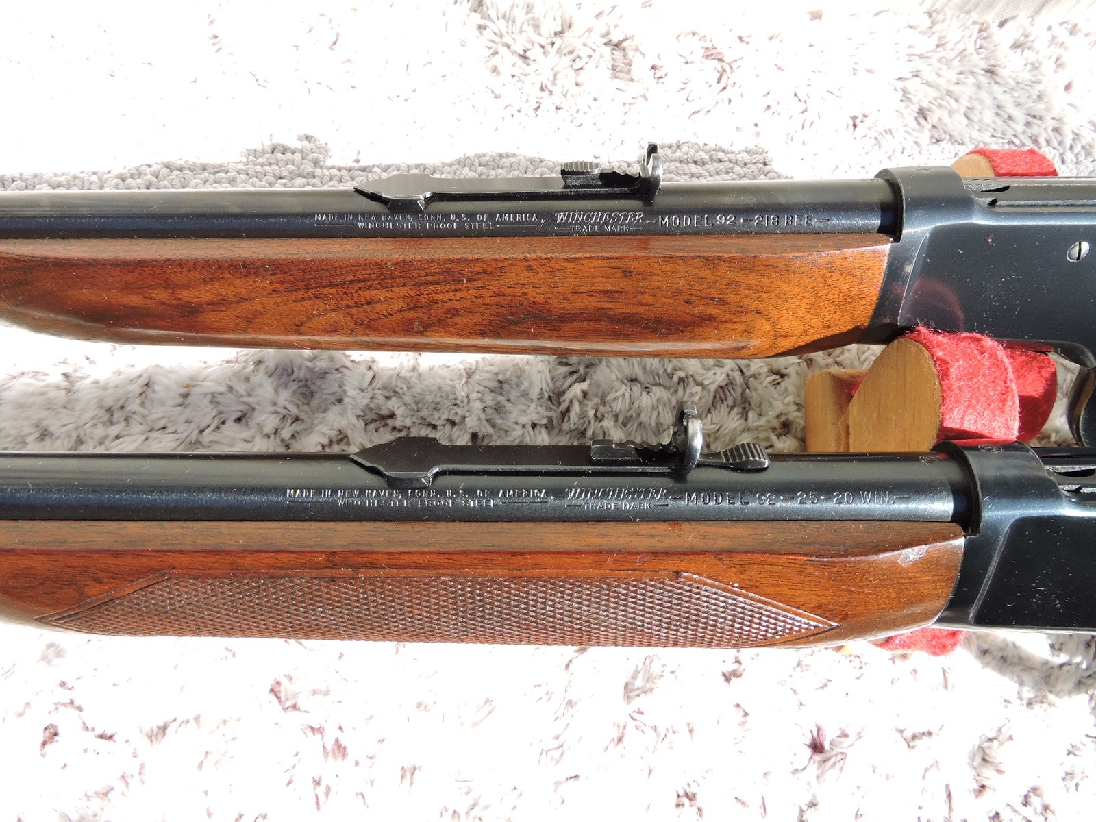

A comparison of the barrel stamps.
Forum Posts: 14839
August 8, 2025 - 6:05 pm

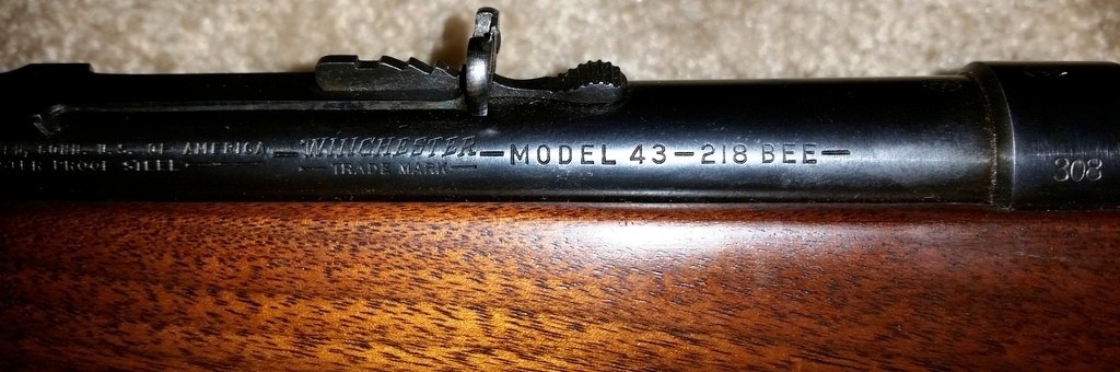

Both of them have the Model 43 style barrel marking.

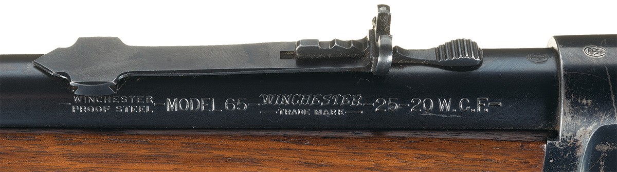

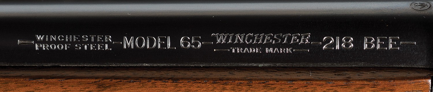

The Model 65 barrel markings look like this…

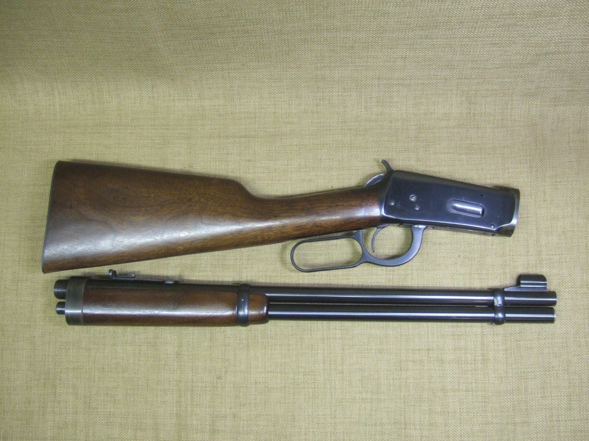

This is a late production Model 92 (s/n 997087) barrel marking…

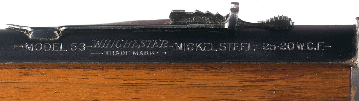

This is a Model 53 barrel marking…

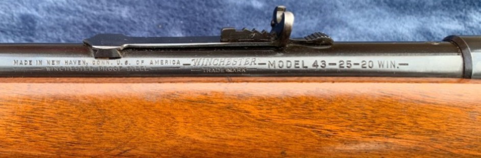

These are Model 43 barrel markings…
