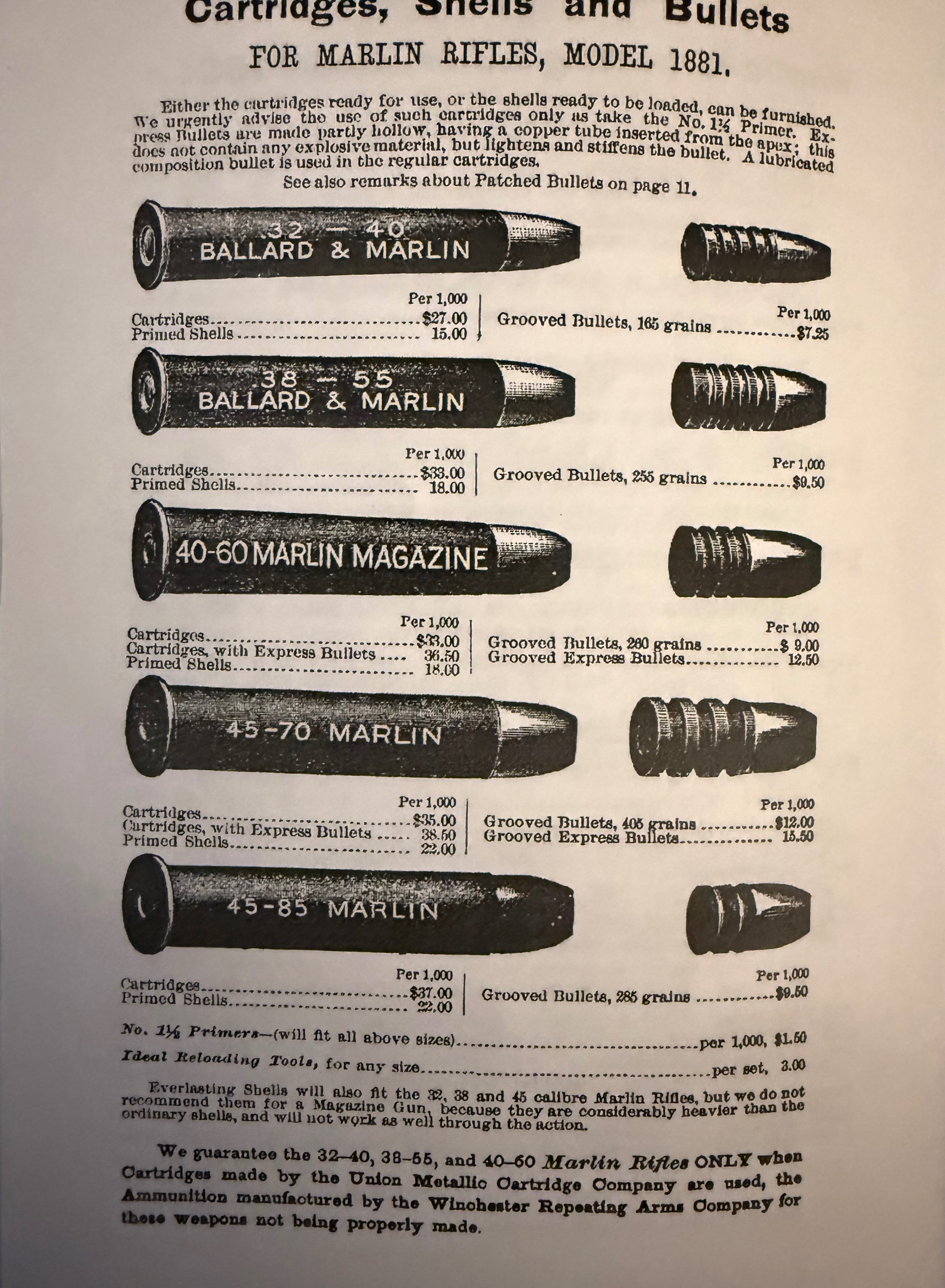

It was a cartridge listed for the Marlin models 1881 and 1895, it was a 285gr loading for 45-70, I’m guessing a express cartridge with light bullet
1888 catalog for the 1881 and also listed later for 1895

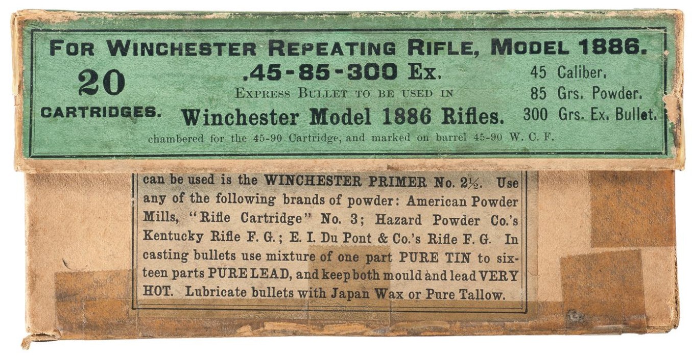

This cartridge is for the Marlin, Ballard and Colt Lightning rifles.   The Winchester 45-85 is marked WCF and is the same length as the 45-90.  This cartridge manufactured by Winchester is NOT marked WCF and is the same length as the 45-70.  I would love to find a box for the Colt Lightning made by Winchester.
oldcrankyyankee
Forum Posts: 1167
March 21, 2025 - 11:41 pm
I would just like a box like Mav has shown! It would go well with the 45-90 stuff I have.

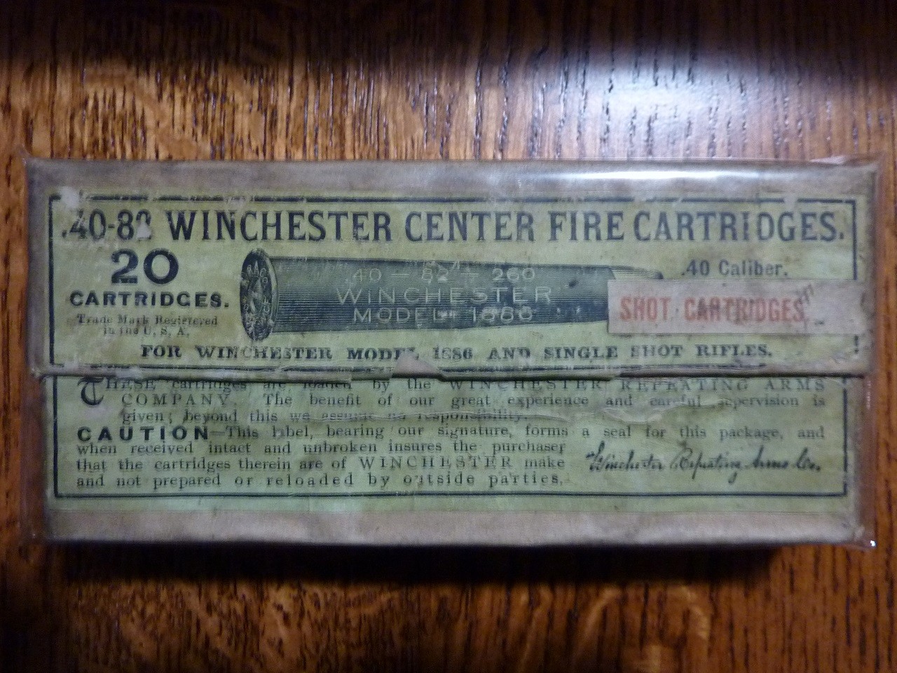

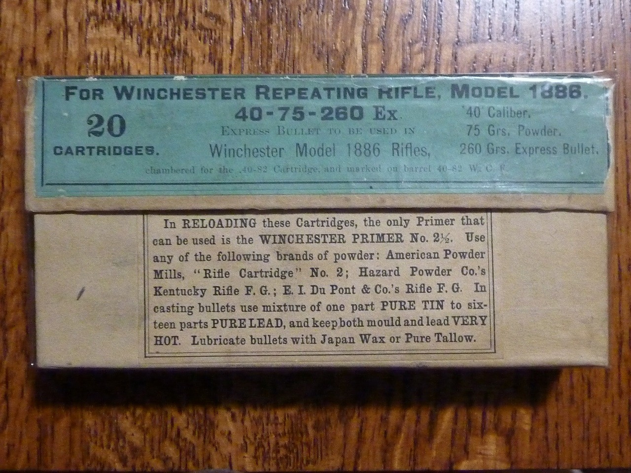

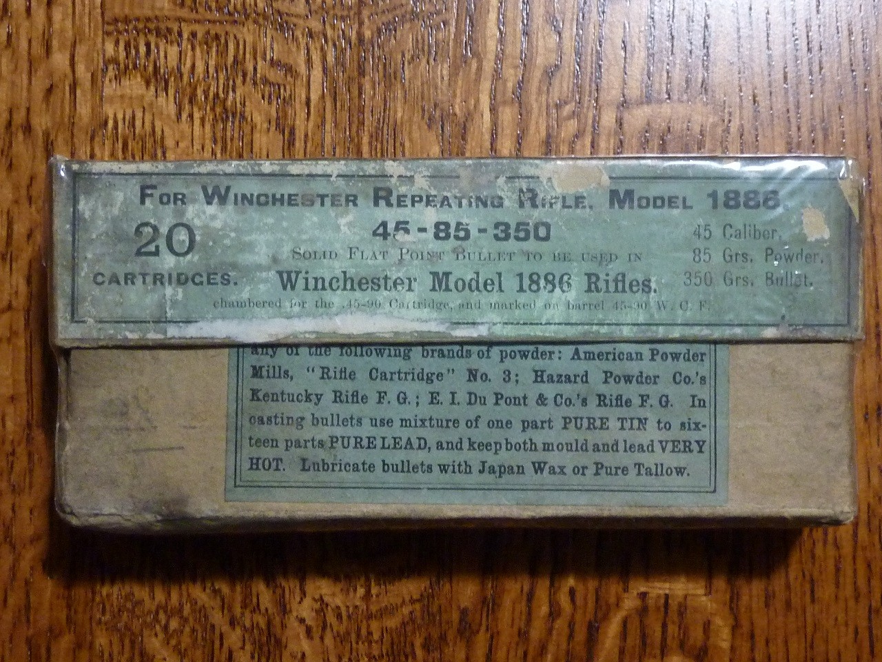

Here’s another variant (45-85-350) for the model 1886 chambered in 45-90 from my collection, along with a couple unusual boxes for the 40-82.
