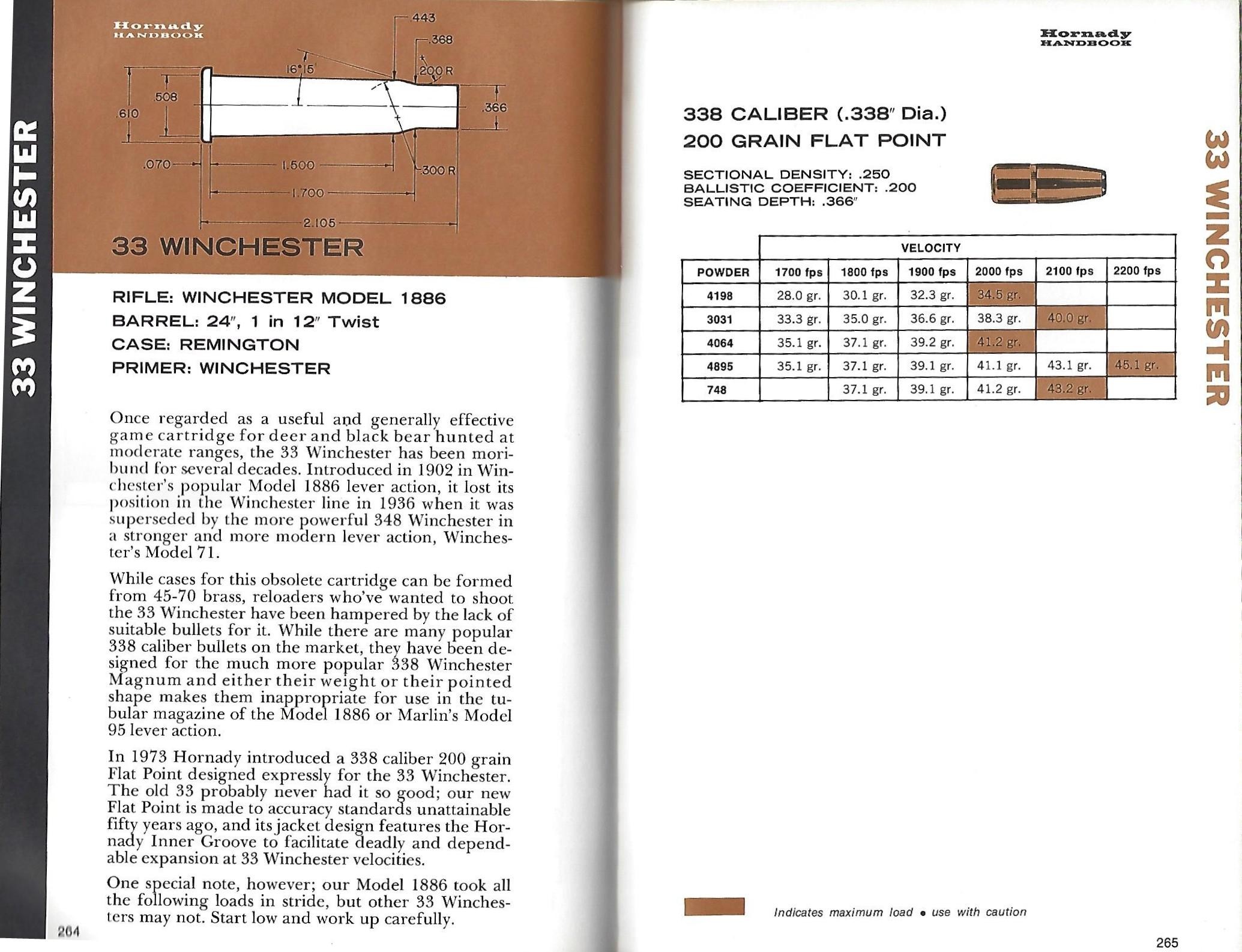

This is a scanned copy of my old Hornaday Reloading manual…
Forum Posts: 1149
August 25, 2025 - 10:16 am
Bert, your old Hornady manual is older than mine, but the data is the same.  Always good to have old manuals.  Tim

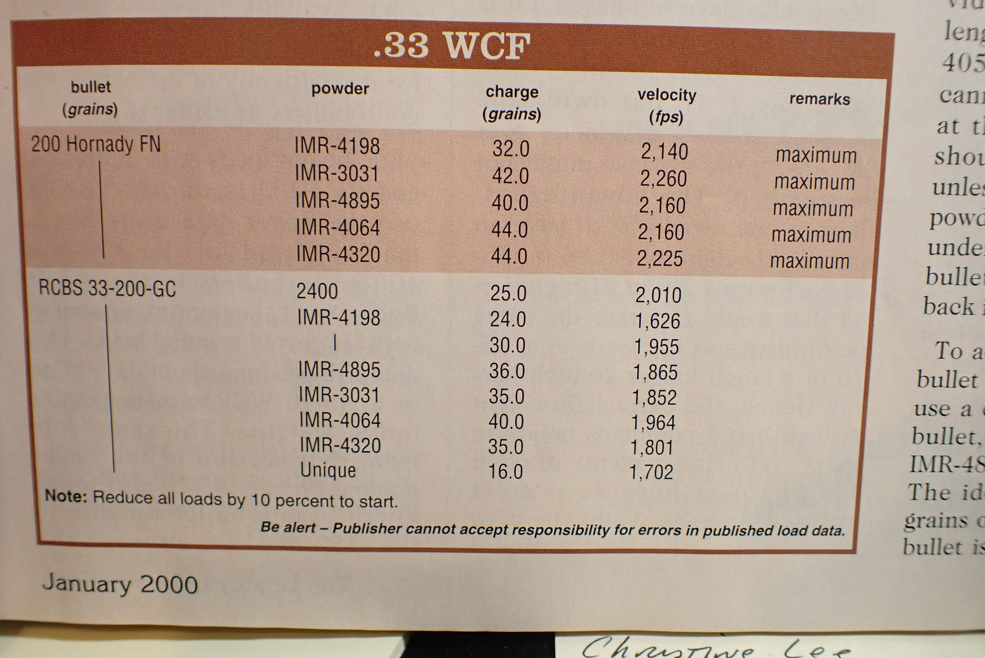

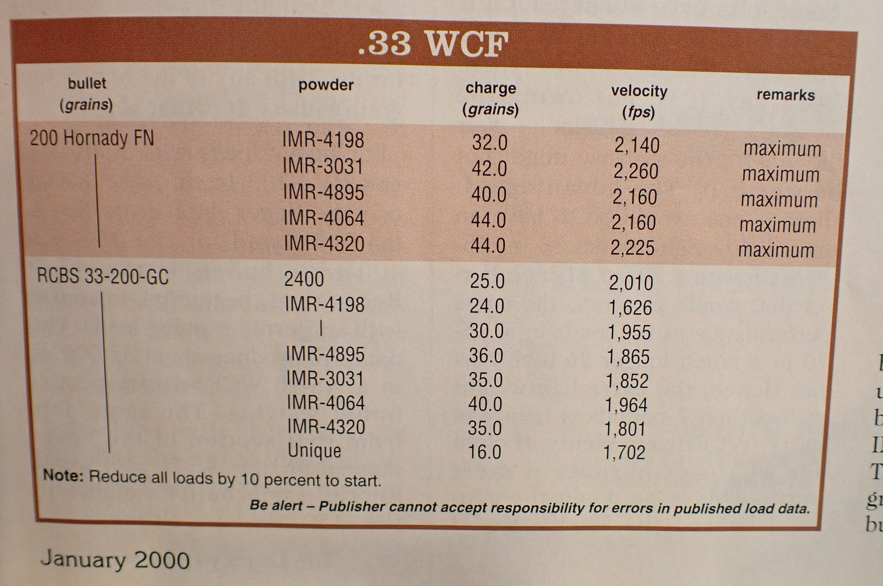

August 25, 2025 - 2:00 pm
I dont have a 33WCF, nor have I loaded for one, but I came across this magazine years ago, had some good info, maybe its useful for someone.
Forum Posts: 5891
August 25, 2025 - 3:53 pm
Chris –
Thanks for the above.  I’ll print it out and add it to my .33 loads reference file.
