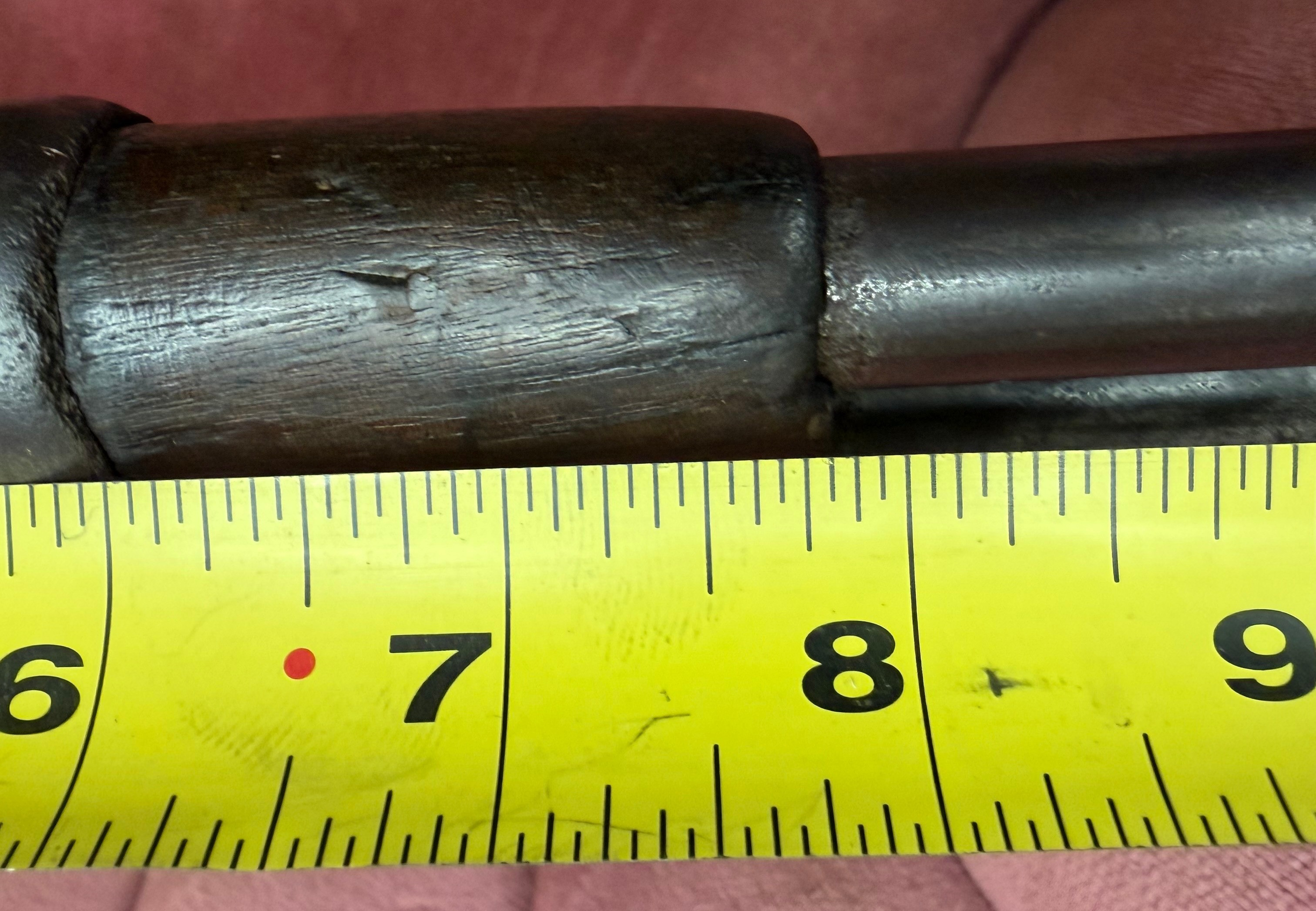

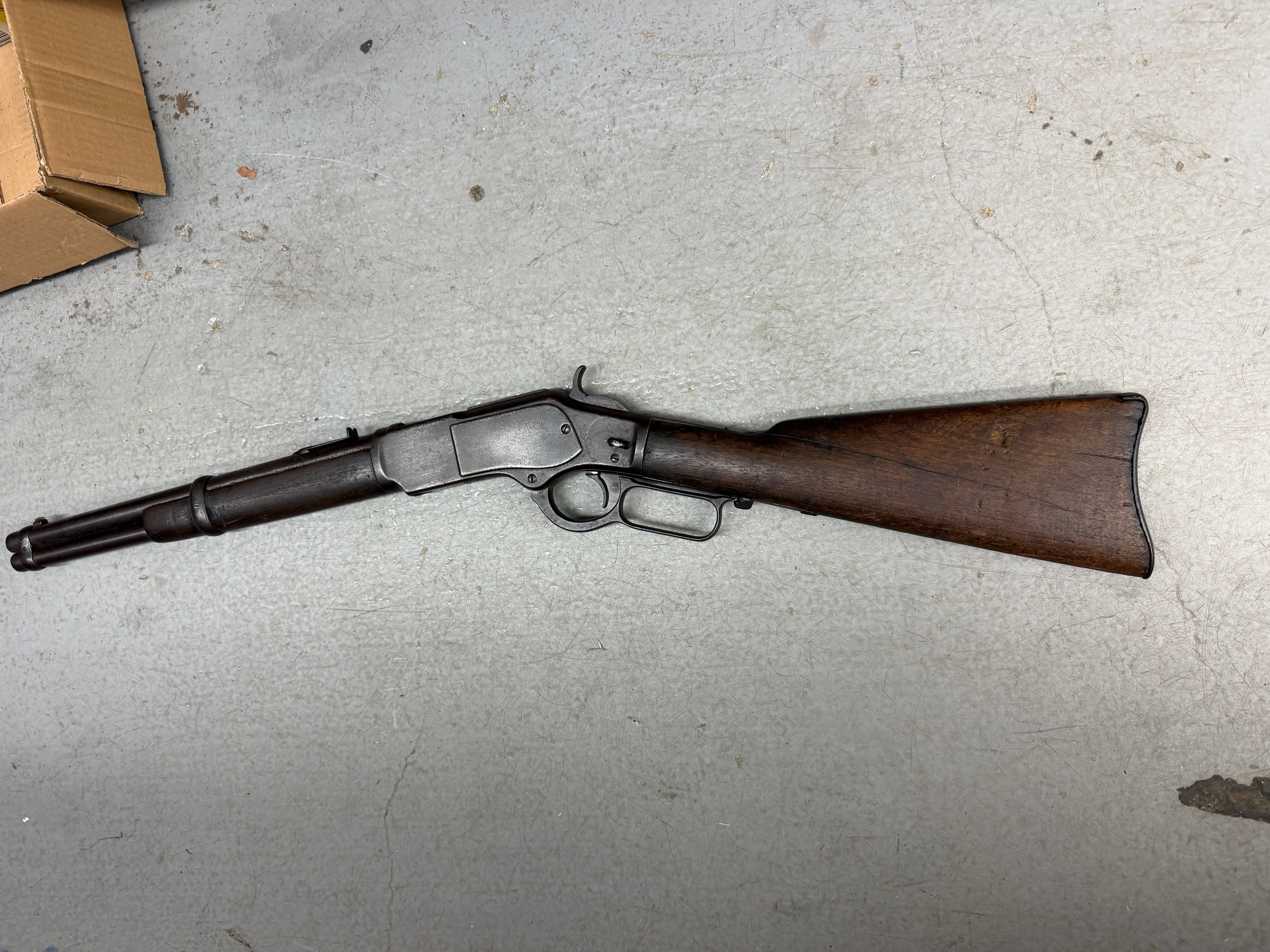

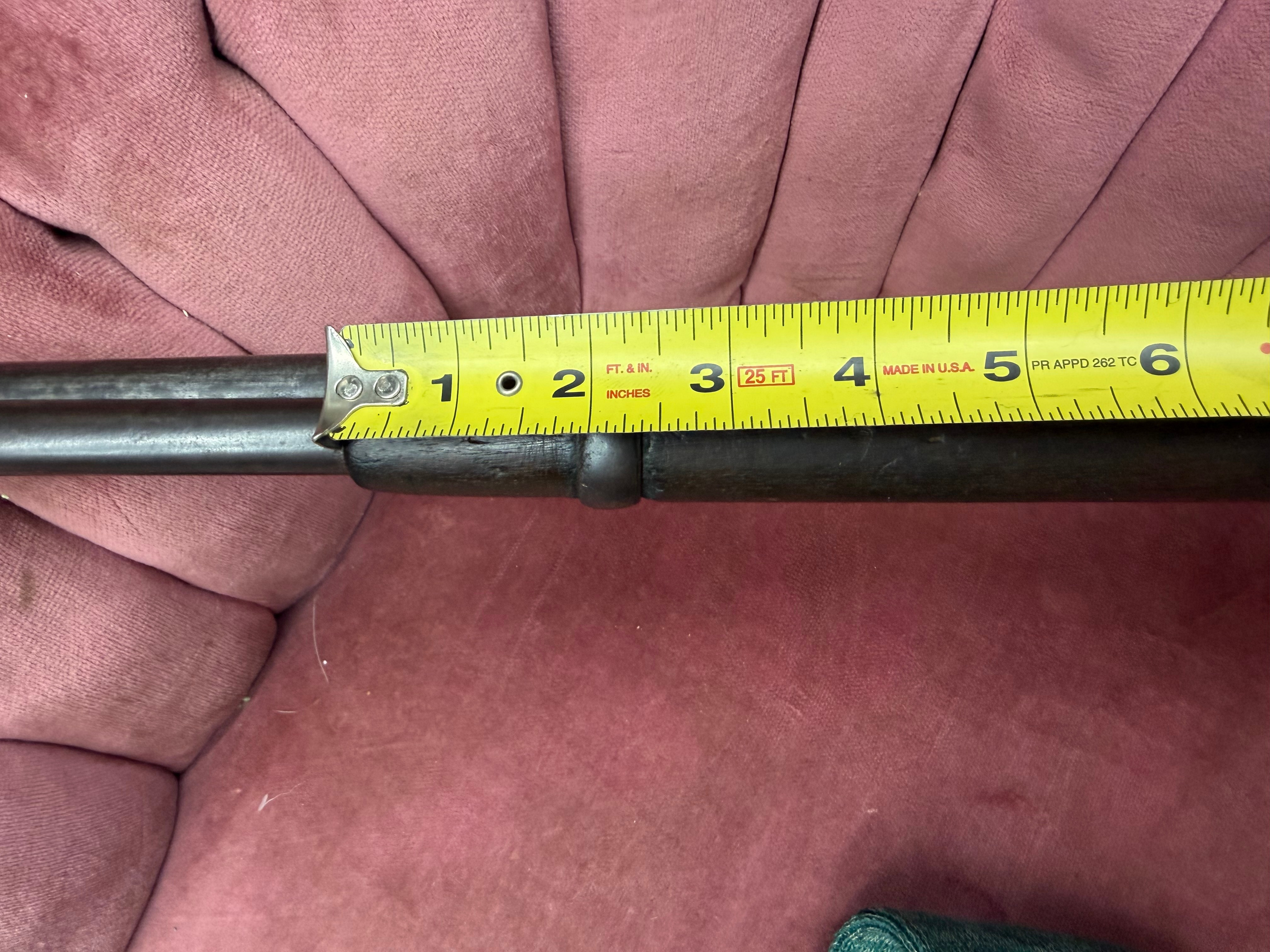

First thing you need to do is get the Cody information on it to make sure it was made with the short barrel. The 7 7/8″ forearm would be right for it and 1/16″ short is no issue. Wood does shrink and can wear. If your having issues posting pictures you can email them to me at the below address. Also send me the complete serial number and I can check it.

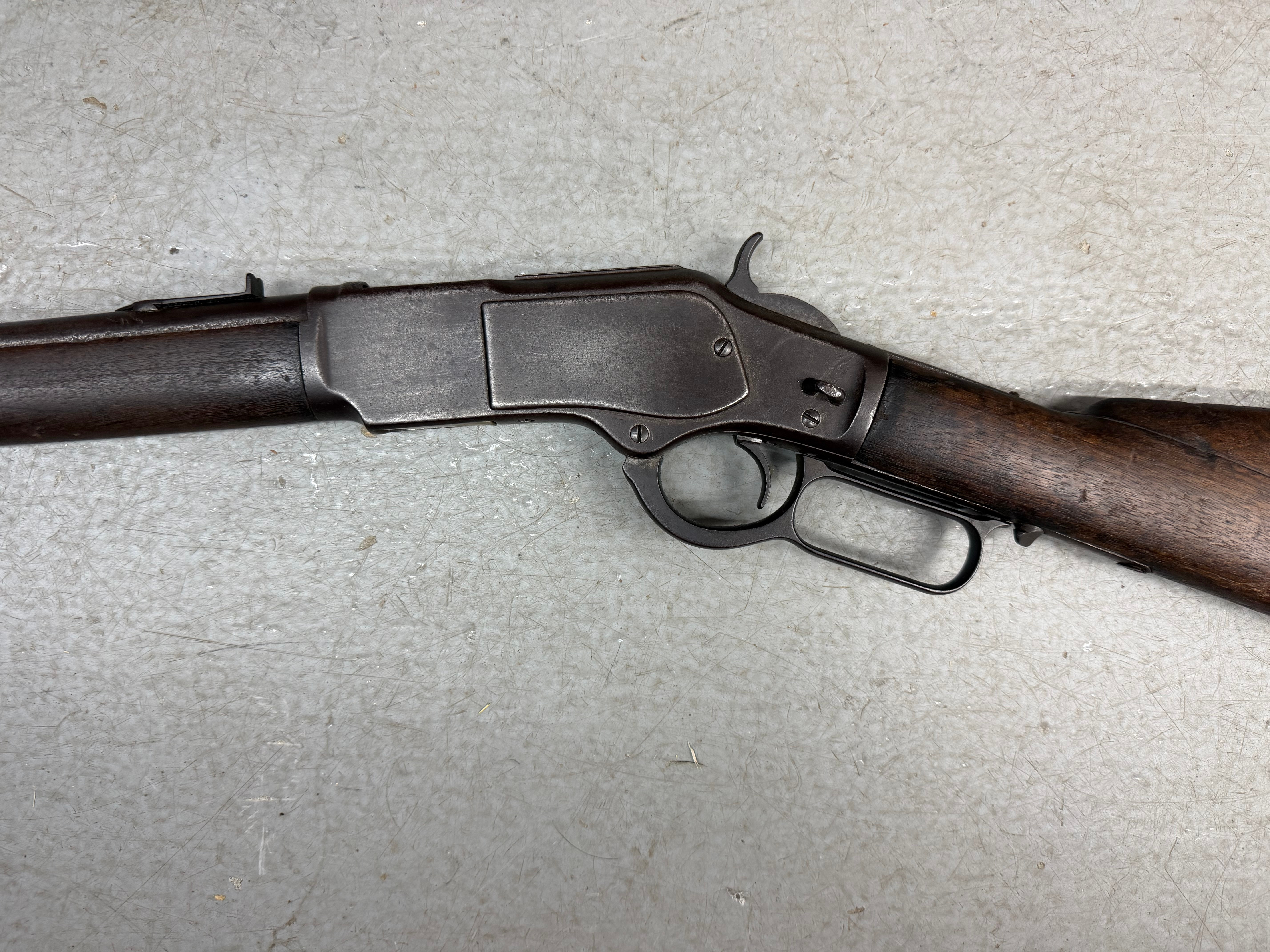

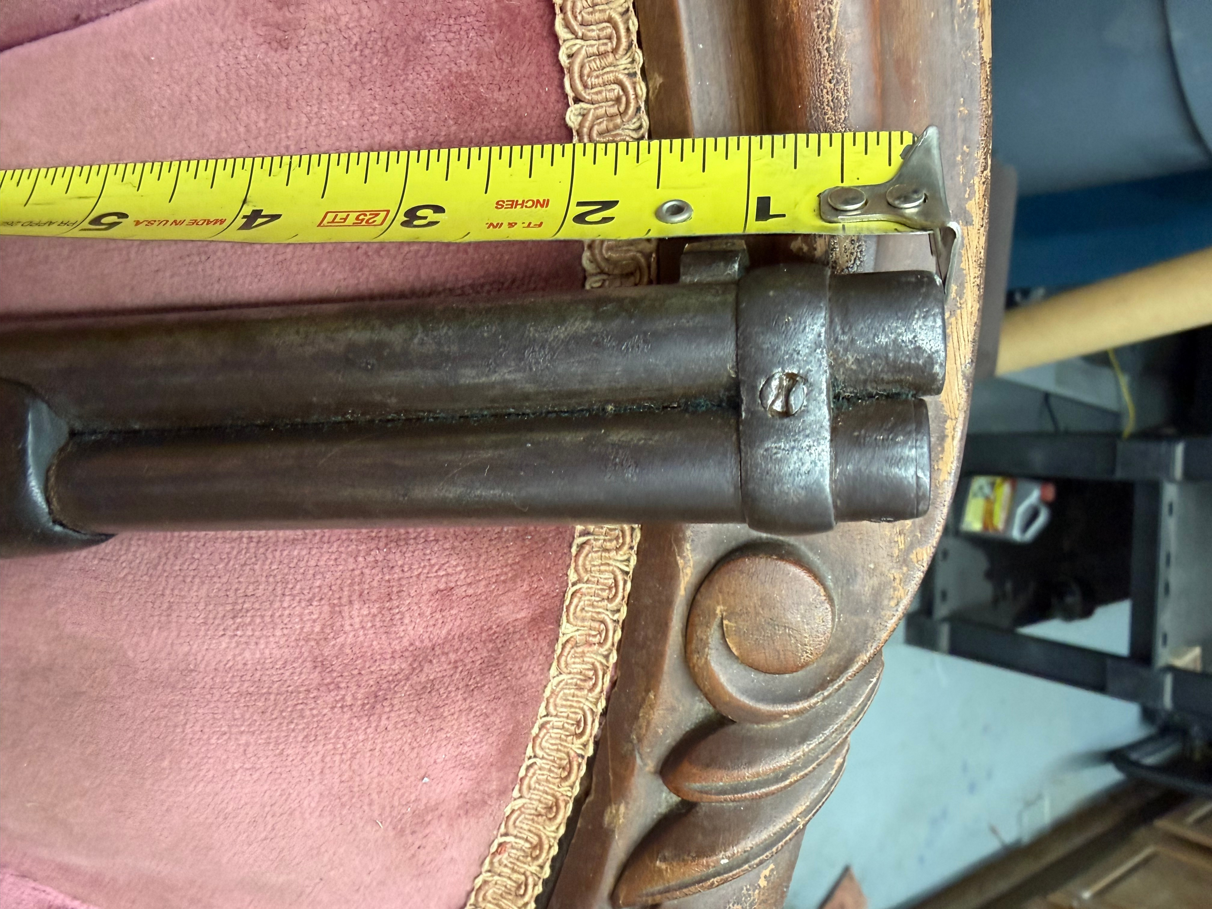

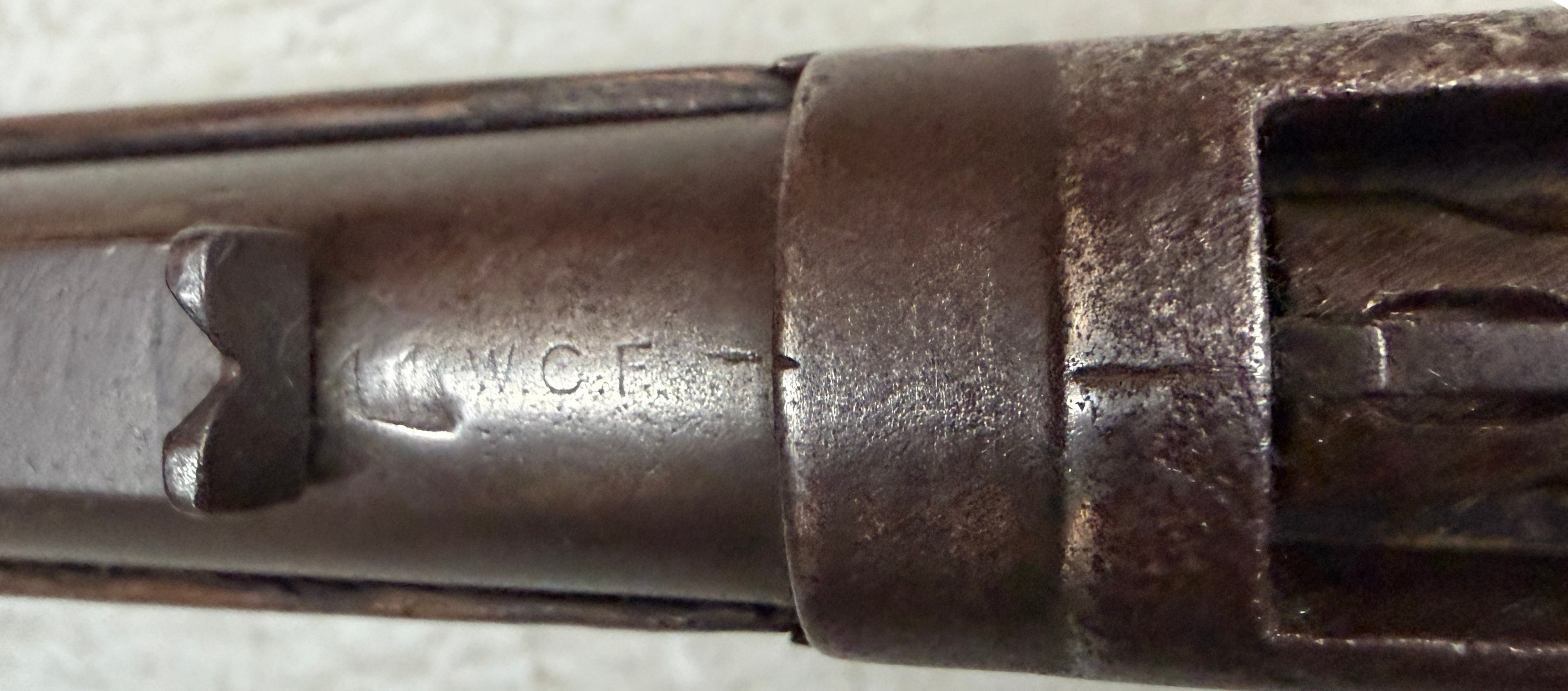

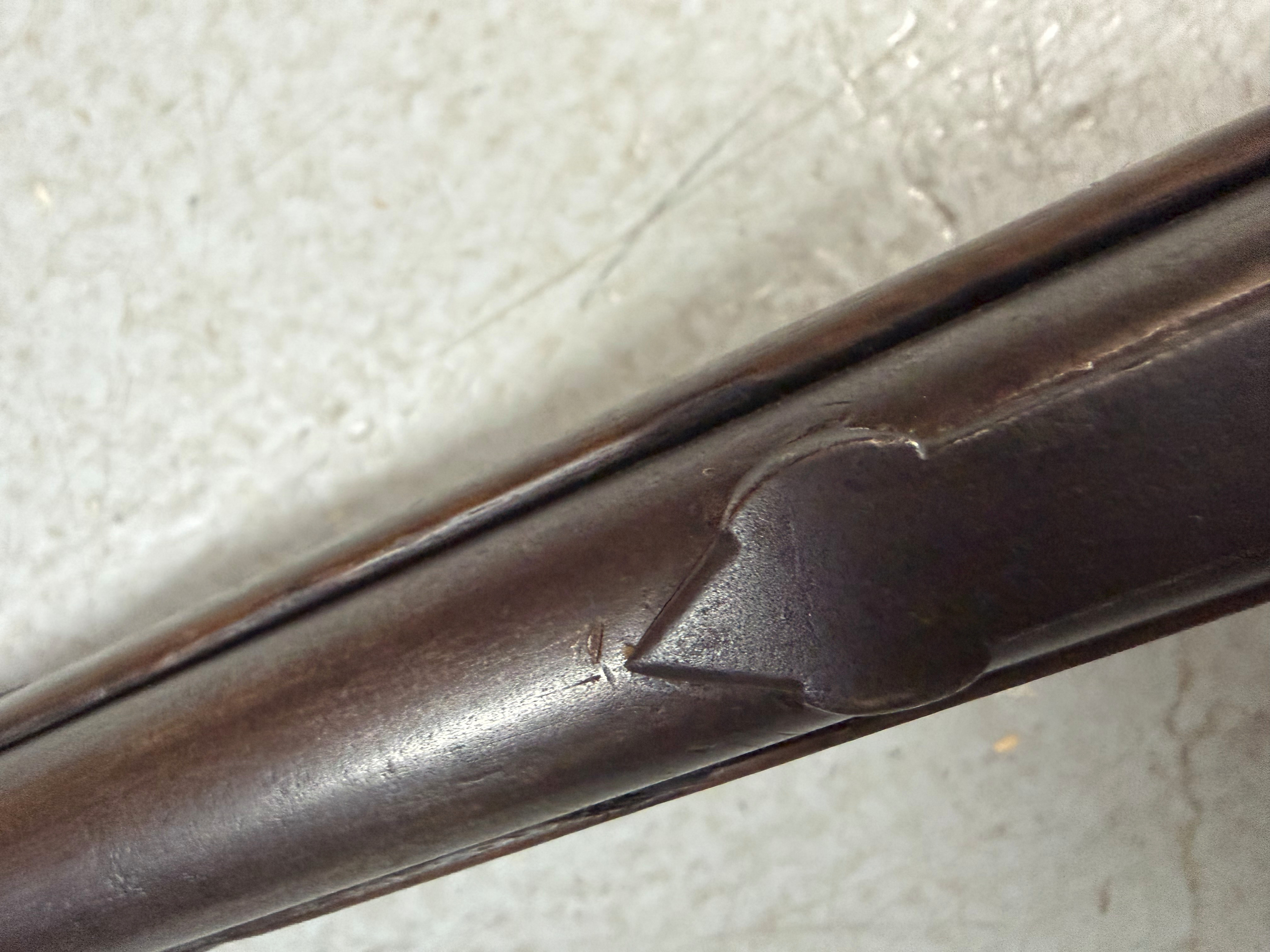

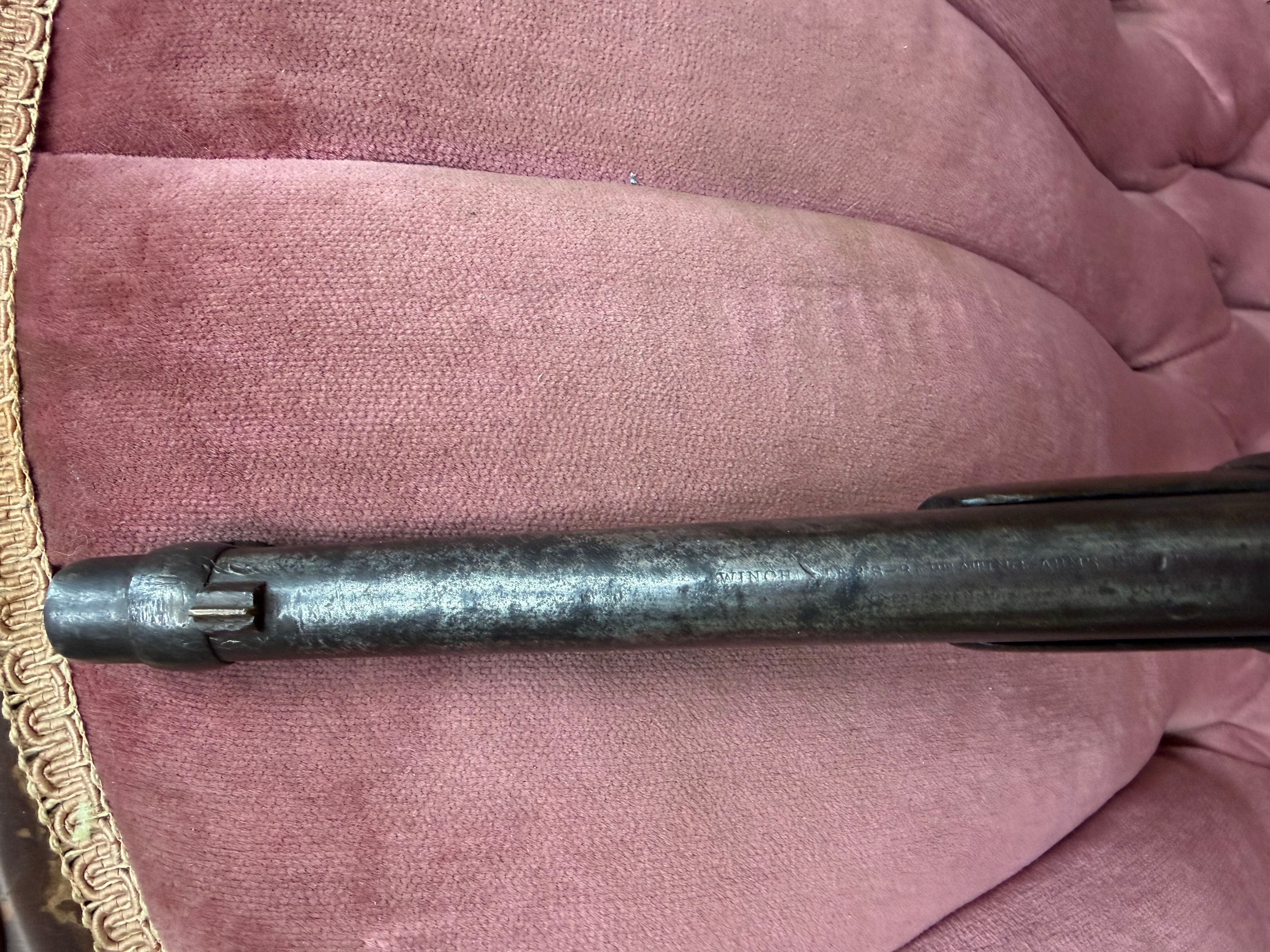

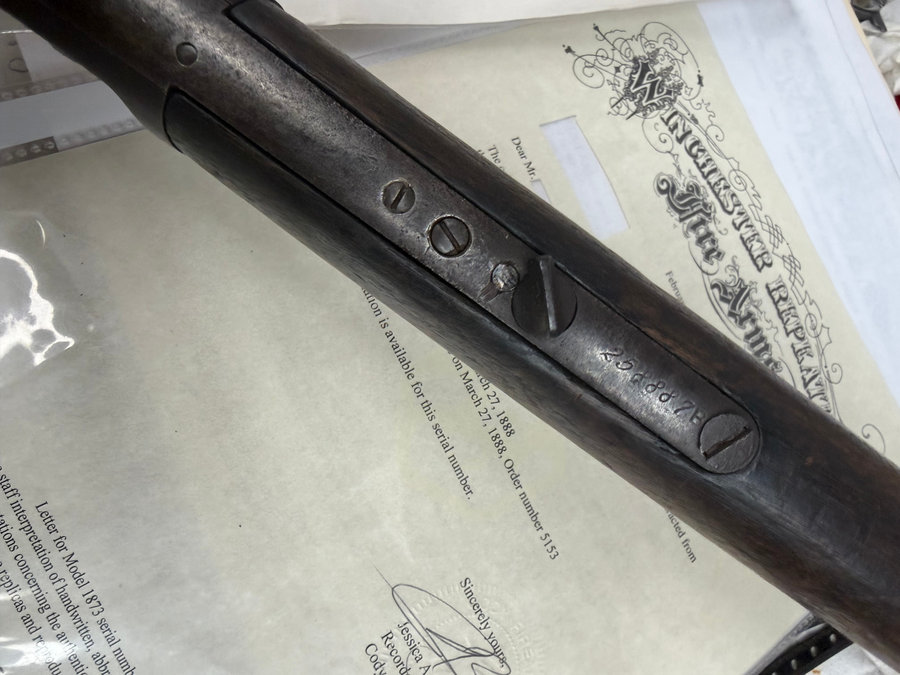

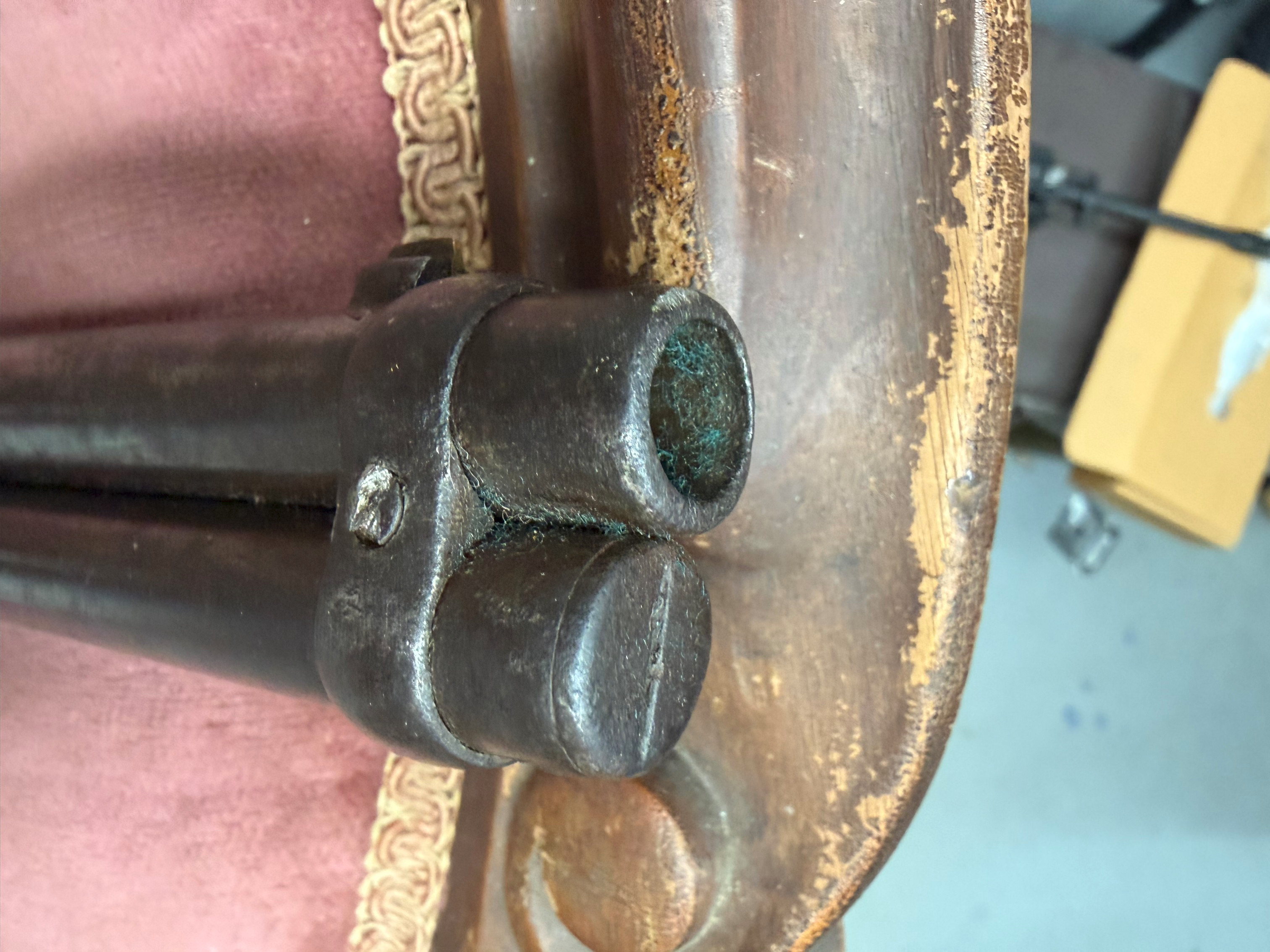

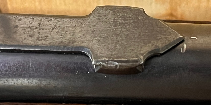

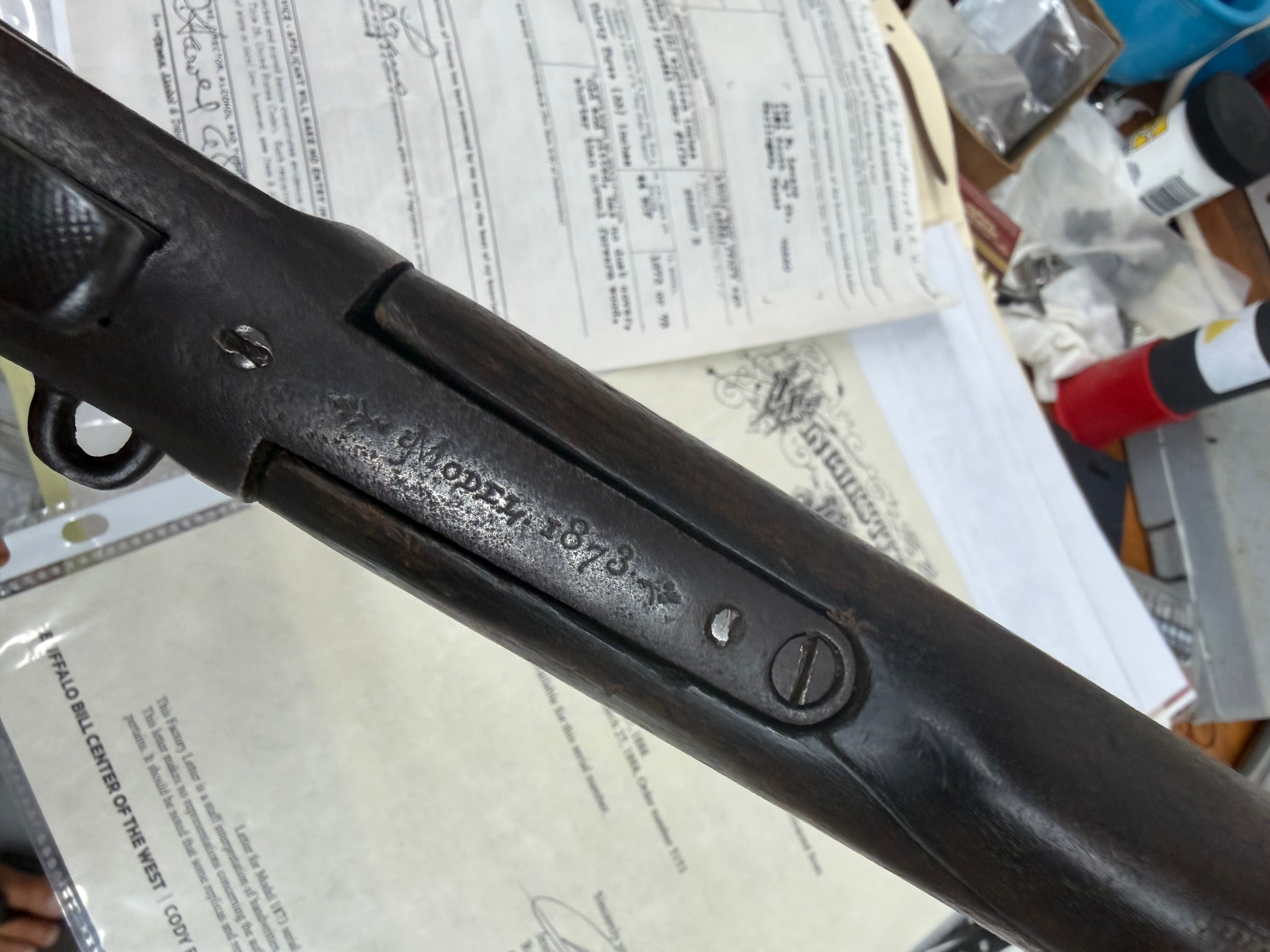

Here are the pictures. One thing caught my eye is the indexing mark on the top of the barrel and the receiver. The only reason for that is if you took the barrel off.

I notice the stepped down portion on front of the receiver as typically found on all calibers except 44-40.
Darrin
Forum Posts: 4995
July 9, 2026 - 12:47 am
On the short barreled guns they used the stepped receiver on the later models. They figured the short barrel put less stress on the threaded area of the receiver and they could lighten the gun.

That’s an interesting fact Bob.
1873man said,
Bob,
The indexing mark is off a little slightly, but not enough for me to notice, until you mentioned it. You’re experienced eye with the M-1873, and you’re experience is second to none, certainly made me take notice of this fact also. With that fact, it makes me wonder about this one for sure. It would be nice to se a few more round barrel trappers, in the 14 inch barrel, to compare this mark to.

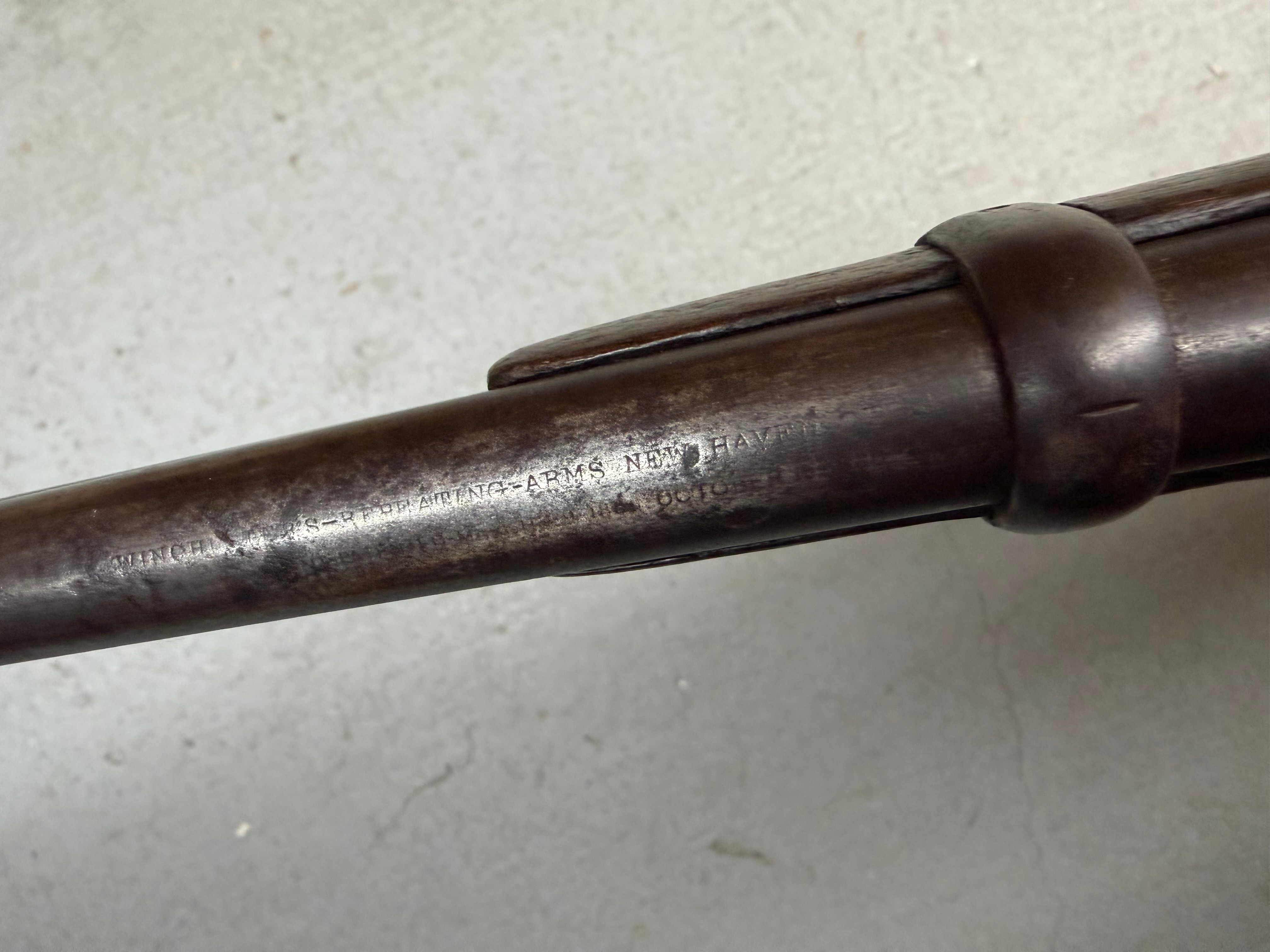

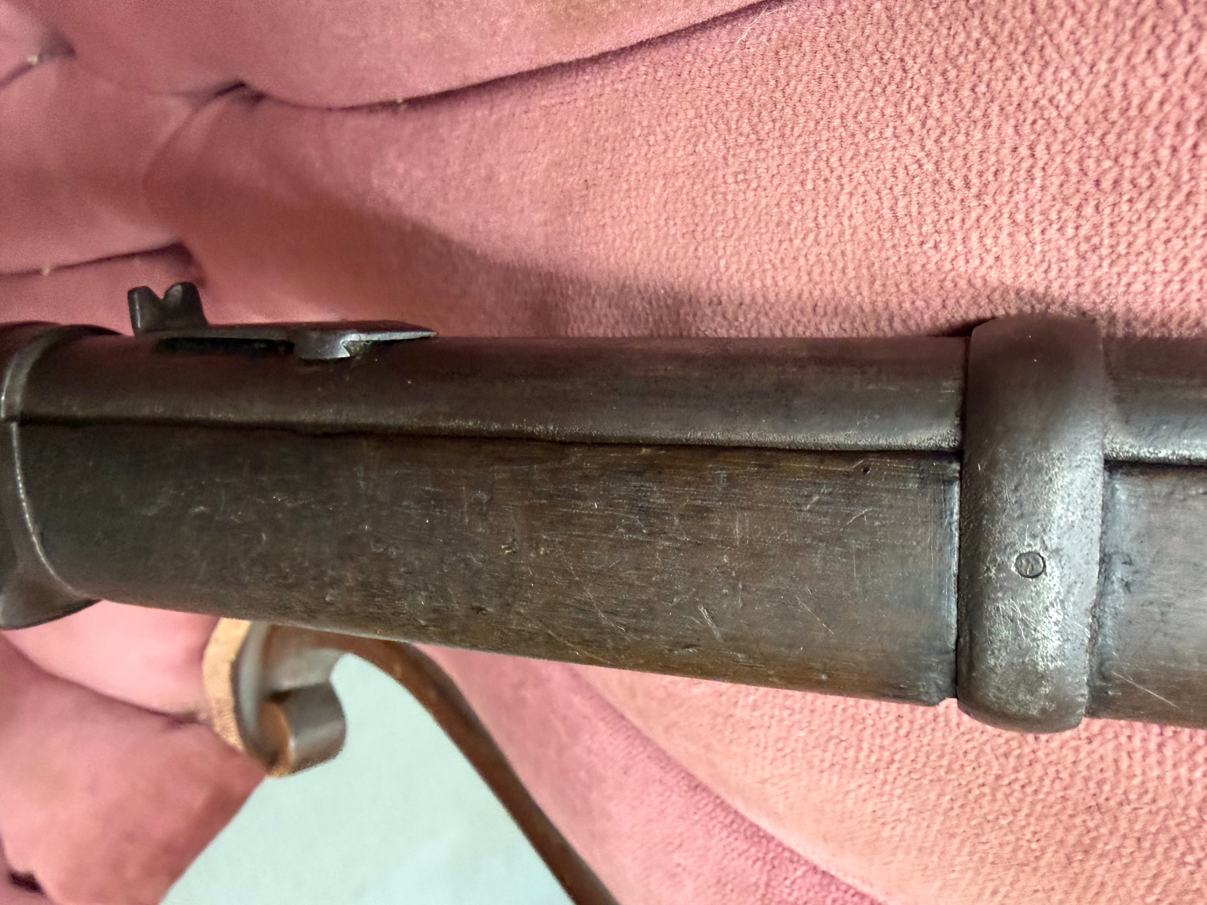

I thought I saw an indexing mark in front of the rear sight as well. Is the line on top of the barrel band supposed to be there too?  I’m not sure why you’d need a mark there. If the gun was re barreled it was either a long time ago or someone is a master at aging.
Forum Posts: 4995
July 9, 2026 - 2:27 pm
Indexing lines next to sights have been put on by Winchester occasionally but they are very short. You use them to reset your sight if they get bumped. The one on this gun is not original. There are marks on the top of the receiver a short ways back and the barrel band that serve no purpose. There are not many 14″ trappers around that are pictured and most of them I have seen have been  messed with like this one.

Interesting Bob! I sure was wondering about that mark on the barrel band. I was gonna venture into Gordon’s Books later as time allowed. By your statement saying “The one on this gun is not original”, tells me a lot. These short barrel rifles, and especially, “the trappers”, are never an inexpensive proposition. Naturally when $$$ is involved we tend to see things like this. With the couple things that you mention, it sure does make a person wonder what someone might have possibly done here long ago.
Bob, do you see that serial number in the ledgers that you have access to?

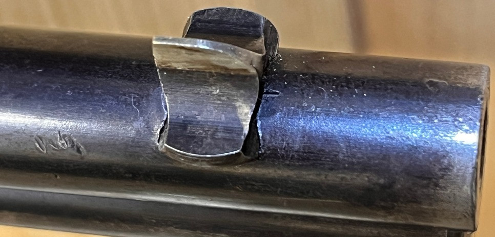

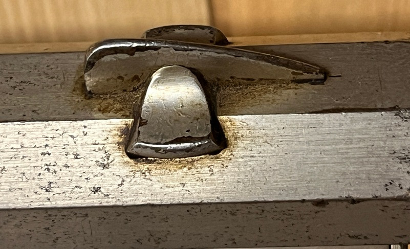

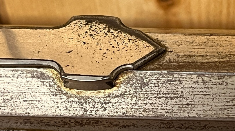

Here are pictures of Winchester sighting marks on two of mine.

Those are nice examples to see as a reference.
Thanks for posting it!

I agree – more things to look for when I pull a piece out of the safe.
