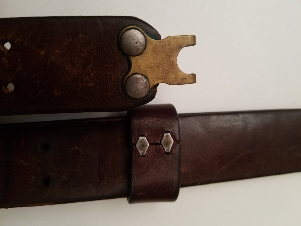

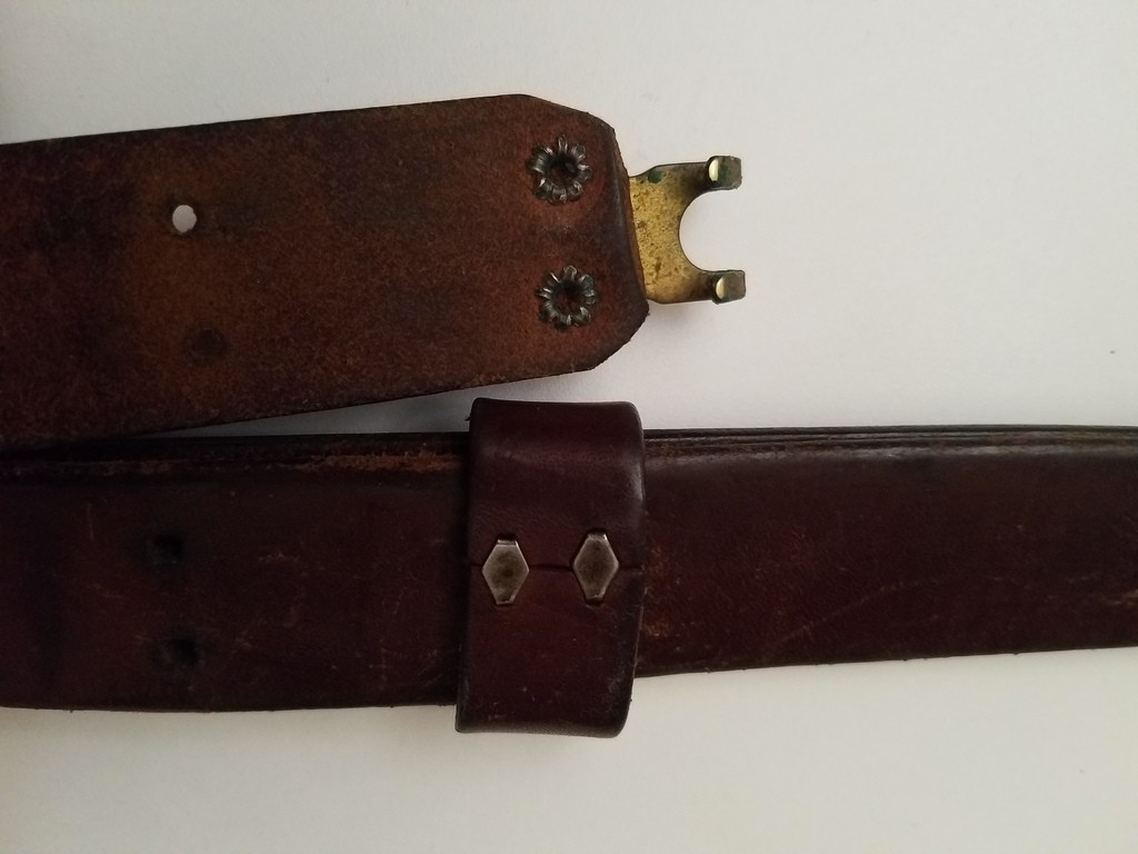

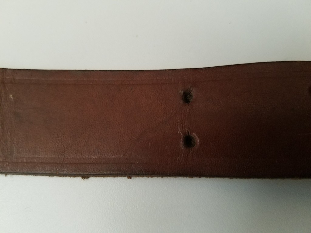

Hi Para-

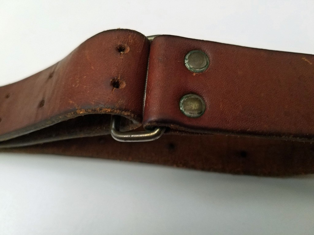

If I have the time later I’ll take some proper pictures of a 3269 sling.  In the meantime, I think these pictures are Jeff’s.  These are of the M1907 style 1 1/4″ Target Rifle sling, BUT the details are common to all of the Winchester Army Type and NRA Improved slings.
The key features are: 1) Single embossed edge on the leather strap; 2) Two rivet frogs with rivets EXACTLY as shown; 3) Two blue “diamond” shaped staples in each leather keeper (no regular staples or stitching); and, 4) NO maker’s mark.  Winchester used several leather goods suppliers over the years, but prior to 1964 they didn’t even put “Winchester” on their slings.  Any sling, whatever it looks like, that has a brand stamped on it was not a Winchester sling.
Winchester-Sling-Hook-and-Keeper-1.jpgWinchester-Sling-Hook-and-Keeper-2.jpgWinchester-Sling-Embossed-Edge.jpgWinchester-Sling-Loop.jpg
As for finding some…  The challenge is that they are NOT marked.  So mostly you have to know what you’re looking for, since the Seller usually will not.  Of course this does make them no more expensive than a comparable brand name sling.  Most of the (probably Winchester) ones I’ve found came from eBay.  Of course I don’t think I even have a “new” or “mint” one on any of my M70s, let alone any “spares”…

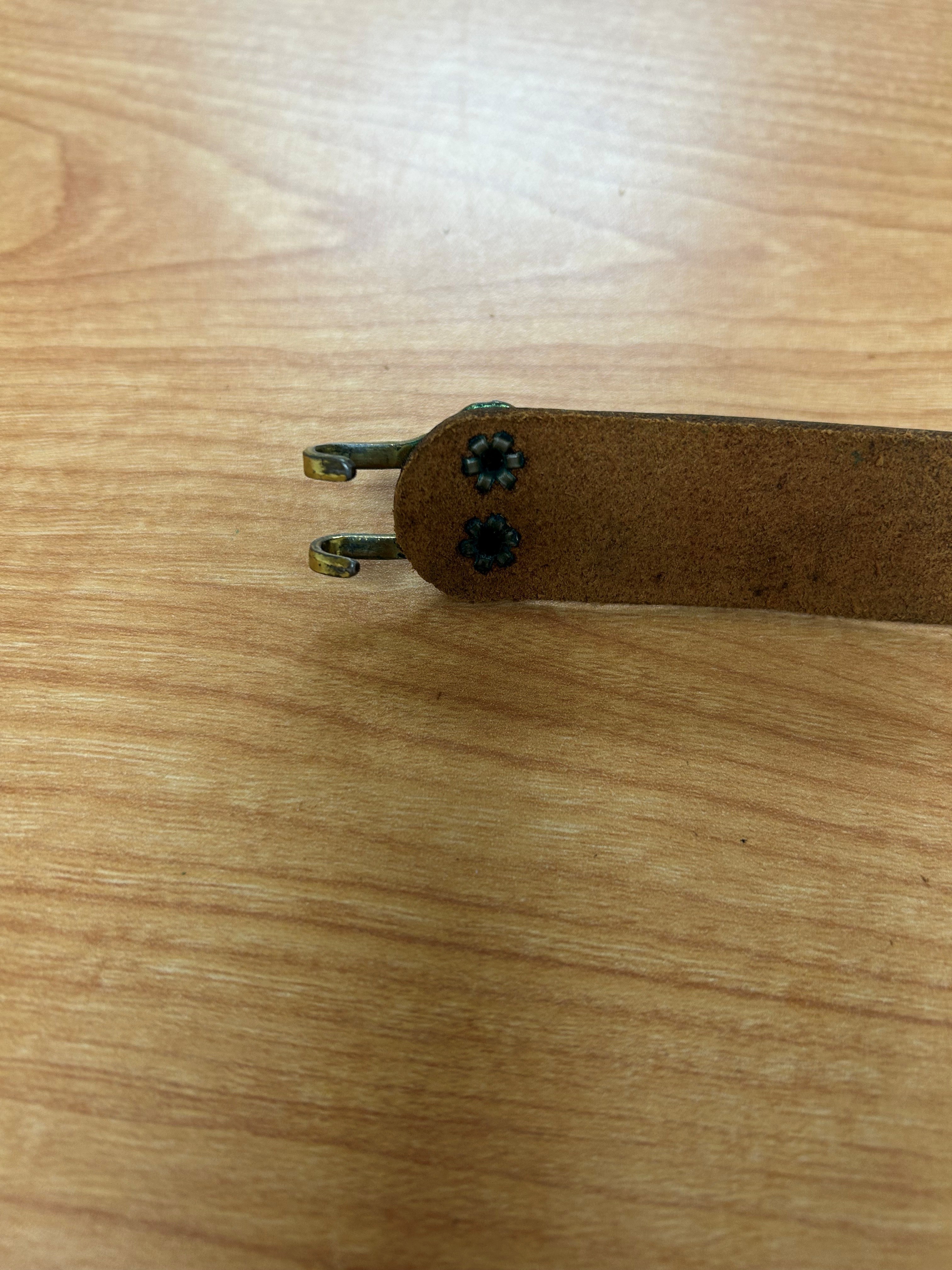

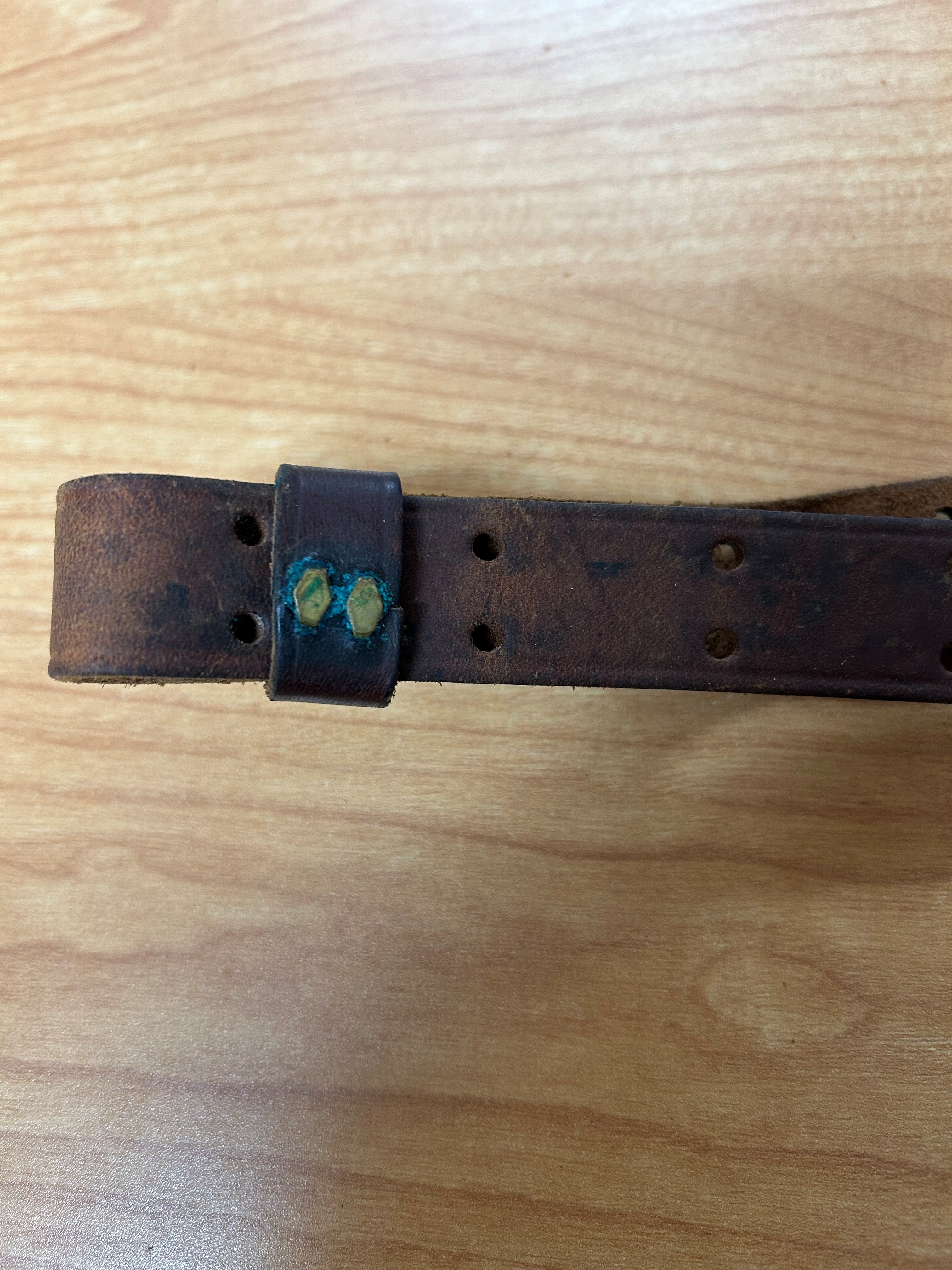

Is it possible that this is a Winchester sling? No makers mark. My father in law had it for years.

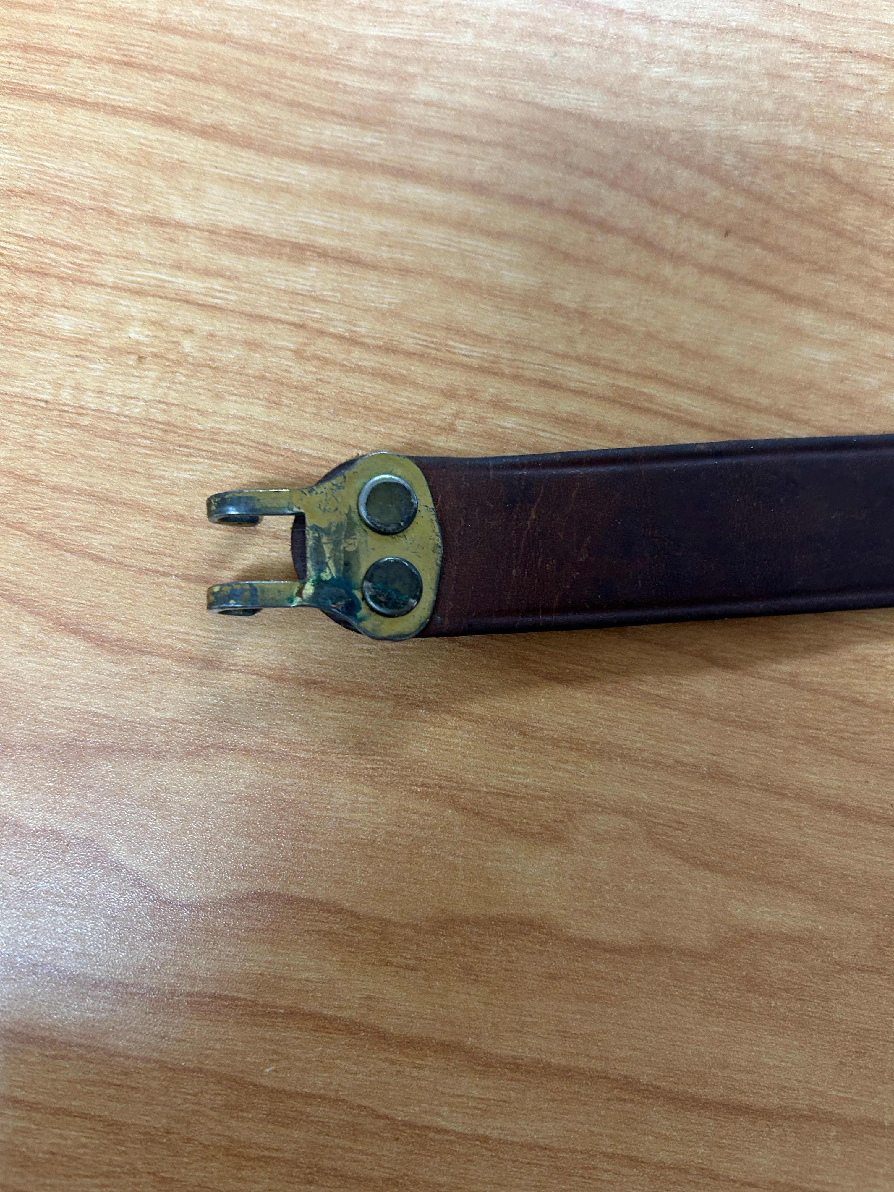

I don’t believe so. While not marked, the marking may have simply wore off. I believe that is a Red Head brand sling.
Red Head Ebay Sling
I think I have the same sling as yours.
Forum Posts: 1532
May 1, 2026 - 9:27 pm
Hi Al-
I do not believe that’s a Winchester sling.  Wrong brass frogs…  Should look like Jeff’s pictures I put above.
There were several name-brand manufacturers of leather slings back then, Brauer, Red Head, Boyt, etc.  Some used the same staples, some the same frogs, some the same embossing, but none that I’m aware of used thhe exact same combination of features as Winchester.
Of course, I don’t consider Winchester’s slings to be of particularly high quality…  I particularly don’t like that they used two-rivet frogs on 1 1/4″ M1907 style Target rifle slings.  For actual use I prefer the three rivet milsurp slings (and commercial copies)…  The Winchester slings are only interesting because they’re WINCHESTER!!!  Laugh

May 2, 2026 - 12:13 pm
Lou, when you say “Single embossed edge on the leather strap” are you speaking of the single line on each side of the sling as seen in your third picture?
Dan #67288
Forum Posts: 1532
May 2, 2026 - 2:48 pm
Hi Dan-
Yes… The outside edge of the leather strap has a single embossed line border.  Of course after 80-odd years and varying amounts of use it’s often very weak.  You can usually make it out on at least part of the strap, however.
