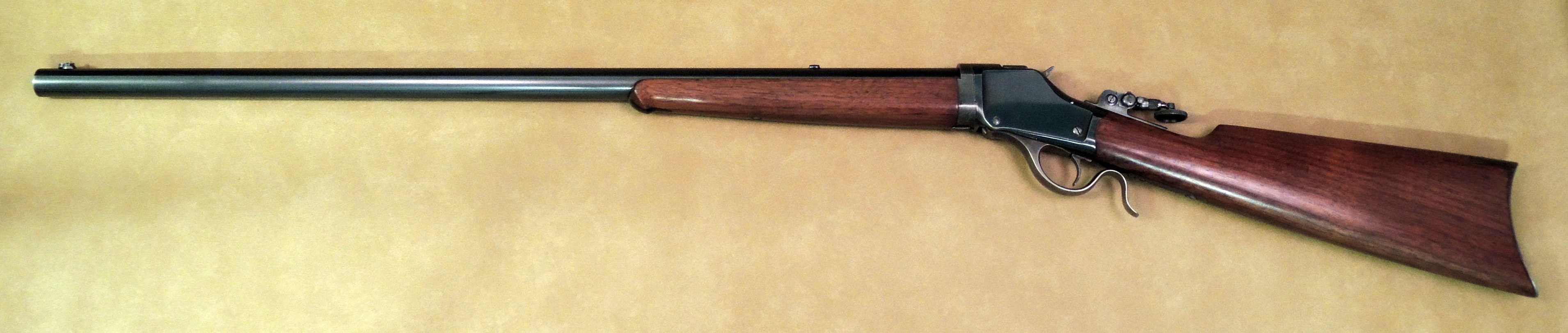

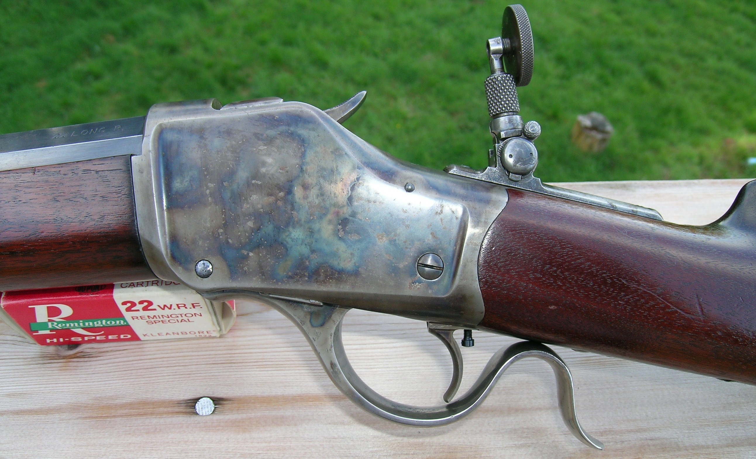

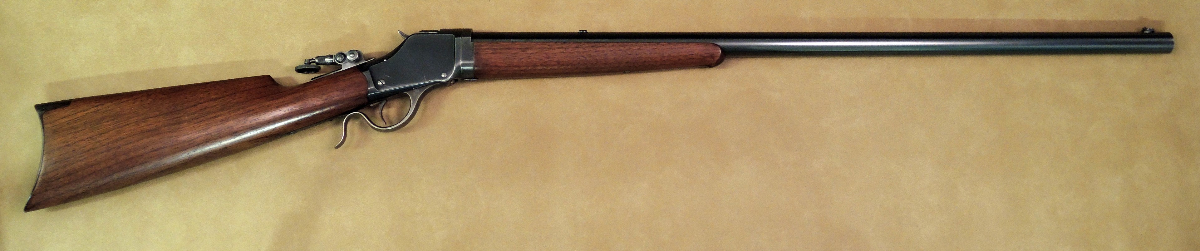

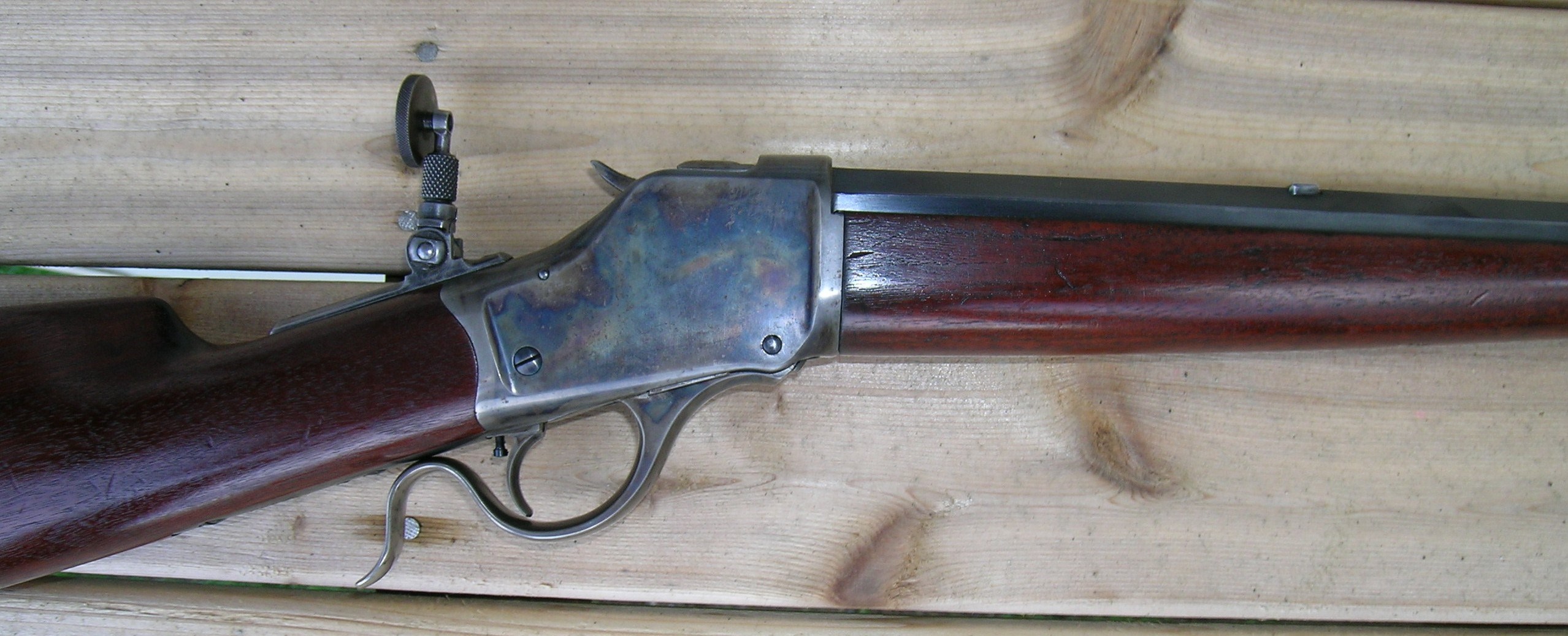

That is going to be a tough find.  In all the years I have been collecting tang sights for my collection of Model 1885 rifles, I have only managed to find two of them with the “SB” application code.  One is a No. 2A, the other is a No. 103, and both are now on rifles.
High-wall Take Down in 30 U.S. with No. 103 “SB” tang sight
High-wall in 22 Long Rifle with No. 2A “SB” tang sight.

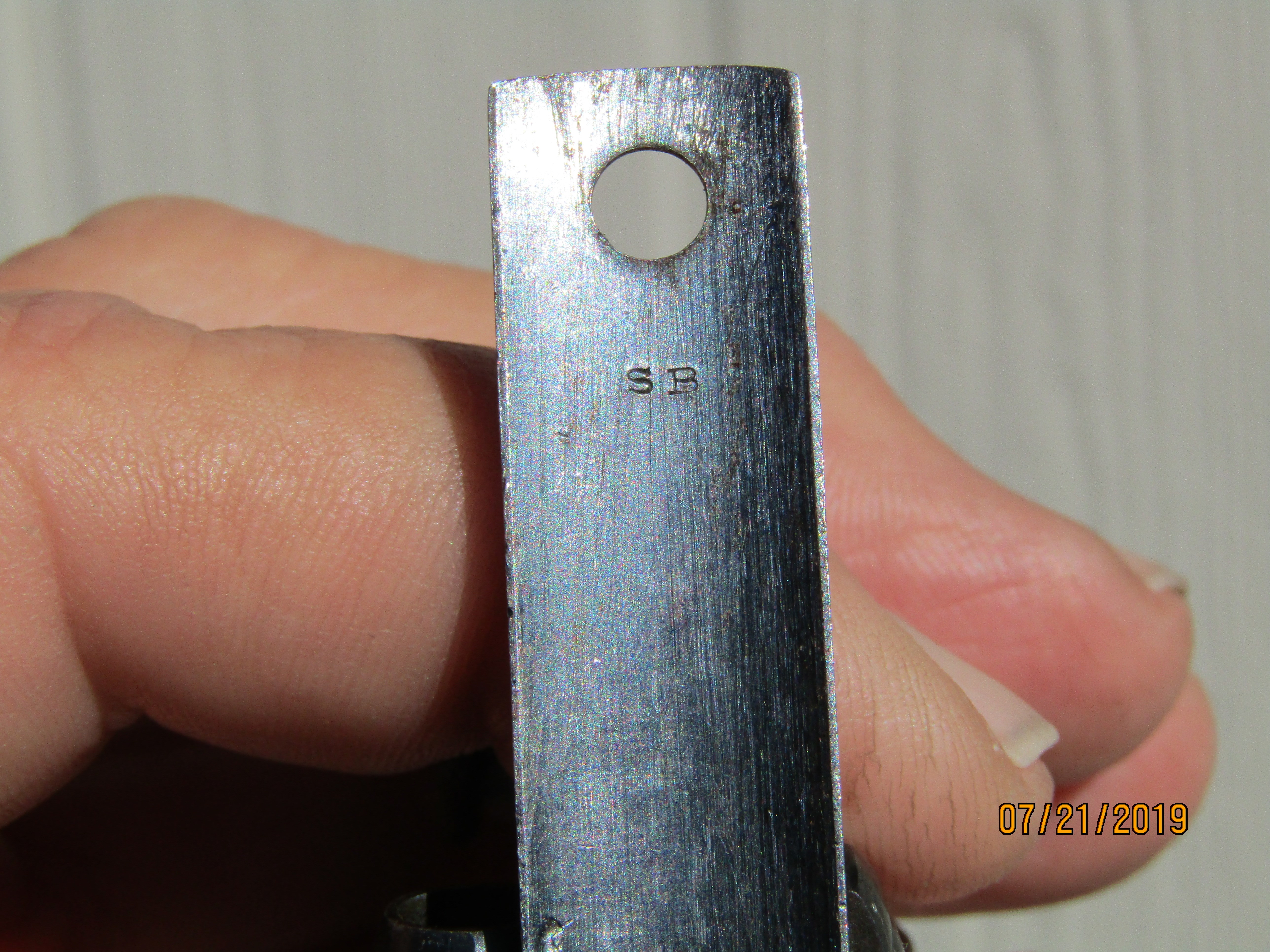

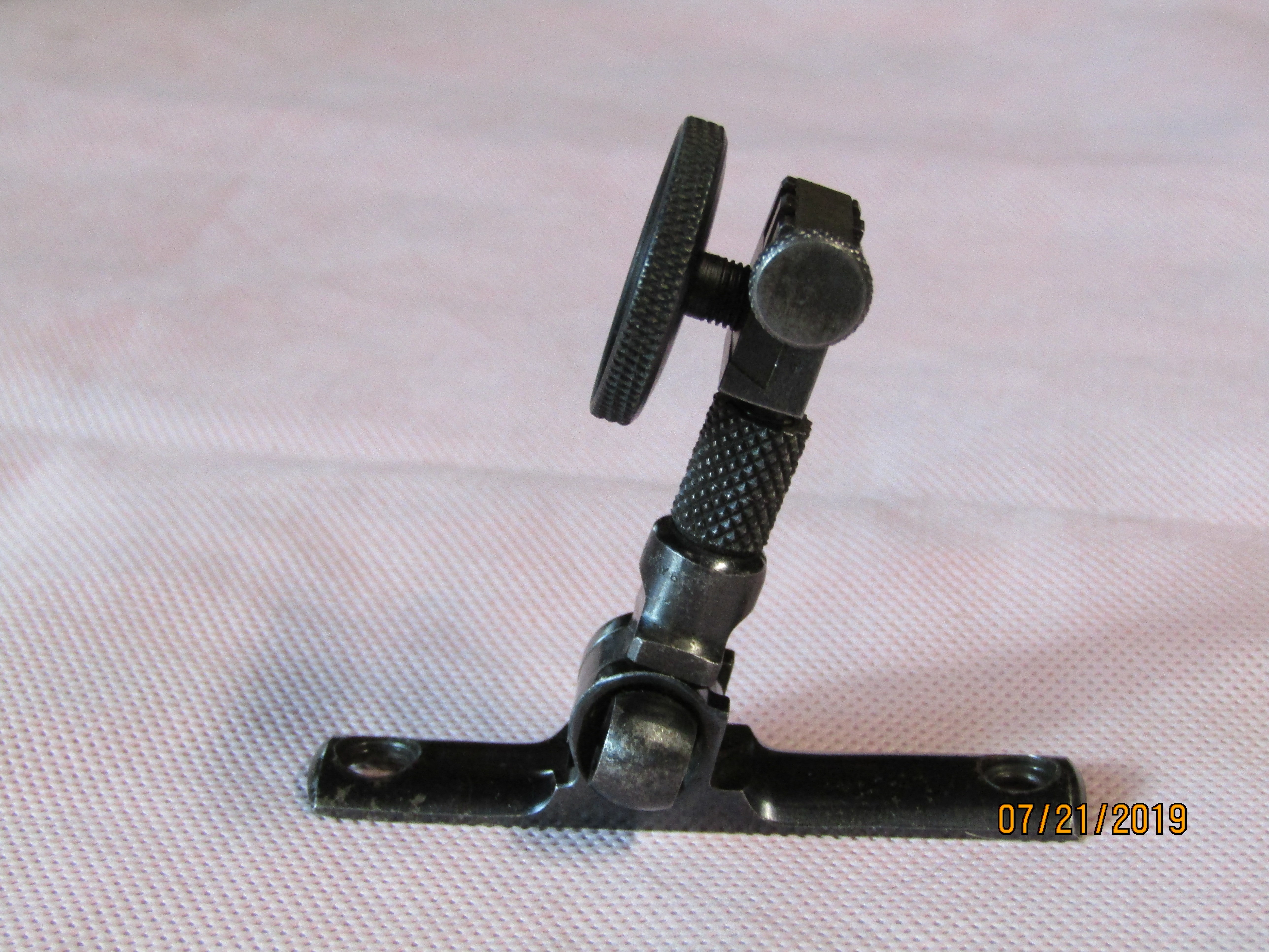

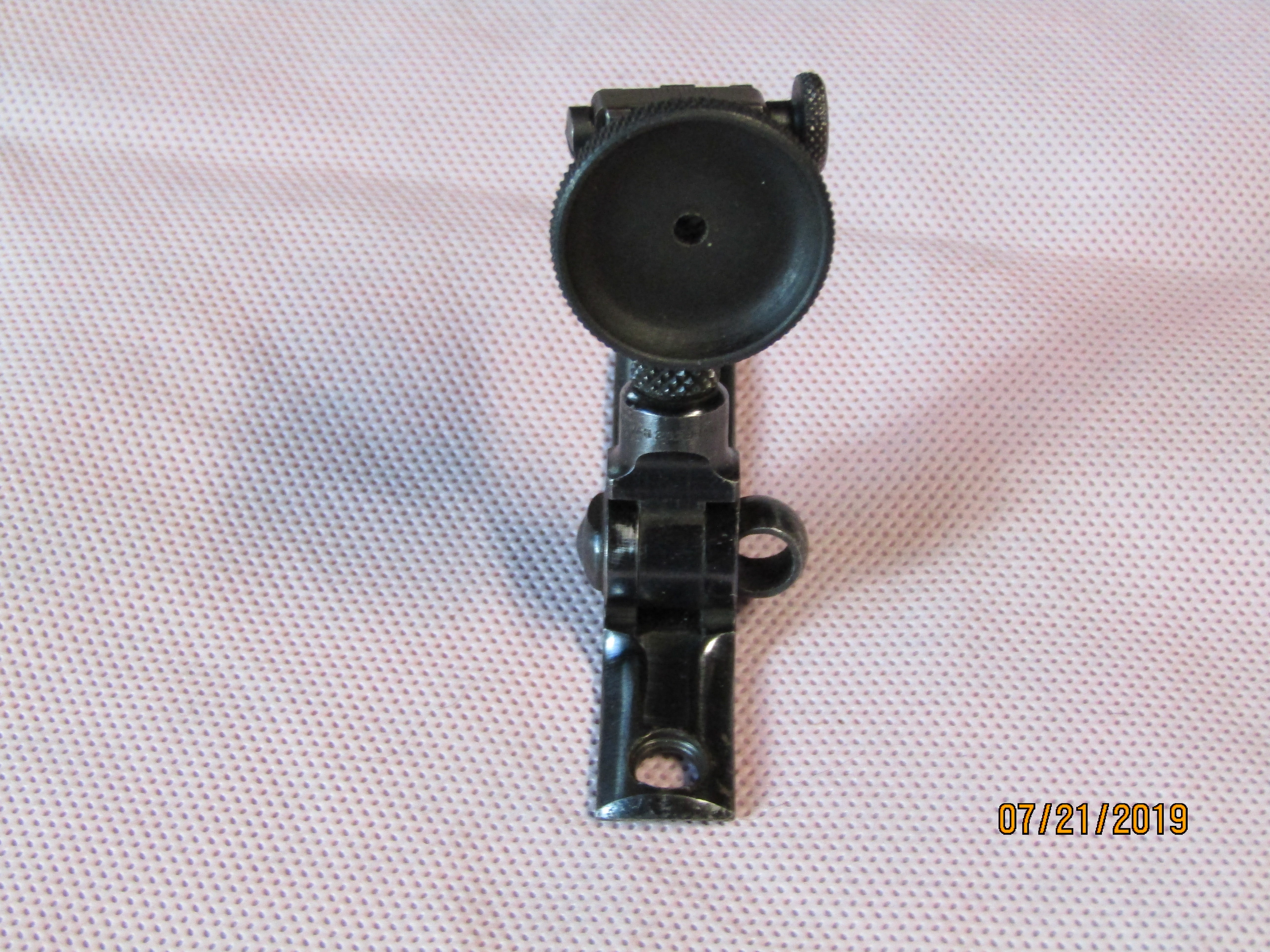

What would be the current value of a 90% Second Generation “SB” sight?

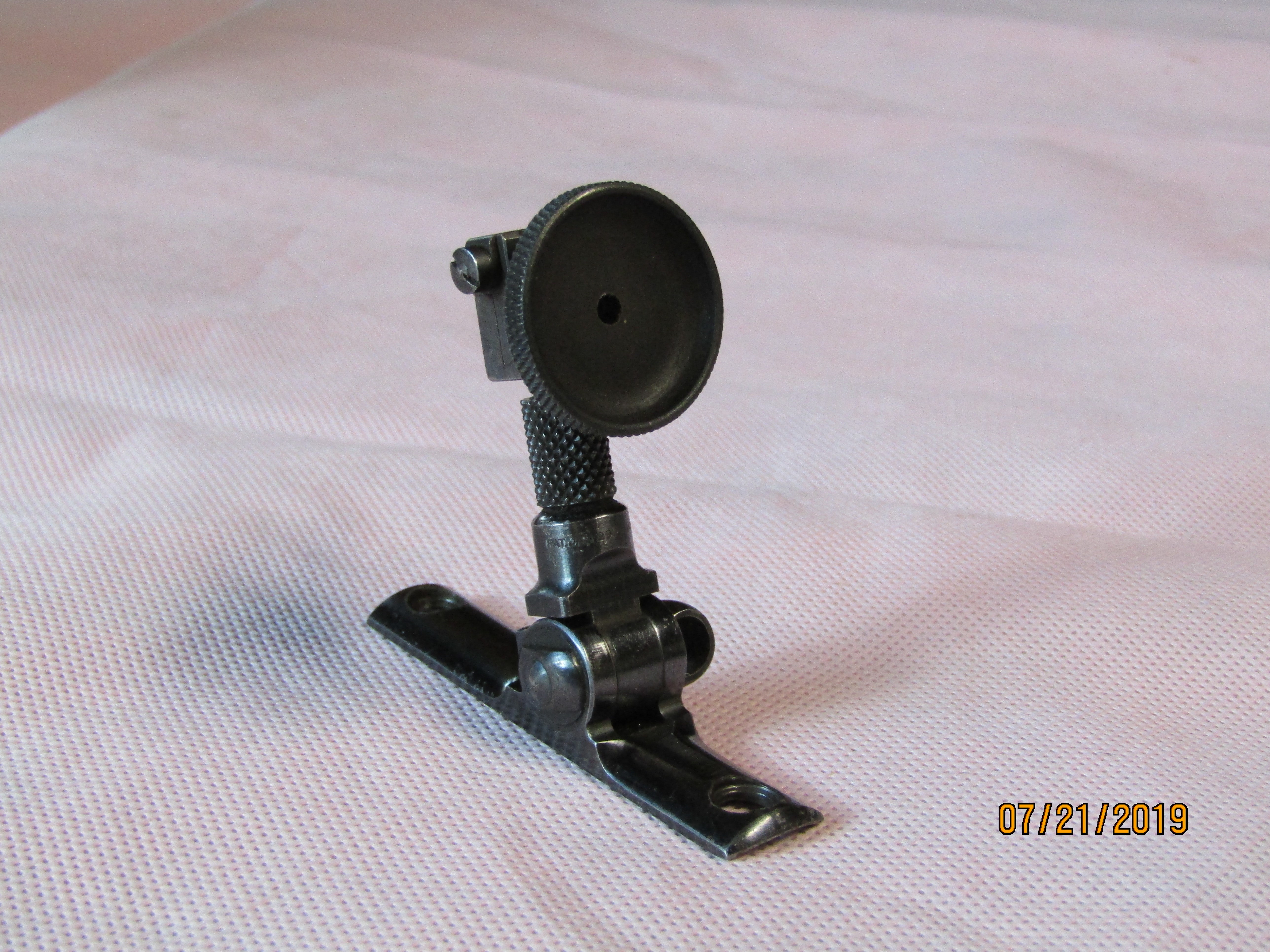

Thanks Bert for your reply.  I have the No. 1 SB sight with the No. 47 windgauge stem.  I have been in touch with Manuel and it appears his luck for finding stuff is continuing.  As luck would have it he is in the San Jose area and I am in Santa Clara.  Go figure.  RDB

I will see you this afternoon Roger!!!
