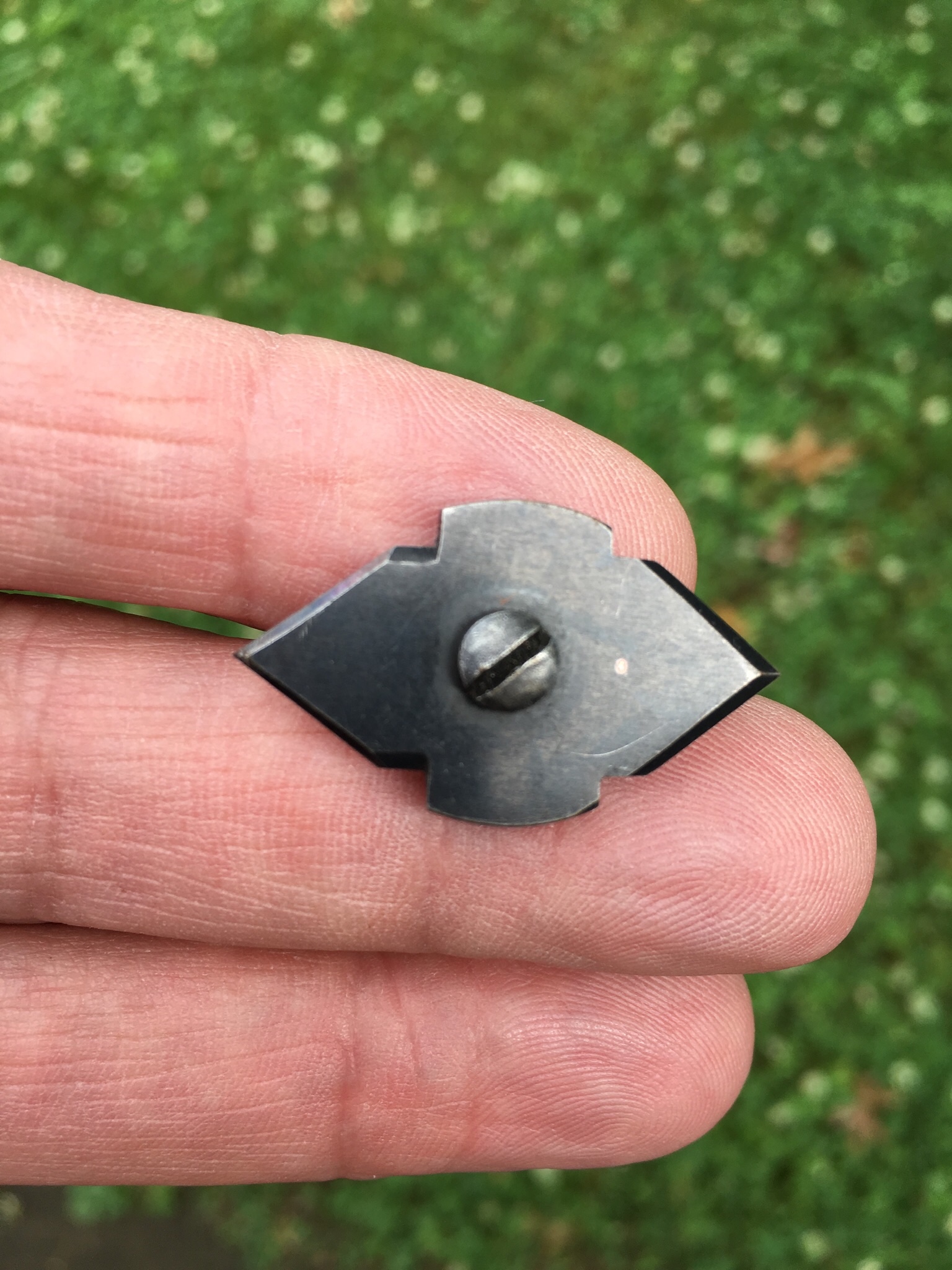

It’s not for sale and not even sure what’s it’s for, but this one always appeared to be factory work.ECD3A9DA-6920-4353-8BAC-70697E5EB317.jpegE94819D2-C762-41E8-84C7-70041C55738C.jpeg
Forum Posts: 6902
July 1, 2020 - 6:28 pm
Looks like a homemade one cut down from a sporting sight.  Factory dovetail blanks are very hard to find, almost impossible.  If you are extremely lucky you can find a real one that is marked Lyman.  Most unmarked ones are repos.

July 1, 2020 - 11:39 pm
Chuck said Looks like a homemade one cut down from a sporting sight.  Factory dovetail blanks are very hard to find, almost impossible.  If you are extremely lucky you can find a real one that is marked Lyman.  Most unmarked ones are repos.
Probably, but I’ve seen others just like it.  That screw makes it fairly modern.

He sure makes it look easy!  I’m inclined to think getting exactly the right angle on the cut-off end may require more care than simply eyeballing it.
Forum Posts: 978
July 2, 2020 - 12:47 am
Didn’t appear that the bevel was milled in a home workshop.

July 2, 2020 - 6:07 pm
Believe me, those homemade ones are fairly common because the real ones are so rare.  If you travel to the large gun shows you will easily find a homemade one or even the reproductions.  Just because someone other than Winchester made them doesn’t mean a gunsmith can’t.  One side is the original bevels and the other side is filed and polished before cold bluing.
What did “the real ones” look like?  Aside from merely filling the slot, this type served a useful purpose: covering the top of the slot if the edges happened to be damaged by driving in a dovetail that was a little too large for the slot, which can curl back its sharp edges.

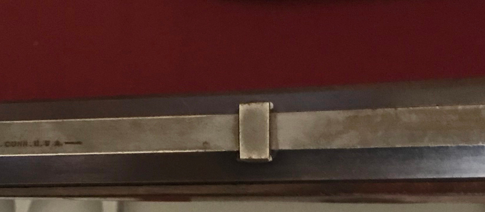

Forum Posts: 6902
July 3, 2020 - 4:41 pm
They were just a rectangle that filled the slot.  Nothing fancy like the cut down sporting sights.  Here is a picture of one.  I don’t know if it is real or a repo but it has been on this gun forever.

July 3, 2020 - 6:21 pm
Though some of these are obviously “cut down,” others look too well finished to be home-made.  They might be gunsmith-made, but I’m wondering if some sight or parts-maker was also producing them.
