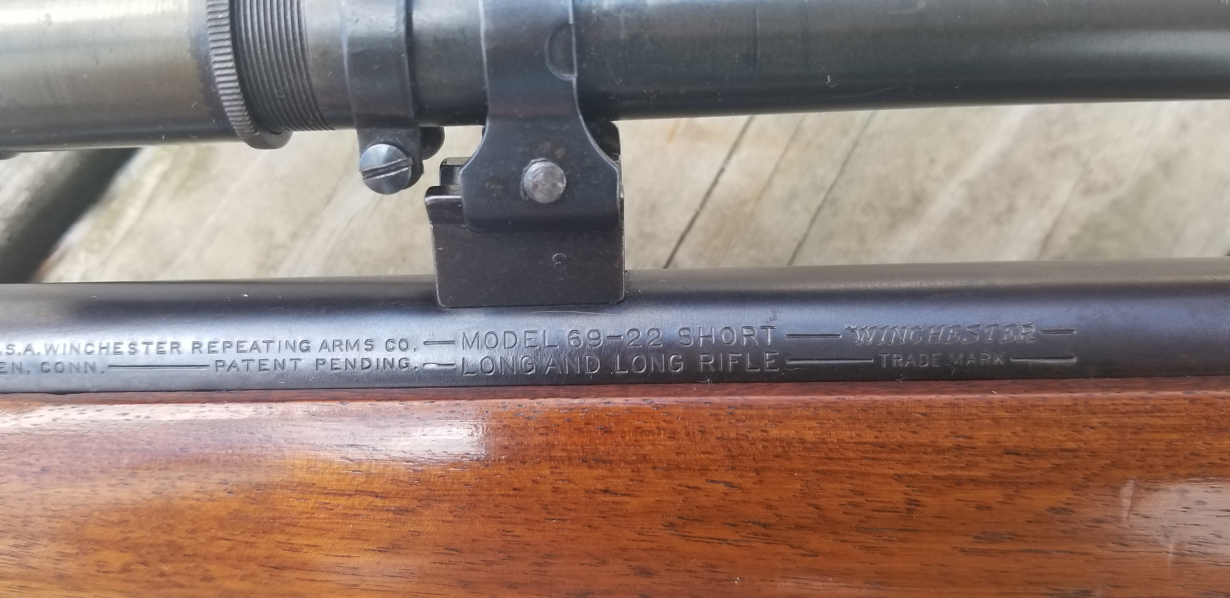

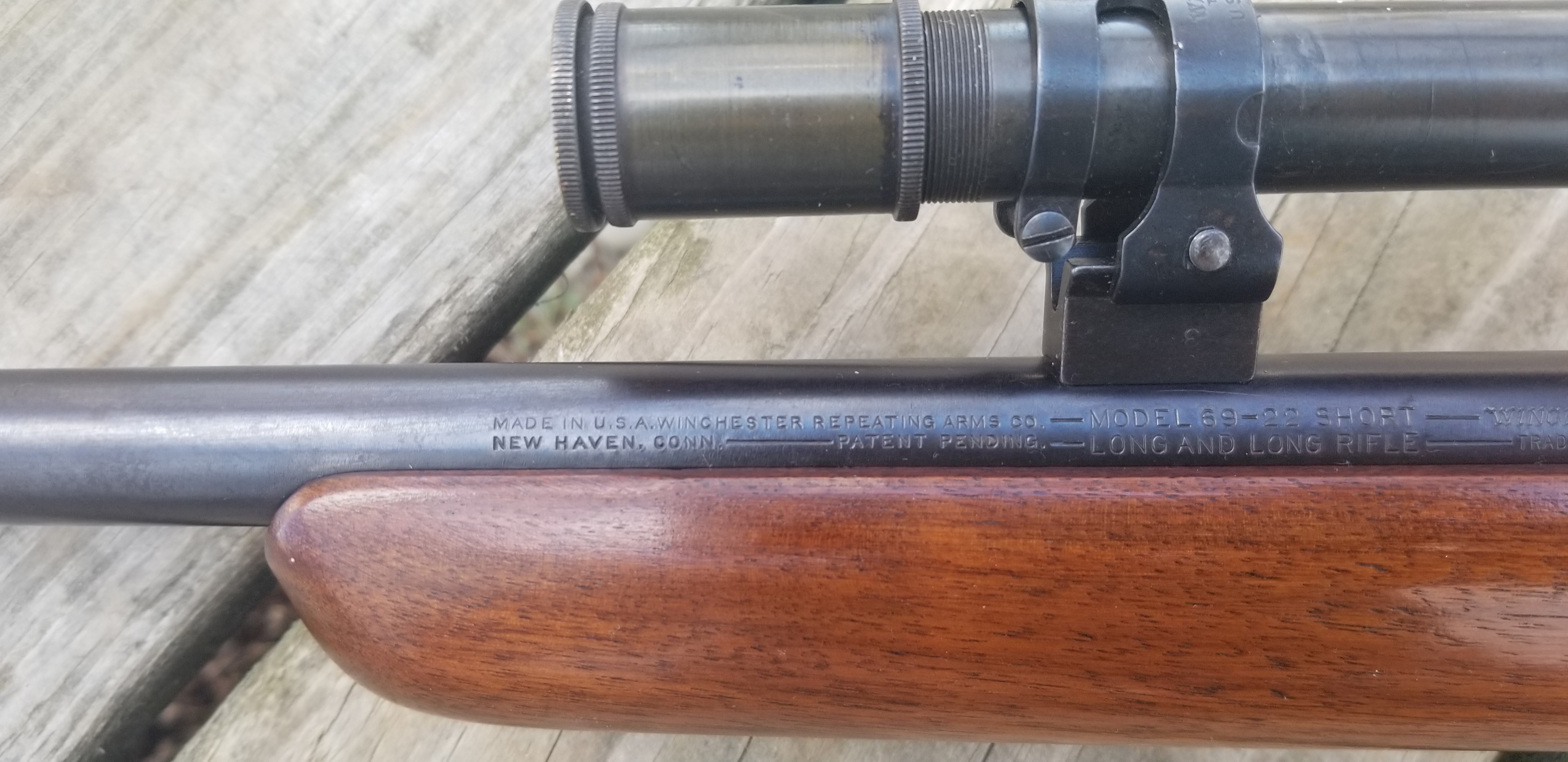

I have this Model 69 for sale. The scope is 2 3/4x, it should be a 5x on this rifle. It is an original Dual Sighted 69, but the scope has been changed. I will listen to an offer. I am not an expert on these but will try to answer questions. Call or text 207-522-0939 or email [email protected]

Hi Dana,

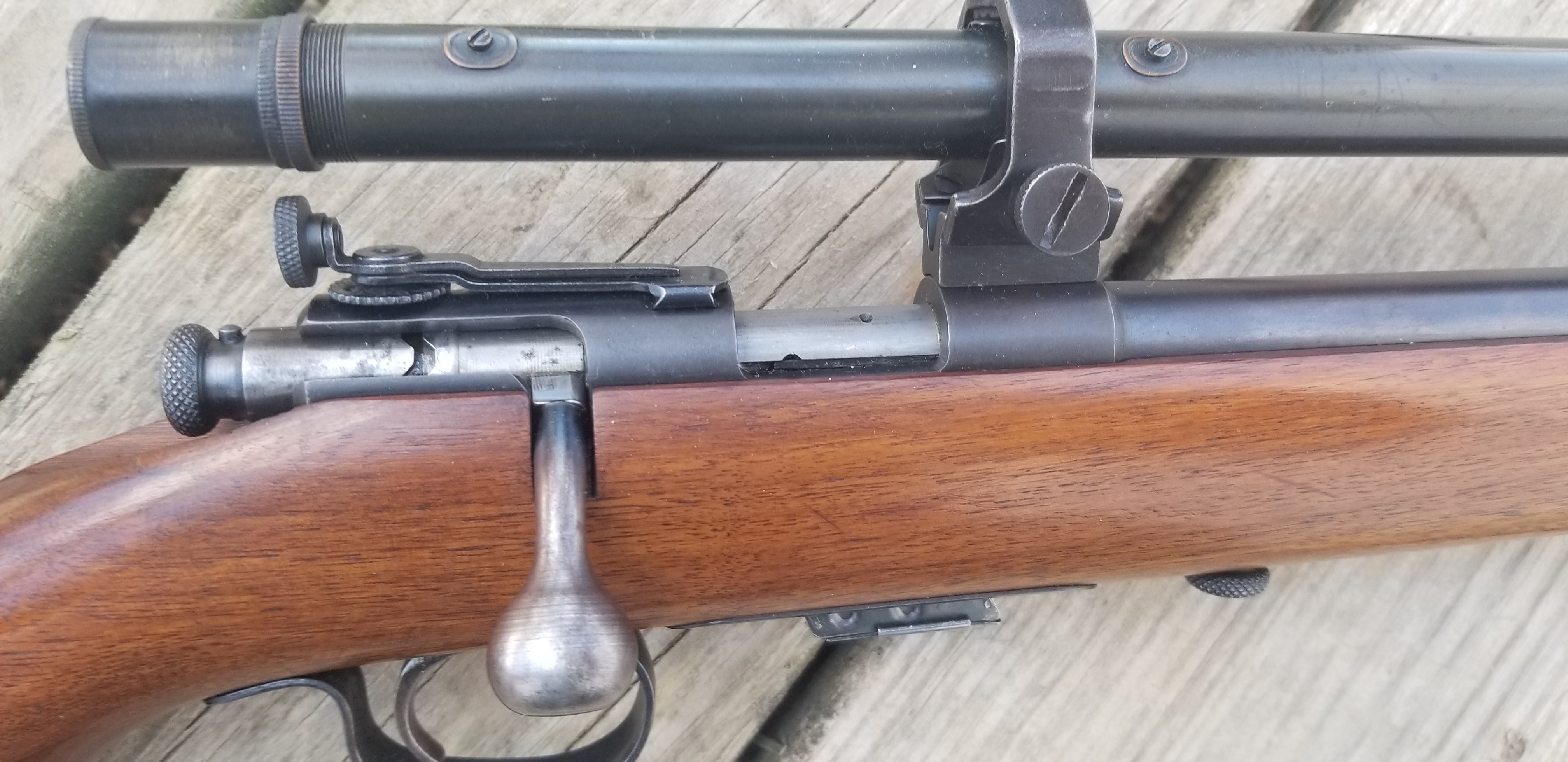

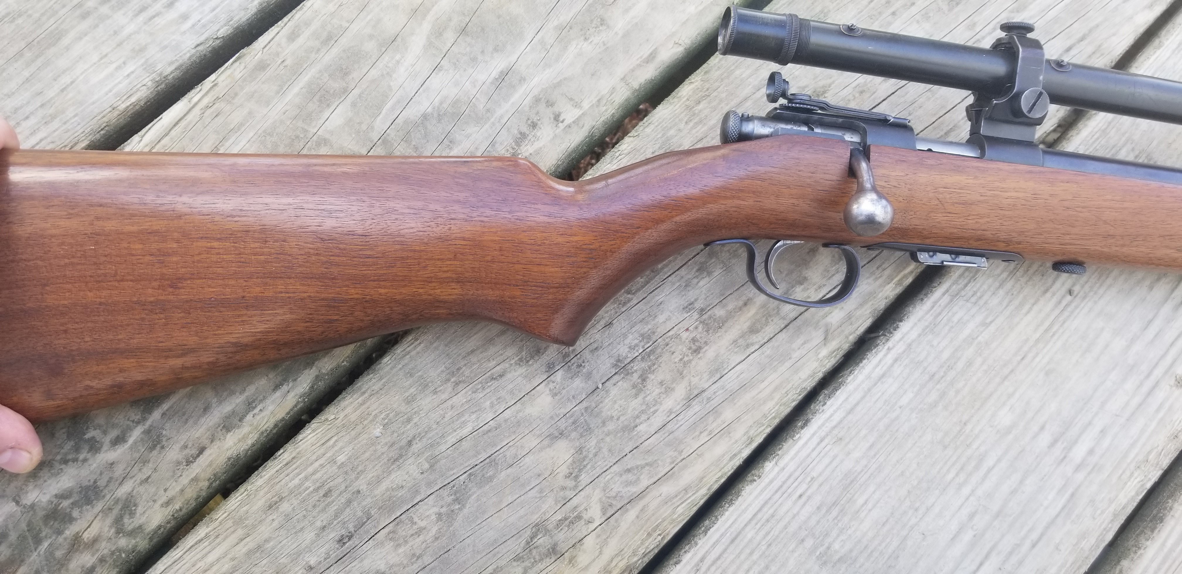

It is a fine looking rifle but judging from the base spacing it looks as if you have a 2 3/4x scope mounted on a rifle that is supposed to have a 5x scope?
What is the CtC distance between the bases and the overall length of the scope?
A G6951R dual sight rifle should have a CtC base spacing of 7.5″ish (with the base on the receiver) and the 5x scope should be 16+ inches.
A G6961R dual sight rifle should have a CtC base spacing of 4.1″ish and the 2 3/4x scope should be around 14″ish (corrected length)
My eyes and perspective may be playing tricks on me in the photos though.

The scope is 14″ overall. According to an article by Vincent L. Rausch that I found about scoped Winchester 22’s, 14″ is correct for the 2 3/4 power scope. Center to center the bases are pretty close to 6 1/2 in. The reticle is a post and cross hair. There are no markings that I can see on the tube.

Hi Dana,
Thanks for the info.  I am travelling and couldn’t remember the exact length of the 2 3/4x, just knew it was shorter than the 16+” of the 5x
6.53″ CtC is the Winchester dimension specified on the 5-10-40 spec sheet for the 5x (7.53″ is the 1937 dimension).

Jeff, So that I’m clear, This rifle has the correct base spacing for a 5 x scope on a rifle made in 1940 or later?  The rifle needs a 5x to be correct?

Hi Dana,
Yes, that is correct for both questions, according to the Winchester factory barrel drawings and the Winchester base mounting information.
Only the mounts were marked…except for the ones that weren’t!

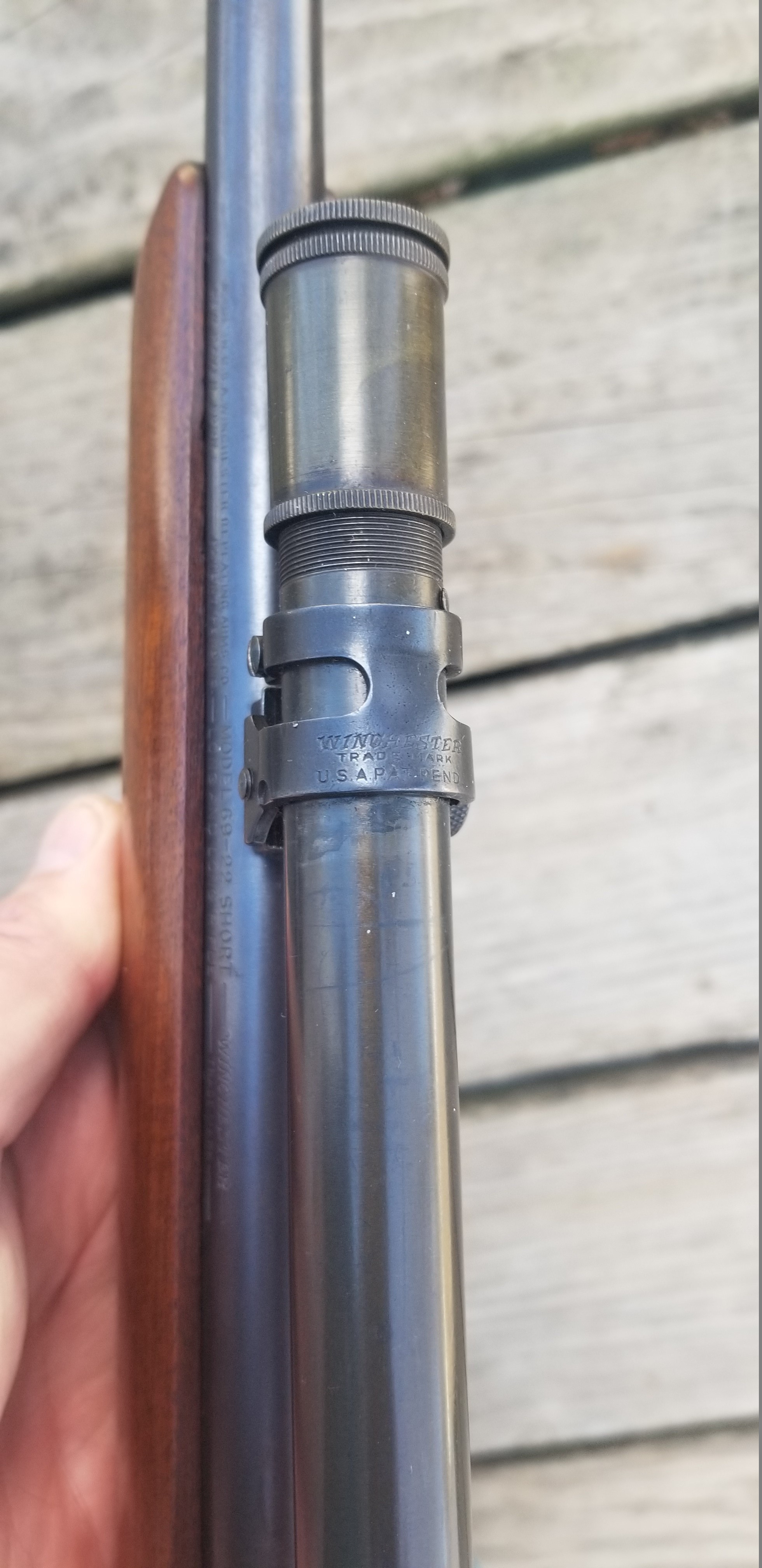

Due to the wider 5x base spacing, it is putting the front ring too far forward on the shorter 2 3/4x scope.  I would bet that if you loosen and slide the front mounting ring back a little you will find it is marked “2-3/4X” under the ring.  Most, but not all, of the dual sight scopes were marked with the power.
The purpose of the closer base spacing for the shorter 2 3/4x scope was to allow enough room to slide the scope rearward to obtain the proper eye relief.  You will notice in your photos there is no more room to slide your 2 3/4x scope to the rear and it should actually be further back at least another inch to have the proper eye relief with the correct cheek weld on the stock.  A longer 5x scope can be used with the closer base spacing of the 2 3/4x scope but not the other way around since you run out of scope tube before the proper eye relief is obtained.  Hope that makes sense?
