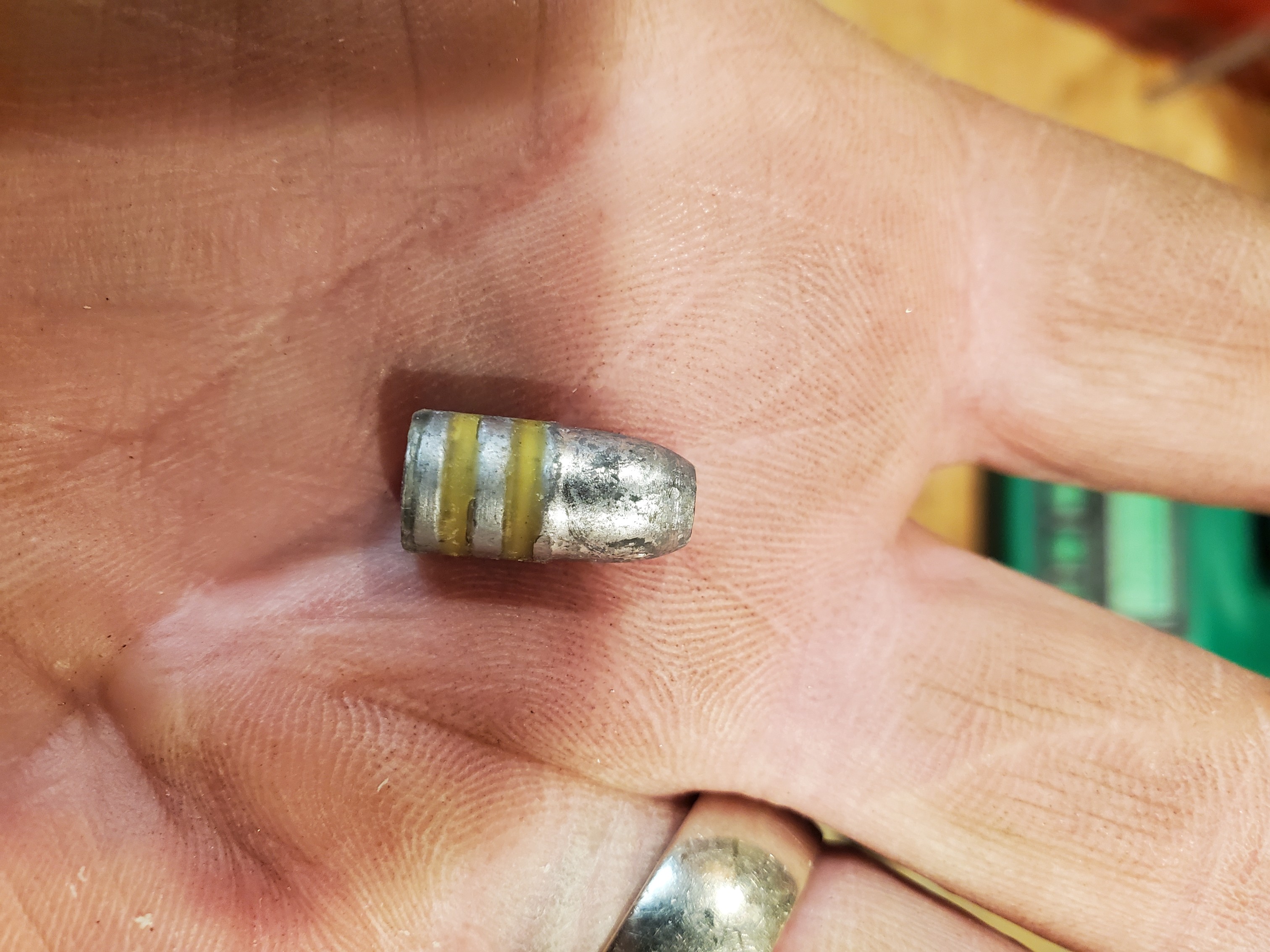

Just figured I would post that I found the mold I was looking for. The Saeco 322 is a 2 lube groove, flat base bullet with crimp groove of 118 grains. The nose of the bullet is a bit shorter than either the winchester or NOE bullet (thanks Mike hupp for sending your mold) so with smokeless powder, the crimp groove can be used, there is no bullet push back, and coal fits in my 73s, 92s, and colt lightning. Thanks all.
Left to right NOE, Winchester, Saeco
