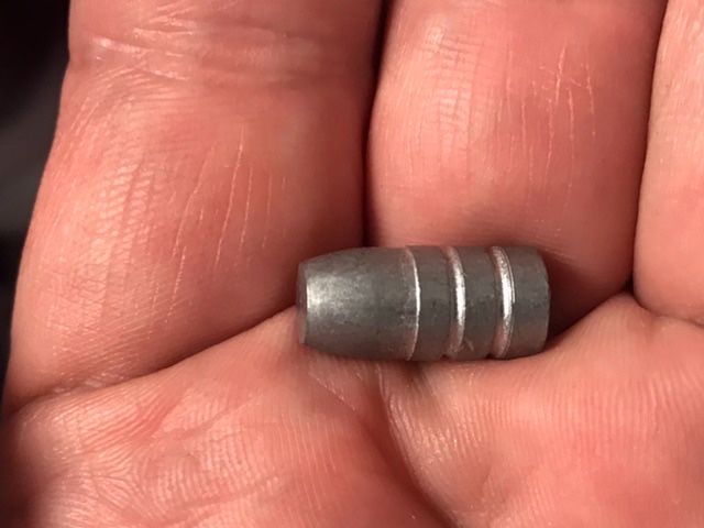

I don’t have any extras cast but if you want to borrow the mould for a bit I’d be happy to send it to you. I also have the Lee TL314-90-SWC if you favor a plinker bullet. It’s a cheap 2-cavity mould but it drops a decent bullet. I don’t think the Lee’s SWC profile is a good idea in a lever gun but I can’t recall trying it.
That NOE mould drops a pretty sexy bullet!

That is a good looking bullet. I have been using a winchester  type 4 mold for 32wcf. It works well but is slow as it is only a 1 cavity mold. Additionally, the bullet is designed for BP. If the top groove is used for crimp with smokeless, which is what I am loading, the oal is to long to function. I will PM you. Thanks,

This bullet is seated to the edge of the top driving band. Grooves probably not big enough to carry adequate lube for BP.

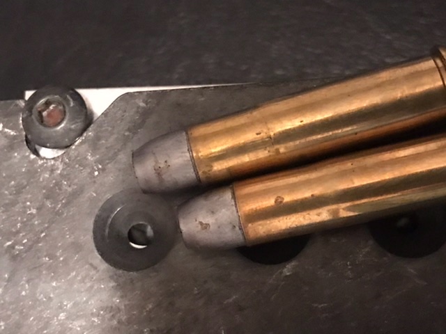

What dies are you using, Mark? Crimp is indeed critical but is useless without adequate neck tension. Neck tension is something the RCBS Cowboy dies seem to do well. As you may be able to see in the above pics I apply a very slight crimp, very little beyond straightening out the flare necessary for starting the bullet into the case. . It almost appears to be a taper crimp. The pic is also a good illustration of why I now trim the cases in this lot of brass because the lengths were not uniform. When depending on a slight crimp the case length must be uniform.
If anyone is crimping into a crimp groove, like Mike said, you have to make sure your cases are trimmed to the exact same length.  Problem with this is the bullet jump may not be what the barrel likes for accuracy.
