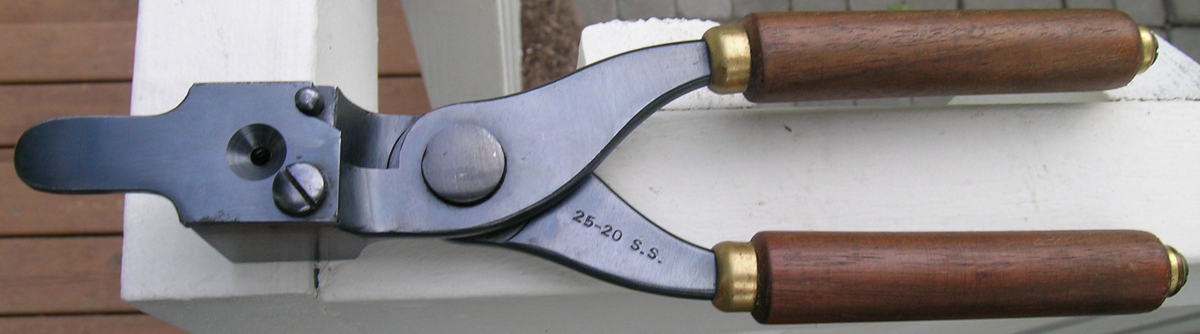

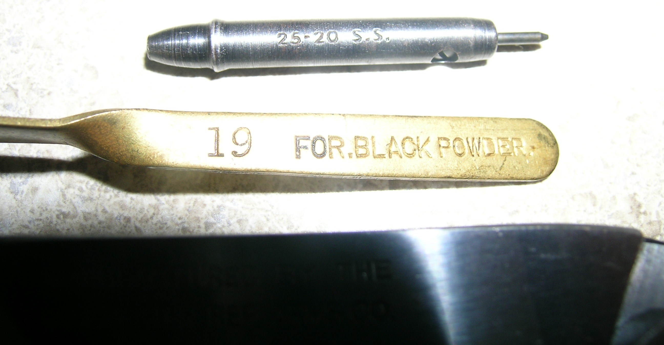

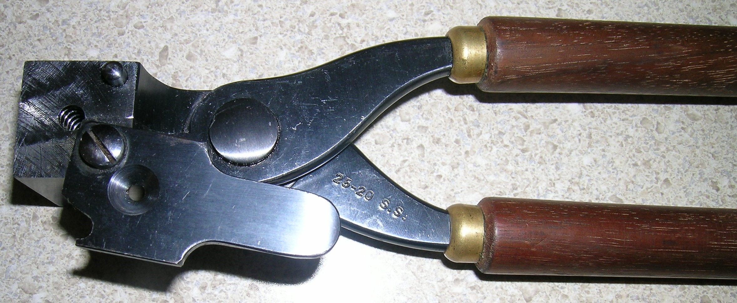

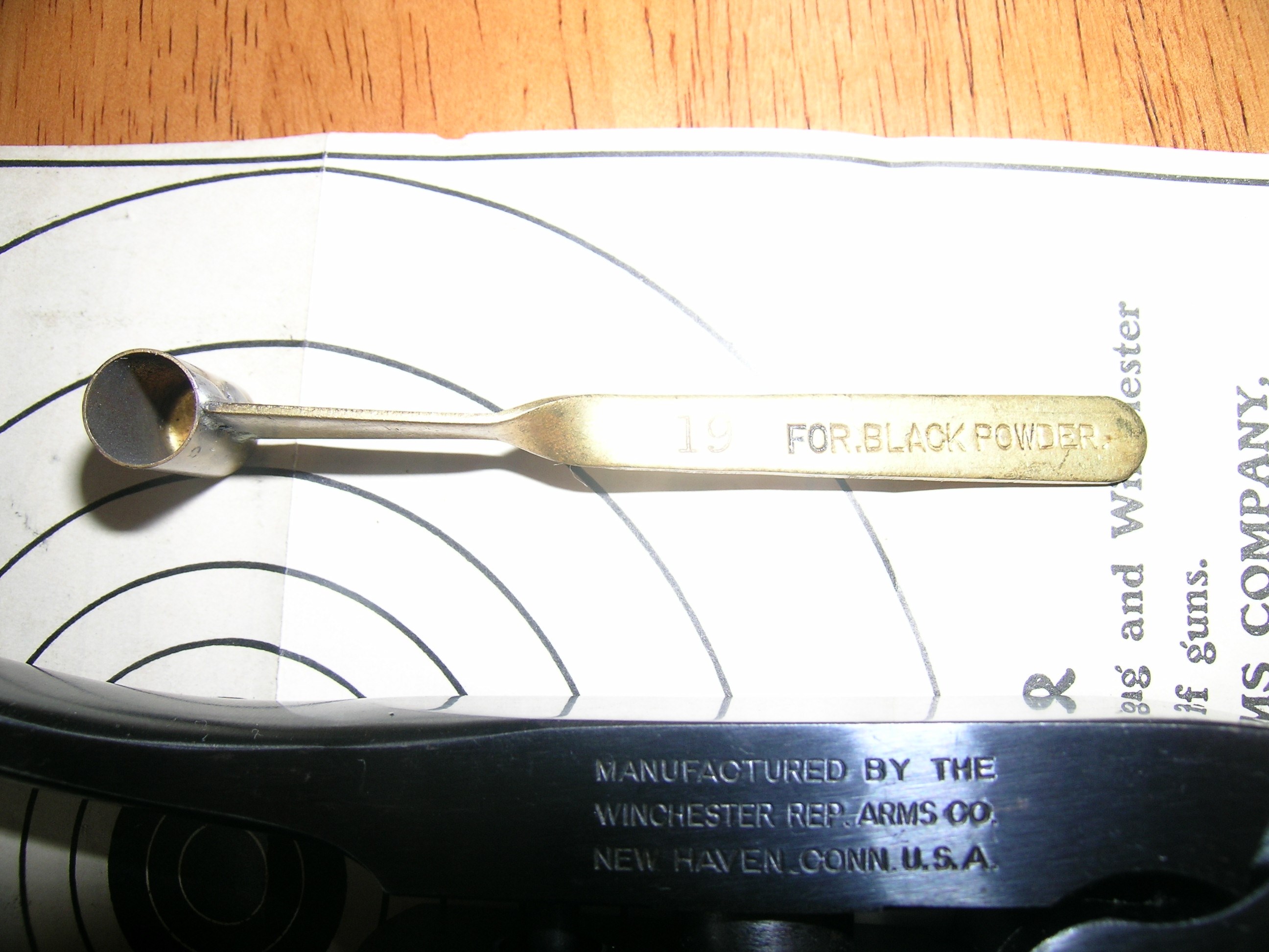

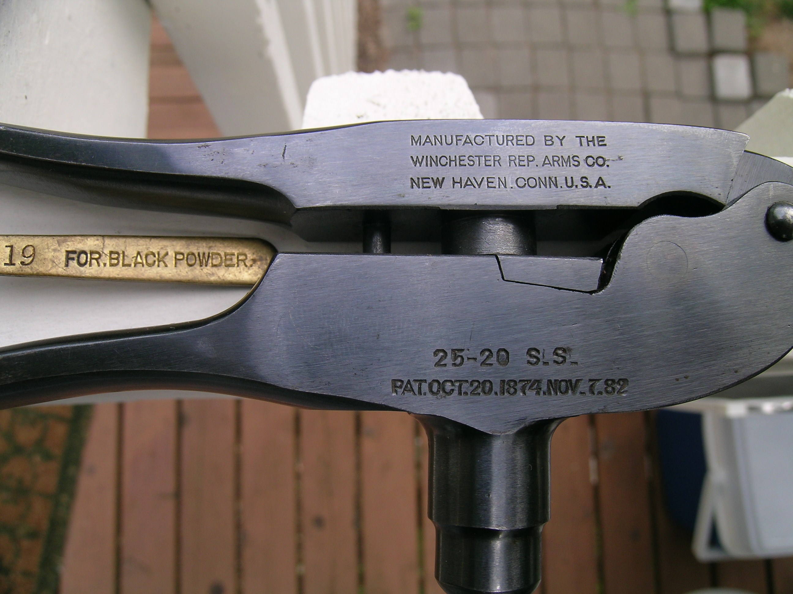

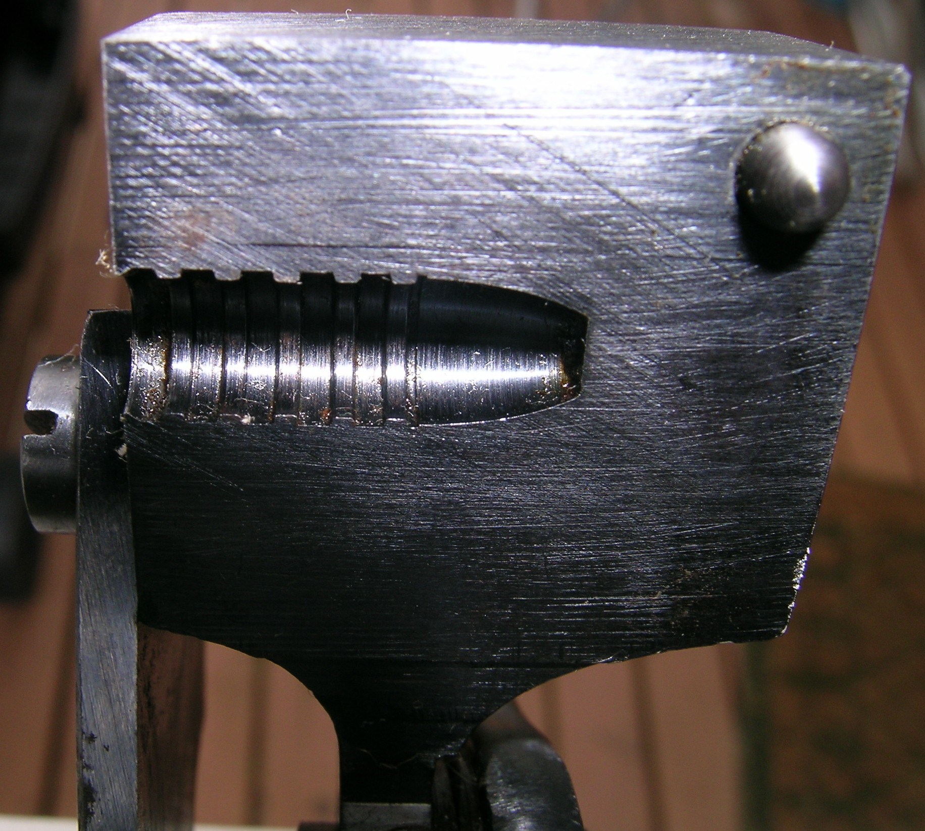

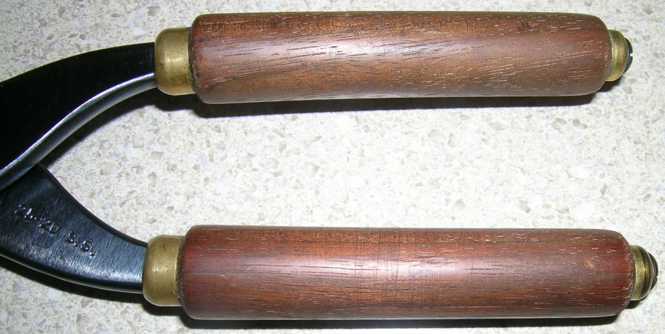

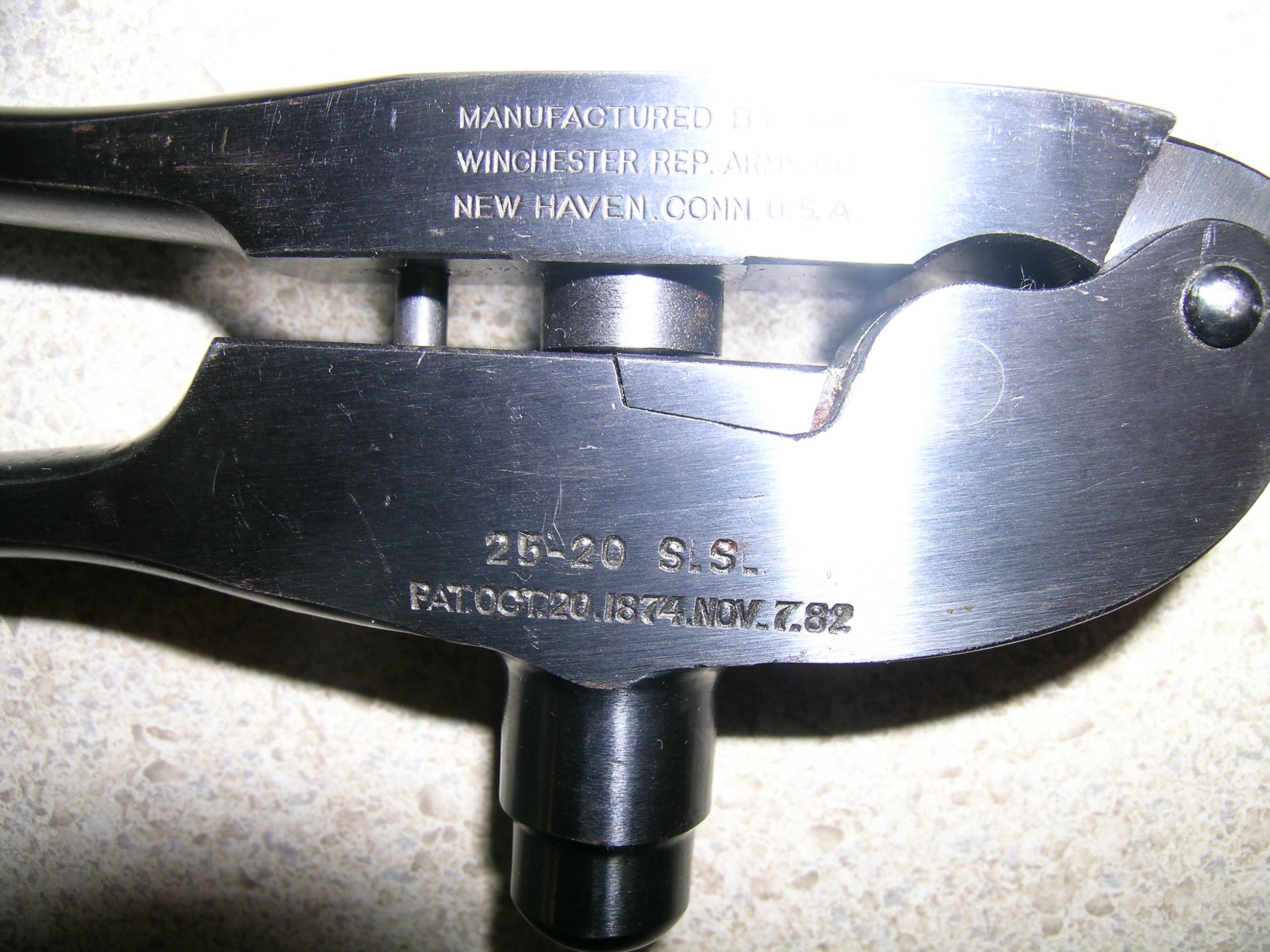

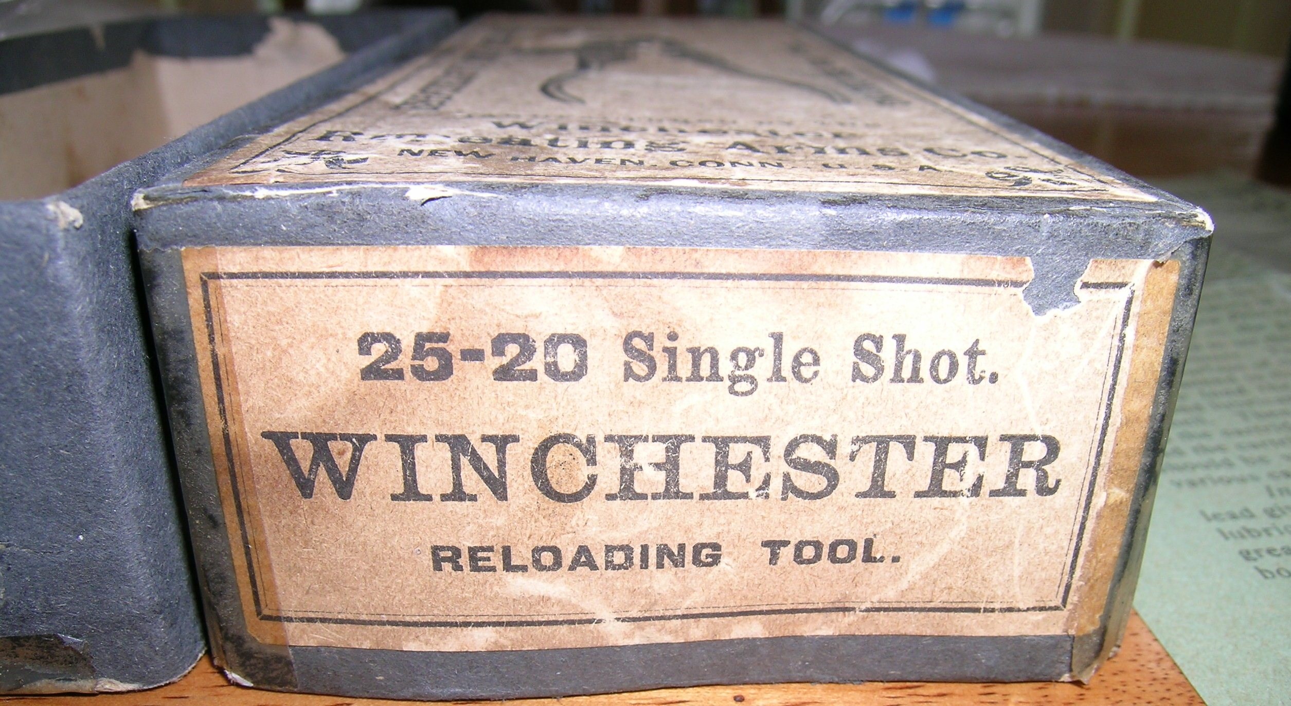

Really… ?
I have this complete boxed set in my collection to compliment the Browning Brothers marked low-wall in the same caliber.

April 17, 2020 - 2:18 pm
Really… ?
Without going out of my way to hunt for them (by no means a favorite, owing to the brass problem), I’ve had 5 or 6 rifles of various makes in .25-20 SS pass through my hands, but never (when I might have wanted one) seen this tool offered for sale, esp. at what seems to me a very reasonable price, $90.
To give us a better idea of the tool’s rarity, what would you ask for yours, if it were for sale?  Or if that’s too abstract a question, what did you pay for it?

April 17, 2020 - 2:53 pm
Clarence,
I paid $700 for it at the WACA Cody show back in 2005.  I have been advised that it is now worth more than 2X that amount, possibly almost 3X.  I have no interest in selling it, and do not know how much I would ask for it if I changed my mind.  My collecting goal has always been to acquire a nice Winchester reloading tool and an original period full box of ammo for each one of my Model 1885 Single Shot rifles.  I have all of the common tools  (32 WCF, 38 WCF, 44 WCF, 38-55, etc.), but finding them in the 40-70 Ballard, 40-90 Ballard, 405 WCF, etc. is a challenge.  Several years ago, I got in a bidding war for a boxed 50-95 WCF set, but bailed out of the bidding at $5,000!
April 17, 2020 - 4:31 pm
Maybe the only one in existence with the full set of original papers, so I don’t doubt it.  Even finding them with the decapping pin & powder measure is unusual.
Forum Posts: 14983
April 17, 2020 - 5:02 pm
Yes indeed, a full set with all of documents and parts is a definite rarity.  Based on it condition, and the dried grease still in the bullet mold, it appears that this set of tools was never used.  It was found sitting on a shelf in a small town gun shop approximately 60-years ago.  It passed through two other collectors hands before I snatched it up.
