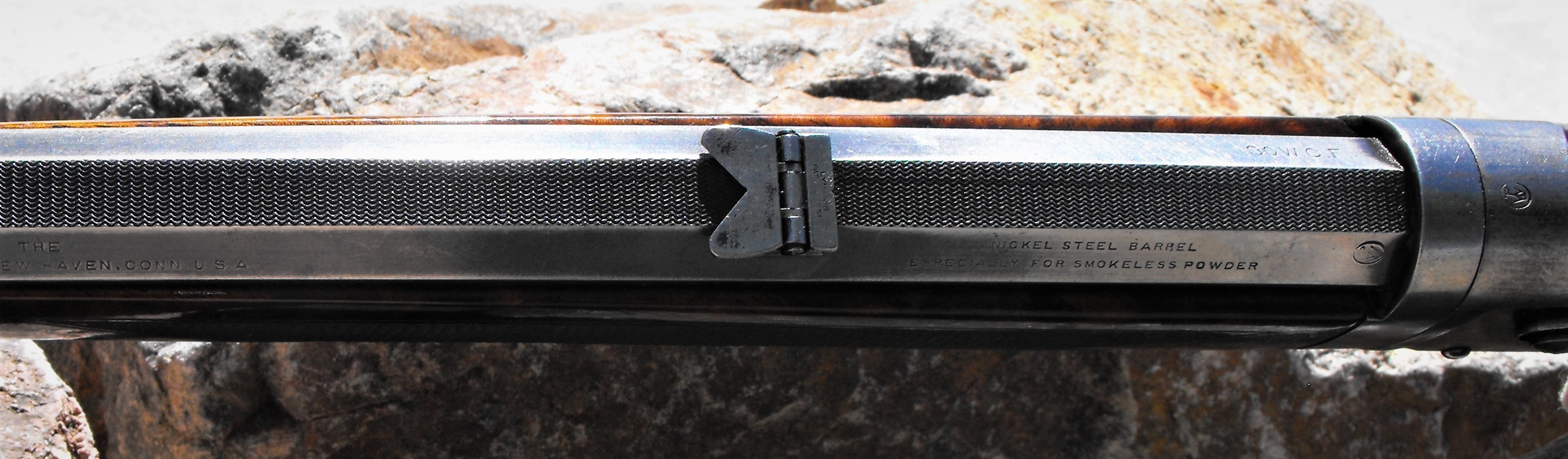

Might be a dumb question but  i bought a lyman 6 sight from a forum member and was wondering if there is a specific way to mount it?
I put the flat top sight the with white triangle facing the shooter but the deep V notch has a concave in it that seems like it should be facing backwards toward the shooter but it isnt.
Does anyone have a picture of the sight mounted?

Sounds like you have the orientation correct. That’s how the sight is made. Here’s a few pics.

What would be the purpose of the white triangle if the shooter couldn’t see it?

You can use either the triangle or the v notch, or fold them both flat and use a tang sight.
The white triangle is facing you. I added some arrows to some of Gary’s pictures to show the sights direction on the gun.

Its weird that they added a concave on the front of the V sight… Almsot seems like it should be facing the shooter. It had me confused.

Its just like every sporting sight Winchester and other manufactures make. The concave side is away from the shooter otherwise you would get glare from the curved surface.
