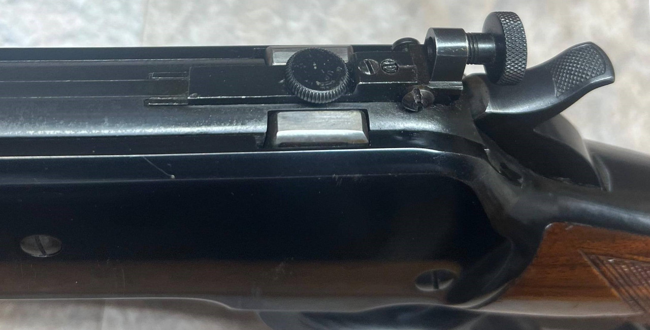

Hello all,
I finally located a replacement 98a bolt peep sight for my 1936 M71
The sight will be here in a week or so.
I noticed after purchasing that the sight I have coming has some differences and I am wanting to know if there will be an issue fitting this in my existing bolt?
My current sight has a single slotted screw on top just behind the aperture and the sight that’s coming has TWO slotted screws in that location (See photos)
I also noticed that the breech end of the sight I am getting has a slightly different shap to the base.
So, the question is….will this new sight work with my current original bolt??
Also, the new sight is missing the elevation nut and spring, but I am hoping I will be able to use my existing nut/spring.
Would appreciate your thoughts and tips on how to carefully do the swap without doing damage.
Another member has already given me some tips, but I am open to all the guidance I can get.

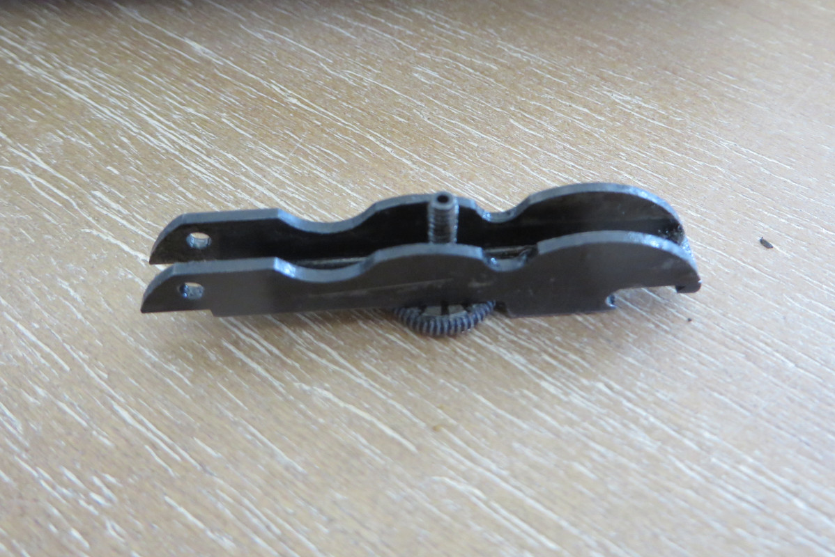

I have both variations and I don’t see any differences in the way they fit the bolt.  I believe they use the same bolt cut out.
However, I’ve never tried to fit them in a bolt myself.

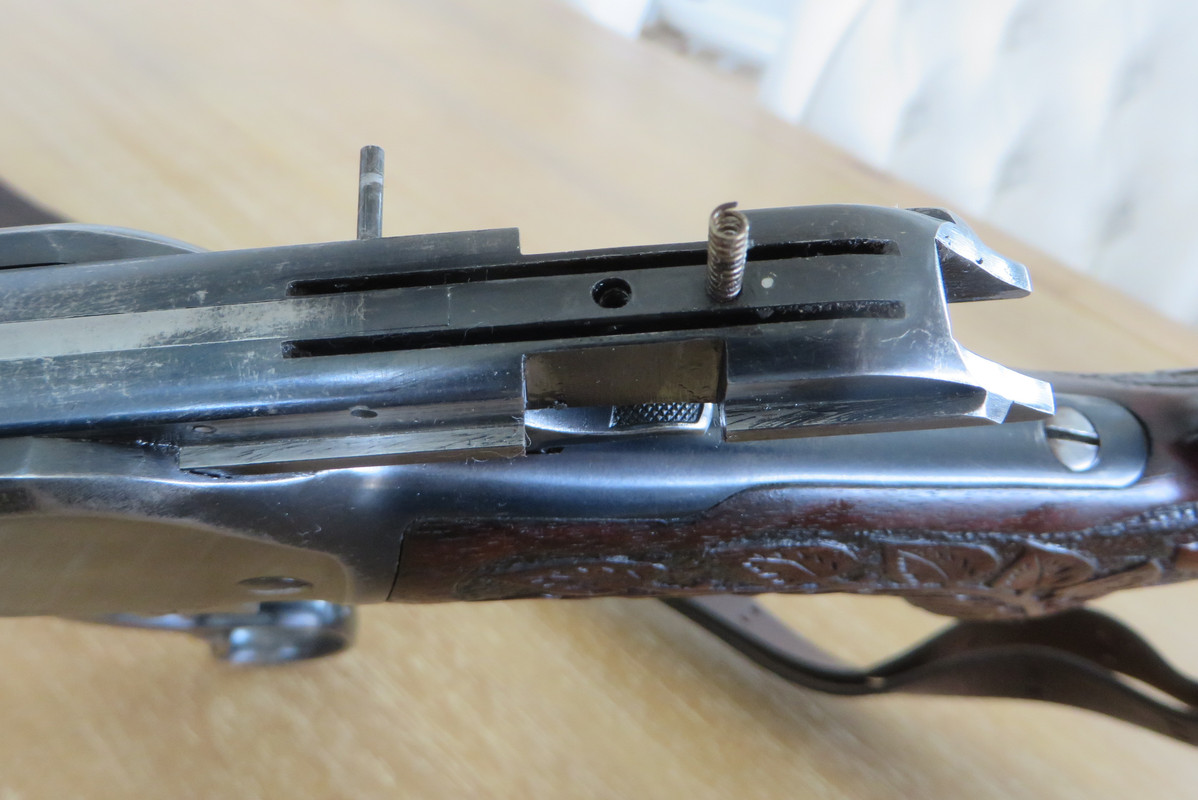

I have removed my existing sight from my M71
Here are photos of the bolt/sight

I’m guessing the 2 screw variation came along later in production as a design change. I’ve seen them both variations.
It would be interesting to see the rest of your early 71… looks like the stocks are carved?!

The rear screw in the top of the sight is a ‘set screw’ for sight “ZERO”.  When the sight’s ‘ZERO’ is established, the second screw is screwed down to contact the bolt. This will not allow  the sight not to go lower than “ZERO”.  In the field if the sight is raised for a longer shot it can quickly and positively be returned to “ZERO” eaisly.  RDB

rogertherelic said
The second screw in the top of the sight is a ‘set screw’ for sight “ZERO”.  When the sight’s ‘ZERO’ is established, the second screw is screwed down to contact the bolt. This will not allow  the sight to go lower than “ZERO”.  In the field if the sight is raised for a longer shot it can quickly and positively be returned to “ZERO” eaisly.  RDB
My sight has two small screws. Is “the second screw” the rearmost one?

October 29, 2026 - 7:52 pm
The set screw is the rear one.  I corrected my original post.  Sory for not catching that sooner.  Embarassed  RDB
