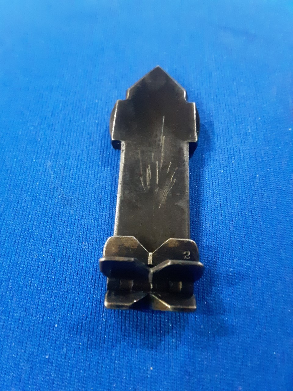

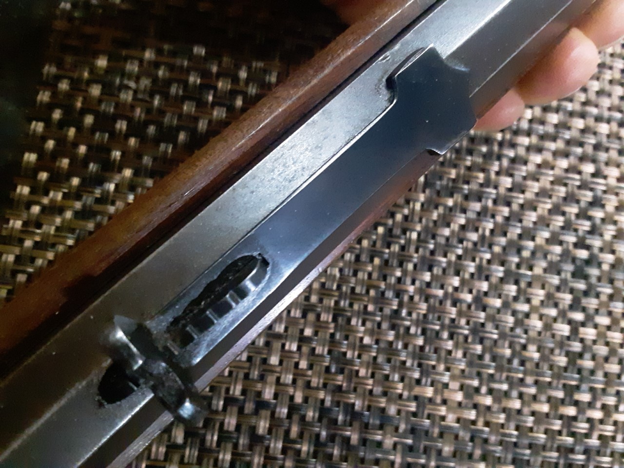

I have a reasonably nice 38-40 that shoots good tight groups. The sights however are sketchy at best. The rear sight, I believe is a late one and looks out of place on #37321 (1894). The Marbles #3 on the front is acceptable save for the partially missing bead which makes for difficult p.o.a. shooting. I have a 3 leaf express that suits the condition, & I think the date, that I’m considering installing. Is it correct for the model and date? I also have a front sight I haven’t ID’d that has been filed down on the top of the sides that I’d rather not use. It’s possibly a sheard marked No. 5 on the bottom. I’d like a correct sight instead. Suggestions/comments?
92-37321-rear-sight.jpgImage Enlarger
92-37321-front-sight.jpgImage Enlarger
3-leaf-express.jpgImage Enlarger
front-sight-1.jpgImage Enlarger
front-sight-2.jpgImage Enlarger
Thanks in advance,
Darrin

Your rear sight is not a Winchester buckhorn sight.  If it were me I’d put Winchester sights on both front and rear.

Just an observation:  The rear sight appears to be a later, post 1930’s vintage sight.  It has the blunted front point.  I believe the rear sight for that time period would have serrated edges  on sight “ears”.  The Express sight is shorter in length and won’t cover the probable elevator mark on the barrel.  The elevator appears to be correct for that time period.  Hope this helps.  RDB

Point well taken. I will attempt to find the correct sight for both front & rear. May take some time. I do have a watch on ebay.
