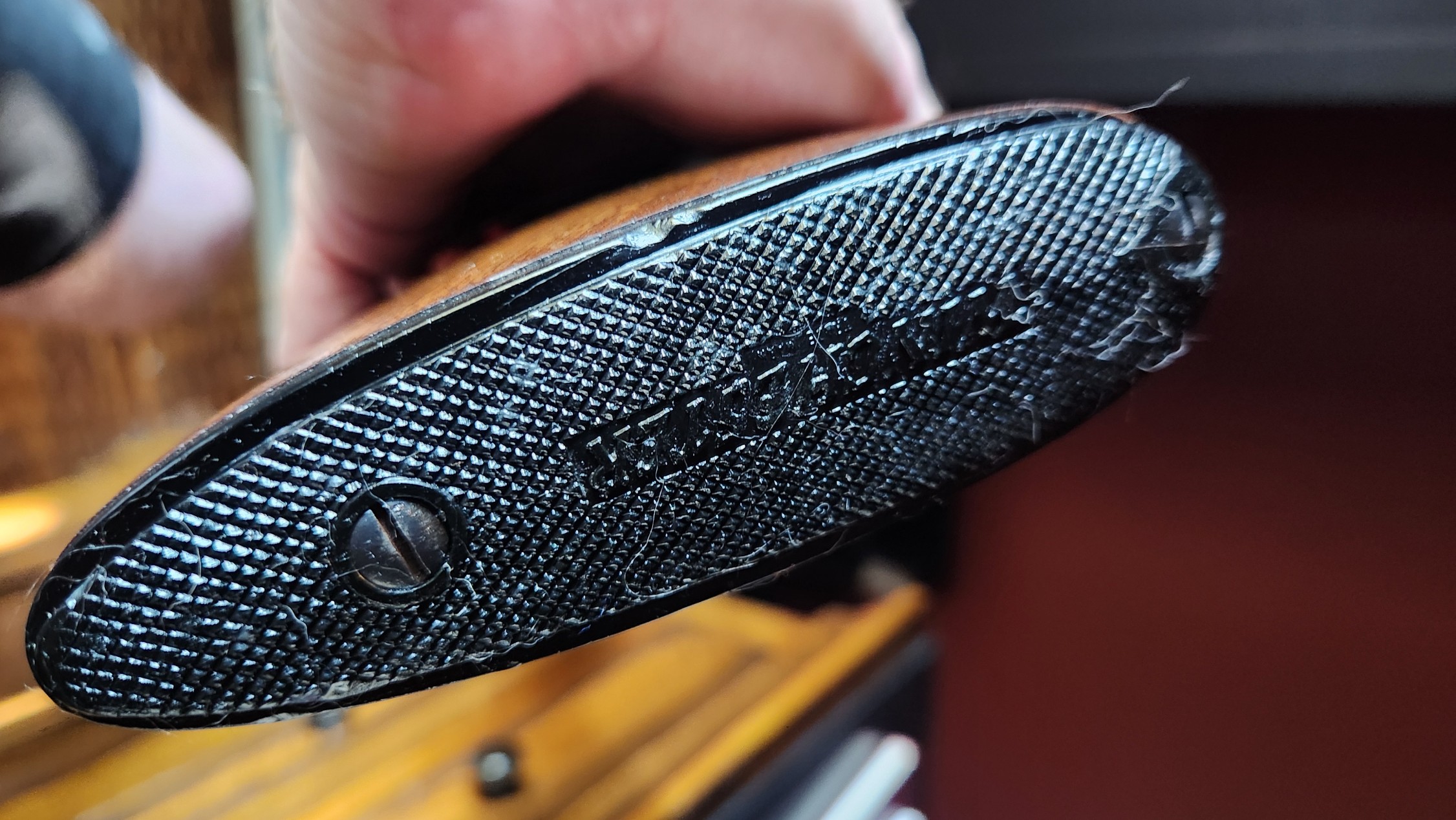

I bought a winchester model 50 in 12 ga that has a added rubber recoil pad, I would like to buy a original buttplate for this gun as the stock was not shortened. I have seen the repros for sale with the round logo but I am pretty sure that is not correct for this gun serial number 80,267, does anyone know what it should look like and if they have one for sale..

Good afternoon, Ken.  I own a Model 50 and the next time I get into the back of my safe I’ll verify what I’m showing you here.
I think the buttplate you are looking for has the single word “Winchester” in the usual italicized type, set in a horizontal stippled rectangle from toe to heel.  In much smaller type below it the words “Trade Mark” appear in the rectangle. The stippled rectangle is set into a much larger oval of coarse checkering that occupies most of the buttplate.
I found a photo of one on the Web:
https://photos.app.goo.gl/Dc4FVw2CZdpCmkgw7

August 3, 2026 - 9:36 pm
Here is sn 47473
https://postimg.cc/8fkJ8rdS

Forum Posts: 1438
August 3, 2026 - 10:25 pm
Here is BP from sn 129029

Thanks guys I saw one near the 100,000 serial range and it was as Bill had a link to so hopefully someone has a gun closer to the 80,000 number to see what I need to look for. I really appreciate you guys checking your shotguns.

Ken,  I don’t think the buttplate changed on the Model 50 during its production. The Model 59, which was nothing more than the 50 Lightweight except for the Dupont barrel, had the same buttplate.

47473 has a buttplate that is different with the round logo, it doesn’t appear to be a repo plate. If someone has a model 50 between 47,473 and 80,267 I would appreciate a picture.

Ken,  the serial of my M50 is 66520 with a DOM of 1956. The buttplate is of the same style as Jeremy’s 129029.
Because 47473 is 20,000 serials lower than mine, even though guns were not assembled in serial number order amd Winchester was known for never throwing any useable part away, I would conclude the more elaborate round logo style seen on 47473 was either;
1. An anomaly or parts cleanup.
Or
2. Earlier standard for the Model 50, superseded by the one-line style seen by serial 66520 and continued through serial 129029.
Because your 80267 falls well between both Jeremy’s and mine, I think.any factory buttplate originally on your gun except the one-line style would be anomalous.
If you cannot find one and if the butt of your stock is still radiused for a plate and not squared off for the existingj pad,  perhaps you should consider installing a round logo reproduction as an interim step while continuing to search for the one-liner.
My views on Winchester shotguns are different than some.of our more obsessive collectors.  I think anyone who owns and actually shoots a 12 gauge shotgun with express loads and doesn’t fit it with a pad is likely not the sharpest knife in the drawer, having lost more than a few points of IQ from being battered repeatedly.
The Model 50 was not a popular product because it weighed more than a fairy’s wings and its short recoil system was doomed to lose against the emerging gas guns.
If mine is any measure of their market value, they are still unpopular because It’s a 95-97% modified choke 1956 gun I knocked down on GB for an embarrassingly low $349.
Unless your Model 50 is a 99.9% gun in the original box complete with hangtags and papers, I don’t think its value is going to be degraded materially because it has the “wrong” buttplate for its date of manufacture, particularly if its a reproduction.
At a guess, nobody makes a reproduction of the “right” buttplate because it isn’t very attractive. The earlier one is more stylish and lots of reproductions of it are available.
If you persist and can find a used “right” plate, the odds of it being undersized and ill fitting are good because final shaping of the stock was done with oversize buttplate installed.
Just my perspective. I am more concerned about appearance and utility because I shoot what I own. I appreciate that many others disagree.

Thanks Bill for checking your model 50 and confirming its buttplate as the straight winchester logo as that is what I will look for.
