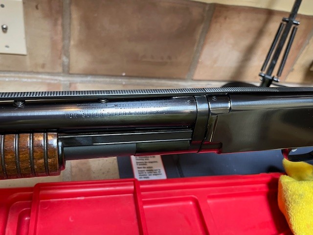

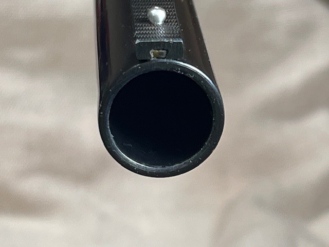

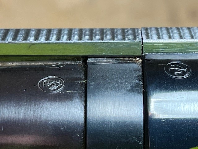

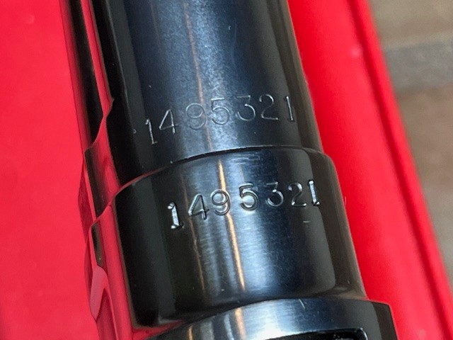

Hello, I’m a new member and own a Model 12 Heavy Duck and would like to verify what I think I know and learn as much as I can about its history.  It was produced in 1953 due to serial number 1495321. It has a “donut” rib with no “Simmons” markings on it but does partially cover a centerline barrel proof mark even though both the barrel and receiver have offset proof marks.  From what I have researched, the Heavy Duck with the donut rib was not available until 1954, therefore I assume my gun, being made in 1953, was originally built with no rib and the donut rib was added at some later date.  Does anyone know what serial number started the 1954 model year?  Is there a way to find out whether my gun was sent back to the factory and had the donut rib added there or was it added by Simmons?  Do the “X” location marks by a few of the donut mounts offer any clues?
Look forward to comments to help verify the history of my duck gun.IMG_8726-1.jpegIMG_8727.jpegIMG_8730.jpegIMG_8749.jpegIMG_8751.jpeg

Serial number 1495321 was manufactured in February 1953.  The first serial number for the year 1954 was 1568661.
While I am most definitely not a Model 12 expert, I get the impression that the Ventilated Rib on your Heavy Duck Gun was added after the fact, and not by Winchester.

I think that that center lined barrel proof mark tells you something.  Also, your shotgun was made just a little earlier then when the Vent  rib was offered as a cataloged item ( as you mentioned).  I have researched these, and have used Serial Numbers from 1,543,941 to 1,770,398, and perhaps a little after the higher number as the range in which Vent Ribs were offered for the Model 12 Heavy Duck  Shotgun.  They do not come up for sale very often.

Bert and Bo, thank you for the informative replies.  I agree that my shotgun did not come with a donut rib, lots of evidence to support that conclusion.   The big question to me is who actually did the work of adding the donut rib?  It doesn’t matter to me when the work was done.   Did the owner send the shotgun in to Winchester or Simmons (or someone else) for the modification?  Would Winchester have done this kind of work in house in the later years after the popularity of vent ribs had commercially increased?
I’ve read a lot about this but so much of it is conflicting information, hence my arrival at this site of historical experts.  My goal here is to be able to definitively say my shotgun was modified by either the Winchester factory or by someone else.  My guess is that Winchester would not install a rib over a proof mark but I have no way of proving or disproving that.  Thanks again for the comments.

I personally do not believe that it is Winchester quality work.  I believe that Winchester would have simply put a new barrel on the gun versus modifying the original barrel.  If Simmons had done the work, the rib would have their name on it.  That leaves a third (unnown) party most likely responsible for the work.

Bill,  I don’t think the answer lies in any records at Cody unless the work might have been done through the Custom Shop. Pauline Muerrle, a WACA member and a former employee of Winchester — the company’s last engraver, I believe, who worked in the Custom Shop and has some of its records — might at least be able to tell you if Winchester would have taken on such work. She maintains a Website and you should be able to reach her by Googling her name.
Another approach might be to research at least which national firms were in the business of installing ribs during your father’s period of ownership. Simmons, of course, and perhaps they might be able to identify their own work. Perusing the índices of Gun Digests for that period might  disclose names of such firms.
I would myself not quit until I had plugged every bit of information about the appearance of the rib and the window of time into an AI engine and see if it produces anything useful. These things have been fed everything available on the Web and can produce surprising results. I myself use Google’s Gemini Pro as a research tool and, while not infallible, it has produced very specific and detailed information.

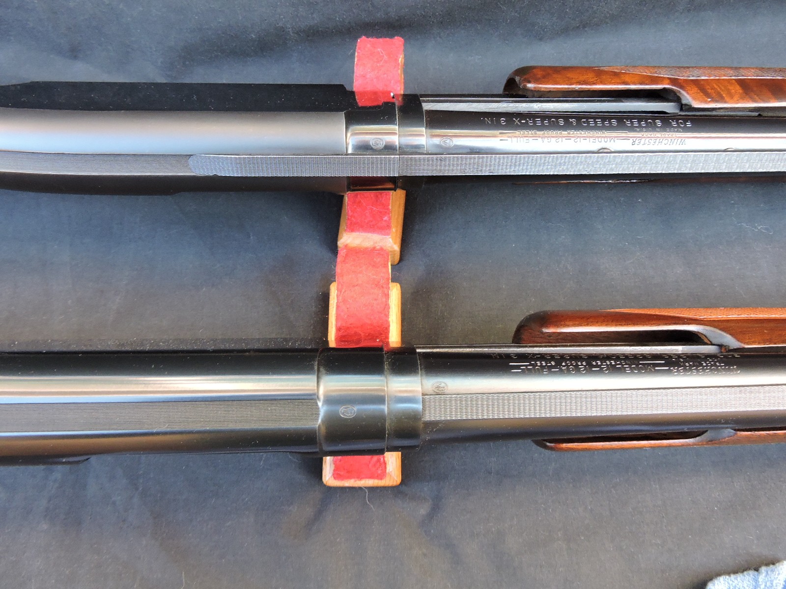

This may or may not help.  “Solid Rib” #1545538 and Winchester “Special Ventilated Rib” #1626627.  For comparison.  RDB

It certainly does help…  for your records;
1545538 – September 1953
1626627 – November 1954

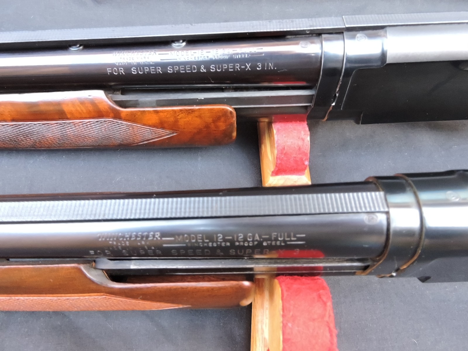

My 28 gauge Model 12 has a donut rib that for years I thought was an unmarked Simmons rib.  On very close inspection under good light and my fly tying magnifier I can see a script signature for Simmons.  Thus sometimes the markings are very faint at least to old and not so old eyes.

I looked at a Model 12 Heavy Duck at auction 5 or so years ago that had a donut base rib and had “Simmons” in very light script, located even or past the end of the magazine tube on the left side. I did not see any address or other markings on the rib.  After i pointed out the Simmons marking the auctioneer was somewhat annoyed, but did announce that it was a Simmons rib and not a Winchester rib.
