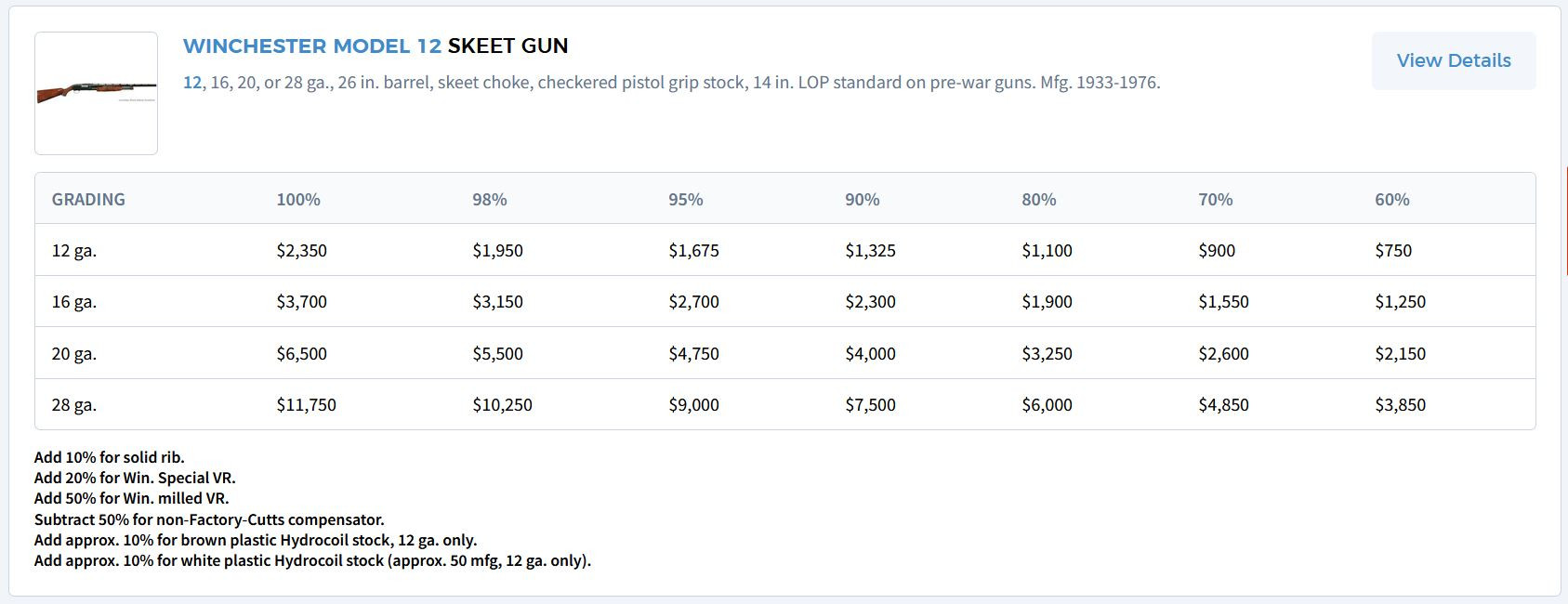

I know all gun values are based on what people are willing to pay…  Just in case I get hit by a bus, I try to keep records with model information and the approximate value of the items I own.  Most are pretty straight forward in the latest Blue Book of Gun Values, but does the 28ga fall under the Model 12 SLIDE ACTION chart since it didn’t originally have a rib, or under the Model 12 SKEET GUN table as a plain barrel without rib adjustment?

Kevin,
First, in my personal opinion, the Blue Book is a poor reference document as it applies to pre-1964 Winchester firearms.
Having stated that, the more correct reference would be the Skeet Gun table.

Just to back up what Bert is saying, many years ago I USED to get the Blue Book for help.  Quickly realized the values reflected therein for the antique lever actions, at least, were woefully out of date at their publishing.  I would have LOVED to have been able to purchase the 1873’s for instance, at the values reflected in the Blue Book!  Just my take on the matter!  Tim
