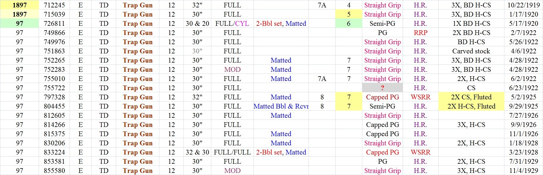

The Model 1897 Black Diamond Trap guns were in production until they were replaced by the Standard and Special Trap guns in the year 1931.  Having stated that, the number of Trap Guns manufactured between April 1922 and December 1930 was very small.  In my survey, I have just (9) documented.   In the July 1897 through March 1922 time period, I have (231) documented Black Diamond Trap Guns.

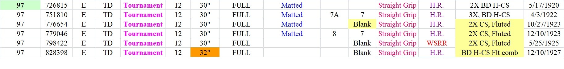

I am not of the opinion that the post-1918 production Trap Guns were “parts guns”.  The following information is directly from my ongoing research survey and lists all of the Trap and Tournament grade guns that I currently have documented.
Per my research (using the original Winchester catalogs), the Trap and Tournament grade guns were officially discontinued shortly after Olin assumed the ownership of Winchester in 1931. Th following is quoted from my recent article discussing the Model 1897 (97) production run.
“As a result of the Great Depression and Winchester’s rapid financial decline and eventual ruin, the Olin Corporation acquired the Winchester Repeating Arms Company out of bankruptcy receivership in early 1931.  Winchester at that time became a division of the Western Cartridge Company.  Production of the Model 97 for the entirety of the 1930s (January 1, 1930 – December 31, 1939) amounted to just 52,709 guns, with no physical design changes/improvements made.  Winchester (Olin) discontinued the Brush Gun, Trap Gun, and Tournament Gun variations in 1931, replacing the latter two with the “Standard Trap” and “Special Trap” guns.“

Not quite.  There is one Tournament Gun (s/n 828398) that was manufactured with the black diamond stock in December of 1927.  That stated, my survey does appear to indicate that the black diamond stocks were discontinued as a standard feature sometime in late April of 1922.
