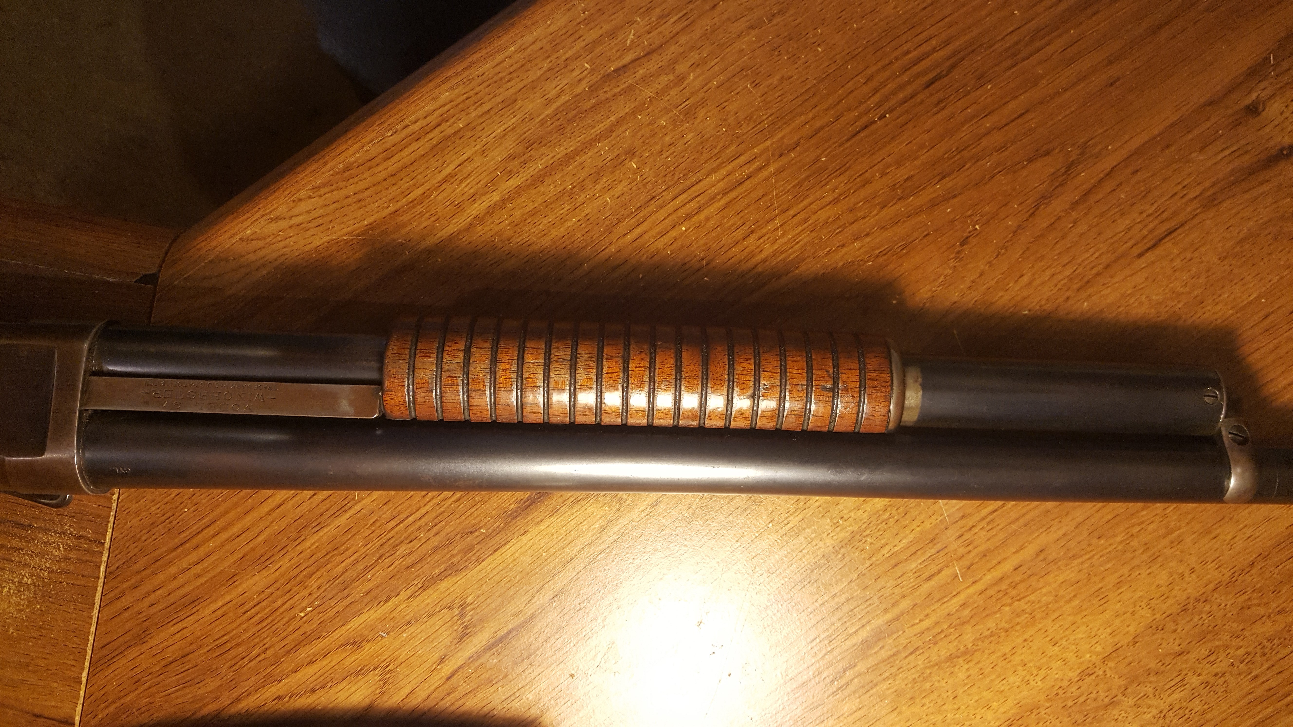

May 25, 2017 - 9:17 pm
Tagging of this old thread about 1897 slide bar markings. I cannot seem to open the jpg. file above, can you please re-upload.
I have an 1897 E series riot gun manufactured in 1914 and I am trying to determine if it has the correct period specific slide bar and handle, please see attached pictures.
Phil
Slide-Bar.jpgImage Enlarger
Handle-and-slide-bar-1.jpgImage Enlarger
Forum Posts: 13292
May 26, 2017 - 3:35 am
Phil,
The slide bar on your 1914 vintage Model 1897 is not correct (original).  It should have a Type-4 slide bar marking versus a Type-7.

Does the slide bar jpg. file names correspond to the s/n ranges of the firearms? Also for my 1914 Model 1897 would the slide bar and handle have a screw on each side of the handle? I am not clear if the slide bar/handle screw version was model specific or period specific on the 1897’s.
Phil
Forum Posts: 13292
May 31, 2017 - 2:56 pm
Phil said
Thanks Bert.
Phil
Phil,
The 3-screw slide handle stock was only used for the pre “C” and the “C” series guns.  The deletion of the 3 screws was part of the change that created the “D” series.  By the year 1914, all Model 1897 shotguns were “E” series guns, and were using the Type-4 slide bar marking.
