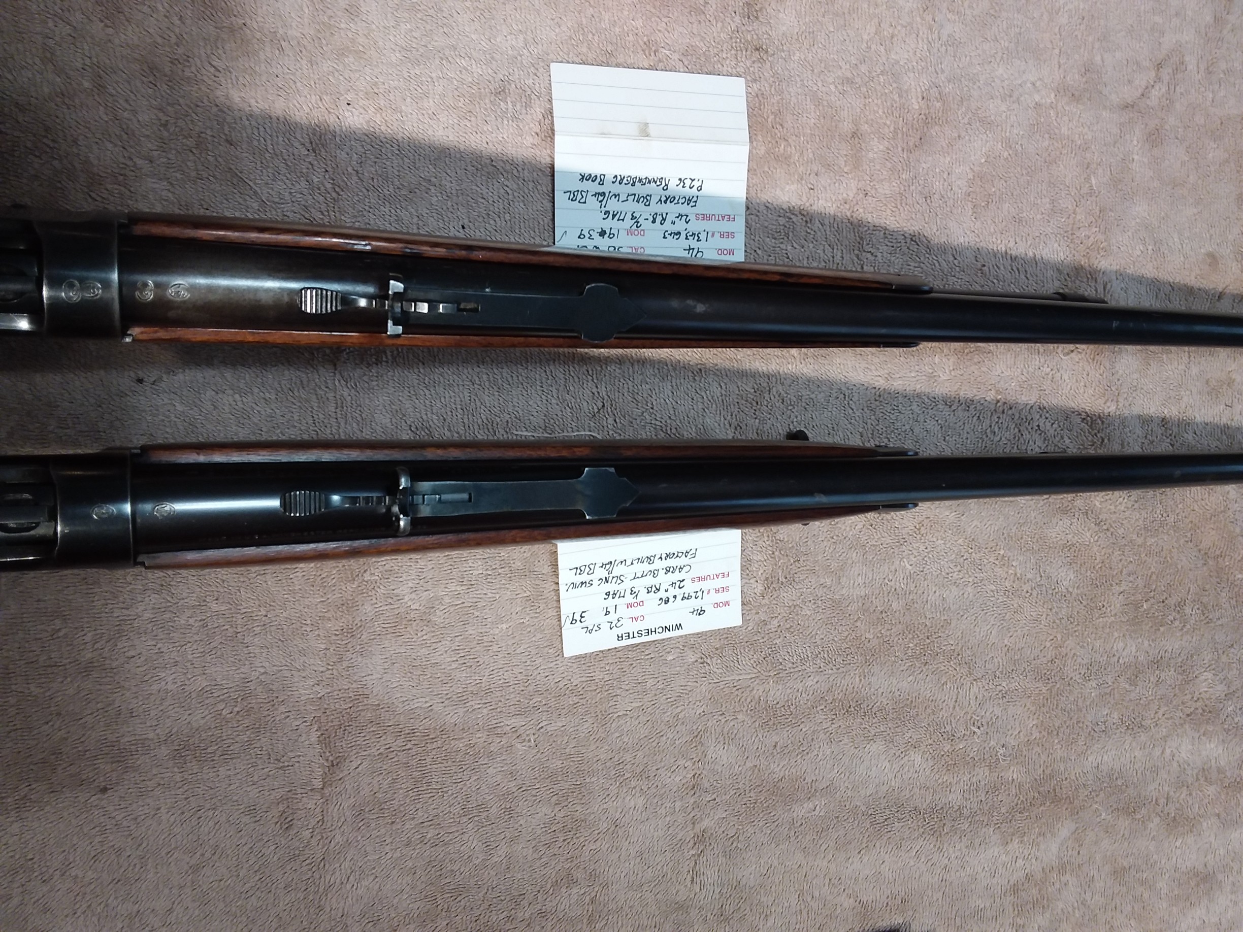

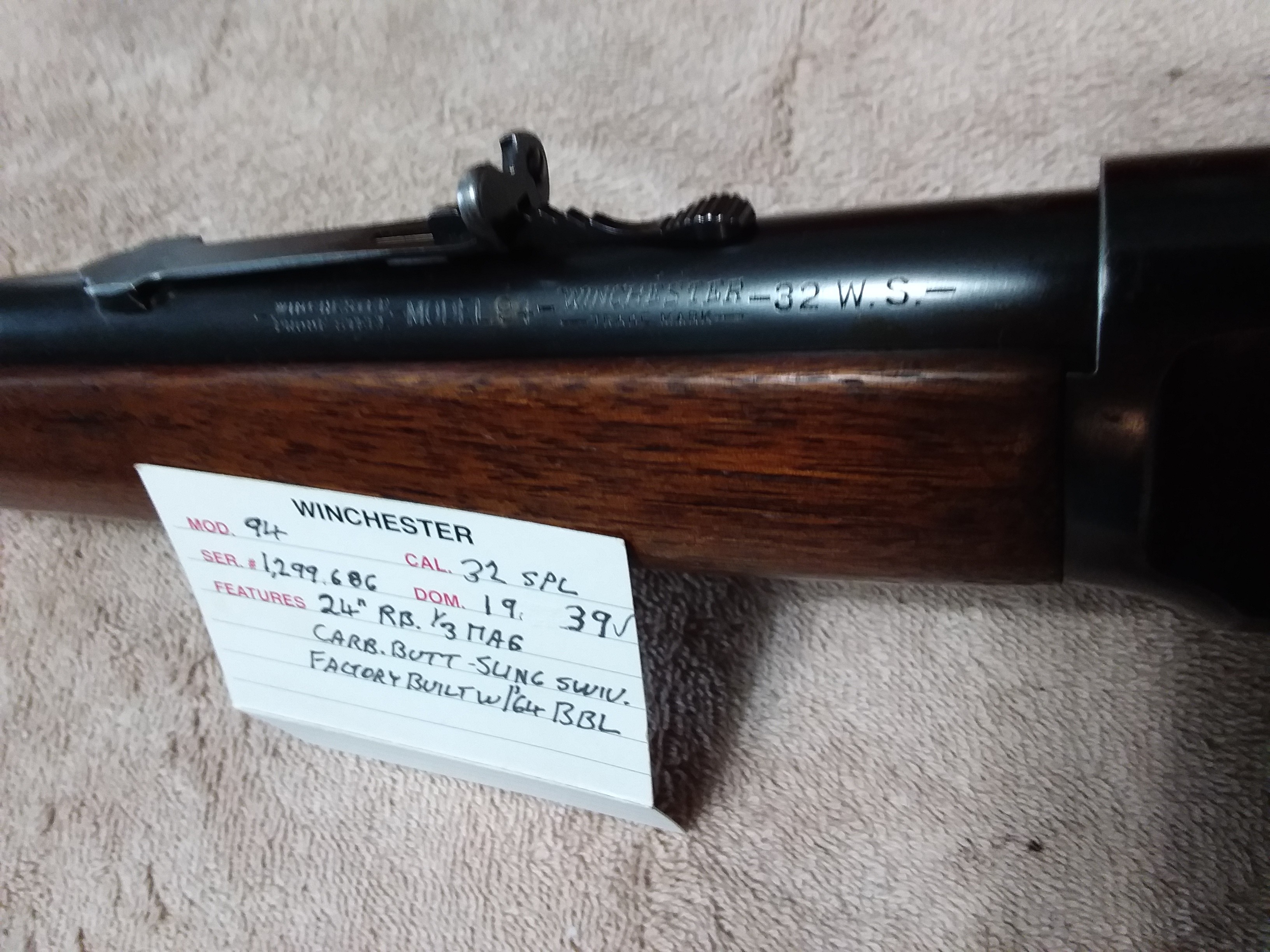

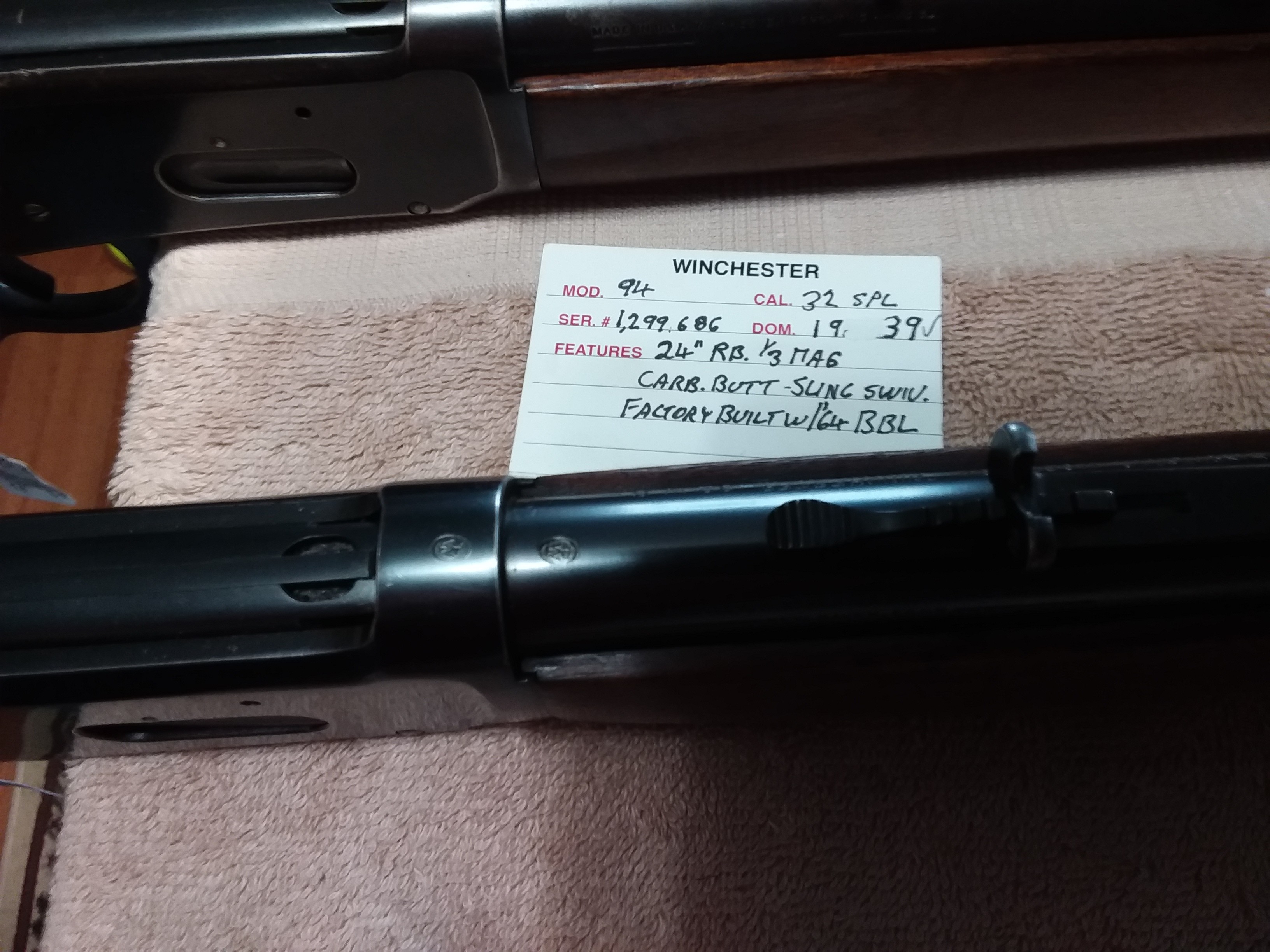

20201117_121258-1.jpg20201117_121321.jpg20201117_121446.jpg20201117_121517-1.jpg20201117_121715-1.jpg20201117_122039-1.jpg  Not the best pictures in the world but best I can do. These 2 guns have differences in that# 1299686 has the proper type 7 tang markings and it has a mod. 55/early64 forestock, a little fatter than a ’94 forestock, the barrel is stamped MOD 94. It also has , what I believe factory sling swivels but I could be wrong on that. In comparison ser#1343643 has a blank upper tang which is several thousand #’s before they were believed to be blank (as per Rennenbergs book vol.2, p126), it is barrel stamped MOD 64 and has a mod ’94 fore stock. Both guns have the mod ’55 butt plates and the unfluted  mod ’94 butt stock.I would be happy to provide any other pics etc. or answer with, My opinion only, any other questions. Thank You every one for Your input and opinions on these guns. I have found over the past 55 years in this hobby that nothing is cut in stone pertaining to Winchester’s practices. I have had , literally , several thousand ’94’s over the years from ser#601 to ser#6668900 and have found many discrepancies in the manufacture of them. I definetly do not intend to cause any controversy, just stating what My thoughts are.
Hi Henry,
Thanks for the additional photos!  I cannot speak intelligently about the authenticity of either of your rifles because the .30 hole in your barrel is outside my .22 knowledge base Wink  I was very interested in the dual-marking on both the receiver and barrel though as that provides another data point for research.  Thanks again for posting.
Henry,
The last Model 94 with an upper tang marking was serial number 1343183.  Your gun with serial number 1343643 is correct with a blank upper tang..
My observation of the gun with the double proofs on the barrel and receiver is this… the position of the “P” stamp on the barrel indicates it was applied before the “WP” proof.  The position of the “P” stamp on the receiver frame ring indicates it was applied after the “WP” proof.  What this leads me to believe, is that the rifle was originally manufactured and proof fired with a different barrel on it.  At a later date, it was fitted with a mail order barrel (possibly Winchester factory), and proof fired & marked.  However, that does not explain the “P” stamp on the receiver frame.  In the past, I have seen several Winchesters with the double proof stamp on the barrel, but a simple “WP” on the receiver frame, and that makes sense for a factory rebarreled gun where Winchester pulled the barrel out of the mail order stock room.  However, and based on the manufacture date for both of your rifles, it Winchester would not have needed to pull parts out of the Mail Order parts room, as the Model 94 & 64 was still in full (regular) production.  New parts (barrels) were readily available.  The other indicator that the rifles were not original factory work is the butt stocks & butt plates on both rifle are of Model 94 origin versus a Model 64.
In the end, we will most likely never know what the true story is behind either of those rifles, and almost anything could be possible.

Thank you, Henry for the added photo of the double receiver proofs.  While I claim no knowledge of the M94 (or any of its variants), I’d agree with Bert that it looks like the BARREL “WP” proof was added after the “P” mail order proof, while the receiver “P” proof was added after the “WP” proof.  As you said, this could indicate that a rifle was rebarreled at the factory using a “P” barrel from parts inventory, then proofed with the new barrel so as to earn the “WP”.  Pure speculation, but maybe the “P” was stamped on the receiver to indicate that the rifle had been proofed with the new “P” barrel.  Stamping it “WP” a second time wouldn’t have conveyed that.  I guess we’ll never know unless a WRACo. document turns up specifying a procedure for replacing barrels at the factory…
What prompted my query was a M70 lot (Lot #3093) sold in the last RIA Regional Auction:
https://www.rockislandauction.com/detail/1035/3093/pre64-winchester-model-70-bolt-action-heavy-barrel-target-rifle
This is a very messed up gun in ways I won’t dwell on here, but the description stated “With factory “P” in oval proofs on the barrel and receiver.”  The double proofed barrel “P” and “WP” is a RAMPED 250-3000 SAV target barrel.  While RIA would not pull the gun apart, that would most likely make it a ’36 (or earlier) barrel, that must have been sitting in parts inventory.  The reportedly double proofed receiver is S/N 51957 (1942) which is WAY too late for a ramped target rifle.  What I’d speculated was that the rifle was originally chambered for something else, then rebarreled (inside or outside the factory?) to 250-3000 SAV using an old “P” barrel.  Along the line it acquired “P” stamps on both barrel and receiver and “WP” on the barrel.  Unfortunately, I neglected to ask RIA for a close-up photo of the proofs, although I did get sufficient additional photos to convince myself that it was a genuine ramped 250-3000 SAV barrel.
Definitely a “parts gun” but not sure who put the parts together… Wink
