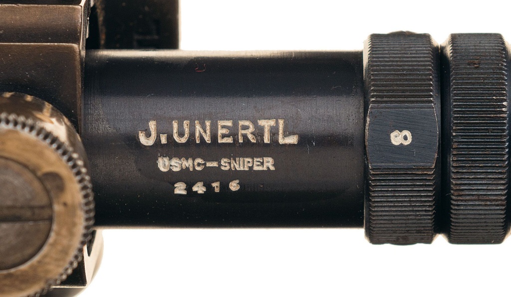

Since we’re talking about scope bases, I have some mystery ones that have me baffled. These appear to be Unertl bases, but the long bases doesn’t appear to fit the receiver of any rifle or barrel (won’t line up with existing holes on my original USMC M70 barrels). They are also marked USMC-SNIPER on the bottom. The font also appears to be the same as the USMC-SNIPER rollmark on the 8x Unertl scopes, so maybe they used the exact same rollmark/stamp on these?
Compare the photos below with a photo of a Unertl scope (not my scope, random pic from the internet), you’ll see that the markings are identical. For example, the left side of the letter “M” is slightly raised on both stamps. When you compare them, you can see other similarities.
I’ll take some measurements later, hopefully we can figure out if these are some kind of M70 bases.

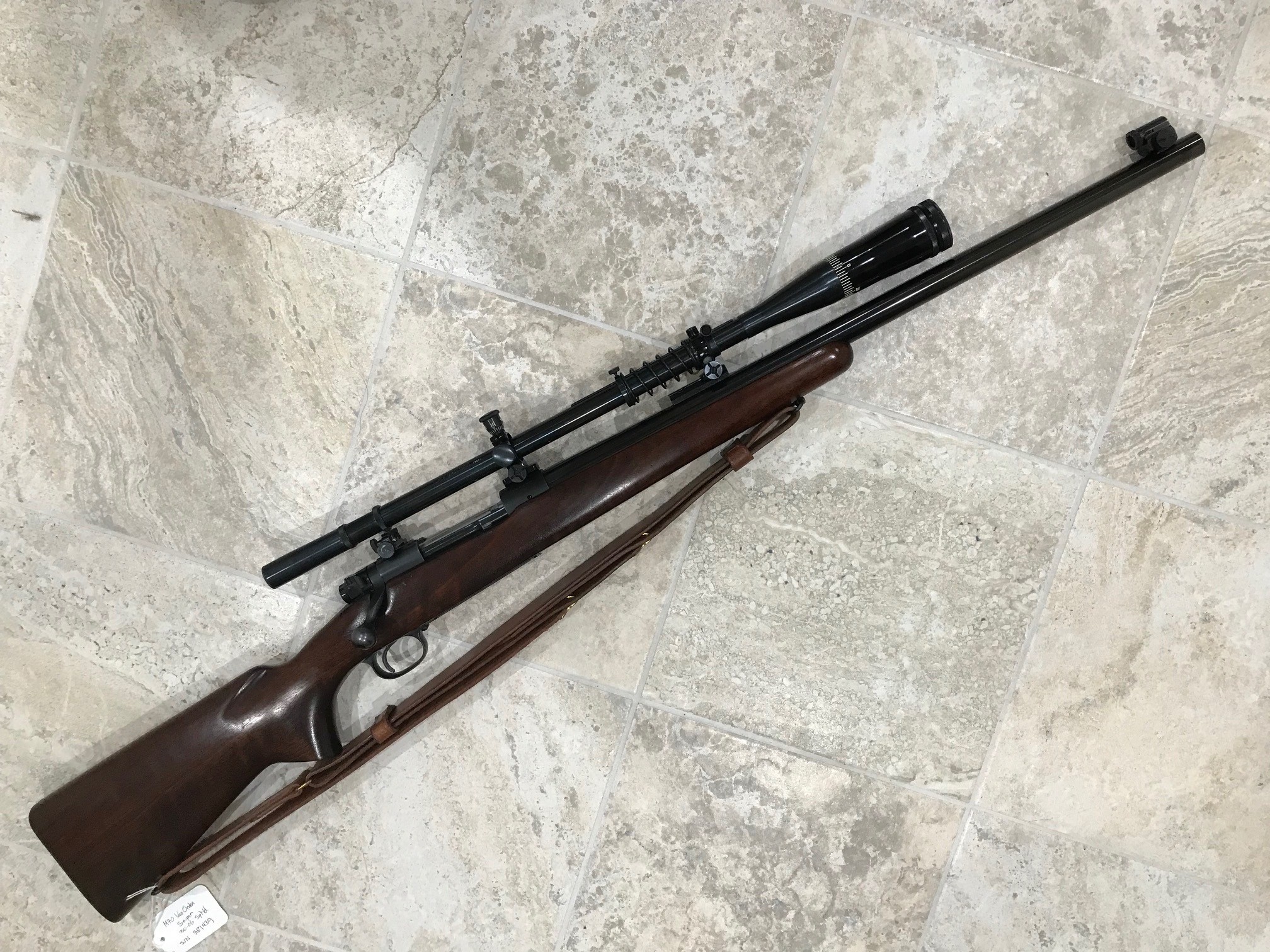

Great looking Van Orden, the Lyman scope is perfect for it!
I don’t think the Corps had more than the original shipment of 373 M70’s, but they did order more rifles a few decades later. Even though 371 rifles were given the authorization to be sold, it doesn’t mean they were actually sold. Maybe it just gave unit leaders discretion to make space in their armory? Maybe the missing serial numbers in DFA weren’t just damaged or war lost rifles; what if the majority of the missing numbers were the rifles that ended up being sold? In a previous post I showed an M70 that was sold in Japan 1971. That rifle isn’t on the DFA list and was probably allowed to be sold decades later because of the 1944 authorization.

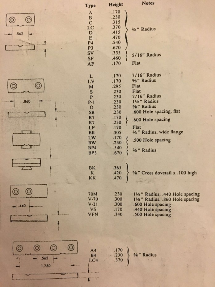

Hi USMCSGT-
Referencing the page from the Unertl scope base chart (copied below), depending on the bottom radius the closest Unertl block to the short USMC sniper block would be either the P (7/16″ radius), P-1 (1 1/8″ radius) or O (5/8″ radius).  All 0.860″ hole spacing and 0.230″ tall.
FWIW…  A standard M70 receiver could use the P block on the receiver (front) ring, since it has the same bottom radius as the L block.  It would just be a taller block that would need a correspondingly taller front (barrel) block.
The P-1 block would go on the bridge (rear) ring of a standard M70 receiver.  Same hole spacing, but with larger radius to correspond to the contour of the bridge.  Thing is that a P-1 block wouldn’t work on the bridge of either a pre-war M70 or one of the M70 Target rifles purchased in the 1950s for rifle team use.  Throughout production, M70 target rifles (National Match, Target and Bull Gun) in 30-06 (not other calibers) retained clip loading slots and had a closer hole spacing on the bridge like on the H&H magnum receivers.
When you say the USMC bases have less radius than the “L” block, did you mean both the short and long USMC bases, or just the long ones?  If the short blocks have less radius than the L block you’ve got, they’re likely similar to the P-1, which raises the issue about their ability to be used on a M70 target receiver bridge.  Any chance these blocks were intended for something other than a M70?
Not sure this helps… Frown

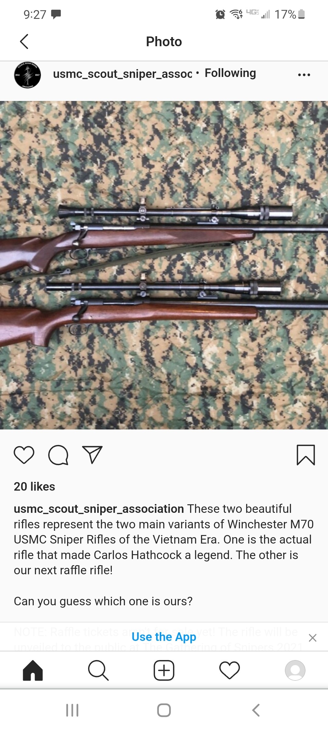

The SSA just posted a teaser of their upcoming 2022 raffle rifle on Instagram! I posted this info here in the vintage section because the raffle rifle appears to be some sort of Winchester M70 Vietnam War era USMC sniper rifle! The raffle rifle was also photographed alongside Carlos Hathcock’s Vietnam War issued M70! More information on the raffle rifle will be posted this weekend, but I can tell you is that it’s an epic clone build using original USMC M70 sniper rifle takeoff parts!
The rifle is going to be unveiled this weekend at the Gathering of Snipers at 7 Foxtrot Firearms Training Complex in Pearsall, TX. Guardian Long Range is also holding a match there this weekend, so it’s going to be an awesome event! The raffle tickets will be up for sale sometime before Christmas and the drawing will be held on March 17th (03/17, the USMC Scout Sniper MOS is 0317).
