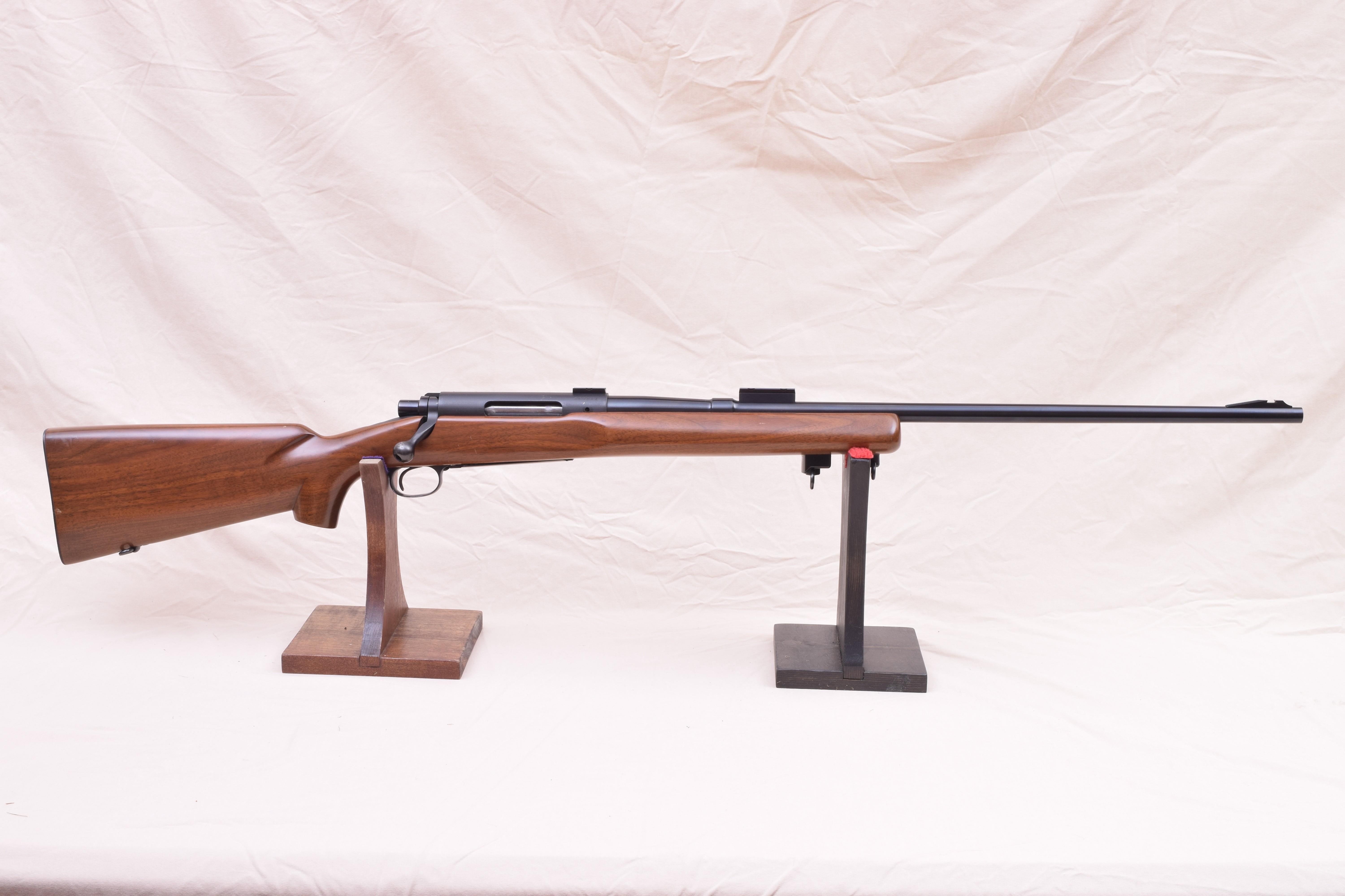

Hi Ned-
Fascinating topic… Laugh  Unfortunately I have no special knowledge of these rifles to share.  Hopefully you’ve gotten some PM replies.  If not, I just wanted to “bump” your thread back up to the top of the page in case someone who can help hasn’t seen it.
Can you tell me a little more about the rifle in your photo?  S/N 499842?  What’s the barrel length (in the photo it looks like 26″) and what is it chambered in for?

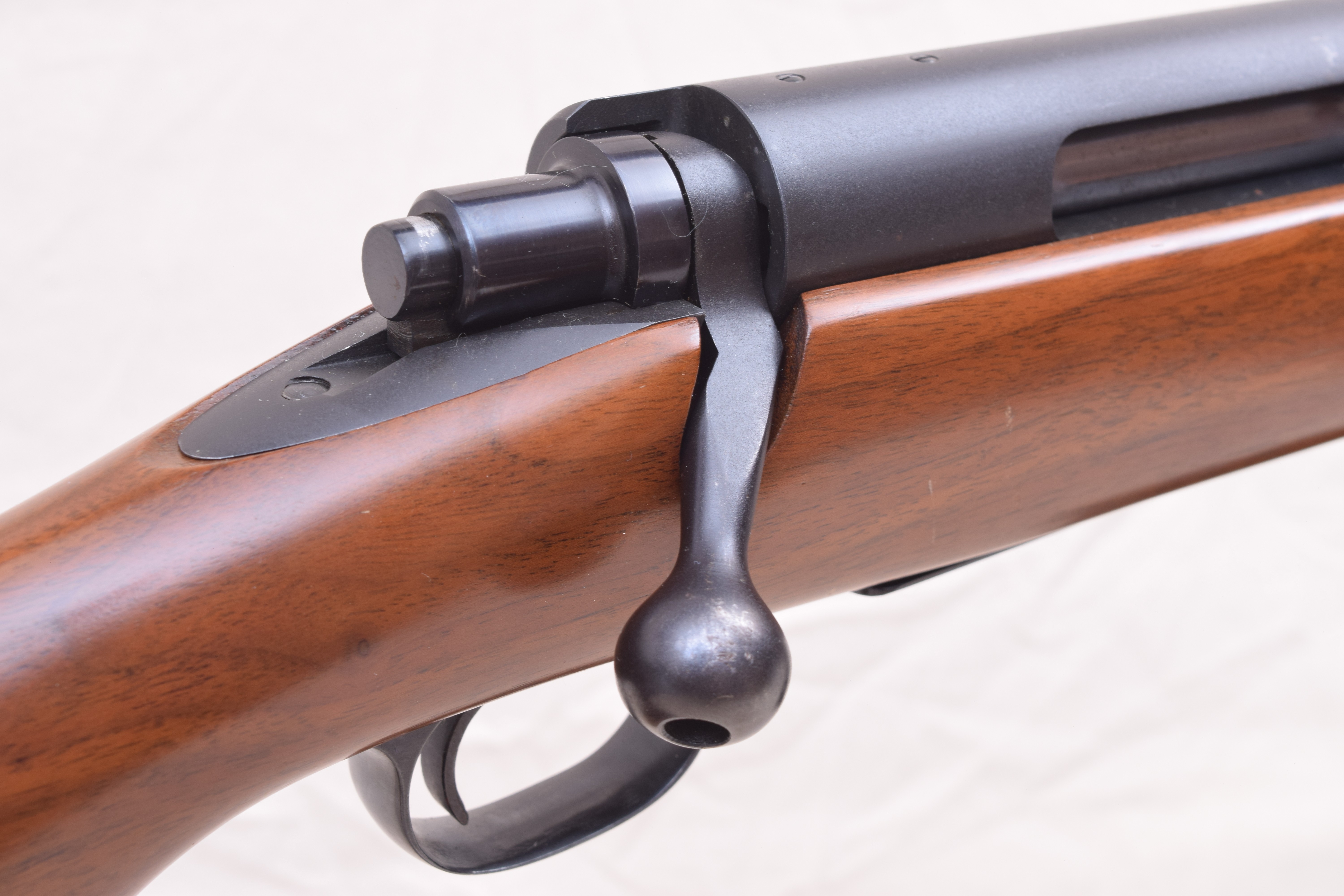

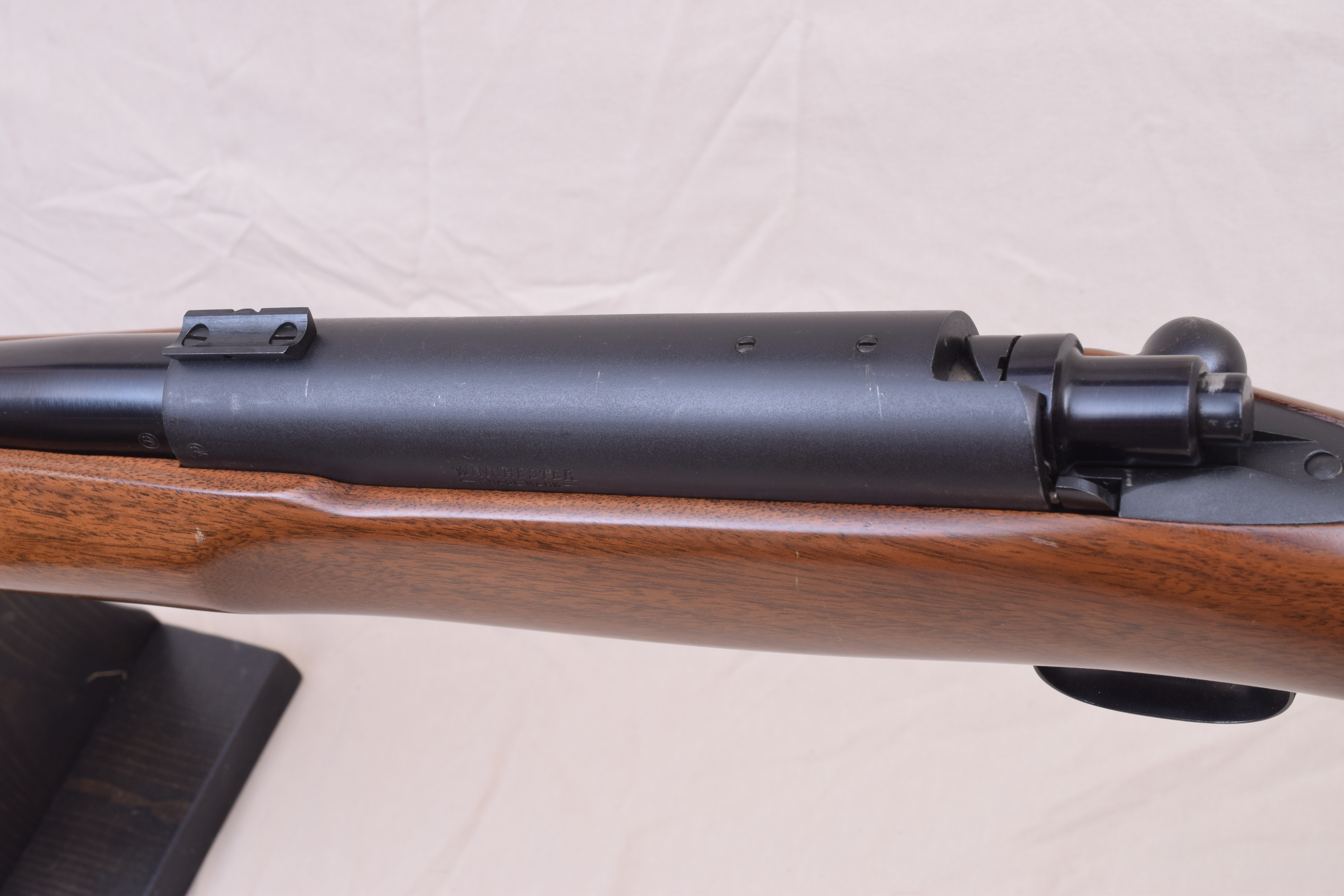

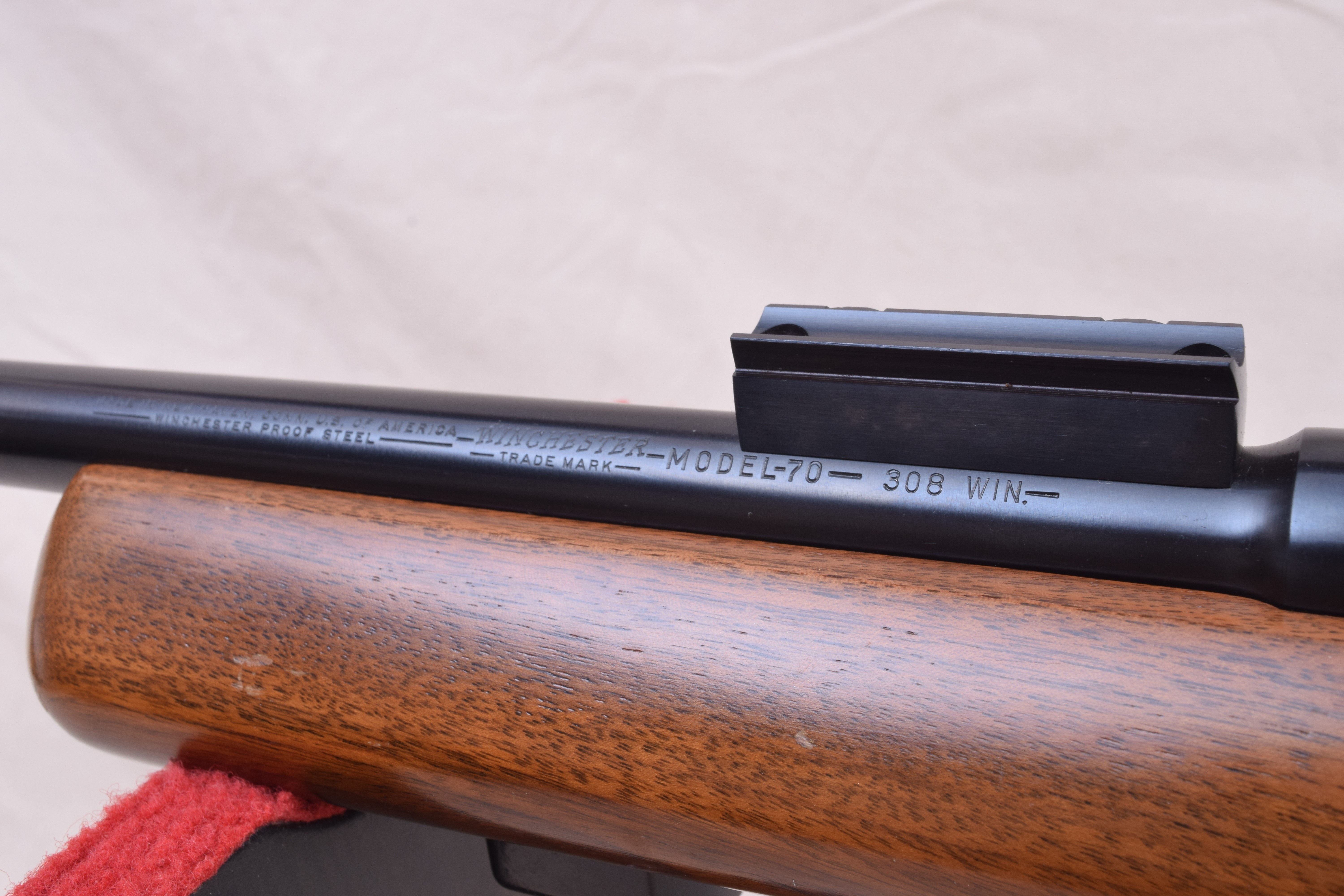

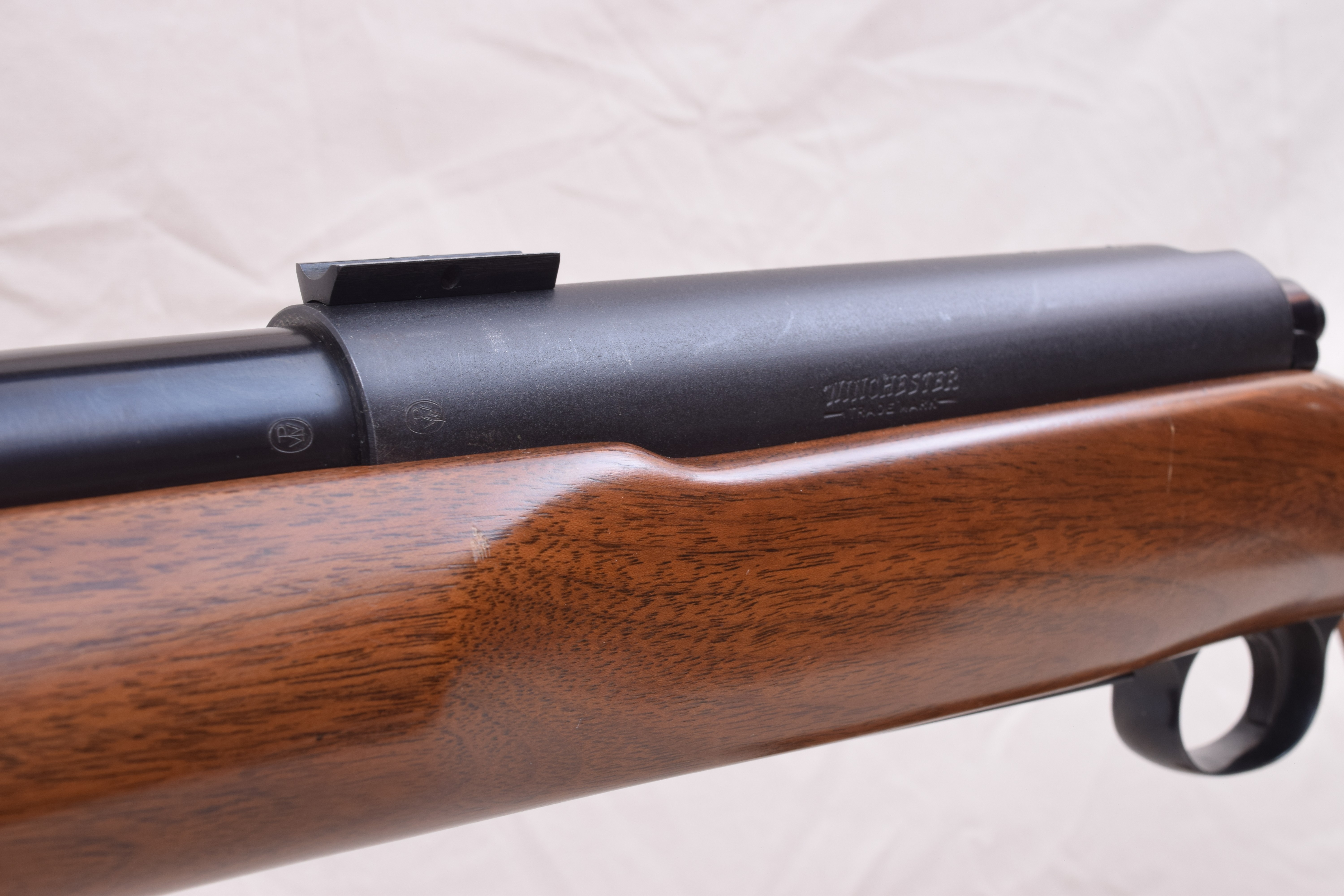

DSC_0138.JPGDSC_0143.JPGDSC_0144.JPGDSC_0156.JPGHello Louis & James,
Thanks for the interest. I have not received any messages. I rather doubt that I will. This is the mostly unknown chapter of the M70.
This particular rifle was one of a group constructed in conjunction with a contract group of barreled actions built for the US Army Advanced Marksmanship Unit that fall in the S/N range 499810 to 499842. It is part of the 3rd of 4 distinct groups of M70 single shot’s built between 1956 & 1968. It’s built in the national match style, with a 26” standard weight barrel with no provision for rear sight and chambered on .308 win. Front sight ramp is standard height.
The most interesting feature is the bolt. This series of rifles were built with a newly designed post 64 style bolt and fitted without a safety. This is likely when the post 64 bolt was first conceived. The members of the marksmanship unit were not entirely happy with pre 64 bolt design. In particular the lock time. Winchester responded with a new design incorporating a fully enclosed bolt face. The barreled actions that went to the AMU and the various test configurations that Winchester built into complete rifles all exhibit the new design. Some were fitted with aluminum firing pins with steel tips in order to reduce weight and lock time.
Iv’e attached some additional photos of this rifle.
