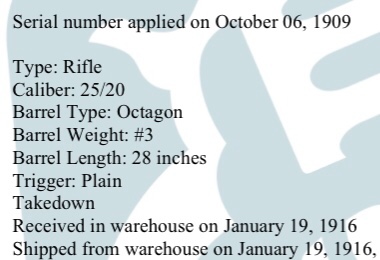

I recently looked at a high wall SINGLE SHOT 25-20 DOM 1909. The owner had described it as rare due to its caliber with a high wall configuration. It would be interesting to know what Winchester was thinking but I have to surmise what the customer wanted, the customer got.

Did it have a letter confirming the original calibre configuration?  To prove the barrel wasn’t changed.
I would think it would be a rare customer, if at all, who would even care if it was a low wall vs a high wall.  That was internal to the factory, I should think.

The serial number was applied in 1909 and it did not ship until 1916.  The Model 1885 was discontinued in 1920, and by then, it was fairly unpopular, and the .25-20 was not a particularly desirable calibre, either, so it might have been simply a means of fitting a barrel and receiver together, independent of the configuration, just to use up stock.

Ya it could’ve been. Like I said previous, it would be nice to know what Winchester or the production team was thinking or would allow. JWA might have internal memos in his files on some of this stuff.

Can’t read letter.  If it has a #3 wt. brl., it would have to have a HW rcvr., because it would need the large brl. shank.  I have one in .32 WCF with a #3 brl.  (Sure helps to tame the heavy recoil of a .32!)  LOTS of them were produced in .25-20 SS, if that’s what it is.  If it’s .25 WCF, that’s very unusual.

They would “allow” anything a customer would pay for, if it was technically feasible to mfg.
 “Model 1885”?  It was simply the Winchester Single Shot.
25-20
#3 oct barrel
December 6, 2020 - 4:20 pm

That accounts for the HW rcvr, but which .25-20?

Rick,  neither attachment will open.  What does the letter SAY the cartridge is?
RickC
December 6, 2020 - 4:47 pm
Ok sorry Clarence not sure why. The barrel is stamped 25-20 SS.

Bert may have some numbers on how many were in 25-20 SS.
