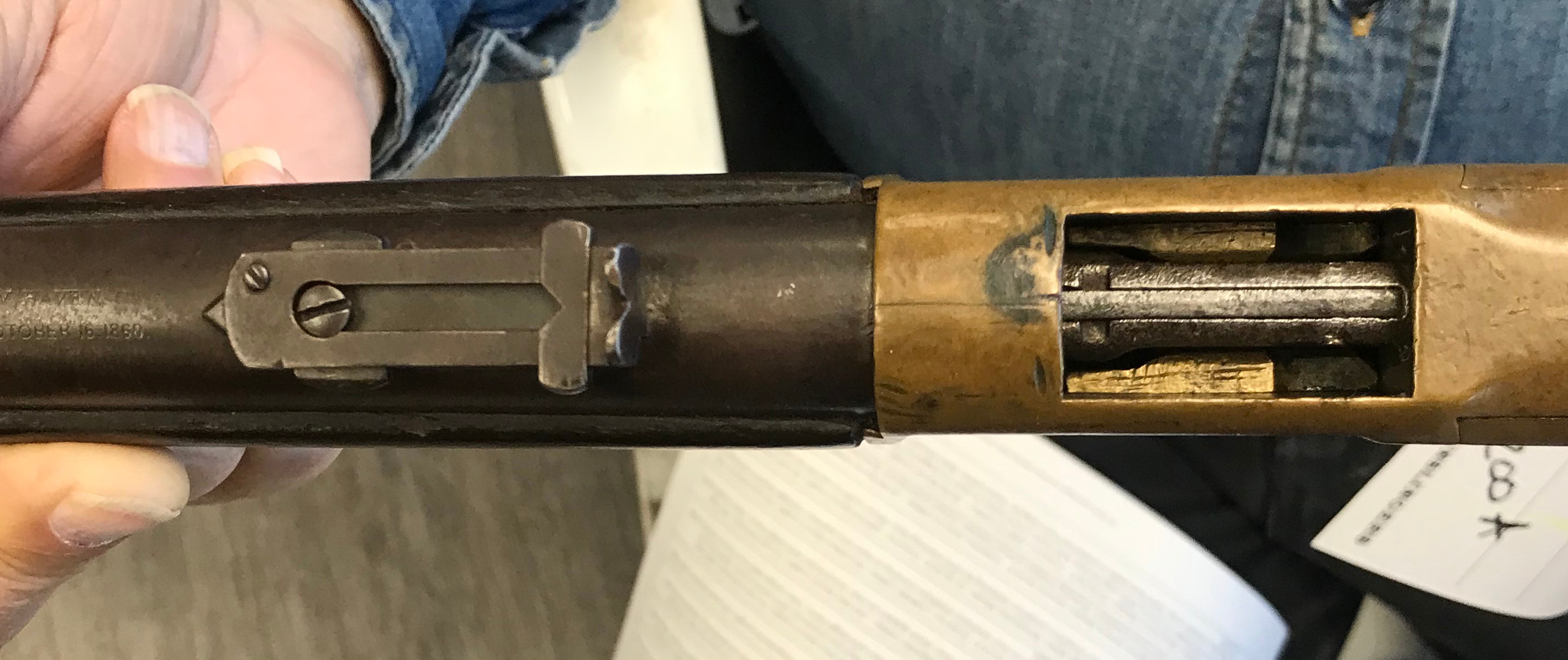

I looked at the gun at the shop again.
Serial #101199.  No caliber mark on the barrel.  Conversion has a bushing.  Bore is rough but will clean up some.
