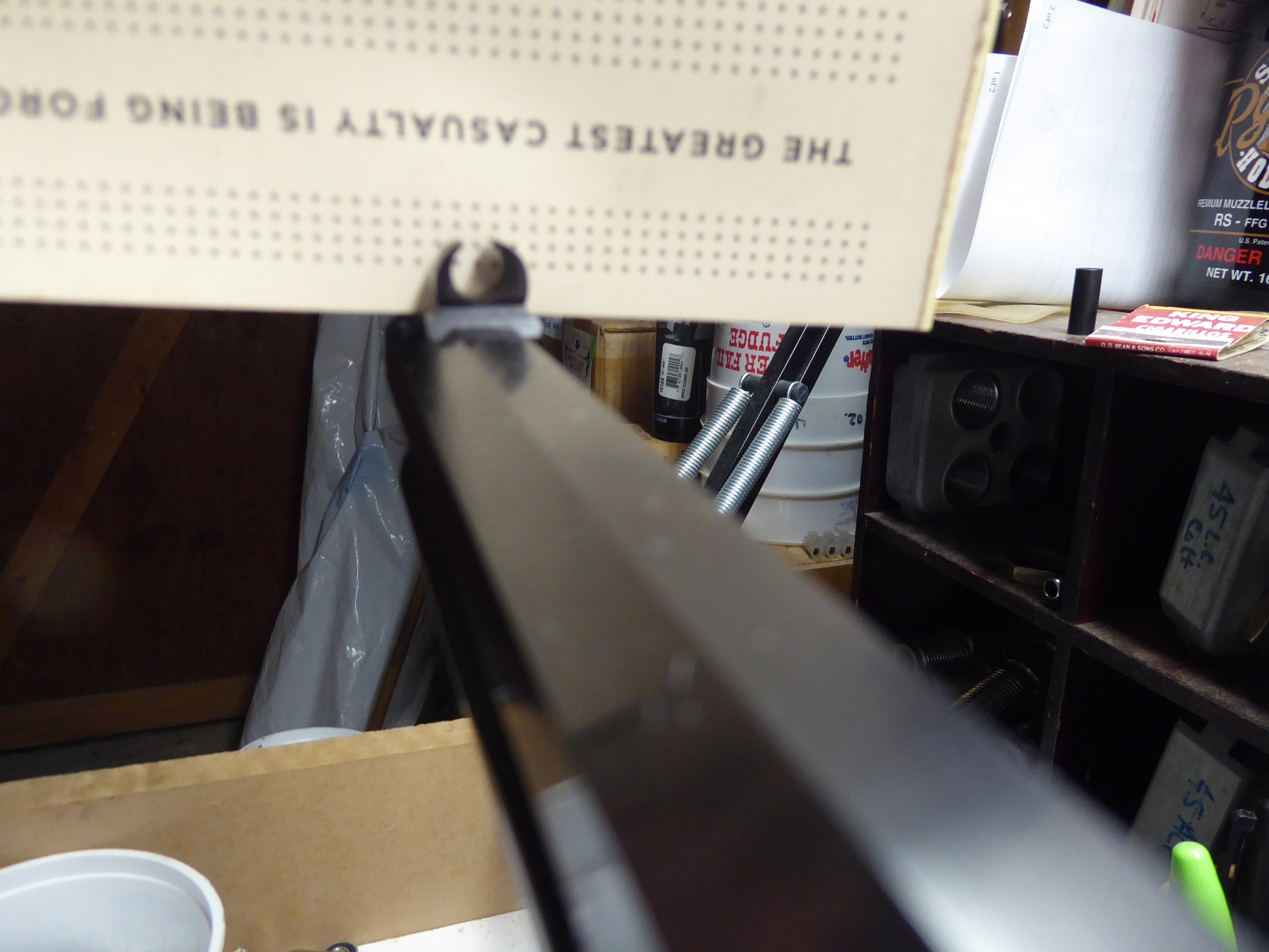

pictures of front sight.P1020598.JPGdoes any know about this sight. the rear sight is v notch with elevator.
September 19, 2019 - 1:15 pm
Looks to me like the “horns” might once have held a tubular globe, which might have contained interchangeable inserts, or some other aiming point.  But it’s unusable in its present condition.
