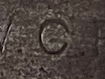

It sure looks like the middle letter, which win4575, has pointed out, definitely looks like a “G”, and not a “C”, as it should be.  Being more pronounced than the, “W”, and the, “F”.  The “F”, also stands out a little more than the, “W”!  It sure is possible that these last two letters we’re re struck, and the reason a “G”, might have been used, is who ever did it, might not have had a letter, “C”, and or the letter ‘W”, for that matter,  in their metal stamps. Due to the angle of the picture, the “F”, doesn’t look to be struck as hard, but again that could be the different angle of light in the photo. Because it does look to have been struck fairly hard enough.It sure looks like it’s been there awhile! In reference, I am wondering if anyone has seen any other similarities to this, on another Winchester Rifle over the years.
I have been trying to figure this out with more defining pictures, and have concluded, that the,”WCF”, is actually stamped as it should be, in my opinion, as the “C”, is not stamped a “G”, as it might  appear, to us in the photographs, as it’s hard to really tell the difference, and why a small line, that looks to be more than just a scratch, is in place, making it look like a letter, “G”, other than the letter, “C”, as it should be can sure be confusing.
In the updated and enhanced photo’s that I tried to provide, we can see that the small line looks to be struck, a little less, than the rest of the stamped, “C”, as I’m thinking possibly, the wrong stamp was used accidentally, and the striker decided to over stamp with the correct, “C”, and not discard the firearm! IMHO!
At this point it’s the only thing that makes sense to me!!!

win4575 said
I like it.  Looks like a used carbine in untouched condition.  I wondered too, about the caliber marking, WGF.  Caliber marking is hard to read, so maybe someone over stamped the C, thinking it was supposed to be a G.  From the photo I see, it definitely looks like a G.
Rick, and others, I tried to break this down, as much as I could to, figure out what the heck that middle initial is, or was! In the post above, I explained my thoughts! Smile

Tony,
After seeing the last three close-up photos you posted, I am now convinced that it is an accidental mark that changed the look of what is or was a legitimate “C”.  I don’t think it was done on purpose.

win4575 said
Tony,
Rick,
I can agree with you on that, as it sure looked like a “G’, to me also!

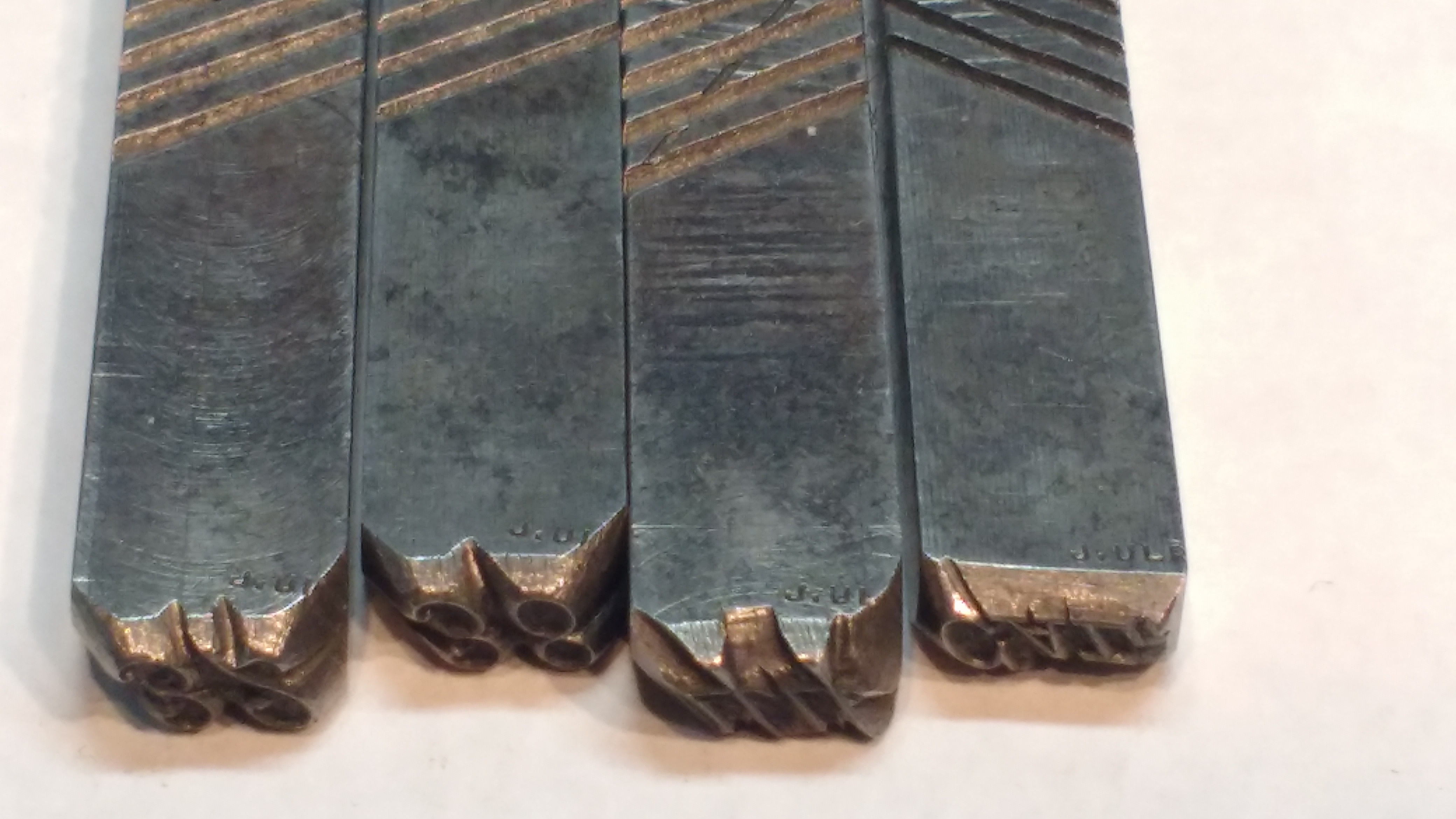

I compared two 38 WCF’s that are 864 apart in the 297,000 range with Photoshop were I could superimpose them and they were stamped with the same number stamp then stamped with the same WCF stamp, two separate operations. There was a space differance between the two stamps. I then compared to another gun over 200,000 higher and the WCF was identical but the 38 on the higher one was a different design.
Very interesting Bob, as it sounds like were talking around 1889-1895, or there a bouts. Putting the one in question around the middle of these, in 1891. So Bob, being stamped with the same, “WCF”, stamp, are there any signs of a small mark, making it look like a possible, “G” ?  I would guess not! Making this an isolated incident. With the one I showed haven a scratch, or small mark, making it look the way it does.
We’re seeing this in the M-1873, and during these years Winchester was in full Bloom, so to speak, as far as several models were being produced. My point is that I was wondering if this was ever seen on other models? I’m thinking possibly not, as a Conglomerate as large as Winchester, back during that time, and so many Craftsman and employees, with that much going on, they weren’t sharing stamps, in different departments to mark these firearms with! I can see where this would be an isolated situation to one particular model, the 1873, Rifle or Carbine, and possibly the musket also, but in this one isolated department. My other thought in my semi warped mind, is that I can only image a particular one person doing this work and possibly making this slight of hand errors.
Another question! Was Winchester using a Roll Die for these, in a press, or a so called hand stamp, at this time?

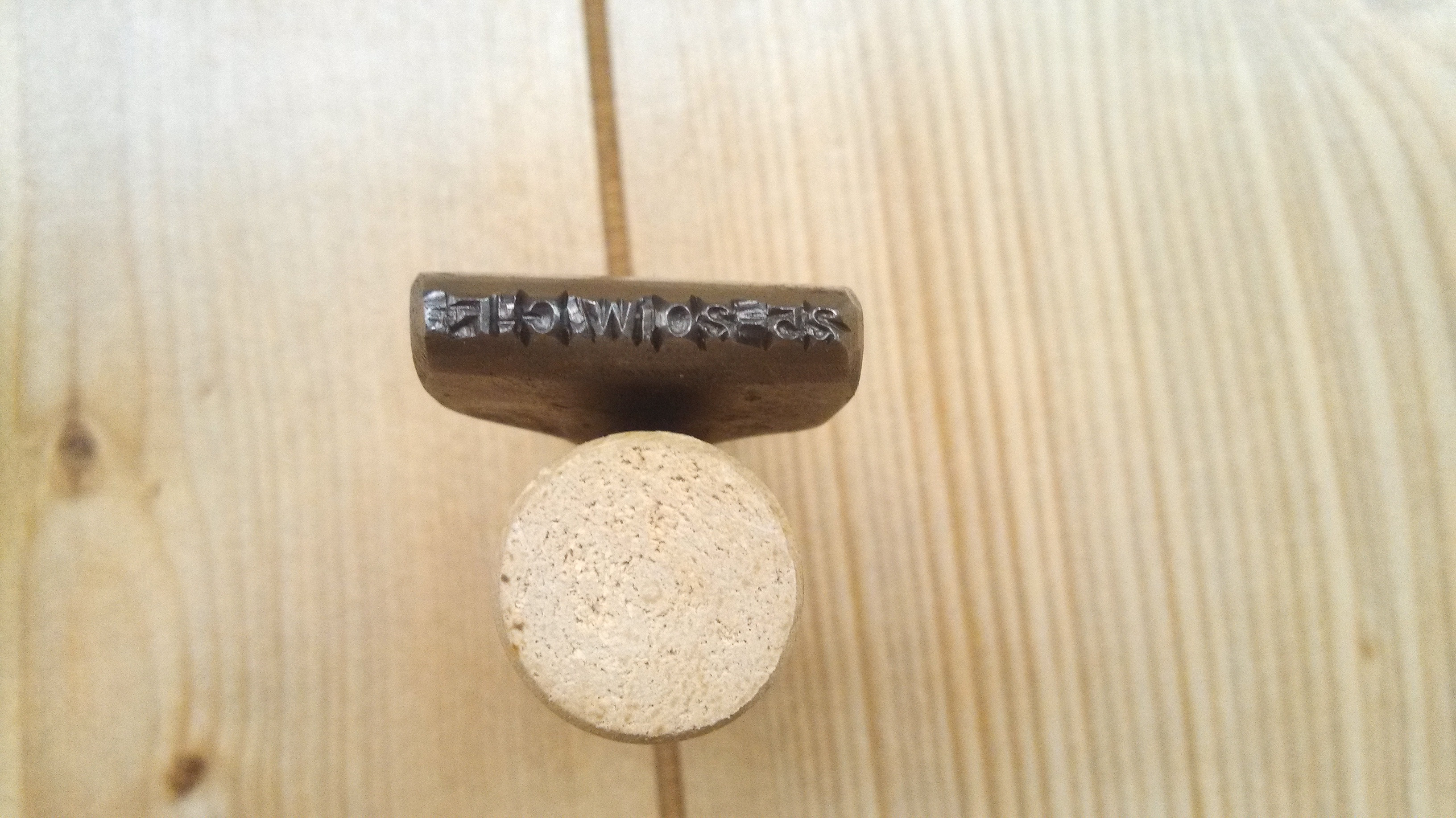

My only information on how Winchester made barrels is based on the polishing room records where they made runs of certain type of  receivers in batches. I would think they ran the barrels through the barrel department similarly. It wouldn’t make sense to have separate barrel department for different models. So the same people were marking all the barrels and they would of had extra stamps in case one broke. The stamps were made by the in house engravers as you can see in the pictures of the stamps I posted. I think they marked them so they could be returned to them if they needed repair. On later models they went to the all in one caliber stamp as pictured in the 25-20 WCF stamp that was made by J. Ulrich as well. I believe they kept using the separate stamps for the 73 because they had them and the new models used a all in one stamp.
Once the stamp got too long they went to a roll die which was harder to make. The roll die concentrated the pressure in one spot as it rolled over the metal where if it was a flat hand stamp it would take a hard hit to get a good impression and the possibility of a double stamp.
That sure makes all the sense in the world to me Bob. What a find those J. Ulrich stamps are! Sure does help to explain things also, just by looking at them.

February 24, 2026 - 8:46 pm
It is a “C” mark with a wear mark that just happens to appear like a dash that would make the letter G. The dash is most likely simply from heavy wear and use from being banged around. The reason you can tell is the dash is not as deep as the C stamping and it is a different color from the rest of the mark. The rest of the barrel and the rest of the gun has plenty of other pop marks or wear marks all over it.
Also the fact that have a G between the W and F, doesn’t make any logical sense. What the hell would a G stand for? Winchester Gun Fire? Makes no sense.
You are absolutely correct in you’re assessment, as it is easy to determine and see that now, on 2/24, as we started this, with photo’s on 2/19! This being after several discussions and pictures to try to understand this along the way! LaughLaughLaugh
Glad you could join in and make it apparent to us, Brady ! LOL! LaughLaughLaugh
You are correct in you’re logical assessment! It doesn’t make any sense! Smile

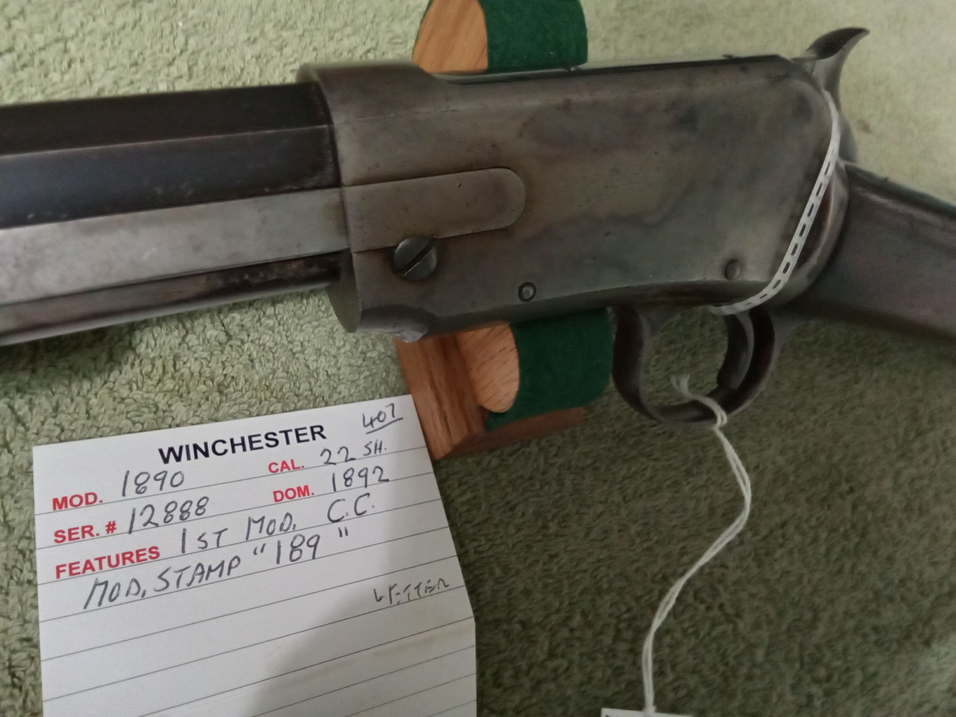

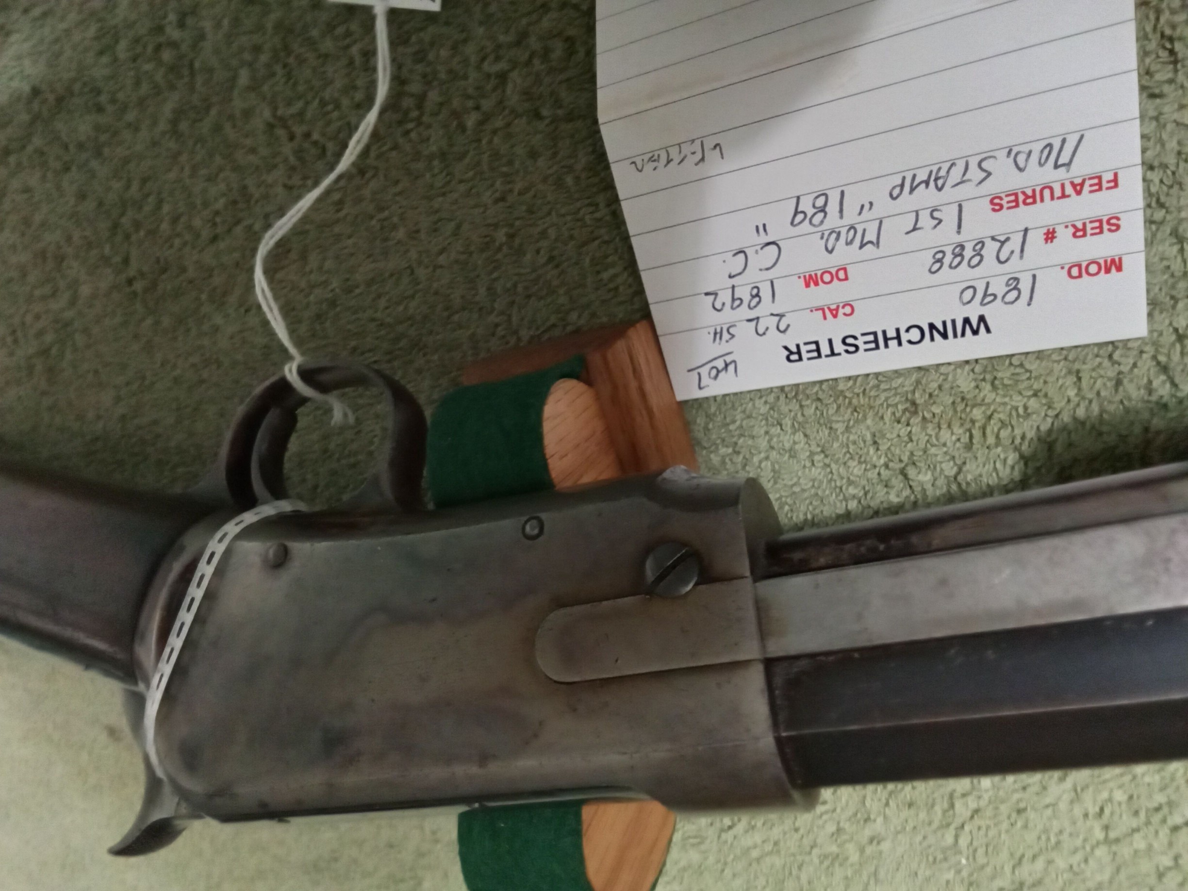

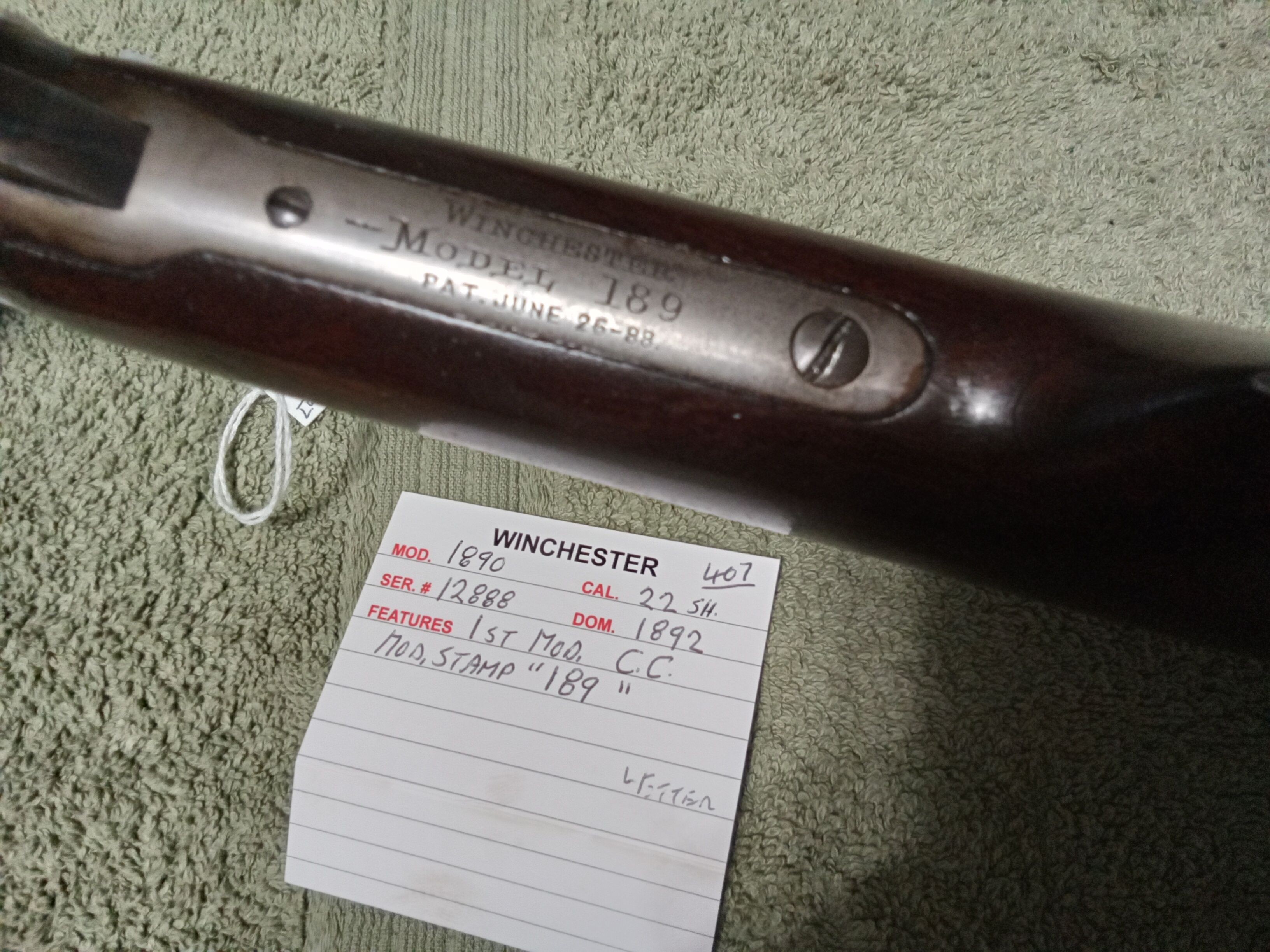

Well there was some strange things happened periodically at Winchester with Their stamps and various markings, like misstamped caliber markings etc. and like this one; a pretty nice 1st. mod. 1890 or should I say “189”, the tang is not broken or refinished in any way. Just another curiosity from the good folks at Winchester.20260224_192141.jpg20260224_192220-1.jpgSmile

Henry,
That’s also interesting, as I’ve never seen anything like that before. I can’t ever remember reading of anything like that.
There doesn’t appear to be even a faint hit or strike of the 0, (zero), at the end of the model designation.
That looks like maybe either it suffered from a broken roll die, or simply they didn’t finish applying the roll die completely and stopped a little early when applying the markings.
A neat find!
Yup.  The very rare Winchester Model 189
Steve,
“One of One”, I’m told! LaughLaughLaugh
