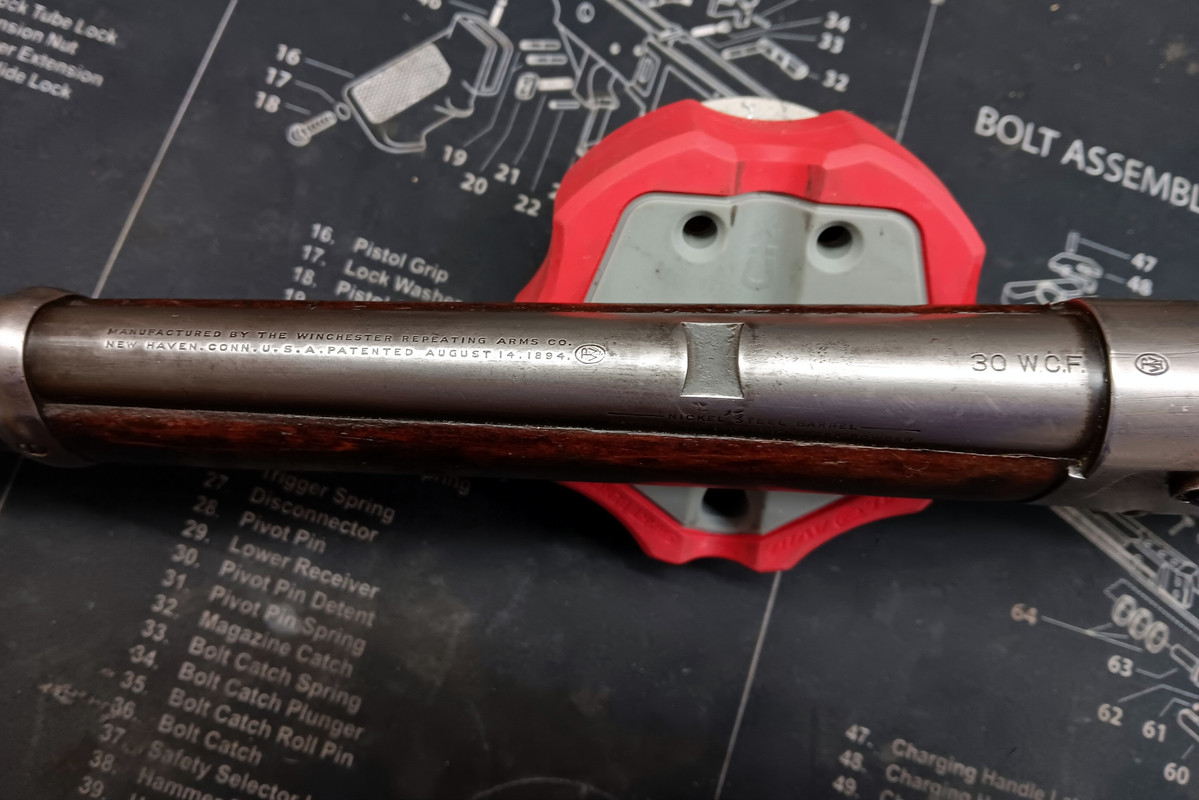

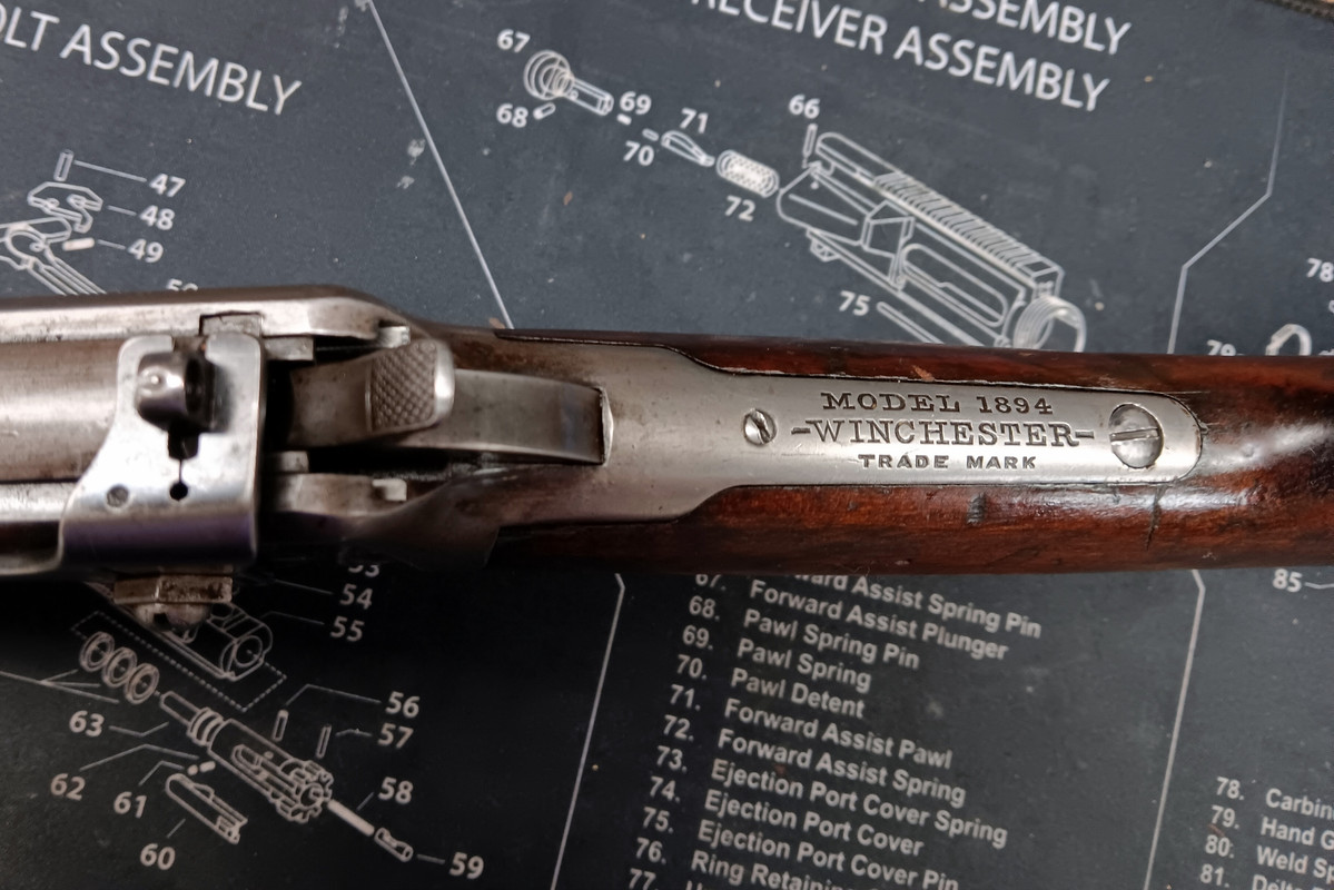

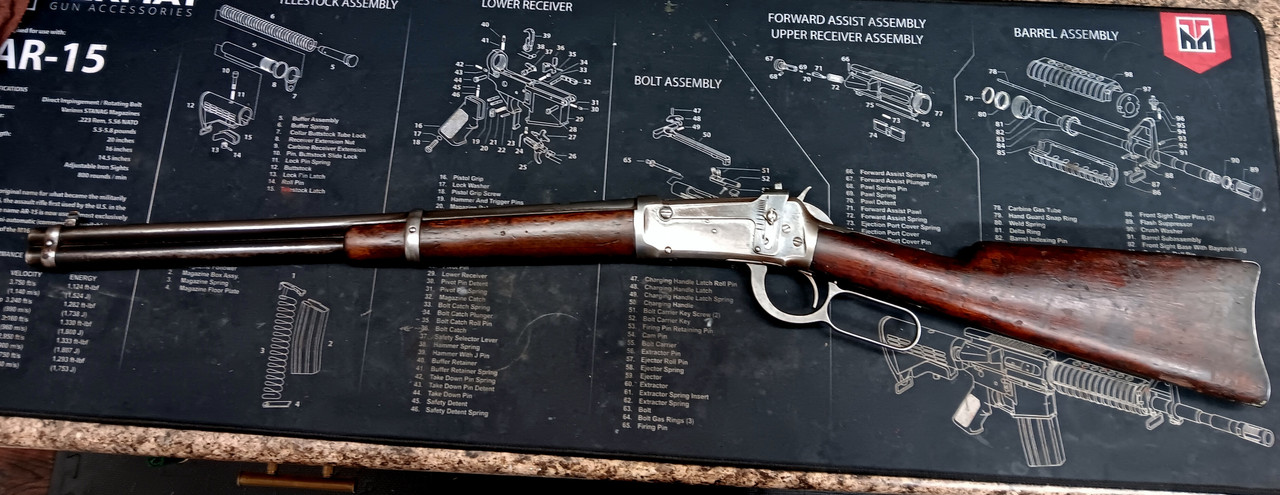

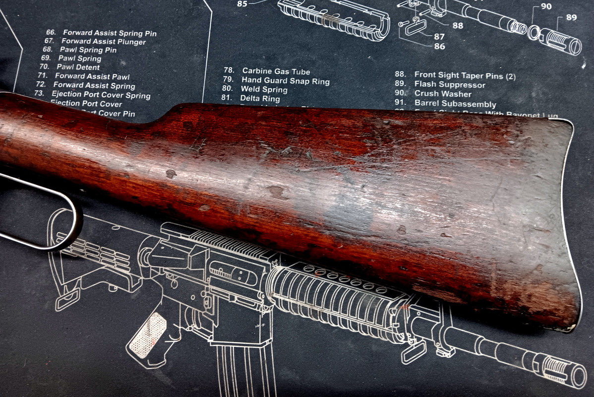

I walked into a local gun store, saw this on the consignment rack, and made a deal for it.  According to the forum tool, it was manufactured in 1907. Most of the bluing is gone except for under the sight and in crevices, but the sight intrigued me and I didn’t pay much for it so I took it home.

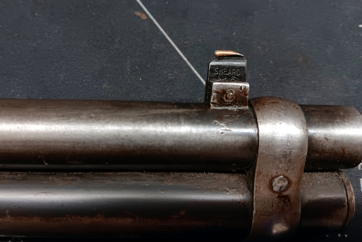

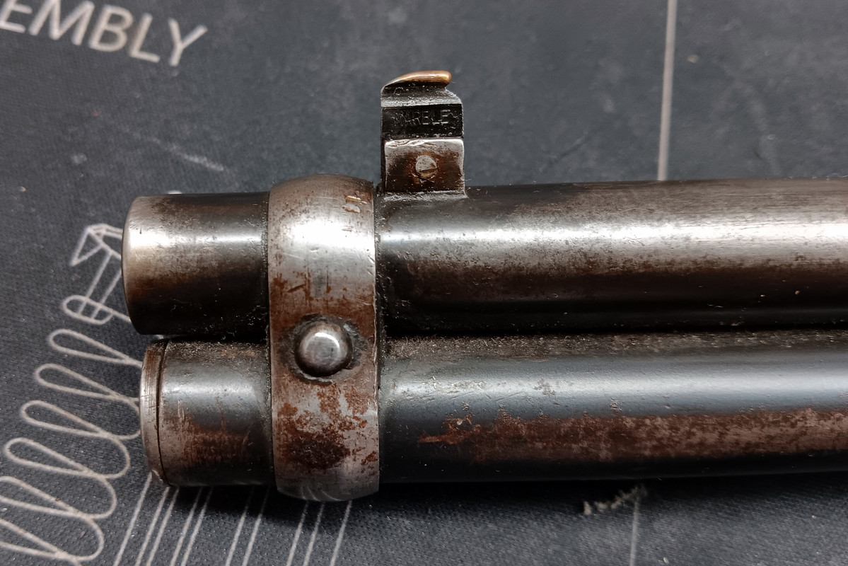

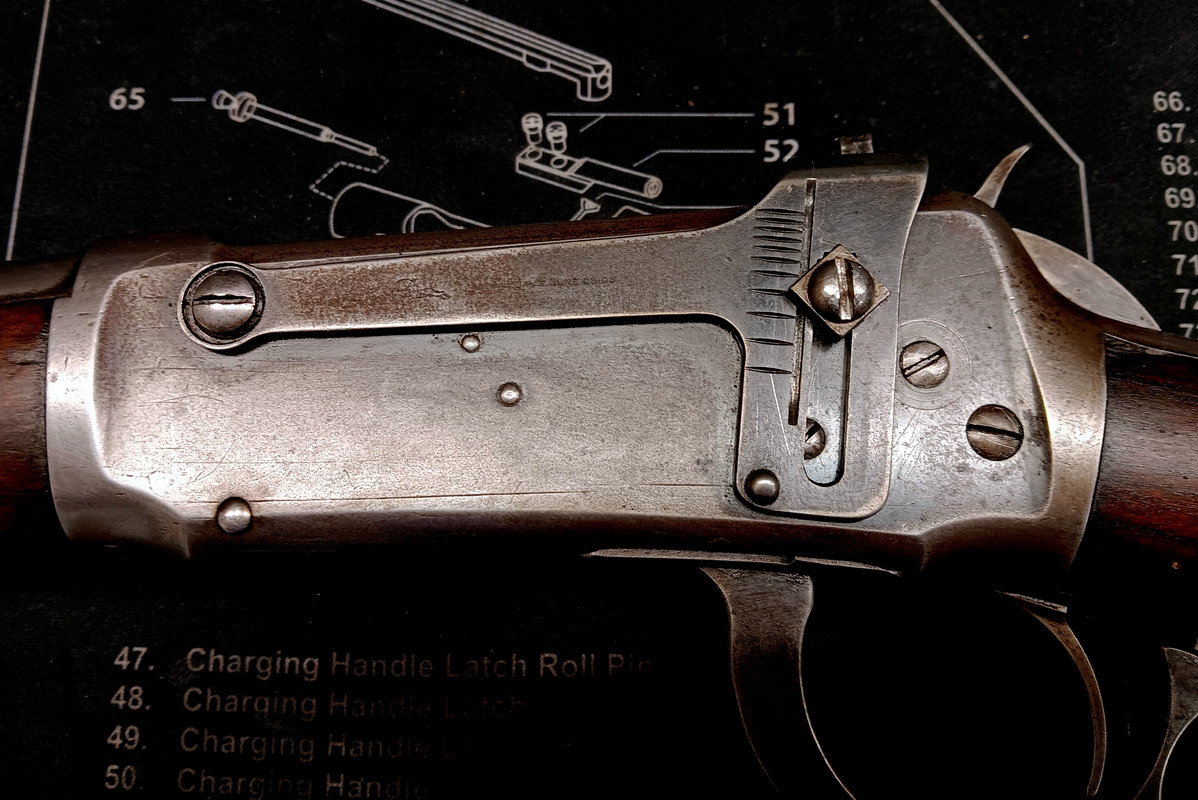

The wood fitment is good, and most of the crews are in good shape. I don’t know if it left the factory with the Lyman sight on it – was it an option or added later?  I assume that since it is a 1907 I can get a letter from Cody…..  wondering if it is worth it or not. I can tell you that there is significant blue under the sight arm, so if not from the factory it has been on the gun a long time. The front sight looks un-original to me, and the front band screw appears to be a rivet or silver-soldered – that looks weird, too.
What do you all think?

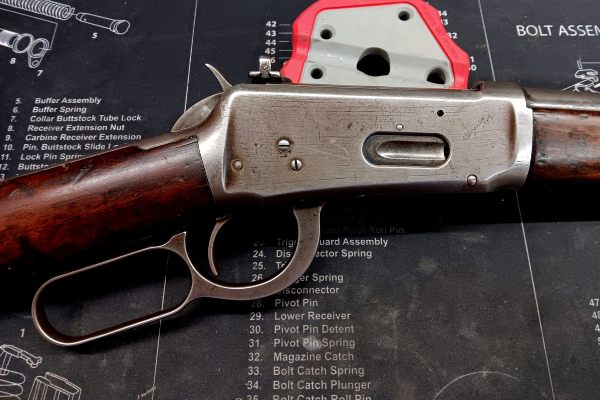

It was a saddle ring carbine but the ring was removed when the Lyman 21 Receiver sight was installed. The front barrel band should have a screw and not a rivet. The front sight is a Sheard, not sure if one of those could have been special ordered or not. This 94 is too late to fully letter, (has to be under sn353999). The only information a letter would tell you is the date the serial number was applied.
The most interesting thing about this carbine is that it is has the error patent date of August 14, 1894, it should be August 21, 1894. Some model 94’s of this vintage left the factory with this error date. I’m not sure how many.  Bert would have more information on the error dates.

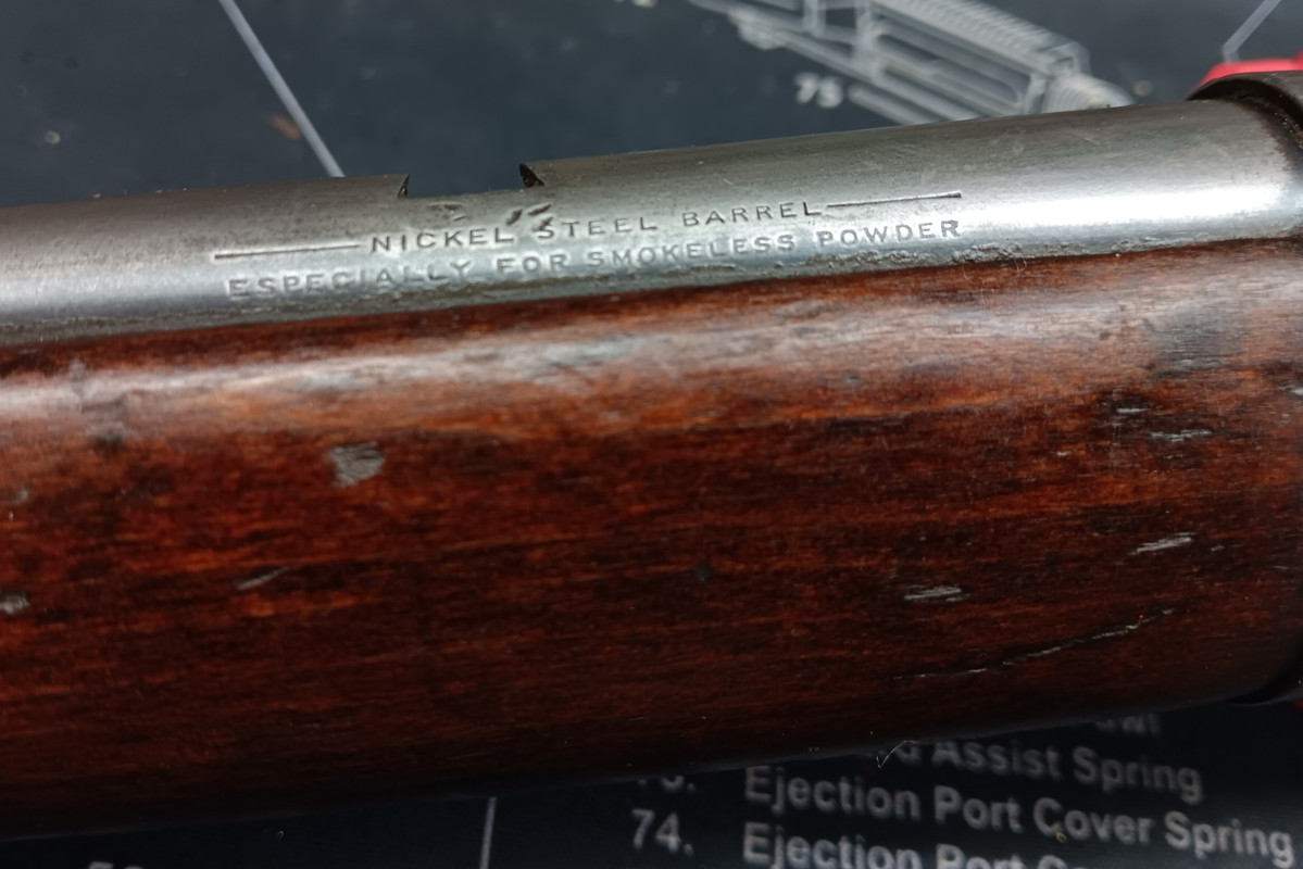

Also, the placement of the barrel proof mark seems to be in an odd location.

I think the Lyman 21 was added outside of factory and has the wrong screw in the of sight and missing the small lever, that said it’s a nice used old SRC. You can find the correct mounting screw, lever and pointer on Ebay sometime, theirs a guy that makes repos

Not a great collector grade Winchester but it has more character than the safe queens bringing the big bucks today. I like it, I think you did well bringing this one home. For some folks it’s a grey gun, I think you’re touching shaking hands with history when you pick up this carbine. It had me at “Lyman 21”.

tionesta1 said Also, the placement of the barrel proof mark seems to be in an odd location.
Certainly, it is, but as use of this proof mark was relatively new in 1907, my interpretation would be that the worker who struck it was making his best guess as where the correct placement should be; no reason to doubt “originality,” in other words.
I find these owner “improved” guns (if skillfully done) much more interesting than the strictly stock ones, so don’t allow any short-sighted purist to put it down on that account.  Esp, any gun with a Lyman 21, even one incomplete as this one, I rate as a cut above the same gun with standard sights.

The Lyman no. 21 was positively added after the fact.  The original rear sight that was mounted in the dovetail slot was a 3-leaf express sight. The placement of the Proof mark stamp on the barrel is actually quite common on the Model 1894 SRCs that were manufactured from late 1906 through early 1908 and equipped with the 3-leaf express sight.  Thus far I have documented (79) Model 1894 Carbines with the August 14 patent date error marking.

I think a Lyman No. 21 on a ’94 carbine is super cool.  If it were mine, I would be very motivated to find the correct screw and lever for the sight.
December 22, 2023 - 2:03 pm
So would I, but won’t be easy to find. Maybe previous owner was having trouble with the lever loosening under recoil & put the screw in to hold it tighter, though that eliminated the best feature of the 21, fast adjustment.  Still, I’d rather have the gun “as is” than the way it left factory.

Since this is my first brush with a Lyman 21, I’m not sure what parts to order from Bob.  It looks to me like it is missing most all of the mounting stuff – lever, bushings, screws, etc.  I do know from reading this forum that it is the correct model for a ’94, as it is stamped “DA” on the obverse side.
Also – I see that it is adjustable for windage, but for the life of me can’t figure out how to make the adjustment.
