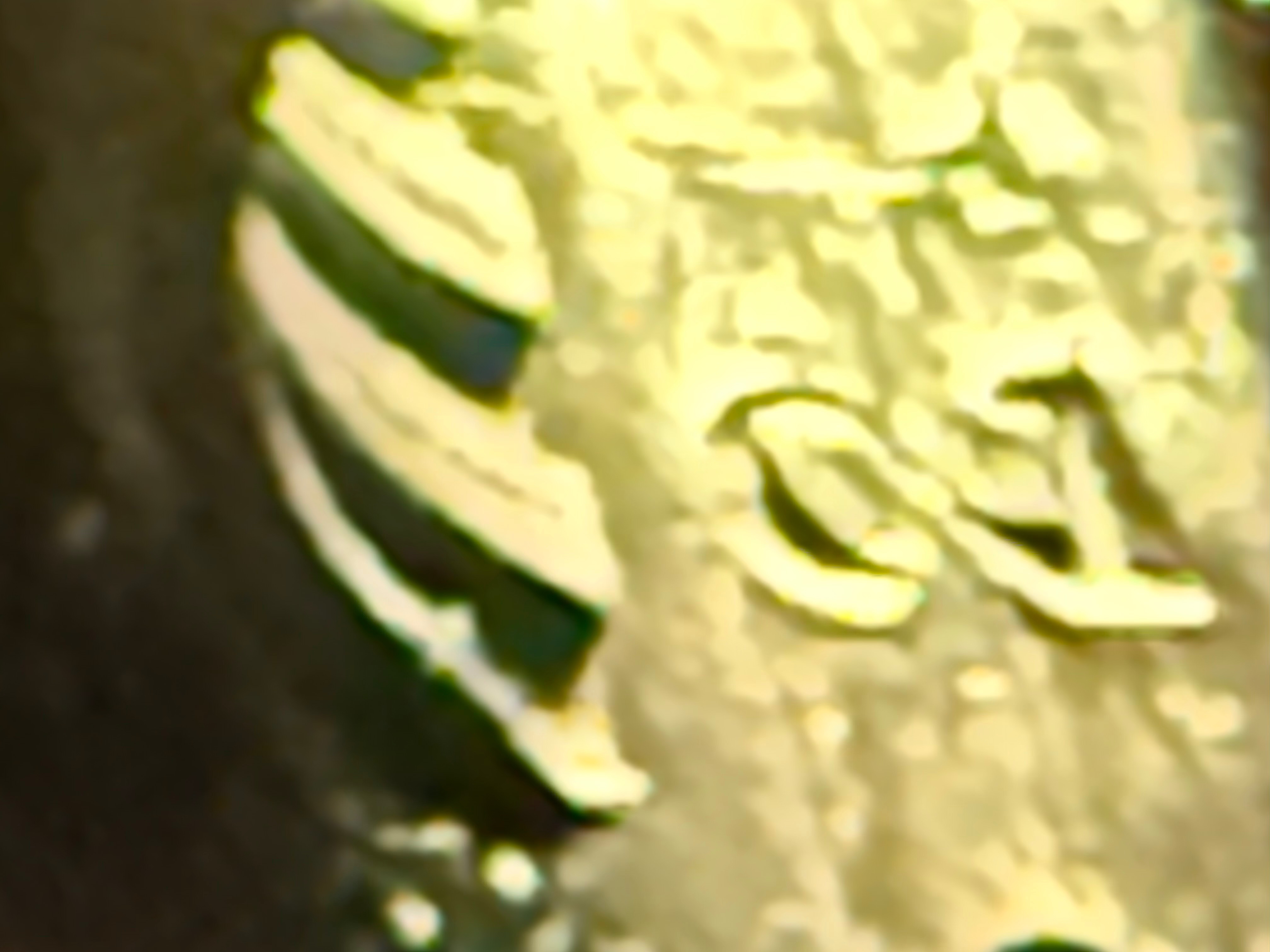

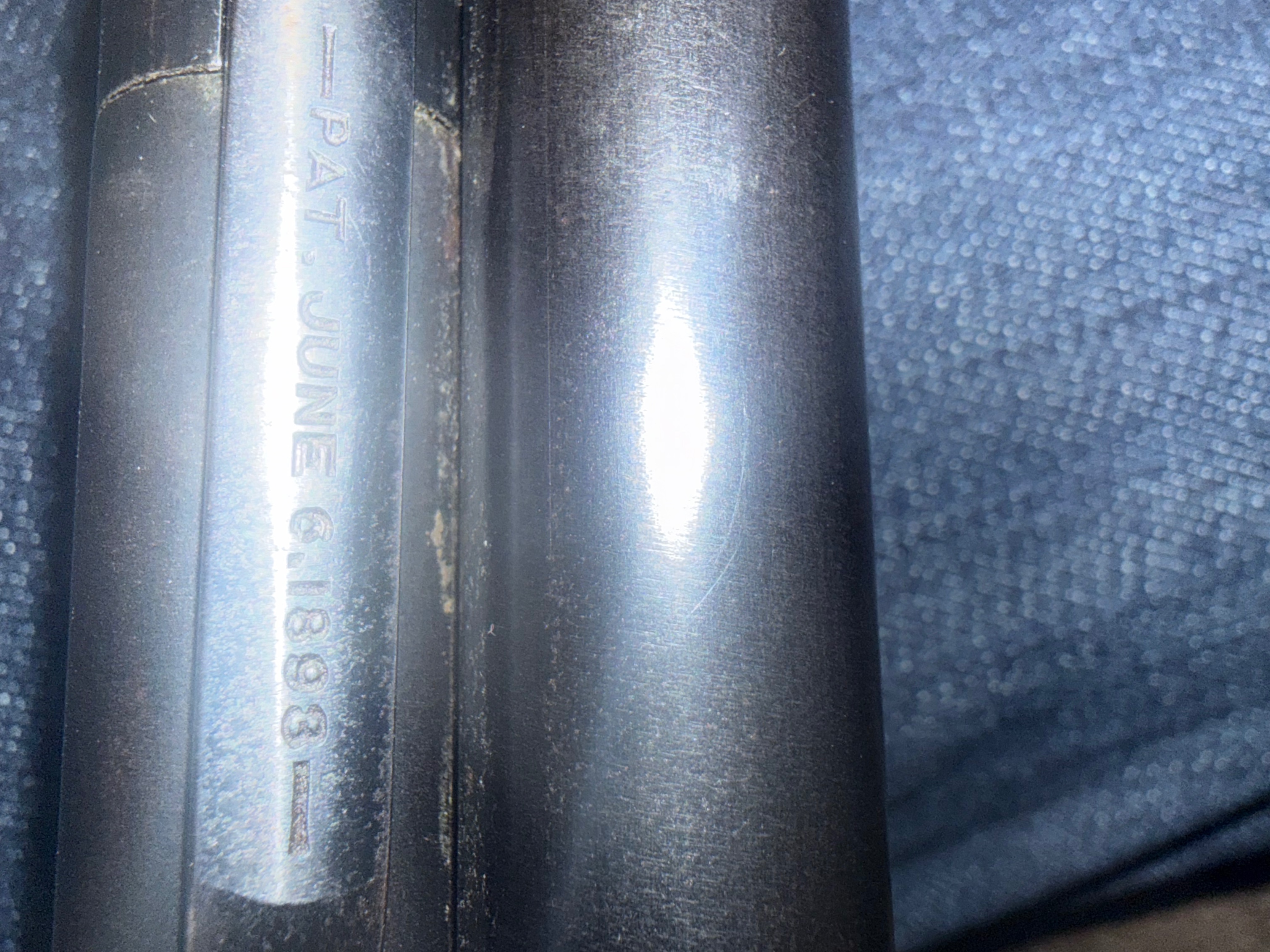

IMG_8150-1.jpegOnly date I could find
June 22, 2026 - 2:25 am
That is the Patent date for the Take-down.

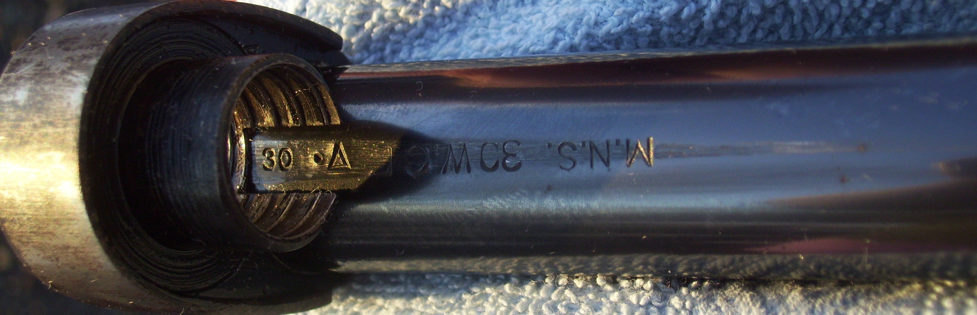

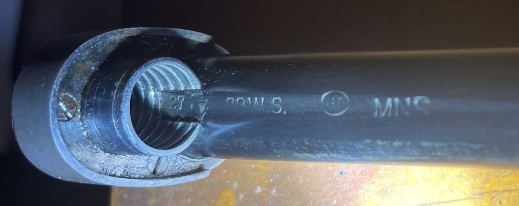

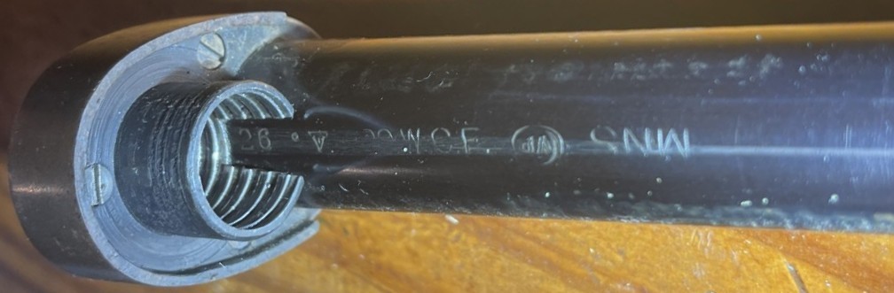

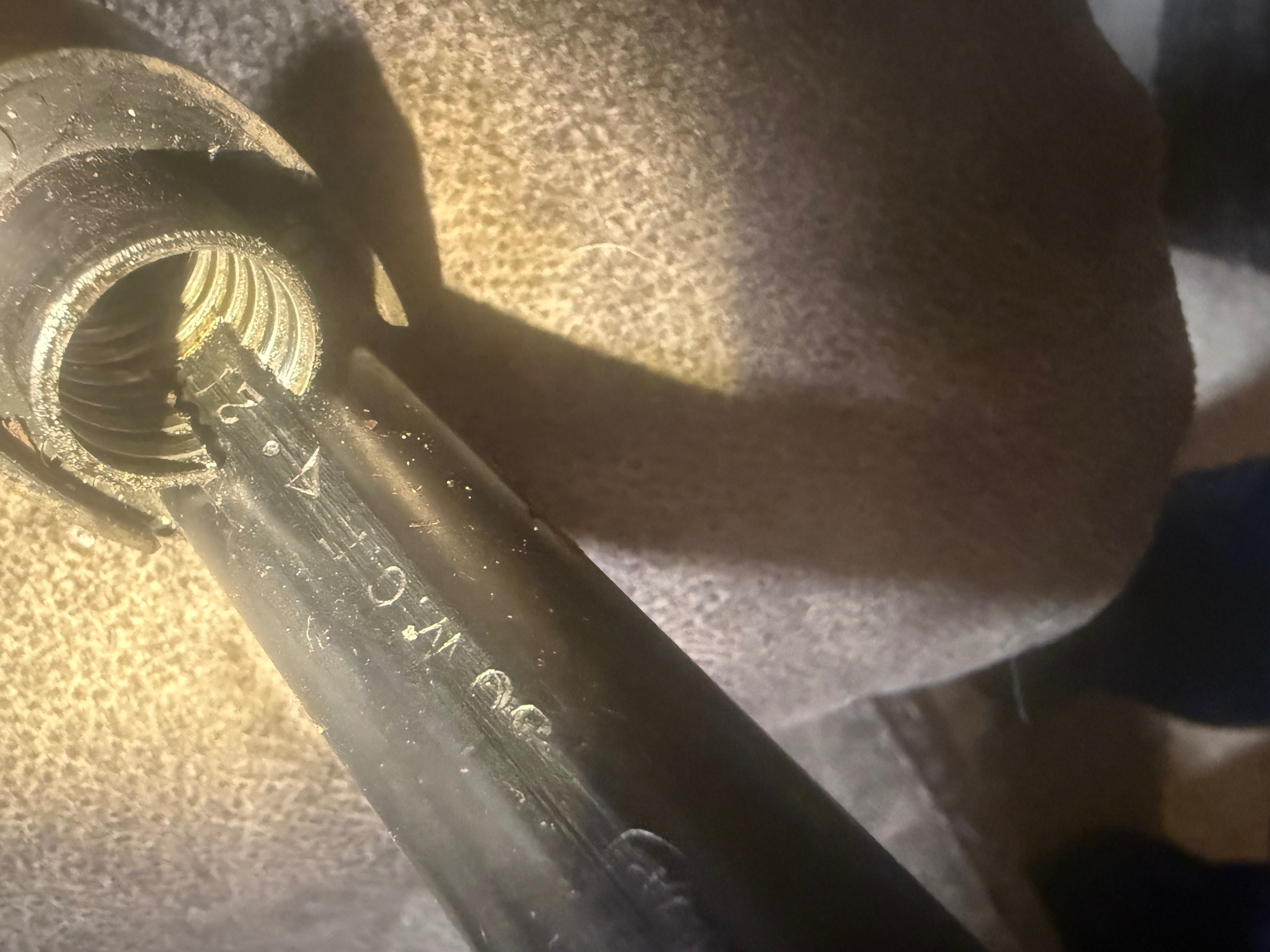

The barrel date requires removing the barrel (taking it down), and then removing the forend stock to see the date on the bottom of the barrel inside the take down extension ring.  The attached pictures show the location of the 2-digit year number stamped on the bottom of the barrel.
Barrel-date-26-7986-30-WCF.jpgBarrel-date-27-9169-32-WS.jpgBarrel-date-30-1070007.jpg

June 22, 2026 - 11:39 pm
The second numeral appears to be a lightly struck “7” making it “27”.  I do not believe that it is marked “24”.

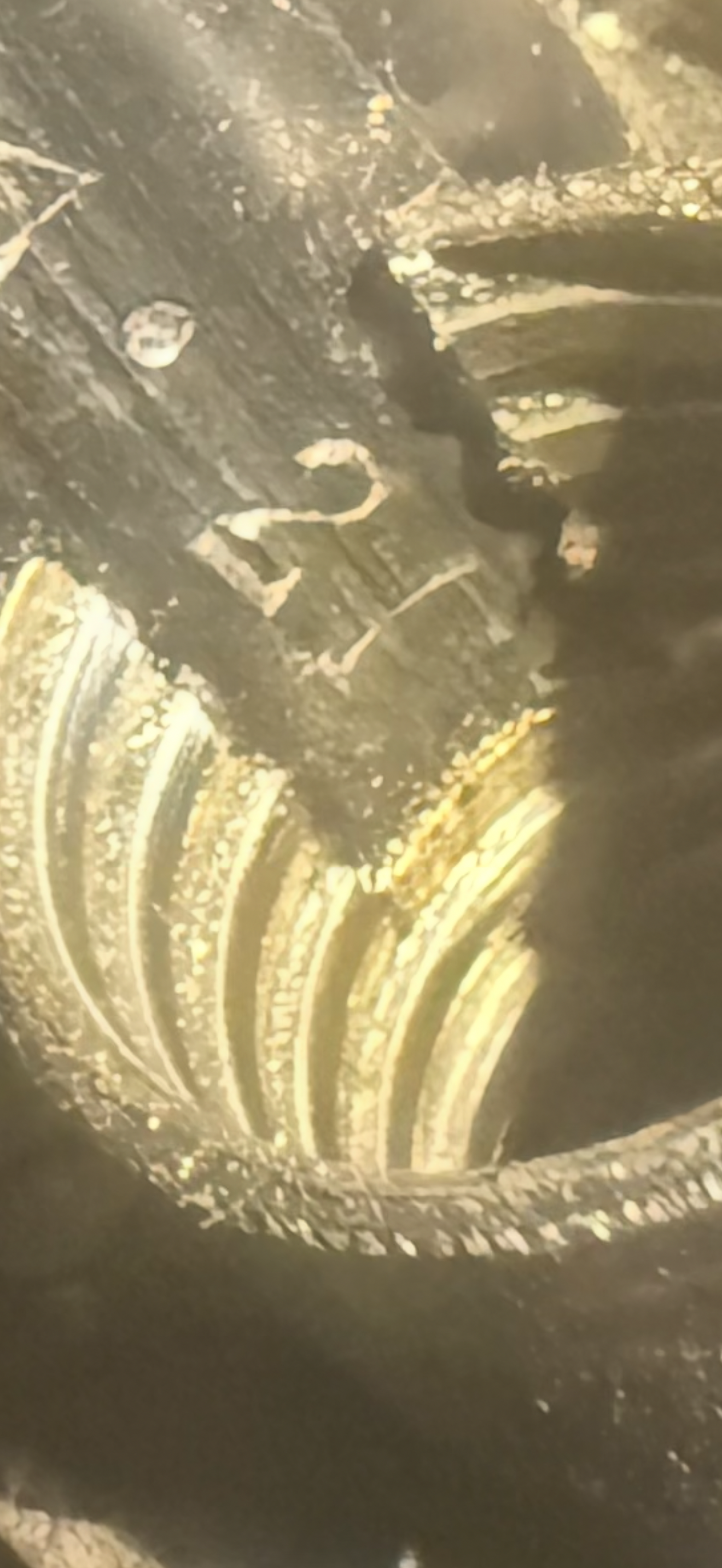

June 23, 2026 - 10:52 am
Looks like 21 to me.

June 23, 2026 - 5:26 pm
Could also be a lightly stamped 24 – what I find odd is mine runs opposite of examples you have – my 2 is toward the barrel yours are toward the gun – would have to see another 24 stamp – there’s a small tail on bottom of my second digit that isn’t on the 27 example you have – who knows 🤷🏾

June 23, 2026 - 9:47 pm
I just got new glasss and I see a 21Smile

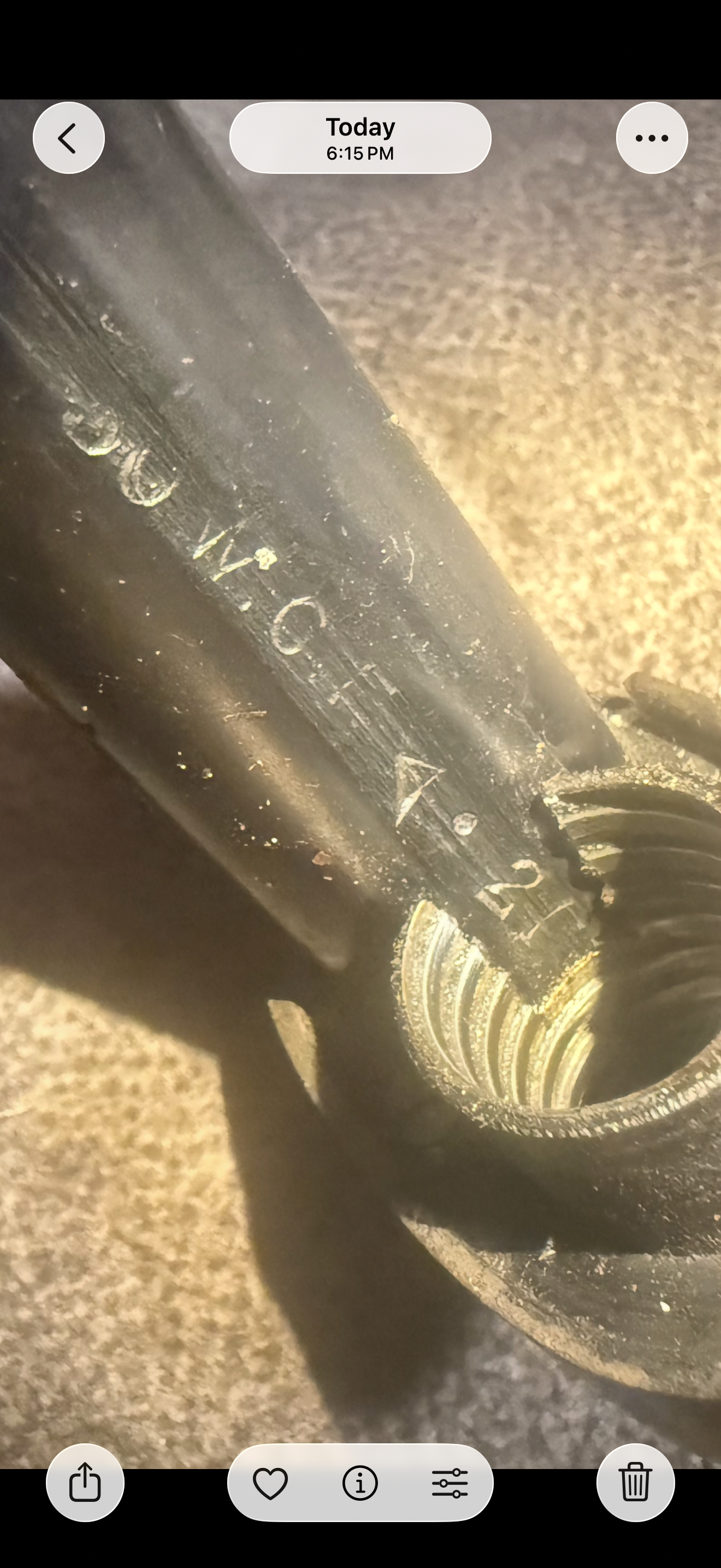

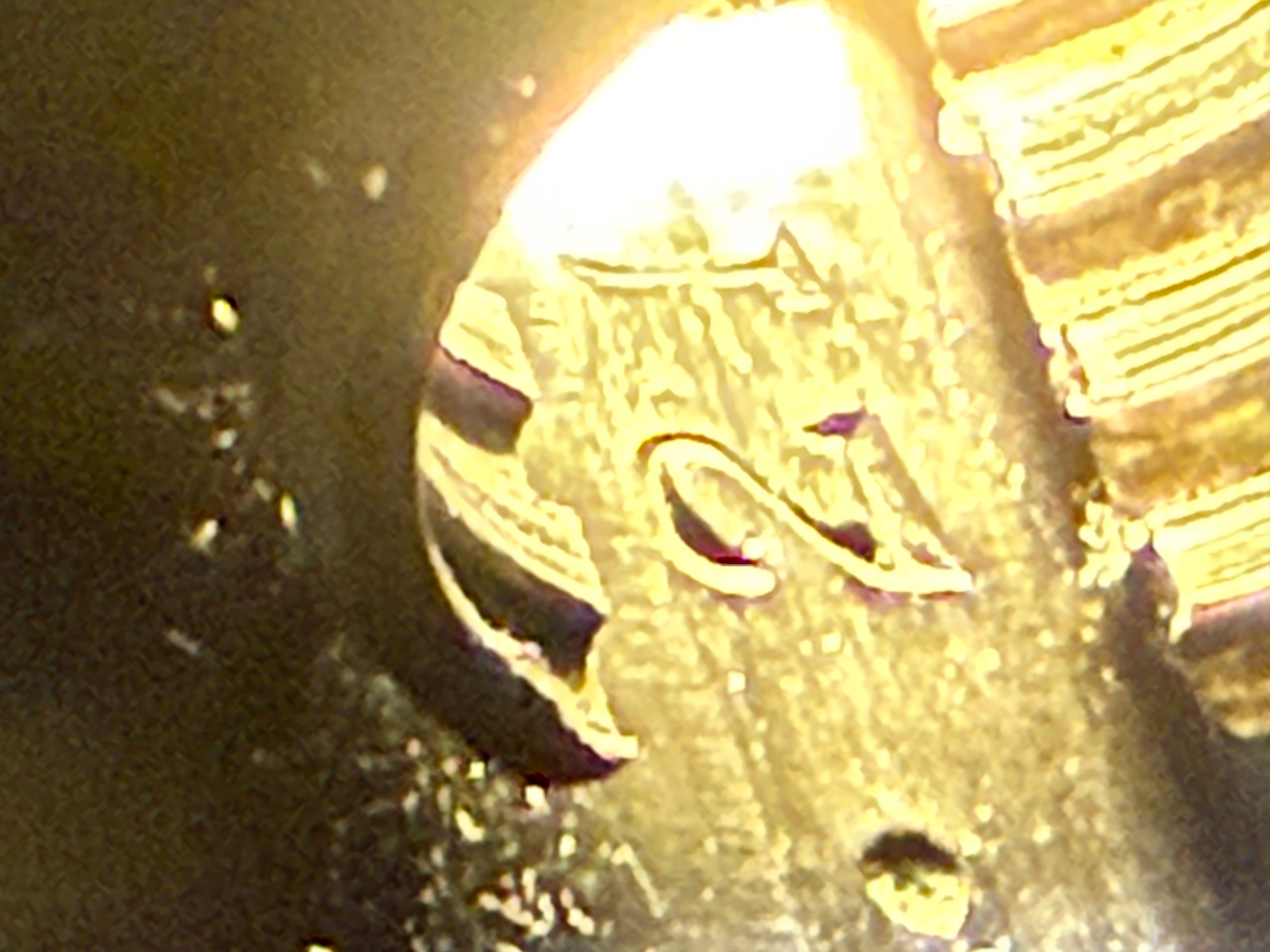

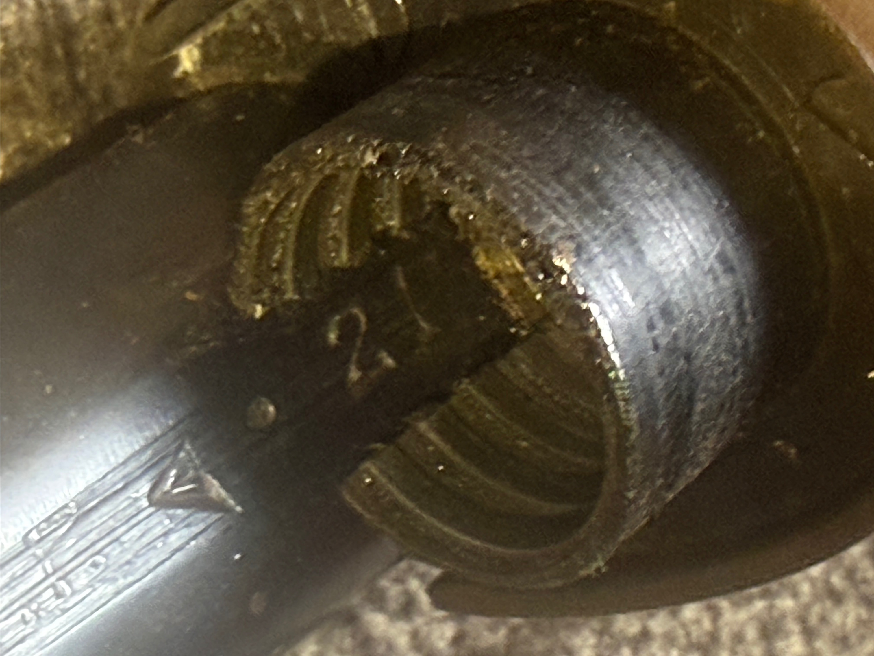

Tore it back apart – cleaned with a toothbrush – will not show up in a pic but can definitely without a doubt see a faint 4 – here’s best pic I could get and it shows the bottom line of the 4IMG_8164.jpegIMG_8165.jpeg
June 23, 2026 - 11:48 pm
I agree, it is a faintly stamped “4”, and that is precisely what it should be.
