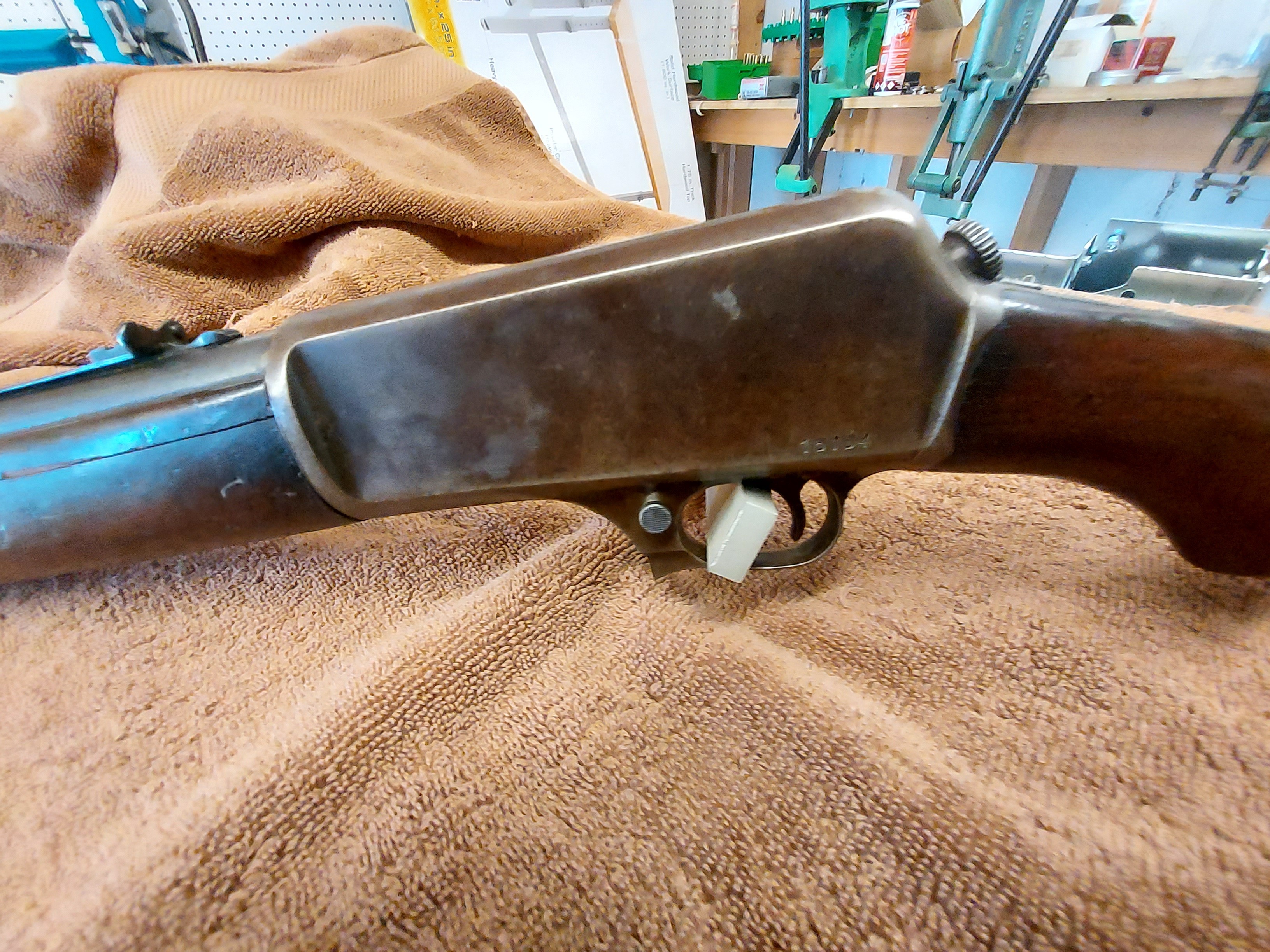

I haven’t worked on the gun yet *other than cleaning the bore) probably take it down and do some cleaning this weekend. Like a lot of these this one has a split along the grain on one side. I had the same thoughts about why they would have an issue with the forearms splitting the wood seems pretty thin along the top line and where it meets the barrel. I also thought once I take down and clean up the rifle I would fix the split with some Accuraglass and surgical tubing as a clamp.

Hi Guys,
As promised here are some pictures of my Winchester 1907WSL rifle in various stages of disassembly. I mentioned that the stock was split on one side and when I pulled the forearm off the piece came completely away just held in place by the fore end cap and the recess on the breech side the stock fits into. Overall the condition is not bad. I plan to clean everything up of gunk and will come up with a strategy on how to fix the stock. When putting the pieces together it is fairly obvious that there is a split even if held together firmly.  I figure on maybe some accuraglass and some surgical tubing as a clamp when reinstalled in the gun. Not sure about blending the repair any suggestions would be welcome.
Rob
