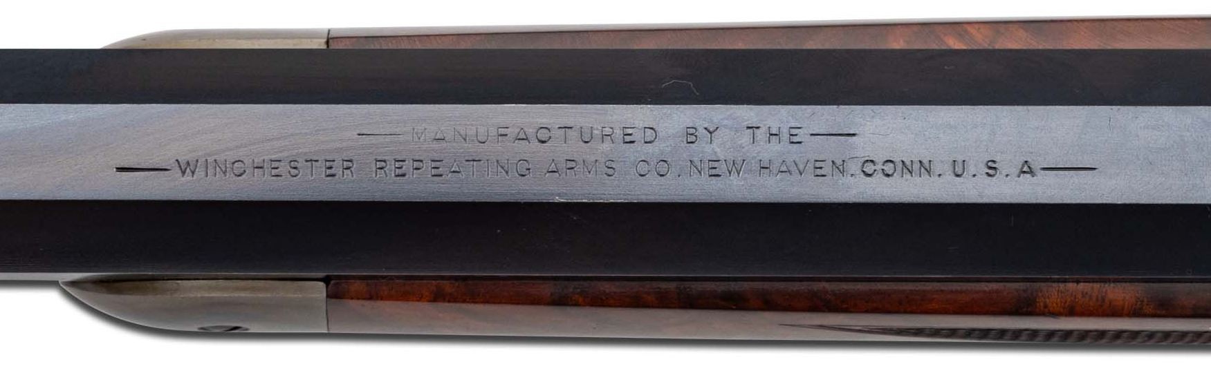

Too bad the auction house cannot tell refinished from original.  If you doubt this isn’t a refinish, one look at photograph 7 of 18 with this extremely weak barrel address should convince you something is rotten in the state of Denmark.

So are you talking about this picture?
What other signs of a refinish do you see?

The seventh photograph shows really weak barrel markings, presumably buffed and reblued.  Maybe it’s the photographs?
November 11, 2025 - 3:20 am
86barreladdress.JPGIf you go to original source (Richmound Auctions Website), you can click on the photo links and make them larger.
I’d say its a little weak, but nothing I haven’t seen before.
What do the rest of you fellows think?

Maverick said
It looks buffed to me. One the first rules in identifying refinished is what we’re looking at in photo 7. This gun just seems too pristine. I would want to handle it in person, especially for the kind of money it’s going to hammer for.
 Rick C

Rick C said
Maverick said
Agreed.  Way too pristine, especially for a rifle that comes along with a story involving some heavy usage.

List of hunts and condition don’t match up unless you know someone like my brother. His wife gave him a rifle when they got married forty years ago and it will still score 95% or better after dozens, if not hundreds, of hunting trips. Trophy list is not nearly as impressive but some folks take very good care of their firearms. Flats look good, edges look sharp. Nice gun, too nice for me!
