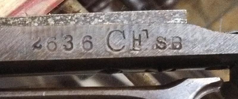

Forum Posts: 4896
January 18, 2016 - 8:50 pm
This the swiss butt style on both of mine and the stamping on the tang.

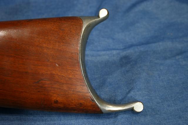

Forum Posts: 14294
January 18, 2016 - 9:18 pm
Bob,
The Swiss butt plate on your Model 1873 is referred to as the “Ballard” style. Winchester used it on all of the various models (including the Model 1885) up through at least the year 1886, then switched to their own design thereafter. The latter type attaches to the butt stock the same as a standard crescent (rifle) butt plate. The stock inletting required for the Ballard style is what drove the change.
