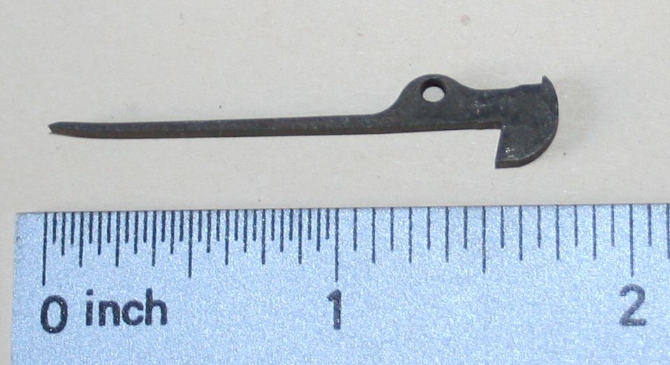

This is the extractor that you need but he is sold out now. Where abouts do you live.
Extractor

thanks, here is the picture of the extractor.
I think the one I have is the two piece one, but not sure.  The way the Homestead states the .22 part, it is consistent with mine.  However, it could be that the extractor in broken off at the tale, very hard to know.
I am in Tyler, Texas, but I can ship it to anywhere there is someone that can do the professional repair and restore to factory original.  thanks, Elliot

I looked around the web and couldn’t find one. One sold on ebay earlier this month. There are two different types of extractors for the 73 22 one with the pivot pin at the front end like you need and one with the pin towards the back. The extractor are one piece. The tail that broke off of yours was the part that acted as the spring. Keep an eye on Ebay they show up now and then or the whole bolt with the extractor.

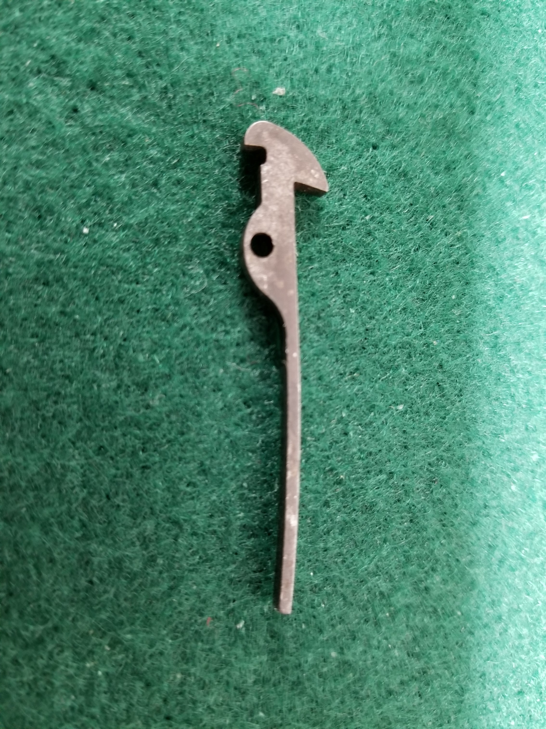

Gentlemen, making progress, I think?
Here is the repro from Holloway that I just received.
However, it is different from the one I purchased on eBay, original, and will be here by Friday. One of them isn’t correct, what is your thinking? thanks, Elliot

Hopefully one will work. The one on the Homestead site looks different from either of the two you found.

TXGunNut, thanks, this is the image of the Homestead, it looks very close to the original that is coming on Friday.  It is clearly not like the repro I just got.
thanks, Elliot

Remove the old one and compare them to it even thou your missing part of it.
