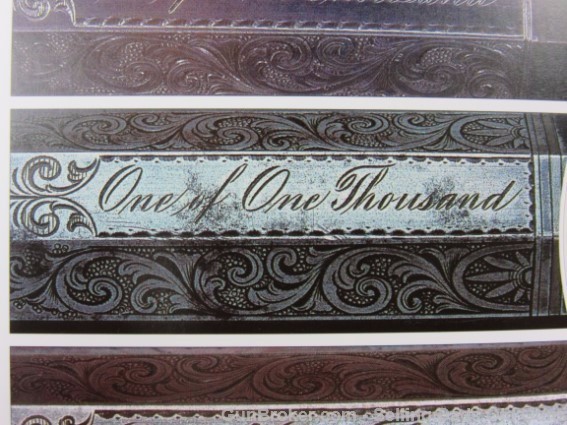

 Any comments on this gun? We know the seller is suspect. The buffalo on the right side plate looks cartoonish to me?

It does not letter as a “1 of 1000”. Additionally, it is highly suspect because it is a 3rd model variation. I personally would not ever consider purchasing anything that seller has to offer.

Just for my own knowledge, shouldn’t the “One of One Thousand” be in the center of the barrel flat?1of1000.jpg

I’ve never seen a real Ulrich engraving in person but that bison looks like a cross between a monkey and a opossum with a little bear tossed into the mix!

The barrel is not a 1 of 1000 barrel. it does not have the platinum inlays. Like Callaway said the One of One Thousand  on the barrel is poorly done.

One of the better Fakes I’ve seen lately. The serial is way to high to even consider it being real. I do wonder if someone took a very nice engraved and plated 73 and just merely had to barrel engraved. Or if all the engraving is fake. It certainly looks more than just $10 worth of engraving do on it. I wonder how much was added or if they just try matching the serial number to a ledger entry that might make sense.
Adding this one to my faked serial list for sure.

 Thanks to Casey I have the serial number now and checked some old records I have and it was in a Rock Island auction in December of 03 but I don’t have any catalogs that old.

Gordon had it in his original survey and in the notes it said “1000?” so he didn’t believe it was real and that was 1997. The other thing I noticed is there is no muzzle engraving which a 1 of 1000 has.
