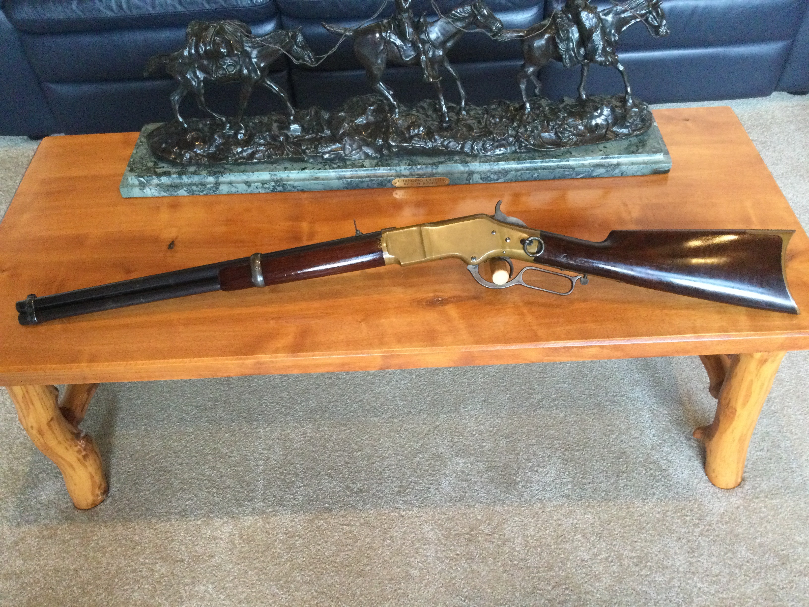

Hi Robert,
I will leave it to the experts to tell you how to grade it. But I will say its a pretty neat carbine!
Rob
Forum Posts: 2012
June 20, 2023 - 1:00 am
  I think your gun is a little rough to be graded NRA Fine. I see a $5000 carbine that has been helped, but not done professionally. T/R
Forum Posts: 5005
June 20, 2023 - 1:15 am
I see no original finish on the gun. Barrel has been cleaned up and blued maybe cold blue. Receiver has been cleaned as well. Wood has been sanded.

No, you’re wrong about that, it’s definitely original bluing.  Maybe it’s hard to tell from photos, but I’ve owned quite a few 1866s and can tell you the bluing is original. I did wipe some mineral oil on the metal surfaces.  Wood is proud to the metal in most areas, not at the toe of the buttplate however.

”No, you’re wrong about that, it’s definitely original bluing. ”
You asked for opinions from other knowledgeable collectors. That’s just what you’re getting. I also see no original finish on your 1866.

The best way to tackle this is to provide a known good example and compare yours to it.
Here’s one that sold at Rock Island Auction recently, for $76,375.  It’s a high condition carbine:
https://www.rockislandauction.com/detail/88/16/winchester-model-1866-lever-action-carbine
Let’s begin with the fact I am evaluating based on the photographs you provided.  Different views in natural lighting may provide better feedback.
Let’s start with the wood.  Note the rich red hues to the wood, and the sheen it contains. In contrast, the finish of yours is more dull and a more brown hue.  This is not consistent with the finish of the era.  The wood on your rifle is lightly sanded prior to refinish.  This is best demonstrated in views of the interface between the forearm and the frame.  Yours is slightly proud, the example provided is much more proud than yours.  How proud the stock is relative to the frame of each is difficult to discern in photographs of the example I provided relative to yours, and this would be better demonstrated with both rifles side by side.
With regards to the bluing, note the richness to the bluing of the example provided.  This is in contrast to the dull grey of th barrel of your rifle.  This is best seen comparing the photographs of the barrel markings of both rifles.  The dull grey of your rifle means it is limited with regards to the extent of original bluing, if any.  The application of oil might enhance the finish present in the photographs provided, but this is likely an optical illusion and removal of the oil might reveal little or no original finish.  Pitting at the end of the barrel demonstrates less favorable storage conditions as compared to the example provided, and the limited contrast here and where the barrel and left side of the sight on your rifle between the white of the metal beneath and the finish of the barrel suggest, at best, a patina has developed over time, and this isn’t damage to an otherwise blued barrel with original finish.
Both the Rock Island example and your description of the finish on your rifle are described as having 95% bluing present.  Clearly, there is considerable difference between the finish of the example I provided when compared to yours, and so it’s impossible to describe both as 95%.
Also, note the presence of bluing on the screw heads of the example provided and how yours lack such finish.  And note the sharp edges and warm yellow glow of the example provided in contrast to your carbine.
This simply demonstrates that the example I provided was exposed to much less use and wear than your example.
From the analysis provided, you can thus determine the NRA Antique grading of your carbine.

I should have also mentioned that the appearance of any bluing present on the magazine or barrel is suggestive of an old reblue, or at least that’s how it appeared to me.

In the picture of the right hand side of the barrel and tube where the bad dent was I could see the same color and texture of finish where there should of not been any left as to protected places. In several places on the barrel there was roughness to the metal and it also had the same color as spots that should of been better blue. I would agree pictures do not always tell the truth and better pictures would be in order but that is what I saw with the pictures provided.

Again, the initial description I provided in the question was – NRA Antique Fine or Very Good (not NRA Fine vs Antique Fine and I wasn’t pushing that narrative, you are) the whole point being, this is likely a Very Good specimen, but could it be Fine? Or do the list of scratches, dings and areas as itemized and shown, prevent it from being that.  SN is 119XXX, 1874 production.
I do think it was a spur that repeatedly struck the mag tube, it’s difficult to imagine some other scenario where someone was striking it there so many times. The marks are very consistent.  Also, it does look like a rock or primitive tool was used to strike the left side of the rear sight in an attempt to adjust or remove it, striking it and the barrel area just below the sight.

Tom, prices have changed in the last few years covering the Model 1866, probably all Winchesters.  Antique Poor condition 1866s are selling $4500, NRA Antique Fair are selling for $5000. I’ve seen 2 in the last year, each with 1 replaced (reproduction) side plate, broken buttstock with pins and replaced sections of wood, reproduction screws, easily sell for $5000 at competitive auction.  Maybe not in the midwest, but that’s how inflation is in the rest of the country, especially back East and the West Coast.
