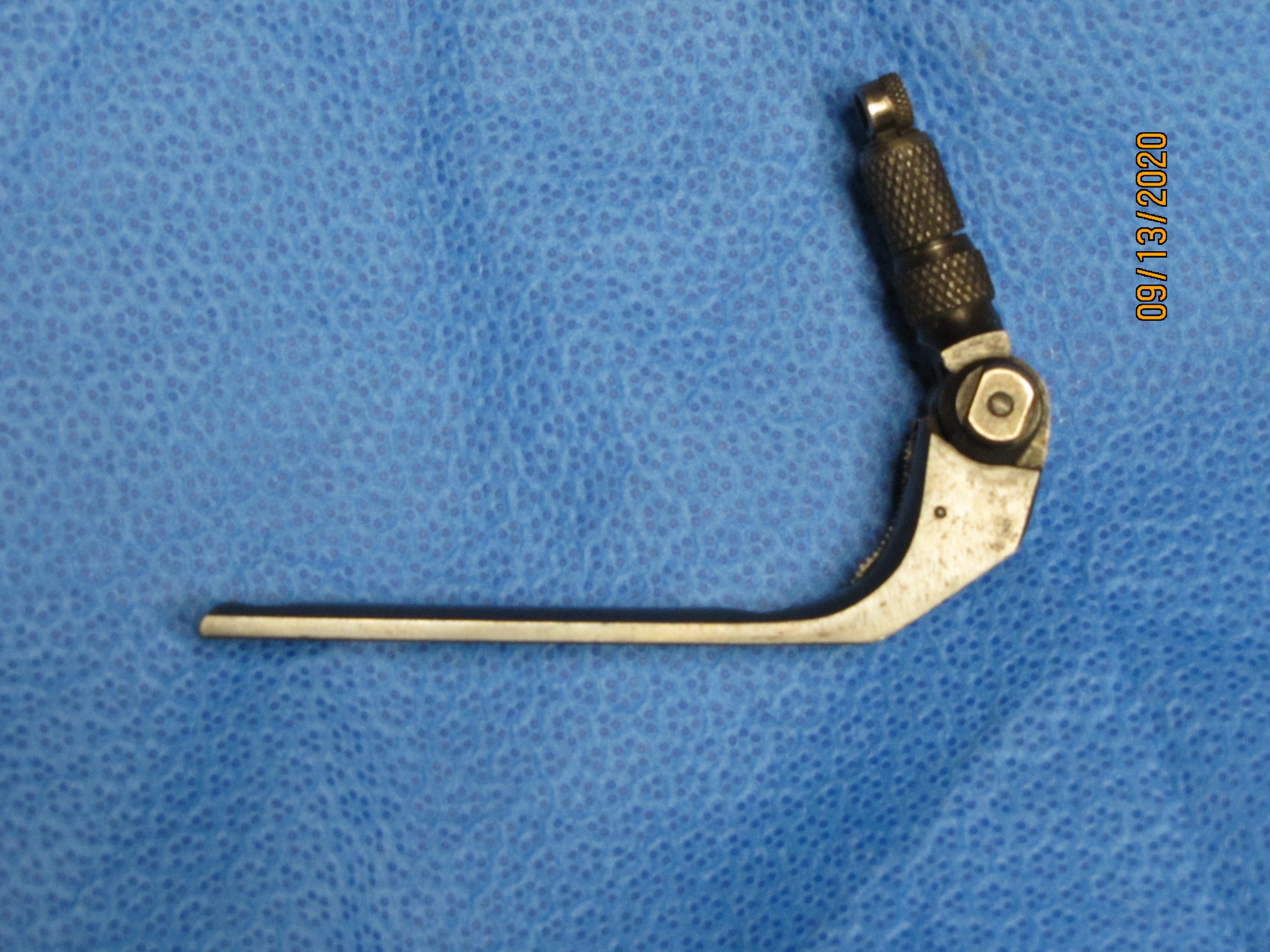

Thanks to a member here, I now have a Marbles Special Base sight on a Winchester.  A Winchester M1894 SRC .30 WCF is now proudly wearing the sight.  One of the advantages the Marbles catalog touts about this sight is the ability for the shooter to wrap their hand completely around the grip.  Indeed, regular tang sights do make this awkward.
Here it is paired with the Marlin 1893 SRC I showed at the beginning of this thread.  Kind of neat to have two .30-30 half magazine carbines with this sight:

Henry – I think this sight would be really cool on a M1894 14 inch, “trapper” carbine.  It would provide maximum sight radius, which would be quite helpful with a barrel that short.
