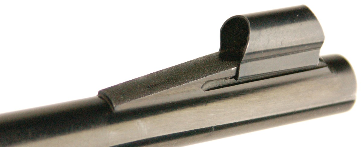

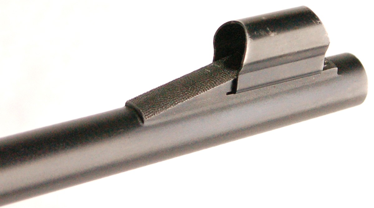

Just to clarify for me…  We seem to be using #2 (integral) and #3 (soldered) sort of differently.  I think you’re saying your Granddad’s gun has a #3.  Here’s the difference:
This is a #2 on a 375 Magnum.  Different barrel contour but the S/N (194078) is close to yours:
This is a #3 on a 220 SWIFT.  Same barrel contour and length as your 300 H&H MAGNUM (S/N 268122):

Thanks for that clarification. You are right. The front ramp on mine has the thin slots (matching the #3) for the hood, verses the wider groves of the #2.
