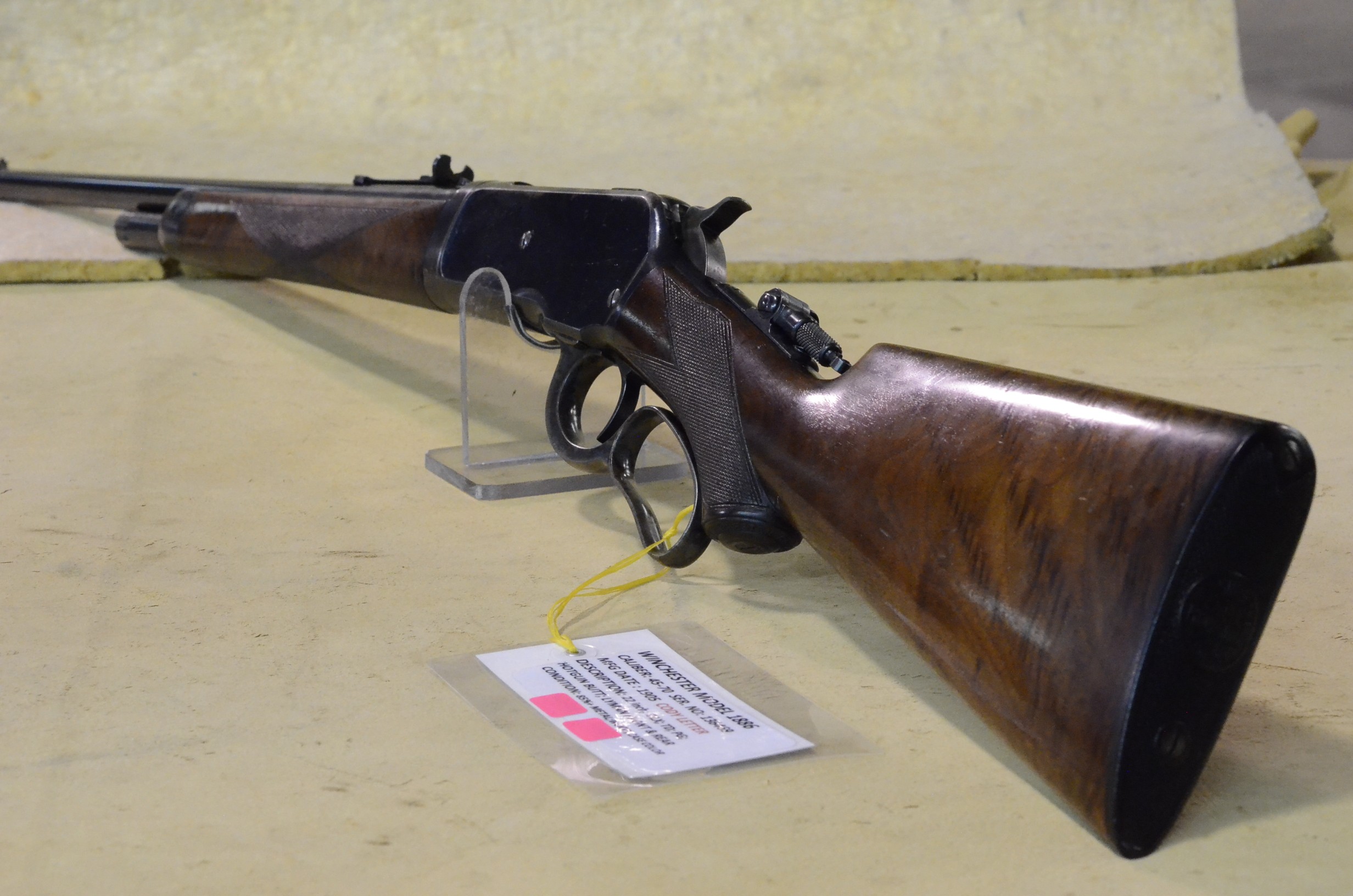

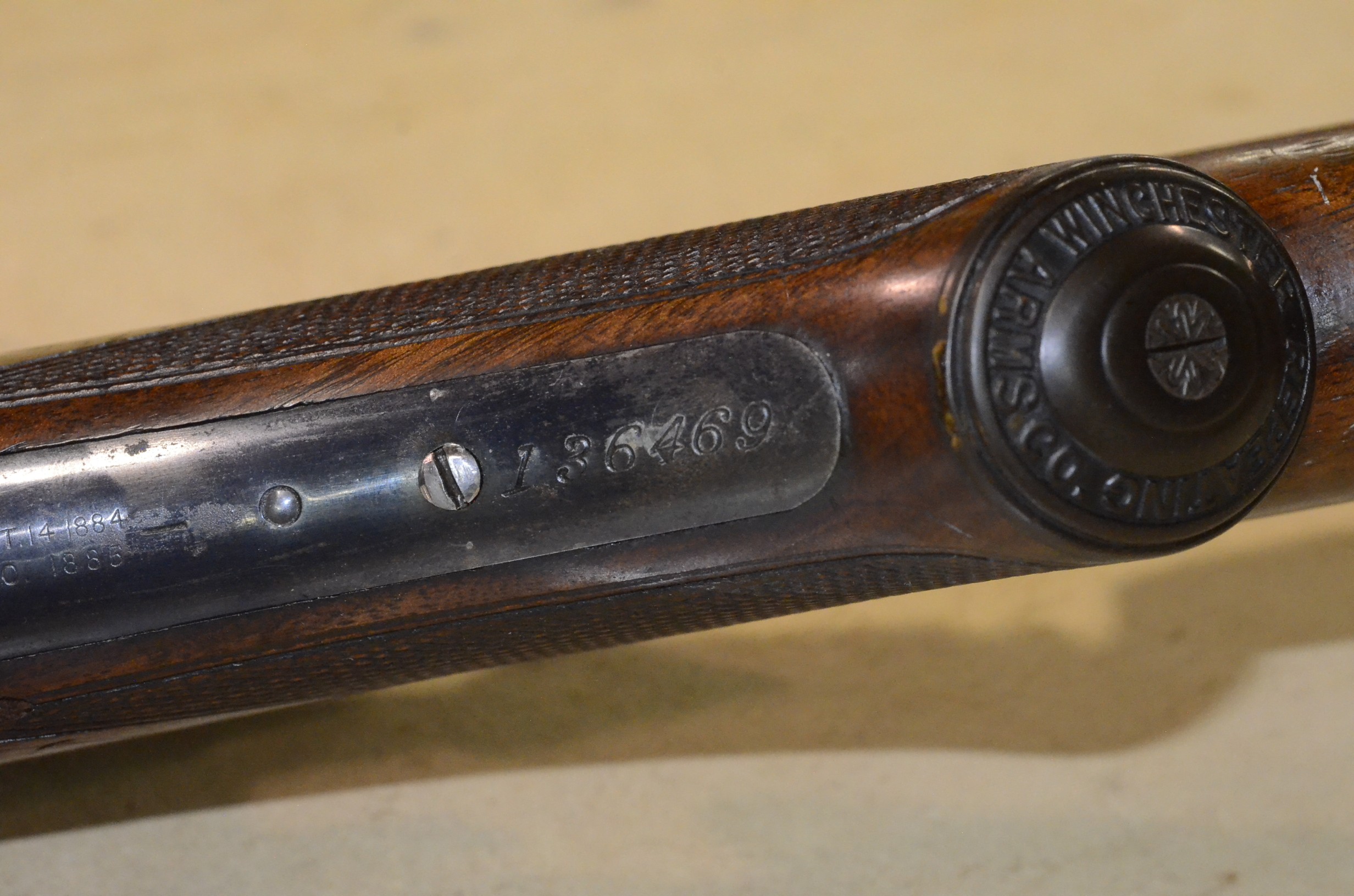

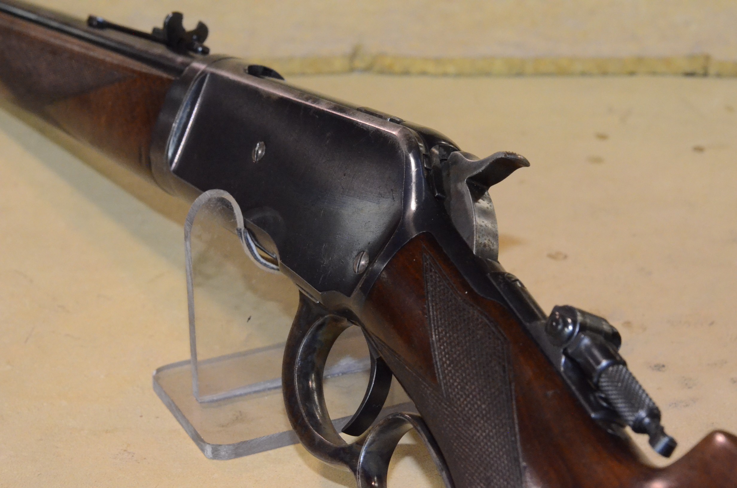

I have recently purchased a model 1886 DLX extra light weight rifle in 45-70 caliber. I like the gun very much and realize some of its flaws but am asking members to evaluate it also and possibly point out some of its downfalls and also potential value. After some reviews, I will reveal as Paul Harvey said ” And the rest of the story”DSC5708.JPGDSC5710.JPGDSC5711.JPGDSC5713.JPGDSC5717.JPGDSC5727.JPGDSC5730.JPGDSC5729.JPGDSC5733.JPGDSC5734.JPGDSC5723.JPG
August 2, 2026 - 4:38 pm
Pat,
Other than the special order Lyman No. 1 tang sight, it appears to be a standard “Fancy ELW” TD rifle.

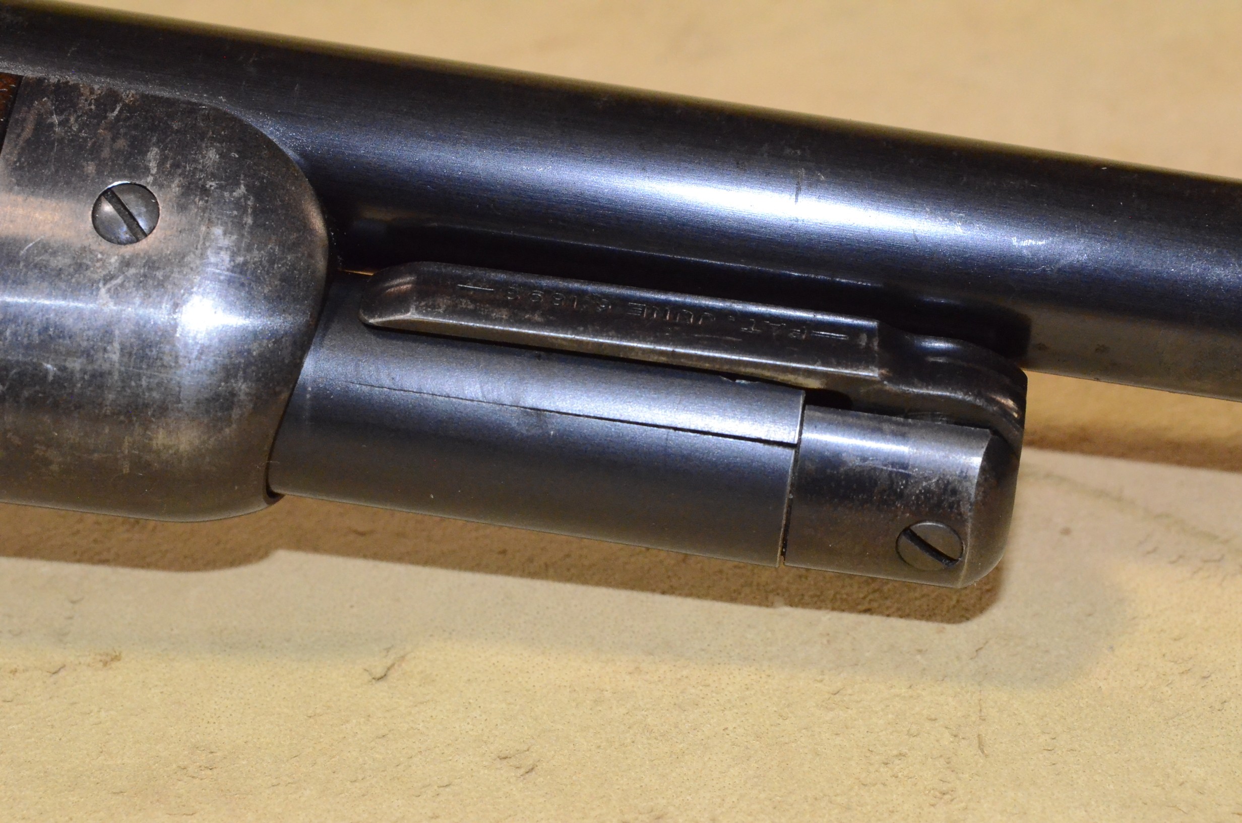

Is the mag tube split?

Yes , there is a short split in the mag tube

Mag tubes were made from rolling a flat sheet into a tube and the seam was soldiered.

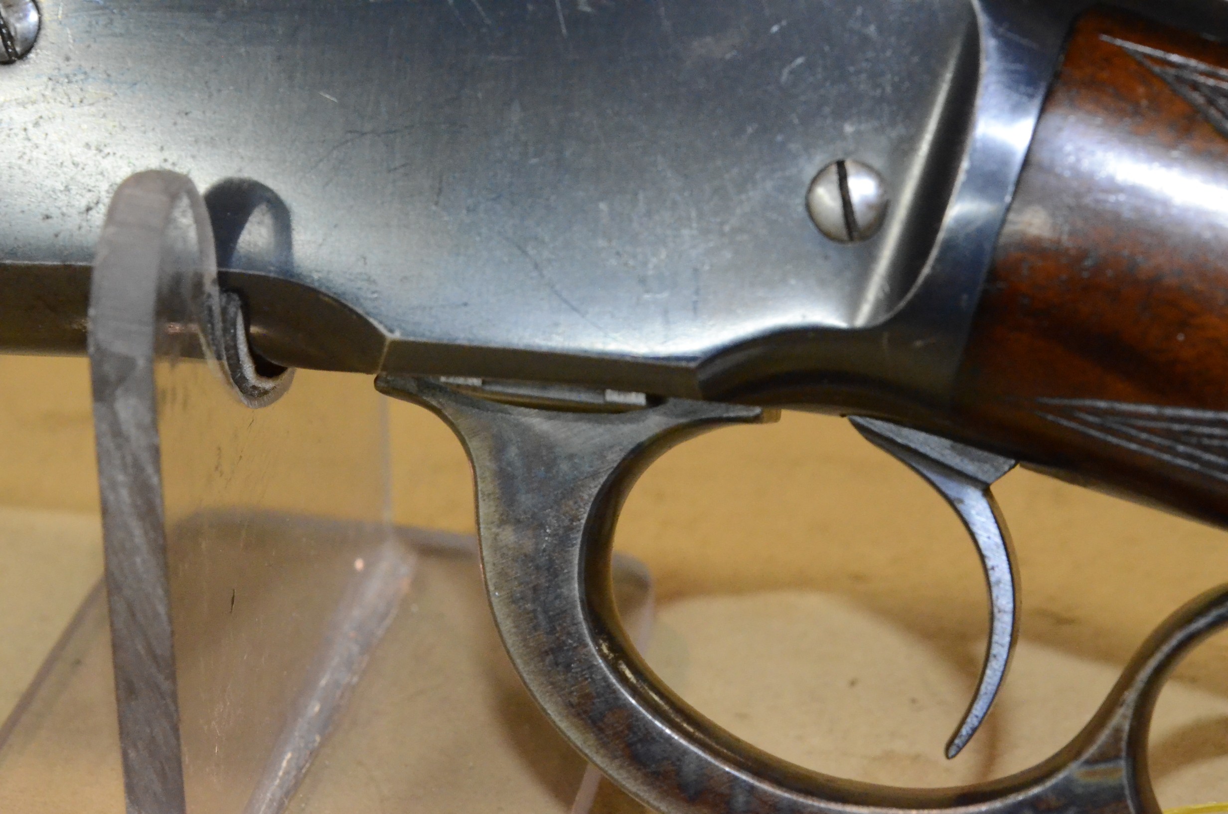

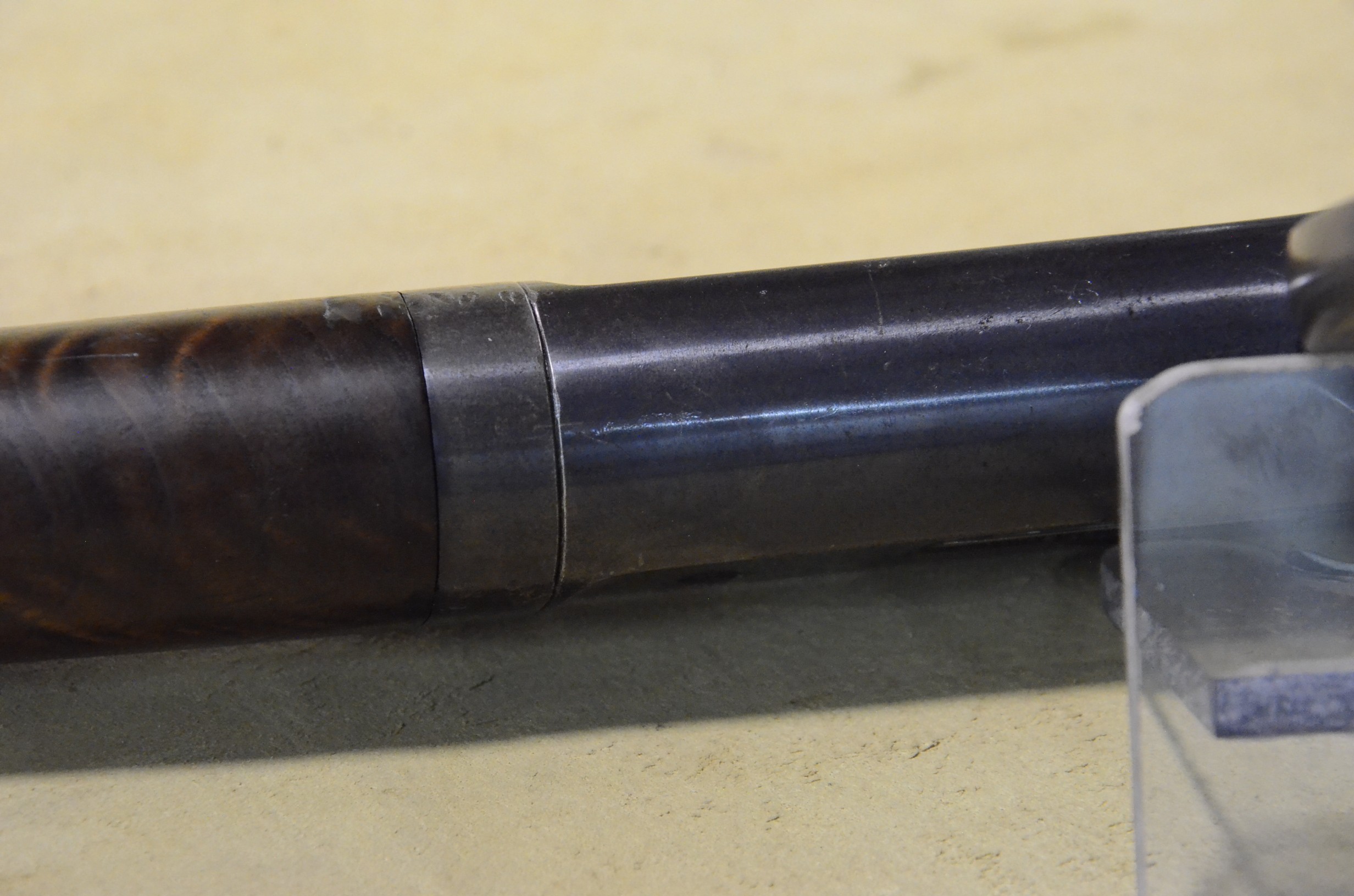

Looks like someone had trouble taking it down at one time and either hammered both sides of the flange or had it in a vice or wrench. I see the wood and frame were effected a little too.

I just checked the tang and stock and they all match 906XX and 906 on stock. What nobody has ventured to address so far is how this mismatched letter to an obvious high grade 1886 will affect it’s price.

Is it possible the mag tube is not original? I’ve never seen one split like that, even knowing how they’re made.

Jeremy, I would dare say that seeing where the split is and what appears to be vise marks on the TD collar and forearm that the threaded mag tube got seized up and upon using a cheater pipe on the TD lever the mag tube cap spun in the tube and presto! Split it.

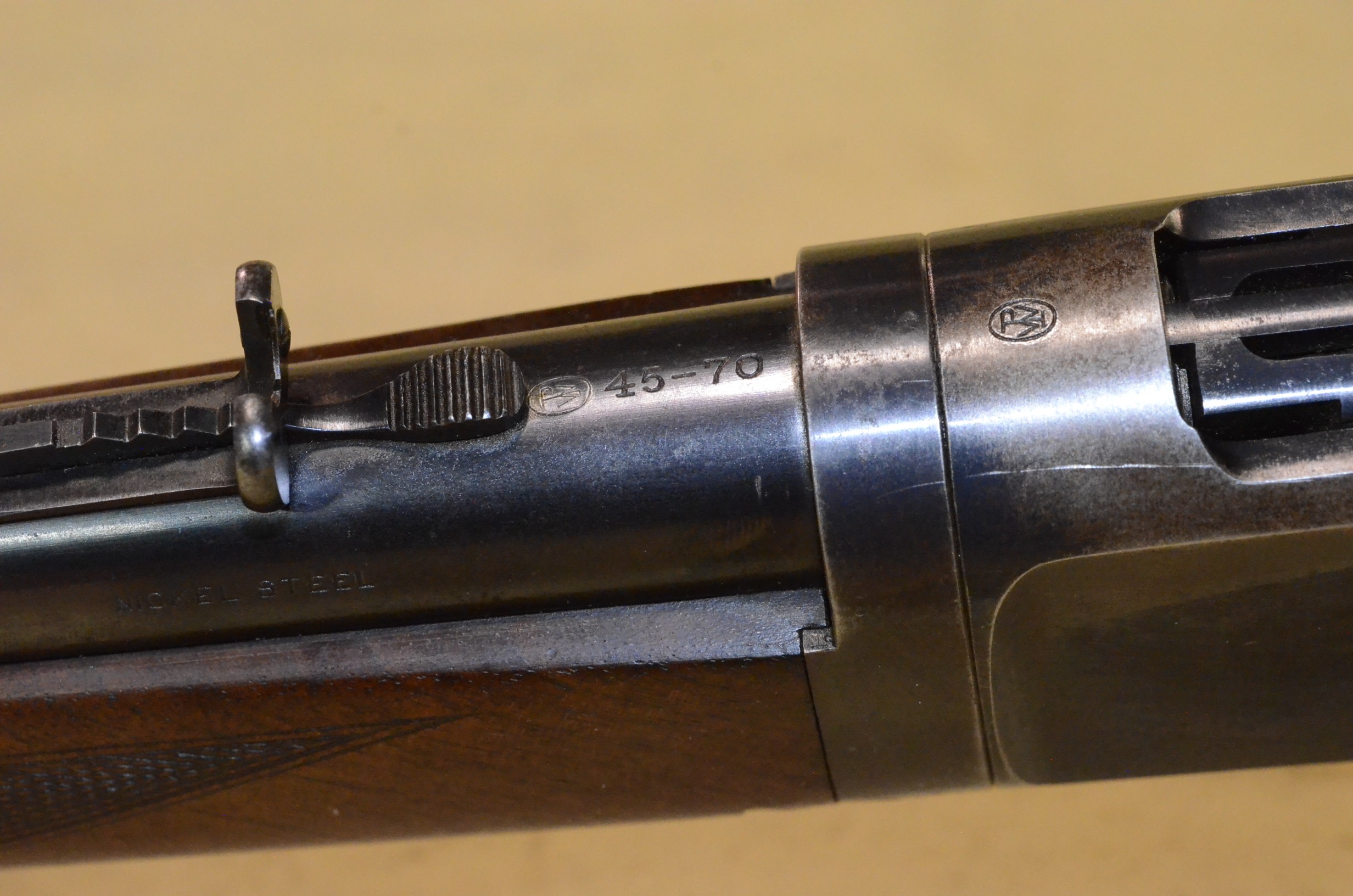

The only thing that stands out to me is the fact that the caliber stamp is located on the top of the barrel.  The rear sight is positioned close to the receiver as is normal on 22 inch sporting rifle barrels but on Model 1892’s The caliber stamp was rotated to the left side so that the rear sight elevator will not cover it.  As you can see in the image if the elevator is extended the proof stamp and caliber stamp will be covered.
Bert, do other standard 22 inch ELW 1886 sporting rifle have the caliber stamp located on the barrel top?
I would ask for an image of the actual ledger entry for the rifle.  They can sometimes be “open for interpretation” if this rifle and/or consecutive rifles have complicated entries.
