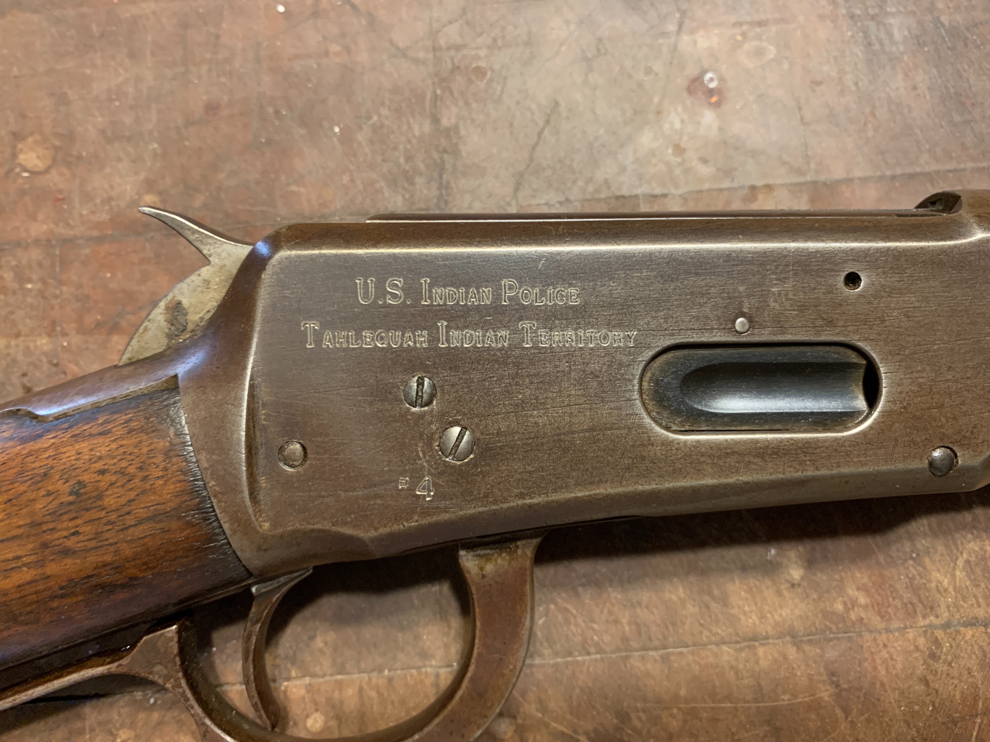

BE929CE5-729D-483E-B2B0-8D3BCE6192E2.jpeg63E557A8-71E2-4D93-8859-55D053C13E82.jpegAAB164C4-FBF2-46E6-9134-6C0D3066D46D.jpeg8DD23C56-E9E9-4FFF-82FD-99ADE1303AF9.jpegI have an 1894 src 30wfc manuf in 1903 (sn 226xxx) Inscribed on the right side of the receiver is
                                                                                                                           U.S. Indian Police
                                                                                                                   TAHLEQUAH INDIAN TERRITORY  Followed by a #4 on the lower side of the receiver above the trigger.  That was the capitol of the Cherokee nations following the trail of tears in Oklahoma.  Does anyone know if this would have been a gov. order or ordered by the territory? Inscription at winchester or after? the cherokee were proud of their language and often inscribed anything in their own alphabet.  I am waiting on a Cody letter to see what if any info I can glean there.  Any recommendations as to where else to research?  Rifle ended up in an estate in Fla.  (Seminole were in the same area of Oklahoma at the time).  Thanks for any info

Not sure if you would find anything at the Department of Interior or the Bureau of Indian Affairs.  Would to suggest to start locally with a historian or look for any references in the local newspapers from the period (Tahlequah Arrow).  There appears to be a lot out there on the Tahlequah Indian Territory on the interweb. The 1904 date for the carbine places it subsequent to the timeline when OK Indian police powers were taken over by the US Govt in 1898 with the exception of the Seminoles, according to the article below.
http://lestweforget.hamptonu.edu/page.cfm?uuid=9FEC4BE4-0CFE-0ACA-15B57C52CED4B765
Without anything substantive leading to provenance I tend to view all these as suspect.  However, the stamping on the carbine looks fairly aged and well executed.

I am of the opinion that the marking on the receiver frame was added after it left the Winchester factory.
August 15, 2019 - 1:08 am

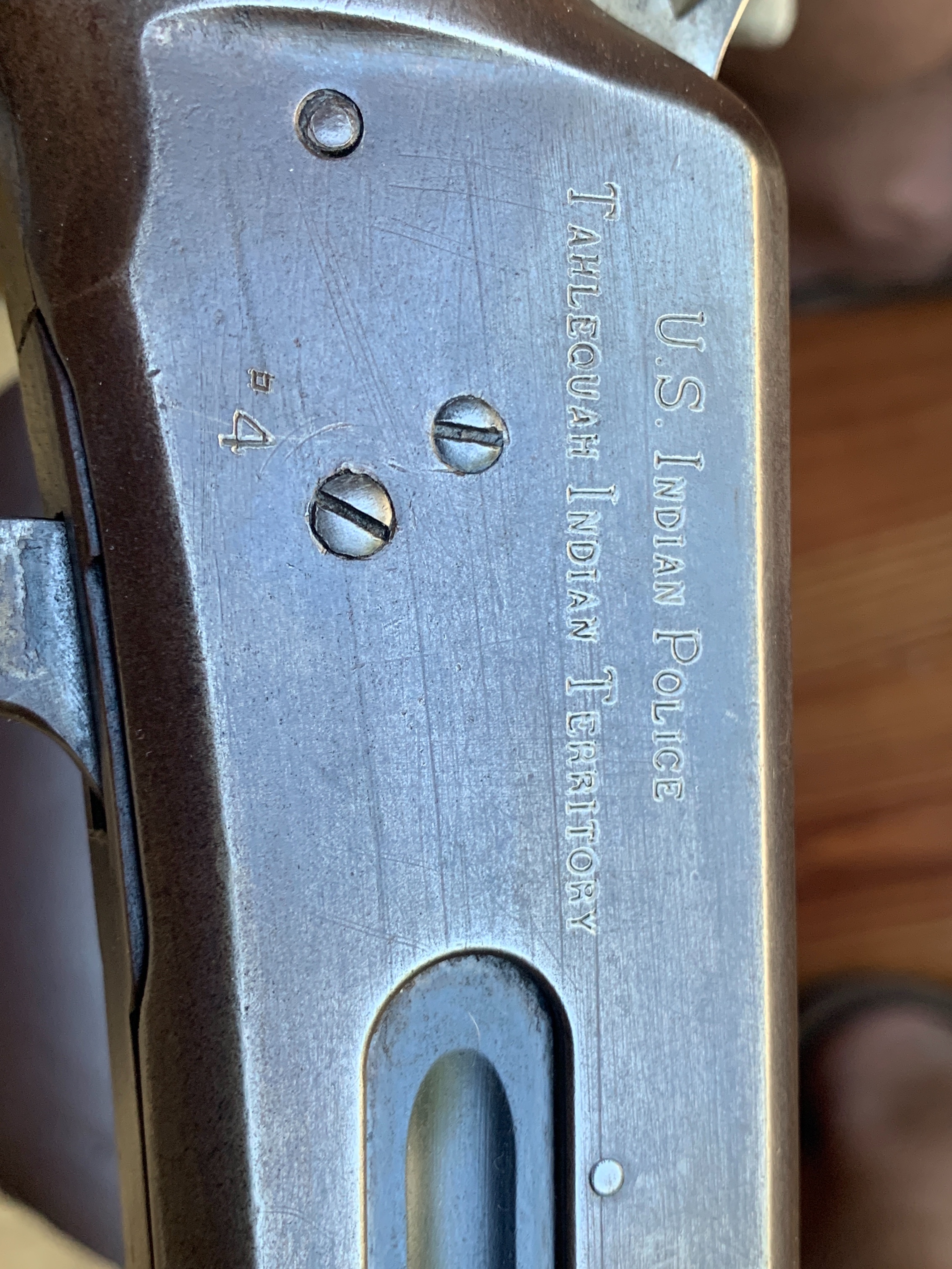

Doesn’t look like the imprint of a roll-die to me–more like what I’ve seen of laser-cutting, which can’t produce sharp corners, as far as I know.
Forum Posts: 1173
August 15, 2019 - 1:55 am
For sure post factory.
Originally thought it was done with stamp dies because of the halo and it looked like the deepest impressions or imprint profile looked “u” shaped.  But after blowing up the photo and looking at the letters E, A, I, N, and R there are some variations between each letter and some that are not.  If thats the case then it was likely not a die.  Dont know.
August 15, 2019 - 2:12 am
Look at that long scratch that begins in the first “R” in “territory”–the letters appear to be superimposed on top of it.

August 15, 2019 - 2:32 am
Thank you much, Ive read the article you cite, (Quote is my fav Billy currington song as well 🙂  )  I have a friend that has a relative that still lives on the res there and is an elder and has offered to research.  Ill let you know what I find out- Thanks for your time and input
Forum Posts: 1173
August 15, 2019 - 3:03 am
I took that to be a forge mark like you commonly see on receivers, this one extends across the receiver through the bottom edge of the guide screw and beyond, unless Im looking at something different than your describing.
August 15, 2019 - 3:53 pm
You’re right, as I see by enlarging this photo again, which makes the lettering look even cruder.  Well, at least the faker picked out a beater to do his faking on, rather than a nice, clean gun.

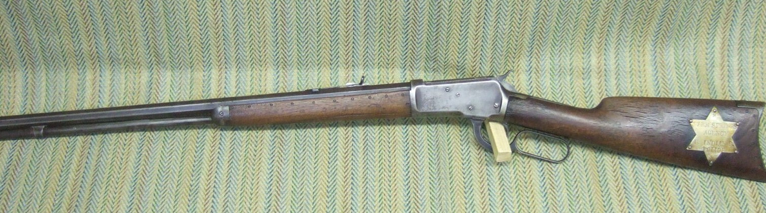

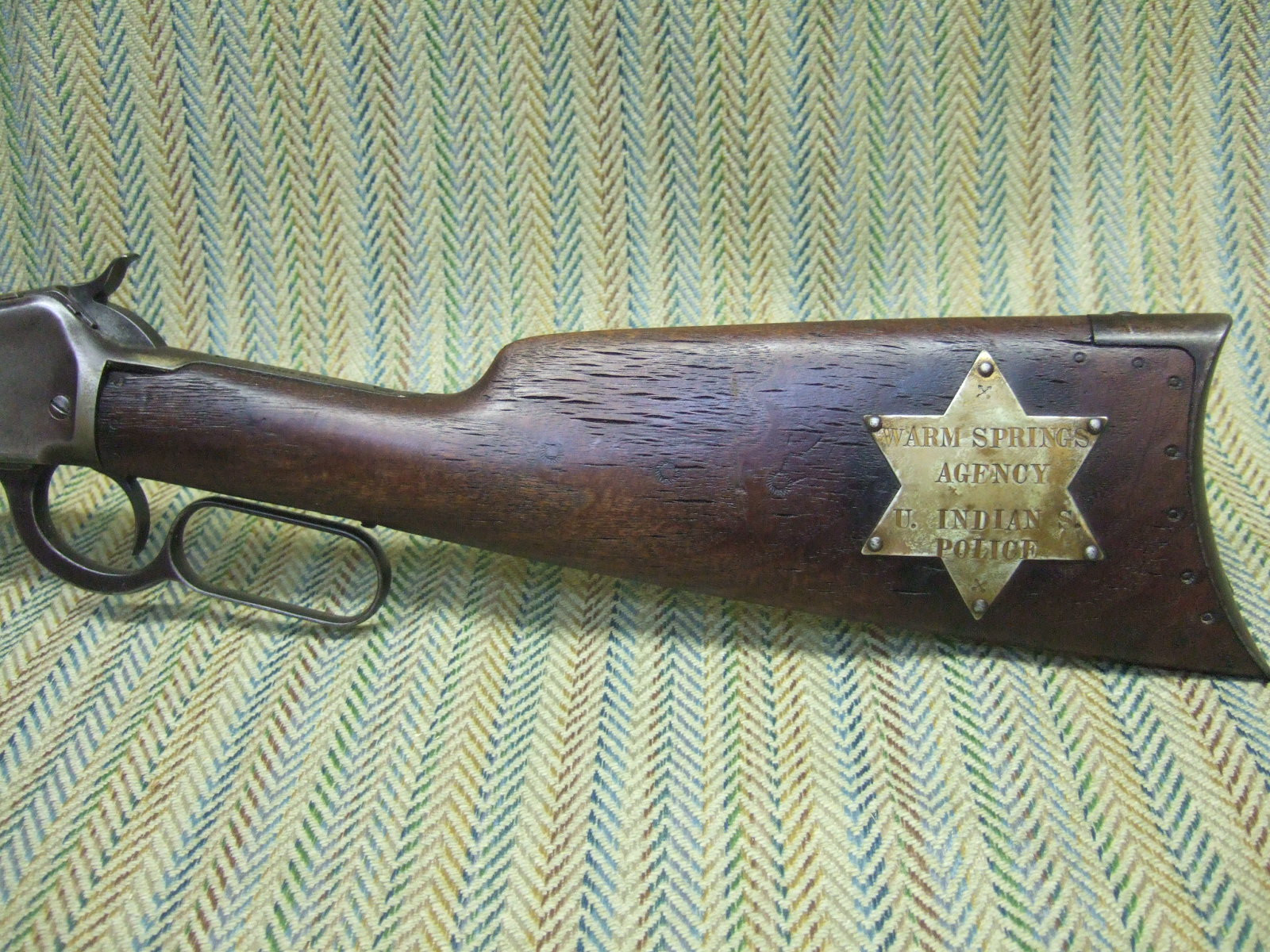

Here is one I had 10 or more years ago that I either bought cheap or was part of a trade.  It was manufactured in 1904.  Didnt find out a whole lot about it with limited research.  While neat and all, maybe original embellishment, maybe not, I was glad to see it go when it did to someone who had more interest in that kind of thing.
Old Guns
