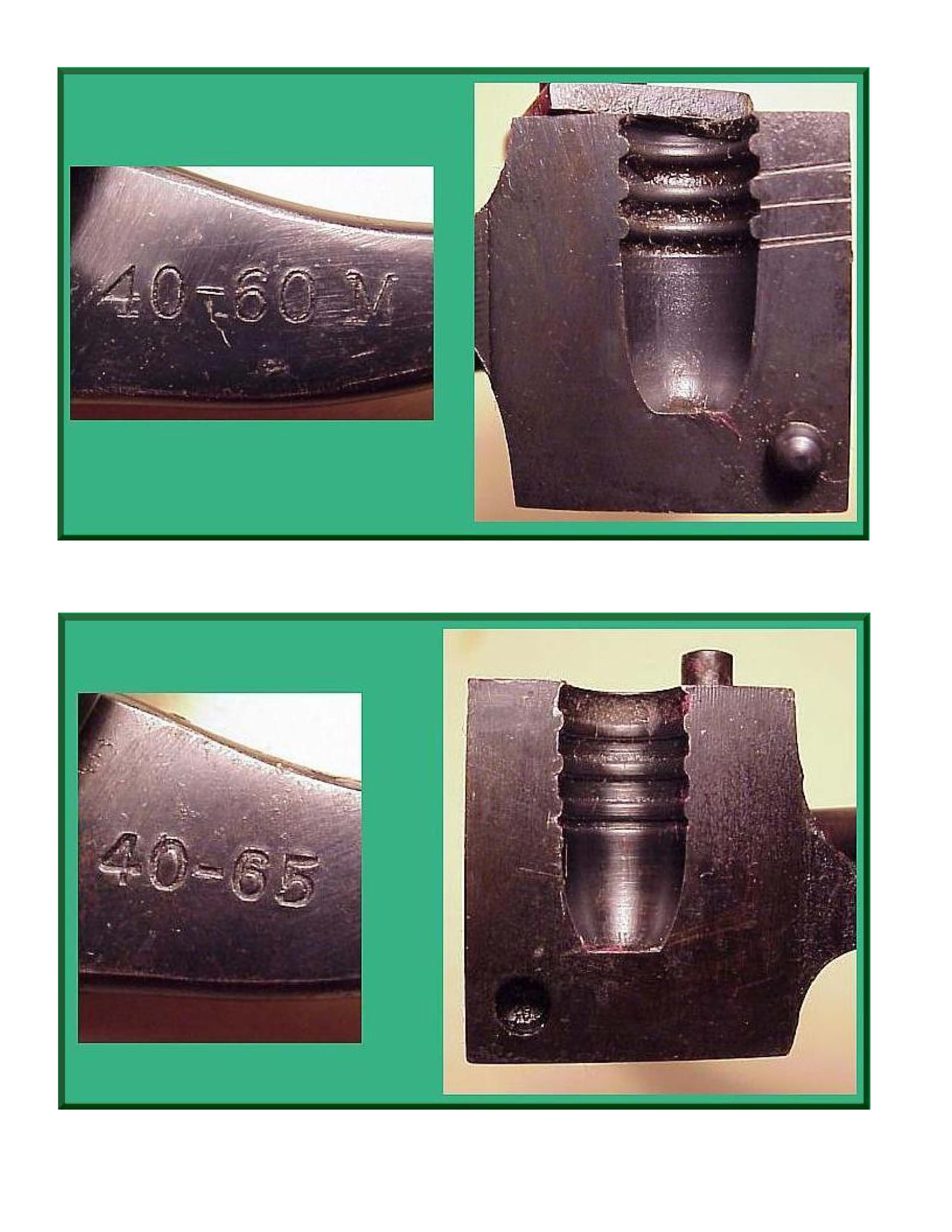

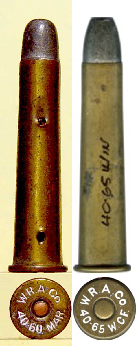

As this cartridge is essentially the same as the .40-65 Winchester, it is a puzzle why these were ordered.  It would be interesting to know how different the case dimensions and bore diameter were from the .40-65.  Possibly they took a standard .40-65 barrel and stamped it .40-60 Marlin?
As to the actual manufacturing process between the two calibers and rifle chambers, I have no idea.
They are essentially the same and my understanding is the brass case is the same. What does make them different from each other is the Bullet Design.
The Marlin has more of a rounded end bullet VS the 40-65 WCF is more flat / squared off. You can easily see this when comparing factory ammunition.
Also notably the Winchester Bullet Molds are noticeably different being cherried differently. The marlin has more rounded grease grooves VS the 40-65 is flat / squared off as well.
Thanks Maverick – very interesting.  My knowledge is expanded!
Also of interest is the .40-60-260 Colt and the .40-70 Bullard is basically the same cartridge as the .40-60 Marlin and the .40-65 Winchester.  I should know as my Colt Express rifle in .40-60, Bullard .40-70, Marlin M1881 .40-60, Winchester M1886 .40-65 and and Marlin M1895 .40-65 – I’ve used my same set of dies, same cases and bullets for all the rifles I just named.
